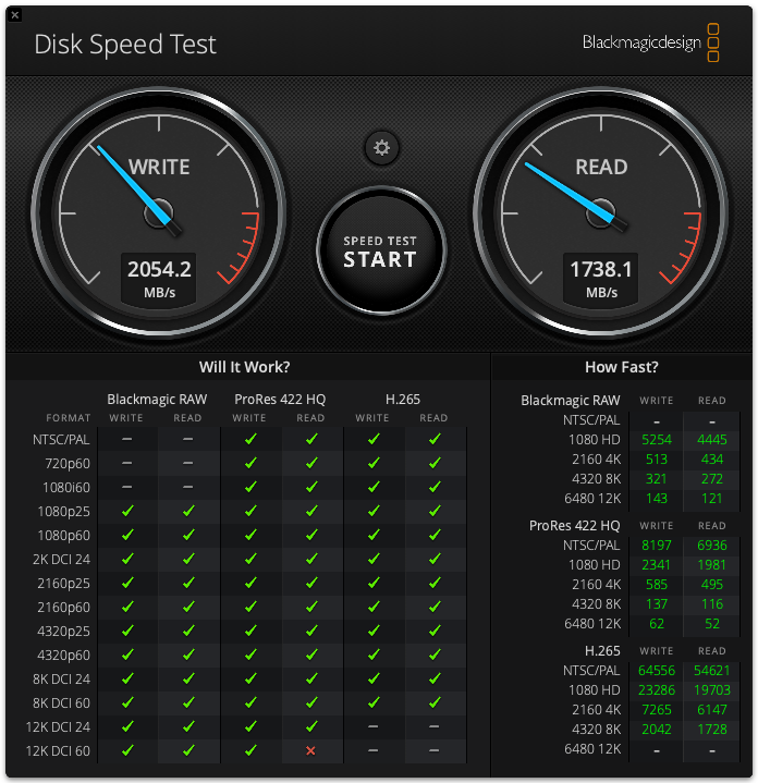

Answering my own question from about a year ago...
Acasis TBU405 works fine with Samsung 980 1 TB. Speed is not as good as compared to reported numbers with Samsung 980 PRO (2600-2700 MB/s write, 2200-2800 MB/s), but it's better than with Samsung 970 EVO Plus, Corsair MP400, Sabrent Rocket Q4, etc.
https://www.acasis.com/products/aca...nderbolt-3-4-usb3-2-3-1-3-0-2-0-type-c-tbu405

Yeah, the 980 (not Pro) is a PCIe Gen. 3 SSD so those slower numbers seem consistent with everything I've seen for Gen. 3's or SSD's w/ QLC flash (the MP400 & Rocket Q4 use QLC). Though doesn't the chart in the Acasis link in your post show faster read speeds for the MP400 & Rocket Q4 than what you're getting from the 980...not to pick a bone or anything with ya?

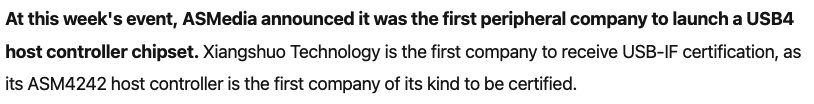

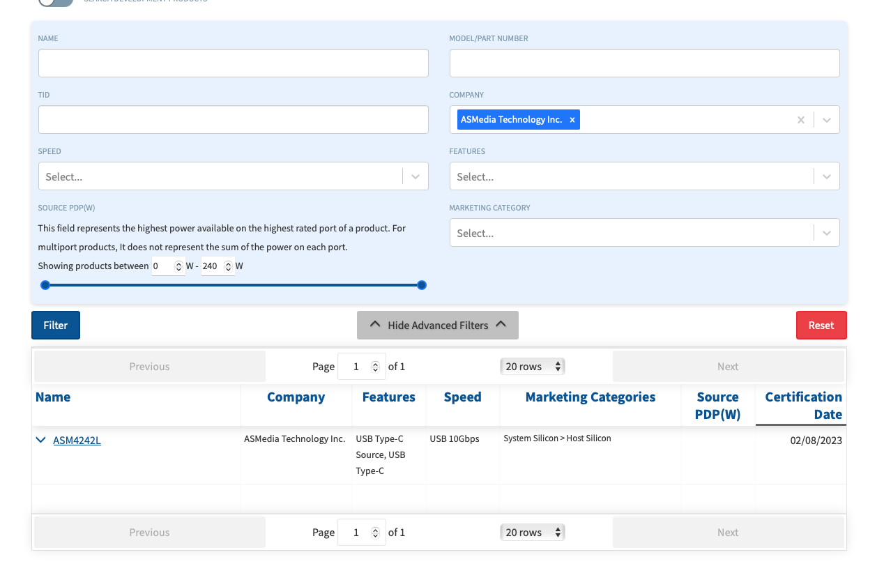

ASMedia has not received USB-IF certification for the ASM2464PD controller used in that enclosure. So the lack of certification should probably be regarded as a red flag. Moreover, if ASMedia has not received USB-IF certification yet, certainly the ZikeDrive has not either. And, I would expect that before ZikeDrive can get their certification, ASMedia must first obtain theirs. So, there is a stacking effect which will draw out the delivery date. According to the Indiegogo web page, delivery is scheduled for May. That seems unlikely.
Really? Meanwhile 2 DAYS AGO....

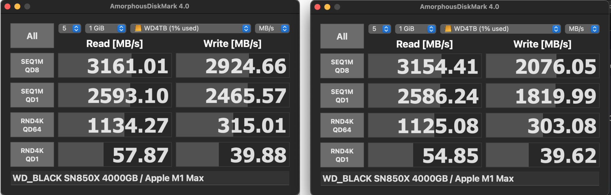

Hi
- WD SN850X 4TB drive in Acasis TBU401E enclosure and MBP M1Max
On the left - the result when connected directly to the MBP
Right - result when connected via OWC Thunderbolt Hub
Write speed dropped by almost 1/3 - is this normal?
Apparently, it can happen with some SSDs and some hubs:
https://eclecticlight.co/2023/02/21/thunderbolt-4-hubs-can-slow-down-fast-ssds/

  • High-performance Thunderbolt 3 SSDs, with read speeds over 1.5 GB/s, connected through Thunderbolt 4 hubs, retain read speeds close to those when connected direct.
  • Some high-performance TB3 SSDs show throttled write speeds when connected through TB4 hubs, resulting in write speeds of no more than 1.5 GB/s, equivalent to only two lanes of PCIe 3.0.
