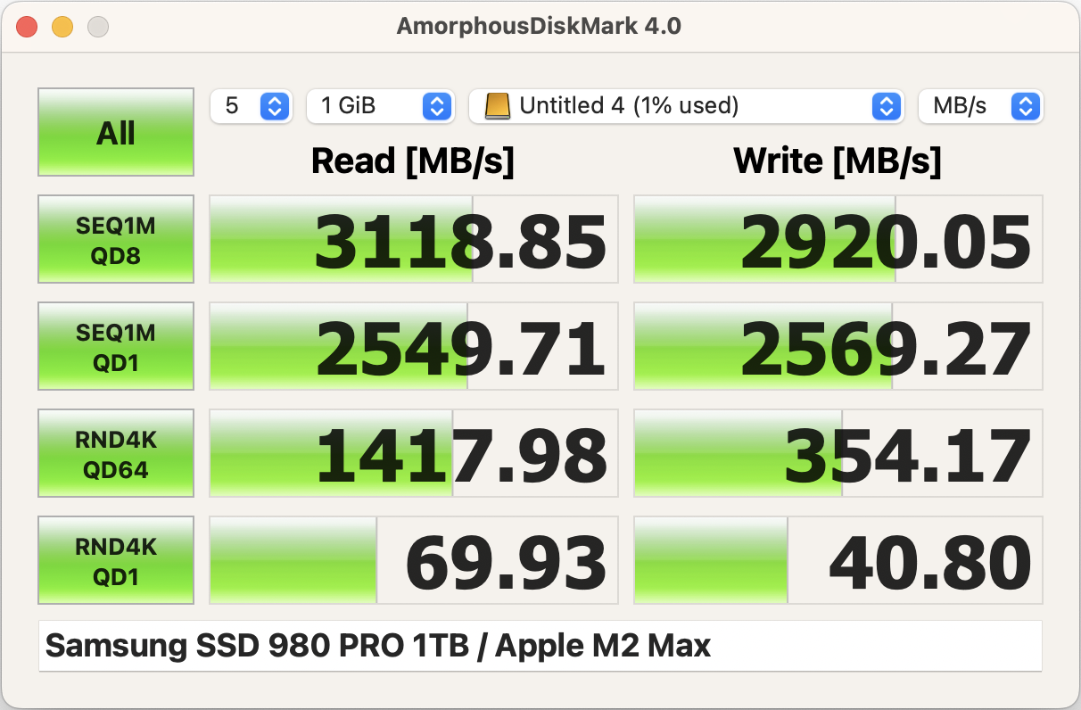

Found a SSD enclosure on Amazon about 33% less expensive than the ACASIS and ORICO enclosures. The device claims to be TB4/USB4 with a JHL 7440 controller.
- MacBook Pro M2 Max
- MacOS Ventura 13.3
- INDMEM U4001A TB4/USB4 enclosure, connected via the supplied cable directly to MBP TB4 port.
- Samsung 980 PRO 1TB PCIe Gen 4 NVMe SSD
- Disk is formatted as APFS(not encrypted)
System Information shows the device enumerates as a Thunderbolt device with 40 Gbps speed. Vendor Name is Intel.
Samsung SSD 980 PRO 1TB : Apple M2 Max.png
Reactions: ekwipt
It supports Thunderbolt 3 and USB.
It uses the Intel Titan Ridge controller for Thunderbolt support. It has a separate USB to NVMe controller for USB support.
It will be limited to USB 10 Gbps if connected to a USB4 host that does not support Thunderbolt (since Thunderbolt support for USB4 hosts is optional).
