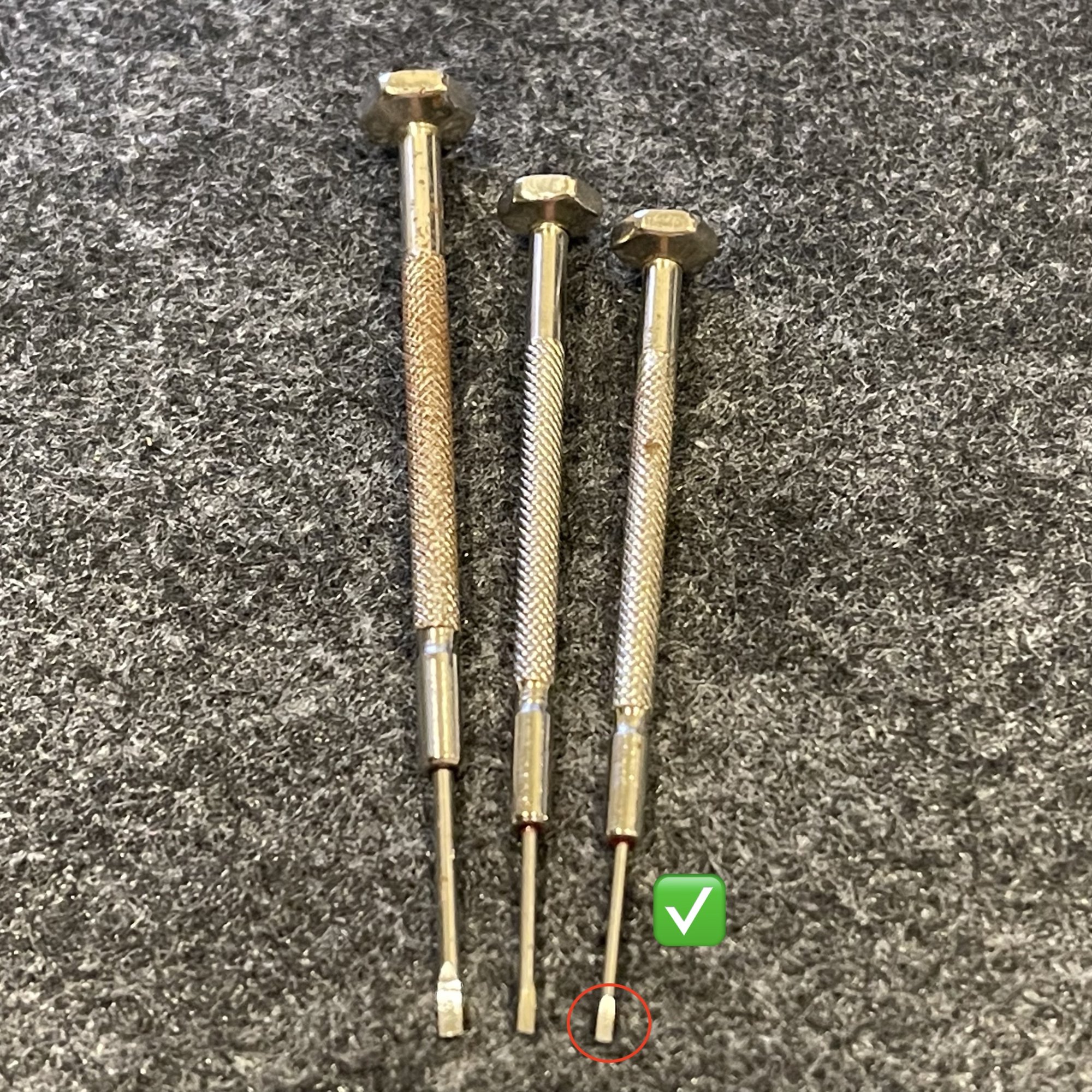

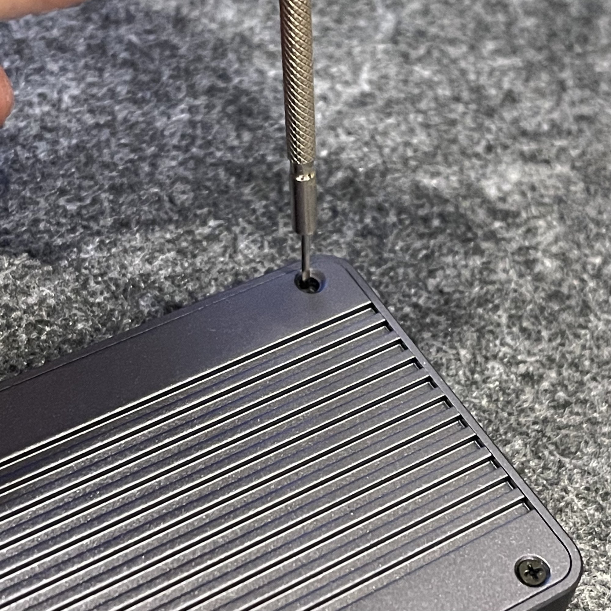

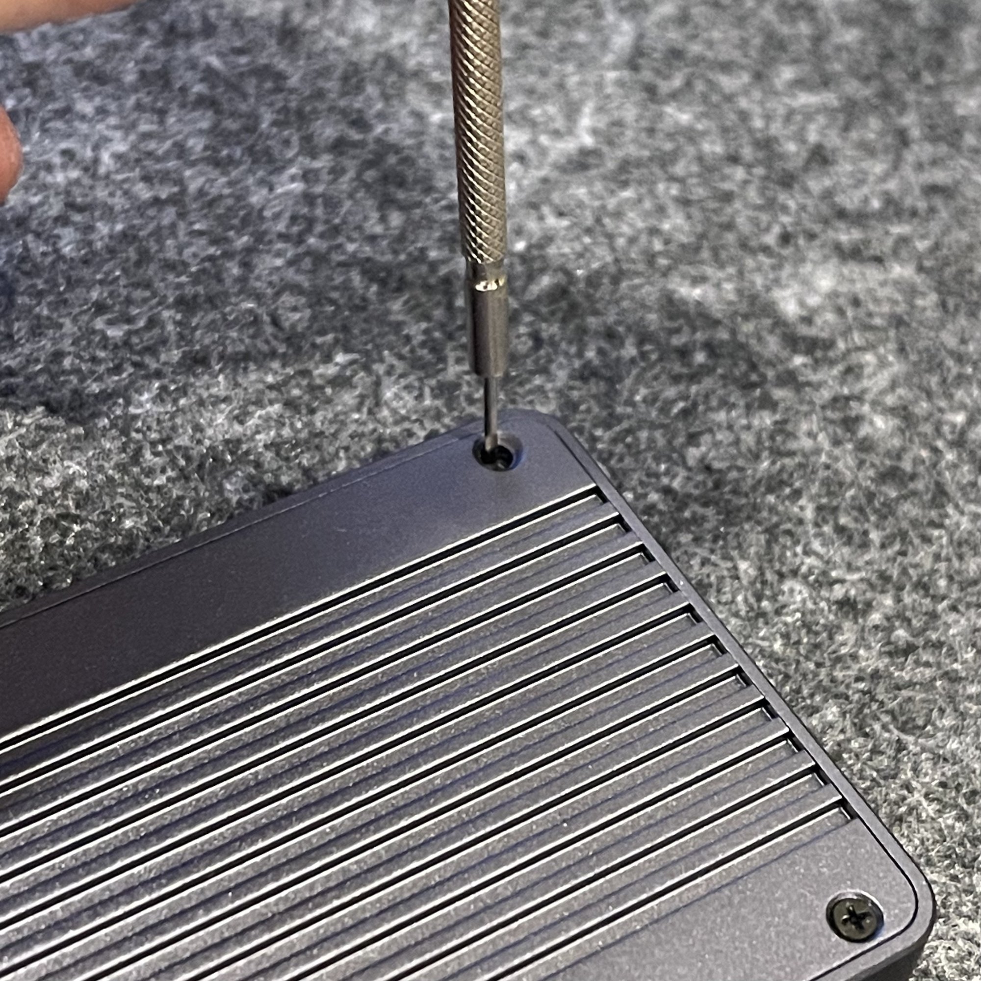

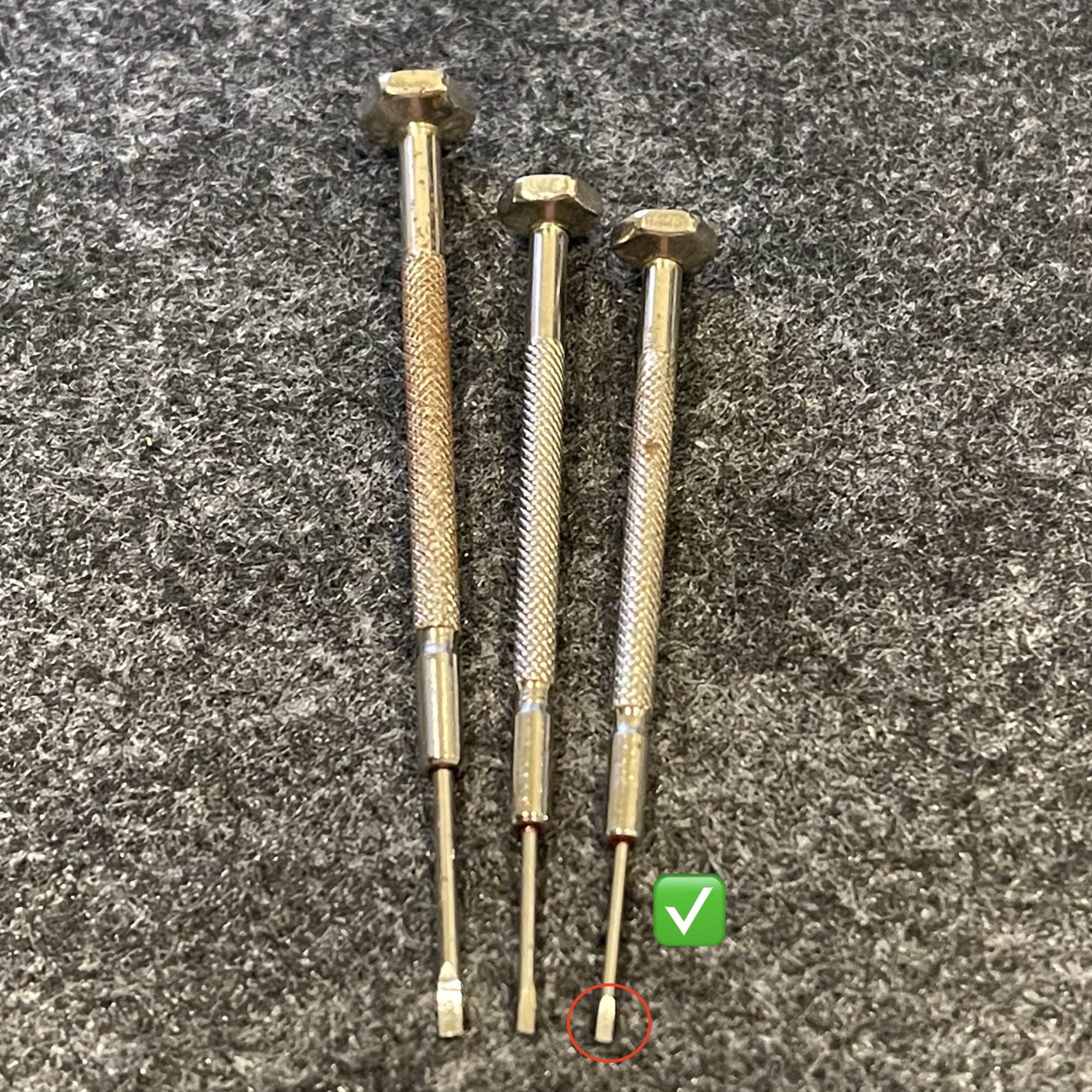

If you read all the posts in this thread, then you will find a member commenting on a design flaw of the Acasis TBU405, where there is no easy way to remove the top cover once the thermal pad is installed. Basically, the pad is stuck onto the cover. He managed to get the top cover off by repeatedly shaking the enclosure, with the screws out of course. In my opinion it is not really an issue that should cause any concern. I believe screw-in enclosure allows one to appropriate the tightness of the top cover with the thermal pad, something other design do not offer.
That said, there is a much simpler solution to removing the top cover actually. Find the smallest flat head screwdriver you have lying around or get one from the hardware store, or something made of steel and is tiny and slim, whatever. Below is mine.
Remove the 4 screws securing the top cover to the chassis. Poke the flathead screwdriver into one of the holes like this (mere illustration, I removed only 1 screw to show what I meant):-
Hold the base of the enclosure in one hand, and pry the screwdriver into the screw hole gently with the other, in a gentle rocking motion. The top cover will come loose. What you are essentially doing is slowly detaching the thermal pad from the top cover.
There, you crossed your first hurdle. Now remove the thermal pad. You won't have too much of a problem removing it. It is not as sticky as you think it is. If you follow my recommendation early, you may still be able to reuse the pad. If you gonna replace it with a new one, then ignore everything I said in my previous post and rip the pad off.
