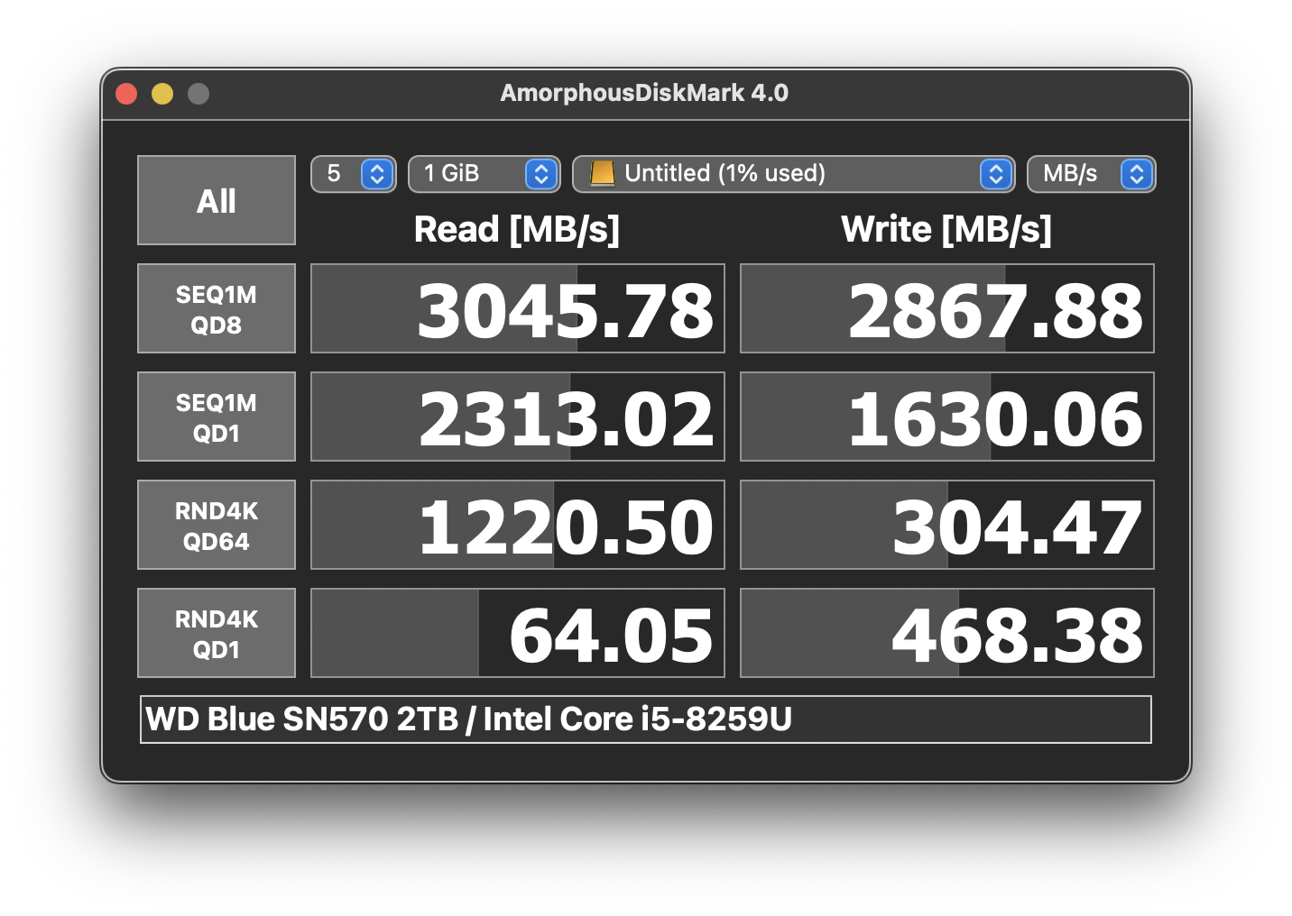

I picked up an Acasis TBU 405 direct from the company's website for $109, and it was shipped direct from a warehouse in Chino, California.
Installed a WD SN570, and got this result:
So far, pretty happy with this.. may get another and put a 770 in next time but the 570 is good and only $99 at the moment for 2TB..
Your Random Write4k QD1 speed is nearly an order of magnitude faster than what I get on SN770. Flipping through this thread to earlier screenshots, something around 40 or 50 is normal for this number.
I wonder what makes your number so much higher than everyone else?
Is it perhaps because the drive had virtually nothing on it? I guess if there is almost nothing on the drive, then it doesn't take long to find an empty space to write to?
Perhaps the right question to ask is what machine is this tested on. See the benchmark again.
Looks like an intel 2018 MBP which technically should give a better results than any ARM Mac due to a difference in the thunderbolt/USB4 controller.
Quite likely this is the case as I literally tested it straight out of the box, only thing I did before I ran that test was to format the SN 570 to APFS using Disk Utility, then went to the tests
I will rerun the results on an M2 Air that I should be getting access to shortly.
Do find it disturbing that it seems Thunderbolt on Apple Silicon systems is somewhat deficient.. perhaps fixed in M3? Or does Apple just not care about reduced TB performance?
