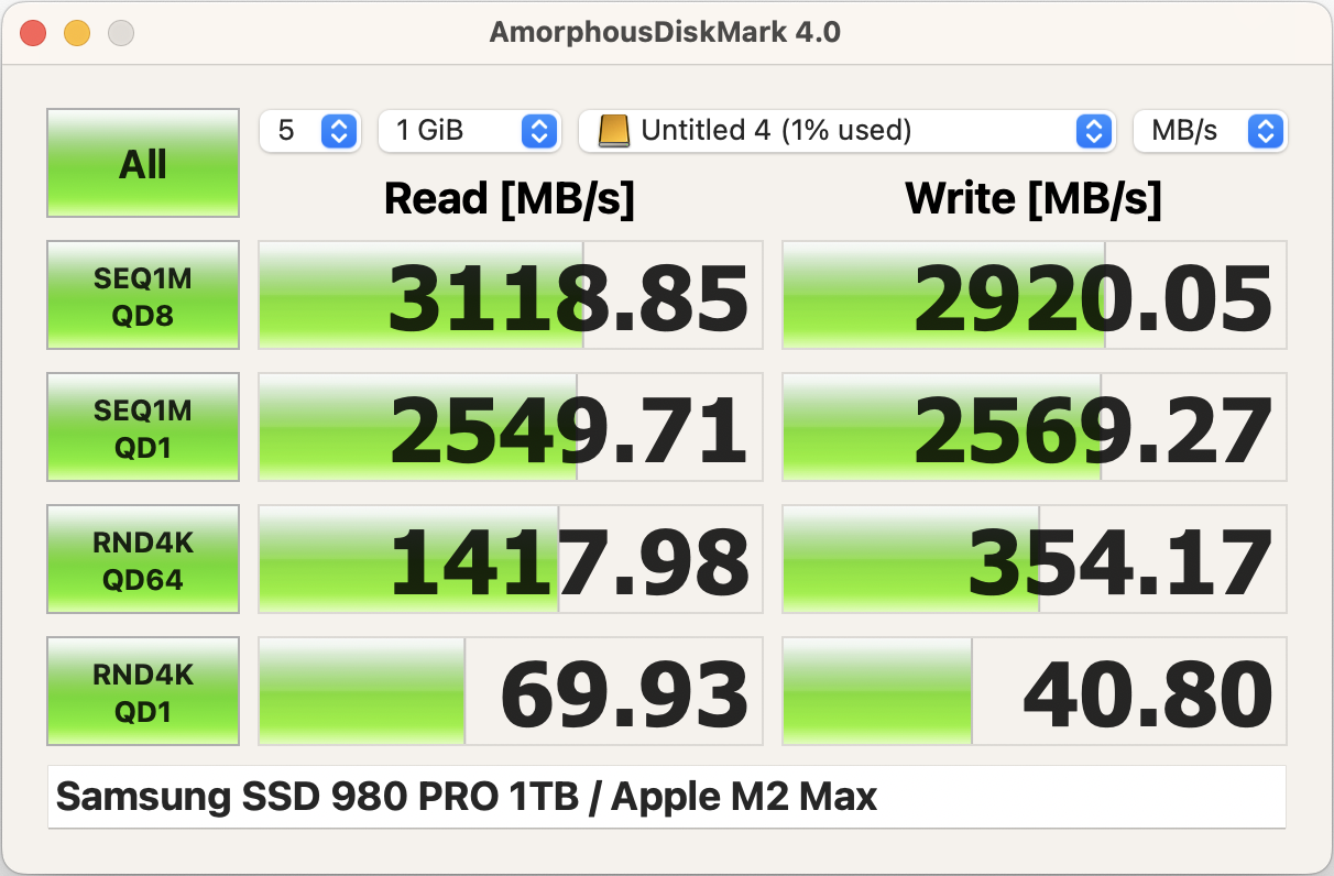

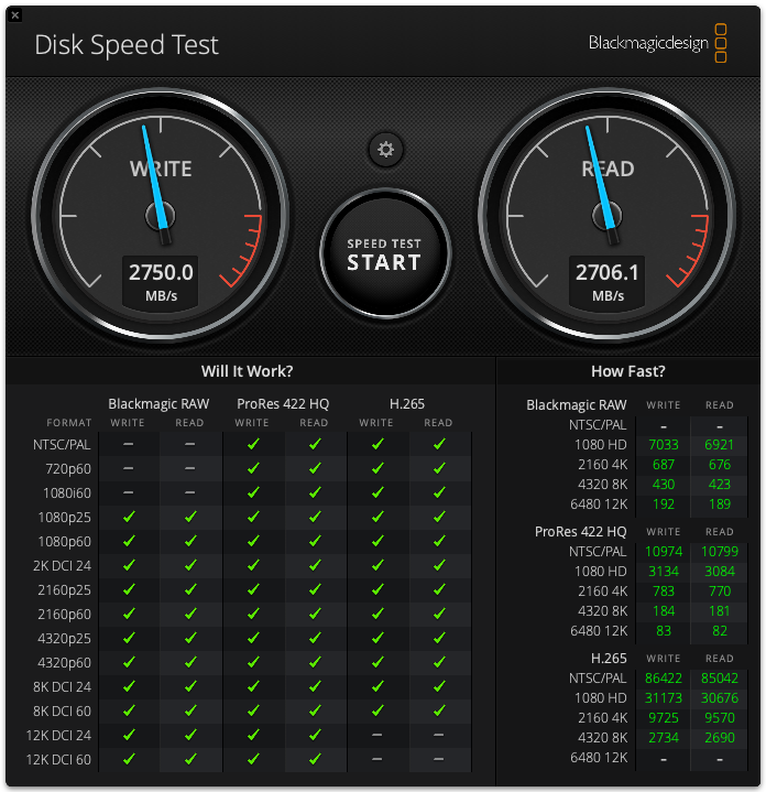

Thank you. Can you share the read and write speeds too?
Want to get an idea what speed the INDMEM enclosure supports.
Here is the Amorphous Disk Mark test I did a while ago. The Blackmagic test is similar. INDMEM U4001 with Samsung 980 PRO 1TB attached to a MBP M2 Max.

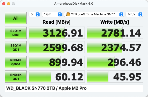

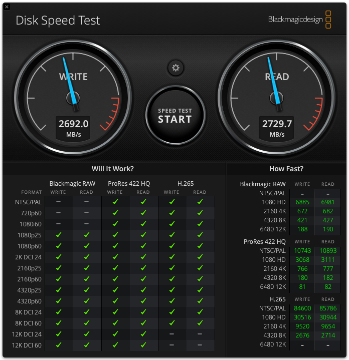

I received 2TB SN770. Yesterday I ran the two popular benchmarks on it while it was empty, using my TBU42, attached to my Mac Mini M2 Pro:
WD_BLACK SN770 2TB : Apple M2 Pro.png
Write speeds were slightly slower than the 1TB SN770 but not enough to matter.
