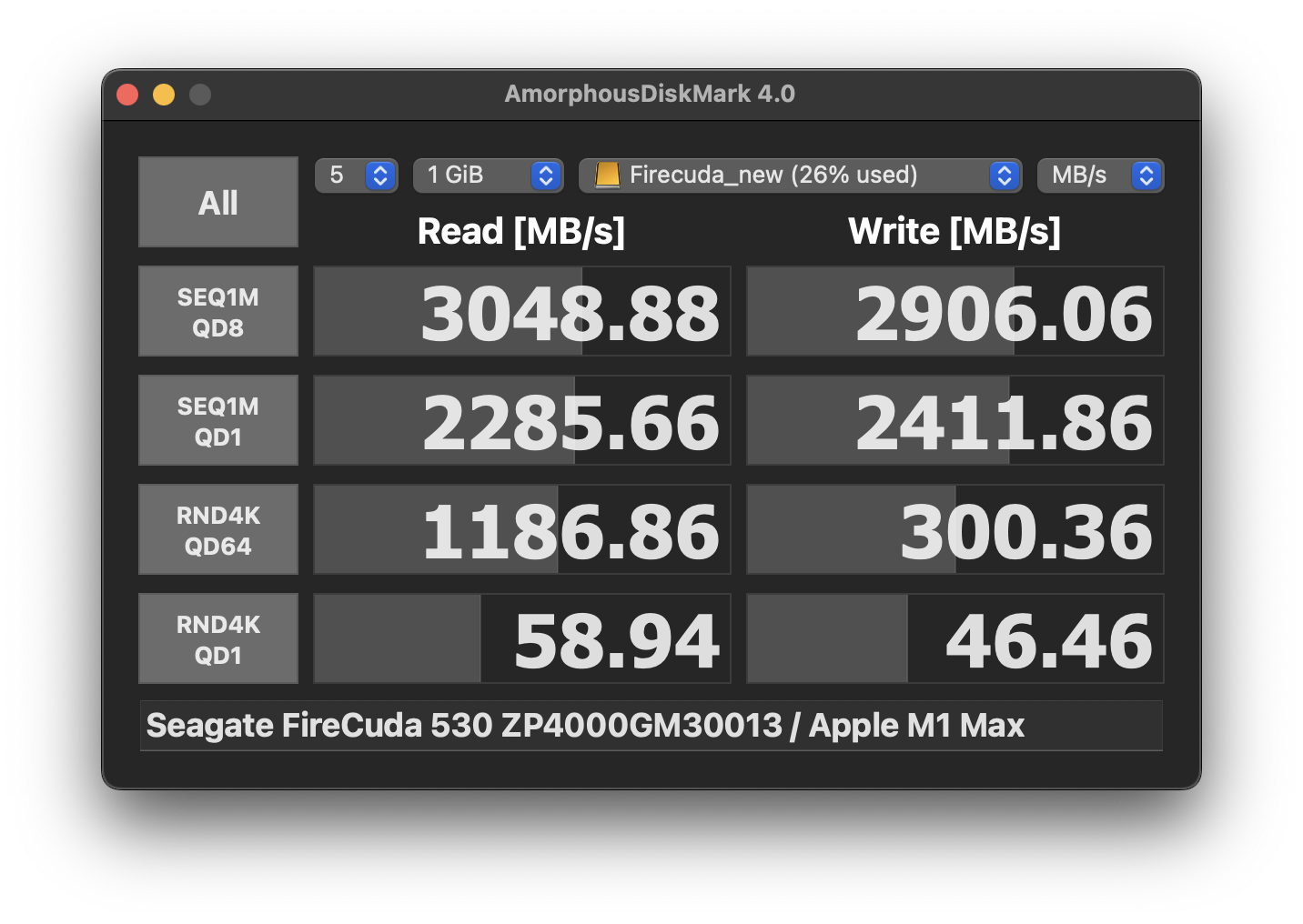

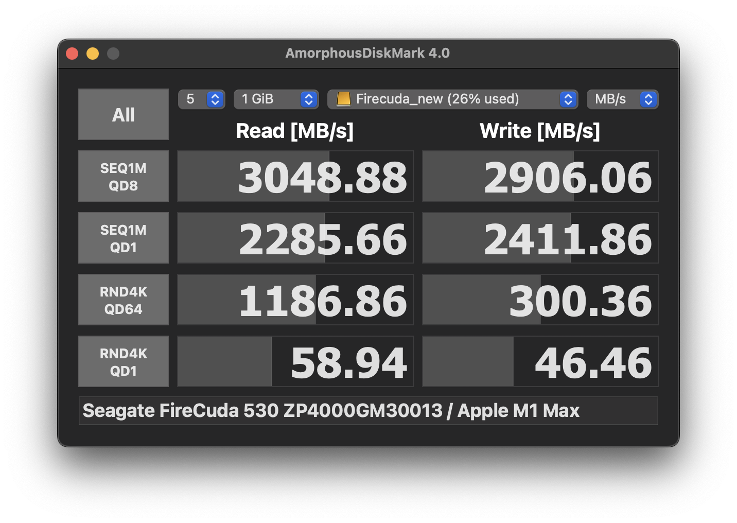

Another combo : ACASIS TBU405 + FireCuda 530 4TB on a MBP 16" M1 Max :
The numbers are similar to those observed by Chancha with the same enclosure and the WD SN850X 4TB.
In a real world test, copying a 470 GB folder (containing photoshop files) to the MBP internal drive took 2 minutes 40 seconds without any slowdown. The enclosure got pretty hot though.
