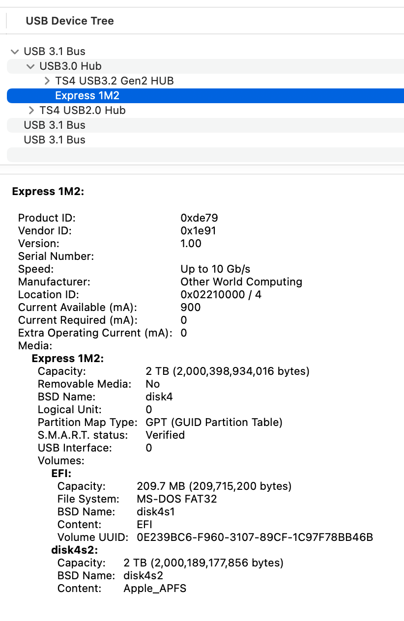

Hoping you Thunderbolt experts can help with a mysterious problem. I have a pair of OWC Express 1M2 enclosures connected to the Thunderbolt ports of a Caldigit TS3 dock (which is connected via Thunderbolt to my MBP M3 Max).
I noticed today that one only one of these enclosures is showing as being connected via Thunderbolt (the other shows as a USB3 device, and is operating at USB3 speeds). While I can't say exactly when this started, I do know that they were both in the past showing as Thunderbolt devices.
Through a bit of trial and error, I observed that if I swap the two enclosures, the problem "follows the enclosure". Also, thinking maybe it was some kind of power limitation on the dock, I tried with just that one enclosure connected, and it still was only USB3. So it's not the cable or the port. I was all set to do an RMA on the misbehaving enclosure, when I decided to try it directly connected to the MBP... it worked (showed up as a Thunderbolt device, with expected speeds).
So, in other words, this particular enclosure works fine when connected to my MBP, but not when connected through the dock, but the dock works fine with another identical enclosure.
Any ideas?
You must be misremembering, because the Caldigit TS3 dock (and every other Thunderbolt 3 dock / device) has at most only one downstream Thunderbolt port. All other USB-C ports are USB.
What do you mean by swap?
This doesn't make sense unless one of the cables is not Thunderbolt. Even then, the enclosure that is using a non-Thunderbolt cable might connect as Thunderbolt 20 Gbps.
The enclosure that is connected to the downstream Thunderbolt port of the TS3 dock should be connecting as Thunderbolt.
The enclosure that is connected to the downstream USB-C port of the TS3 dock should be connecting as USB 3.1 gen 2.
Was that enclosure connected to the Thunderbolt port or the USB-C (non-Thunderbolt) port?
Did you try connecting just one enclosure and checking each port individually?
When testing, reduce variables and simplify.

Ah, my apologies for the brain fart… it’s a TS4, not a TS3.
I have two Thunderbolt cables attached to the two downstream TB ports of the TS4 (not TS3 as I mistakenly said previously). If I leave those cables attached to the TS4 as-is, but swap the enclosures (so enclosure A is plugged into the cable and port where enclosure B was previously plugged into, and vice versa), the problem follows the enclosure.
I also tried a third cable with the troublesome enclosure (same cable with which it works fine when attached directly to the MBP), but same problem.
So, with that enclosure, I get TB when attached directly to the MBP, but USB when attached to the TS4 (no matter which cable or port is used). Meanwhile, the other Express 1M2 does give me TB on either TS4 port and either cable.

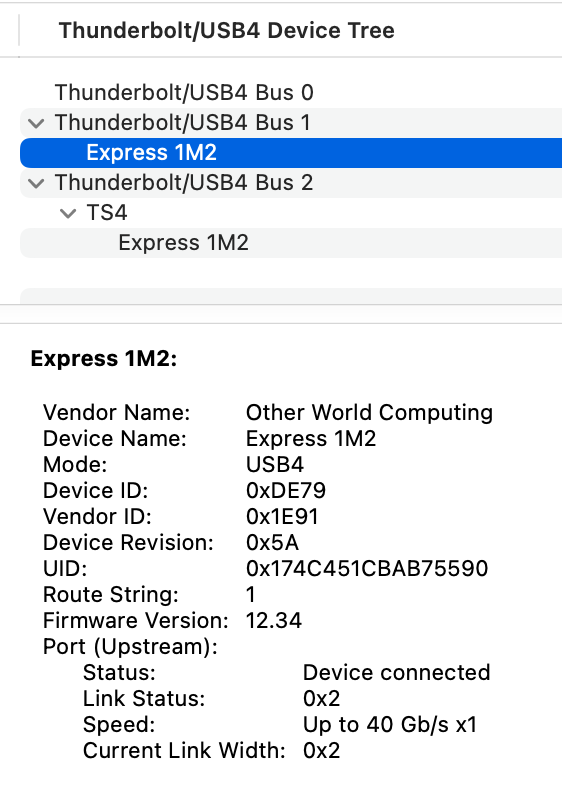

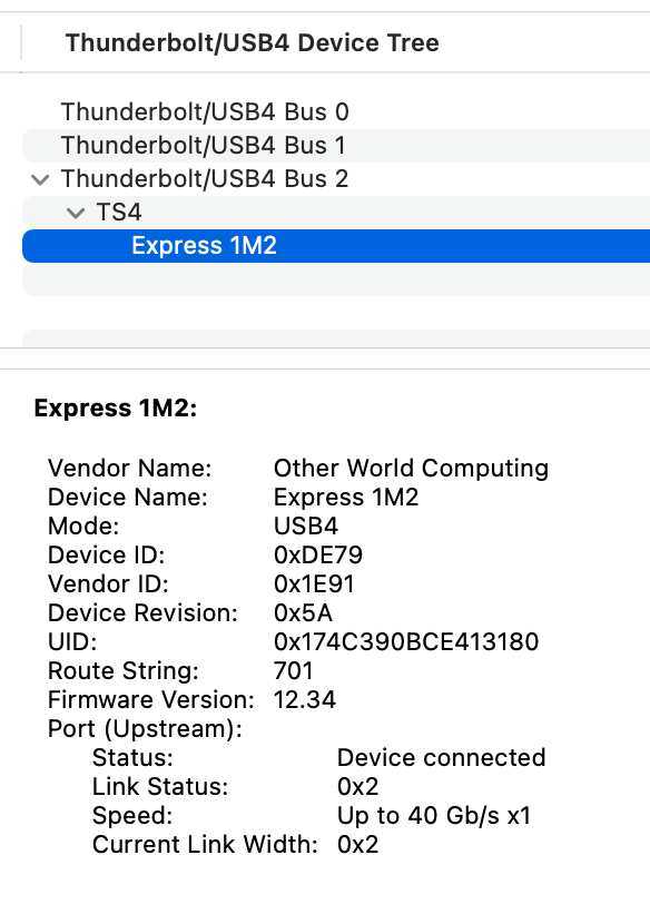

Do both Express 1M2 have the same Thunderbolt and NVMe device IDs and firmware versions?
This is the drive that shows up fine (as TB/USB4) no matter where it's plugged in:
This is what the misbehaving drive shows when it's connected to the TS4:
And here's what that same enclosure shows when I connect it directly to the MBP:
