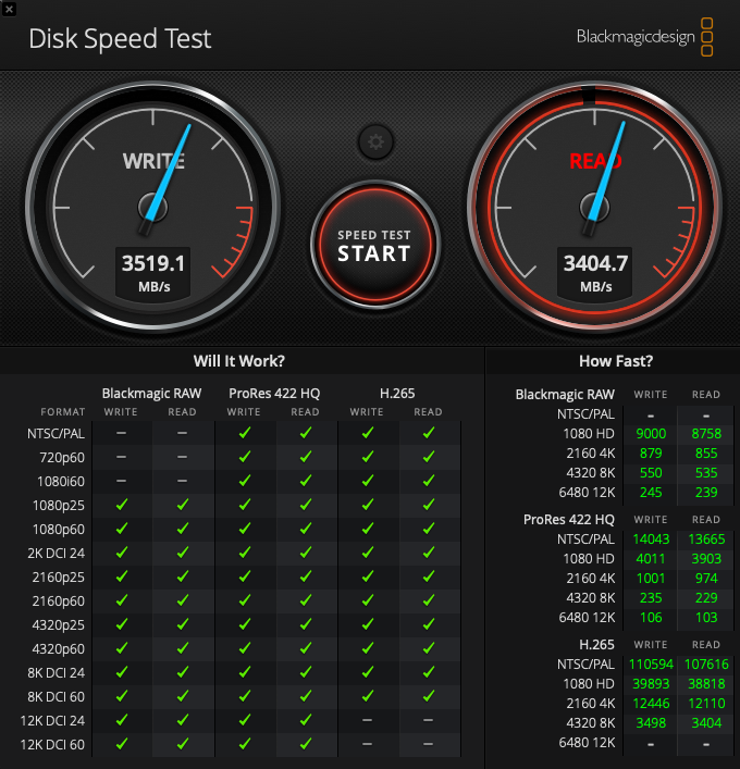

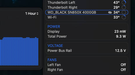

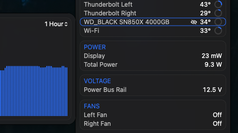

Thanks for everyone's help here. I'm a total newb when it comes to this stuff but with everyone's help I just assembled my first Maiwo k1717 with the WD SN850X 4TB. I left the sticker on the SN850X and used some thermal pads on top from Amazon. I bought istat Menu 7 for my Macbook M4 Pro. I also formatted the WD SN850X using "APFS encrypted" so I'm not sure if that affects performance or not. I connected it directly to my M4 Pro and used the cable that came with the Maiwo. I got the speeds below from Blackmagic.
As for temps, like Specfoto mentioned you can cool it down a bit by setting it on something metal. My initial idle temp was 45 while sitting on a wood desk. Then I pointed a small usb fan on it and it went down to 42. It went up to 48 after running black magic for 8 minutes. Then I put the Maiwo on top of the aluminum base of my old 27" iMac and temps went down to 39. Then I added the fan while sitting on the iMac base and it's down to 34 at idle.
The read/write speeds did not slow down after running for 8 minutes. Please provide feedback on my speed and temps.
Thanks again for all your help. Now I will assemble my 8TB drive and assume it will run similar speeds/temps.
Nice speeds and nice temps. Good work! However, do you really need it to be encrypted? Just curious.
Nice work, although unless it's a backup drive, or being used to store documents or other sensitive information, I'd remove the encryption. Nevertheless, those speeds are typically at the upper end of what you can achieve through the TB3 or USB4 interface, so you won't get much better than that without moving to a higher interface (TB5).
I have also a 4 TB SN850X, but inside an Acasis case and my temps are at around 40 °C. The SN850X is my System Drive. If the SSD does not reach around 70 °C on load (throttling), all is fine. I would say your temps are in the green area.
I don’t really need the encryption, so I can get rid of it if it causes issues. Let me know what the negatives are. Thanks.
I can remove encryption, let me know why it’s not ideal. Thanks.
