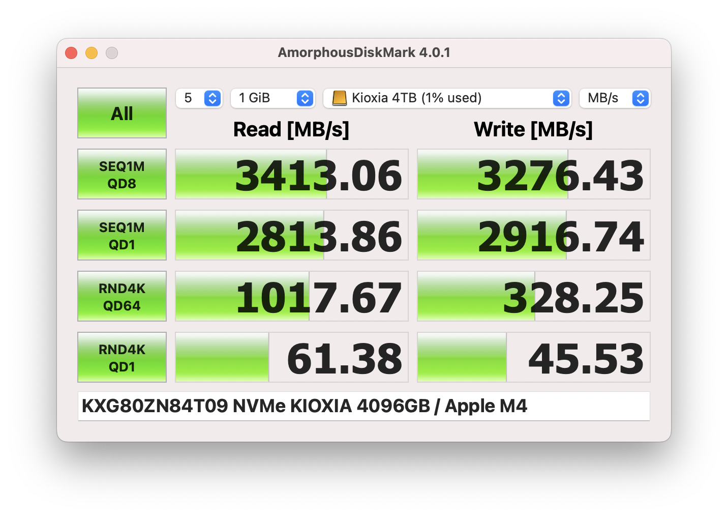

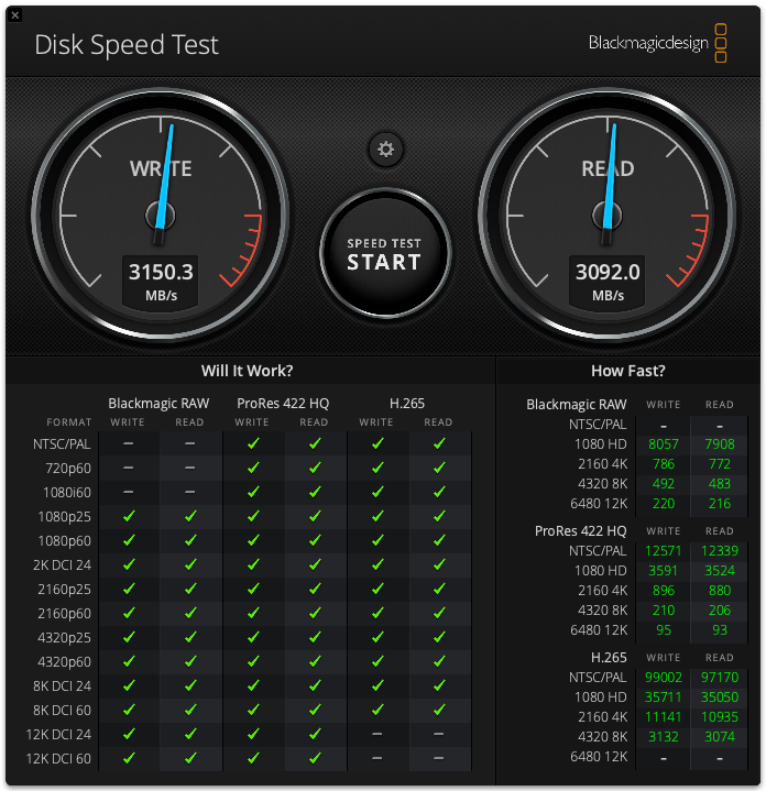

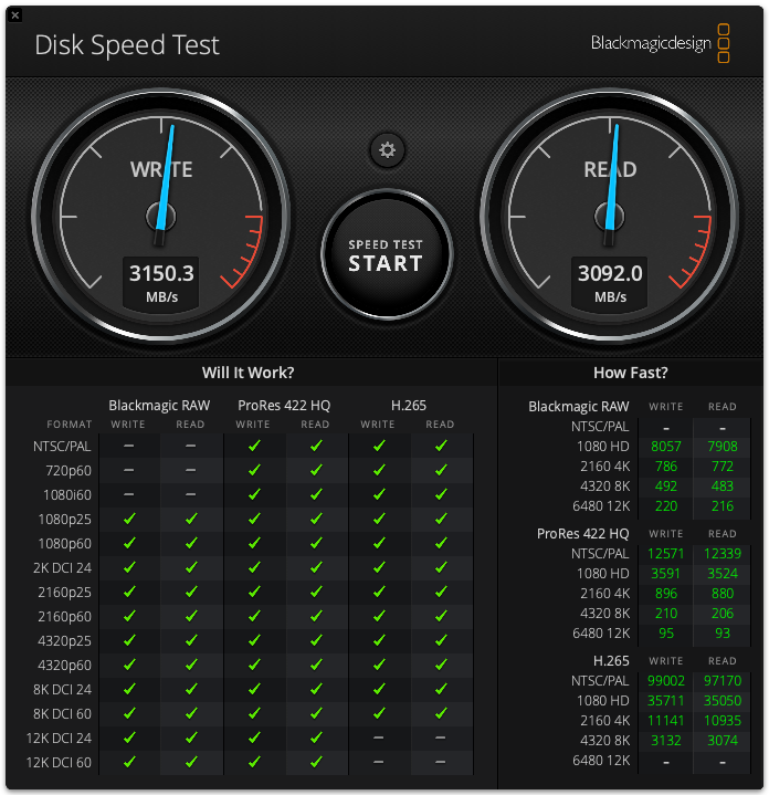

I've bought the Qwiizlab enclosure and I'm waiting for it to arrive. I've been doing a bit of research and it seems the best TB3 performance will be ~2,300 MB/s write and ~2,500 MB/s reads. This was with Blackmagic.

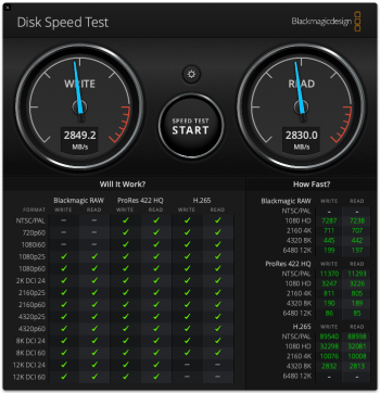

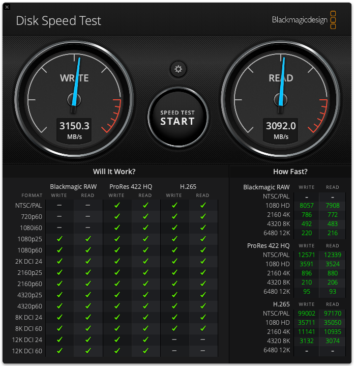

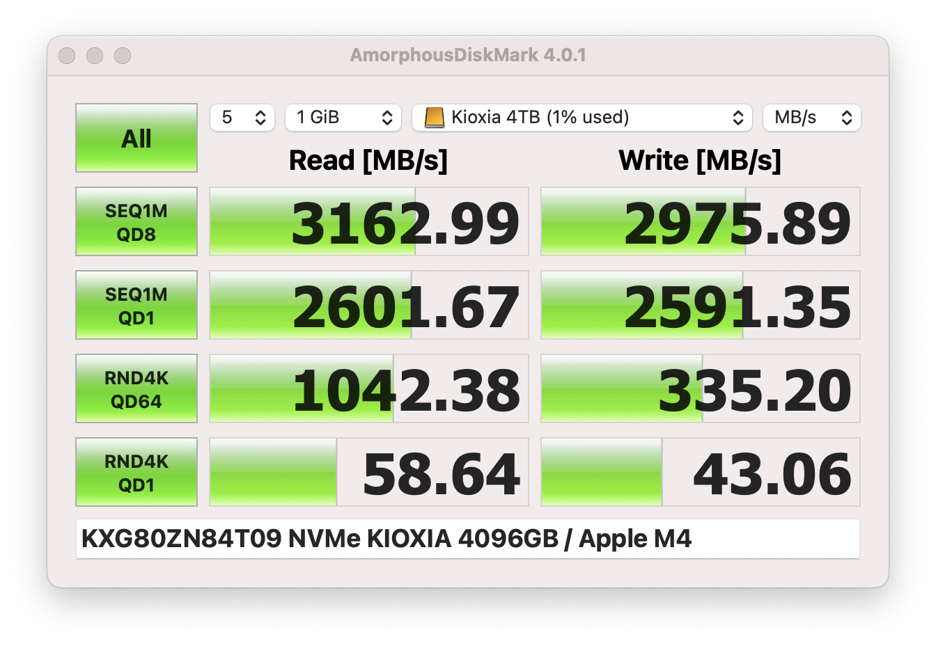

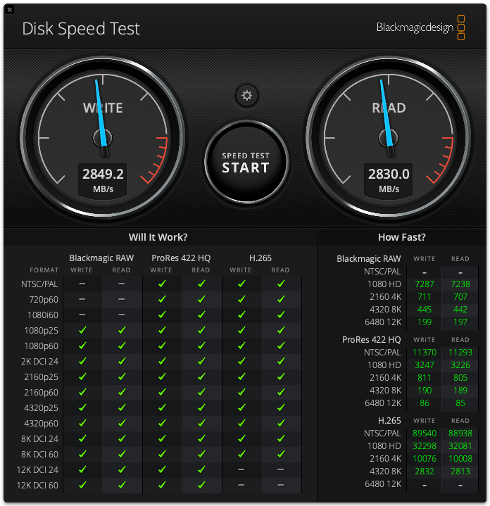

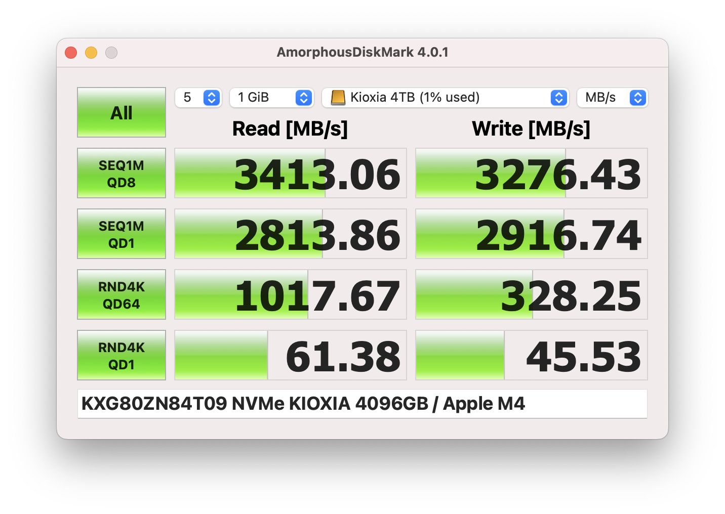

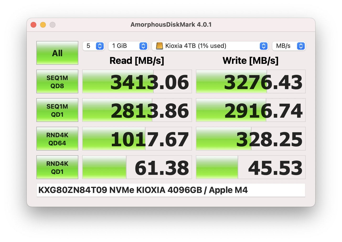

USB 4 - Kioxia XG8 4 TB / Hagibis:
Thunderbolt 3 - Kioxia XG8 4 TB / Hagibis:
