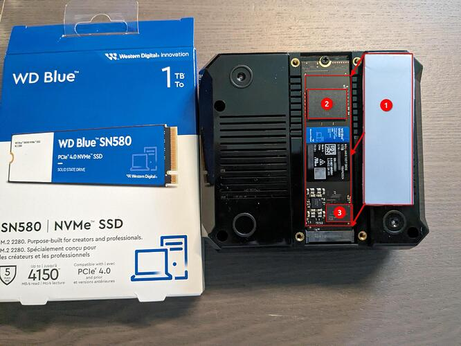

Hi everyone,
I've finally got around to setting up my Qwiizlab and SN580.
I've got a little bit of a surprise. The SN580 doesn't have an entirely level top side. It seems there are a couple of chips sitting on the top. I've read plenty of people on here have used the SN580, so I'm hoping it's not a problem.
I'm getting a bit nervous now I'm at the point where I should be adding the thermal tape. Are these instructions correct? I found them doing a web search (obviously, it's a different enclosure). https://forum.argon40.com/t/wd-sn580-nvme-installation-on-the-one-v3/3004
I've also noticed there will probably be enough space to apply both thermal pads on top of each other, if that's a good idea? I might just start with the thickest pad.
Here are the Qwiizlab instructions:
For the SSD, you only need the thermal pad on the top side of the SSD, but I put it on both the top and bottom, which slows down the temp increase under use. There is an also a thermal pad for the top of the SSD enclosure's controller, and there is already a thermal pad installed on the underside near the controller.
Stacked thermal pads can sometimes work, but when I tried it, it didn't seem to work well. However, I would be surprised if both thermal pads included with the enclosure stacked on top of each other would fit properly in that enclosure without bending the SSD motherboard. I wouldn't do it. When I tried stacking thermal pads, it was with the stock 2.0 mm thermal pad plus an additional third party 0.5 mm thermal pad.

Thanks @EugW. You're right, there is a probably too much thickness with both bits of tape stacked on the top. The thickness of mine are fractionally different, .5mm max. They both look like 2mm to me.
I'm wondering if you looked at the photo in the link I posted? It's not my set-up. Someone else posted it. The bit that's unusual (from what I've seen of other chips) is the top of the NVMe isn't flat - chips visible, making it an uneven surface. I think most NVMes have the chips on the underside? Here's the photo:
The response this guy got was to just put the tape across anyway. I'm not sure whether to trust it.
It's not clear from the photo, but the chips are at either end, so the the thermal tape will sag in the middle. I suppose I could double stack there to level it.
The other thing is this design means when I fasten the NVMe to the case it slopes down from the pin end to the screw end. I guess this is because the chips are on the top side. Maybe another opportunity to add some tape and keep it level?
Don’t worry about the unevenness. Mine aren’t even either. Just use the best fit thermal pad that allows all the areas to touch the surface of the enclosure. It will compress to compensate for the unevenness.
In my case a 2.0 mm thick thermal pad worked fine, but I eventually bought a third party 2.25 mm thermal pad to use instead so that it could provide a bit more compression. (Thermal pads will sometimes work better if there is some compression.)

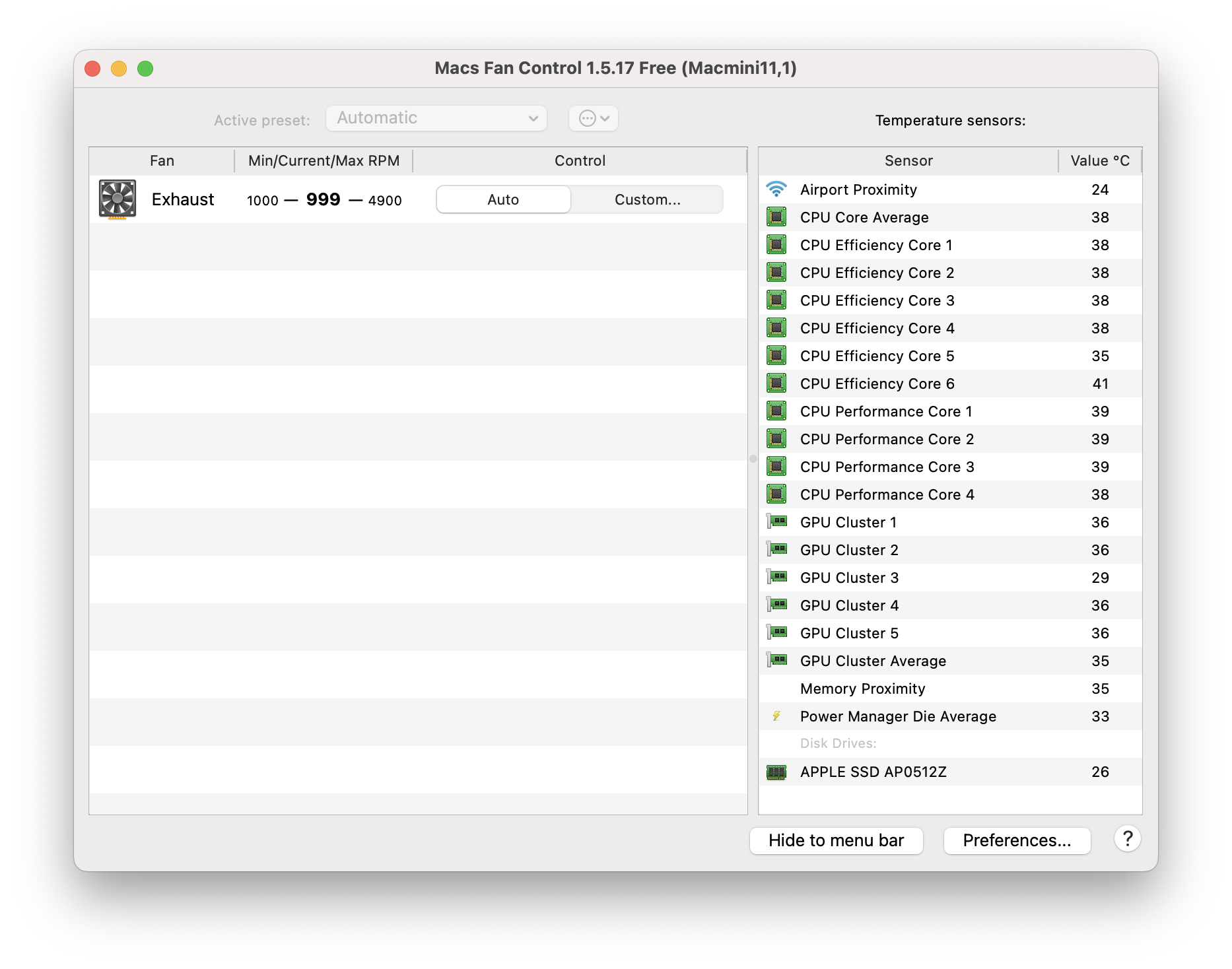

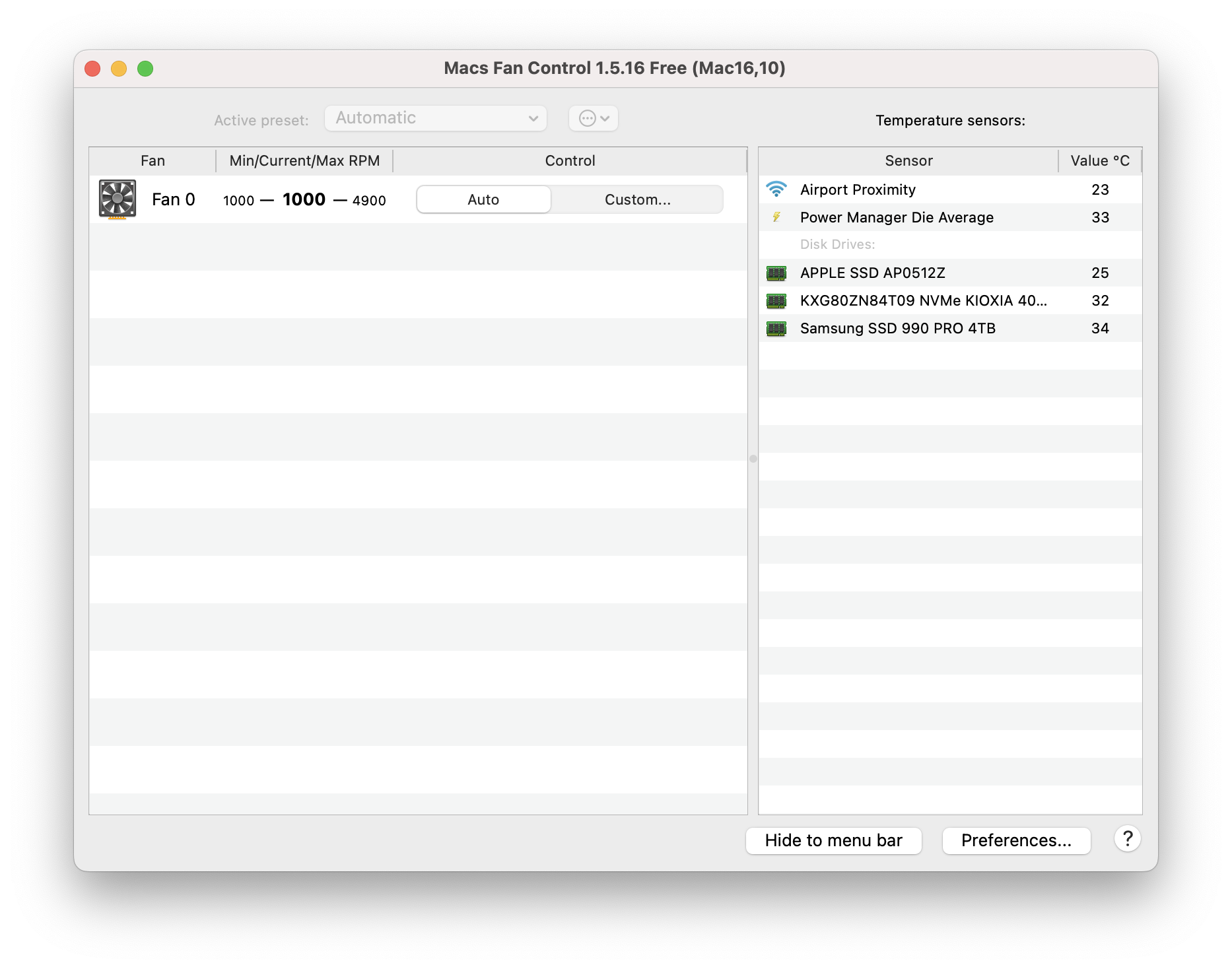

If you're using Macs Fan Control, don't install the latest 1.5.17 if you want to continue to monitor your external Thunderbolt SSDs. It adds CPU temp monitoring support for M3 and M4, but loses external Thunderbolt drive temp monitoring.
1.5.17:
1.5.16:
Actually, right now I have both installed. I just renamed them to include the version number, and both work fine on the same system.
