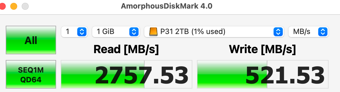

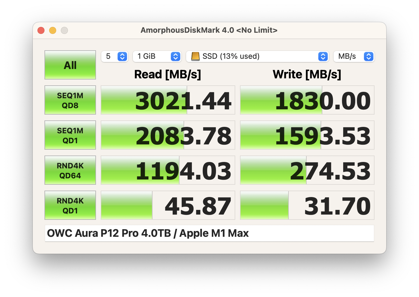

I have the OWC Envoy Pro FX, 4TB version. It manages 2800+ MB/s read, 2200+ MB/s write.
Black Magic seems to have an issue with this drive, as it reports slow read speeds for some reason. Amorphous DiskMark gives consistent high readings though. Using the drive, I think it has no speed problems either - but I fired off an email to OWC asking about this.

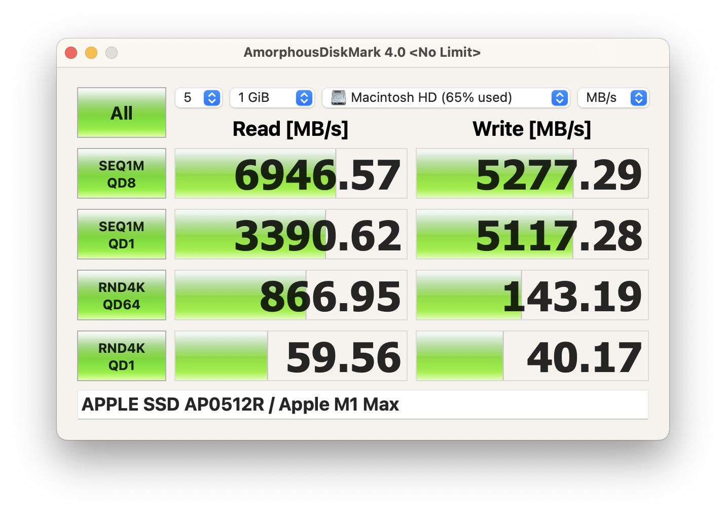

Speed comparison with internal storage:

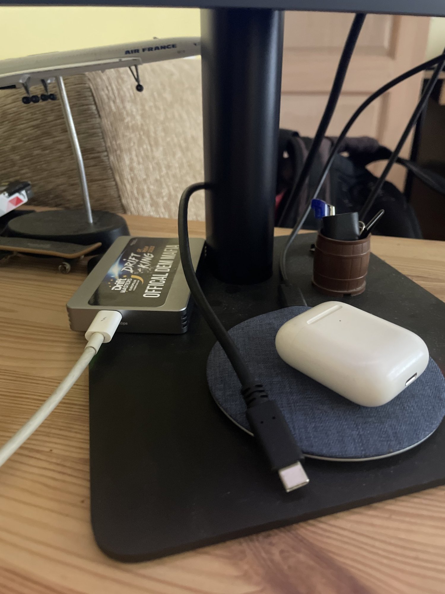

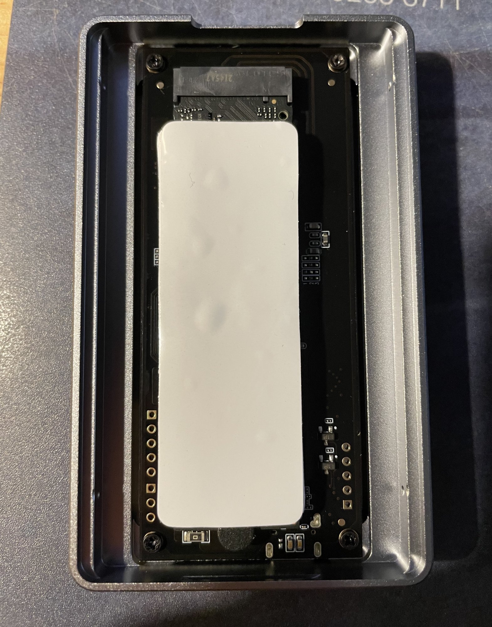

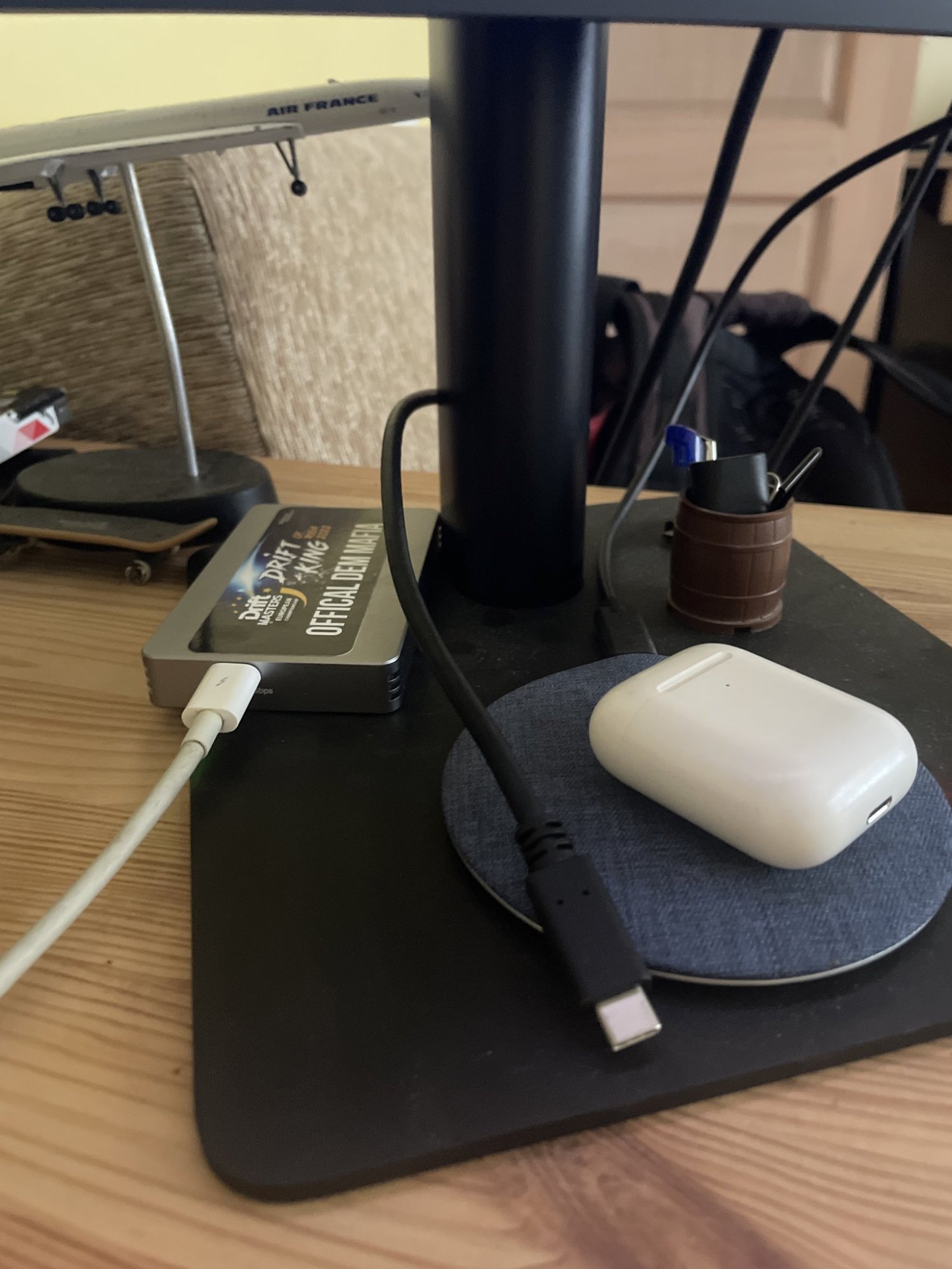

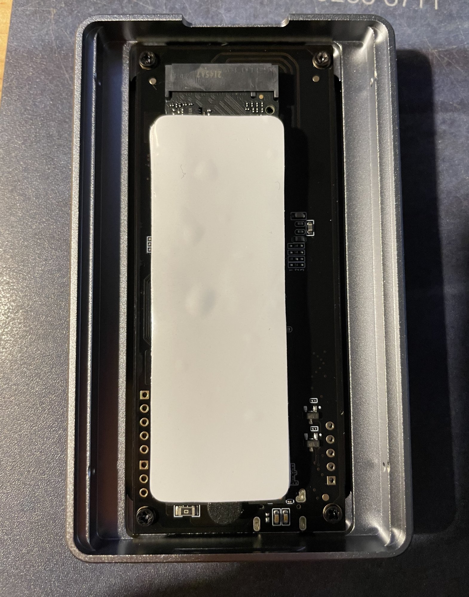

Acasis enclosure comes with 2 thermal pads. I used both to my 2TB Samsung 980 Pro - no overheating. By the way next year will be available 4TB Samsung 990 Pro.

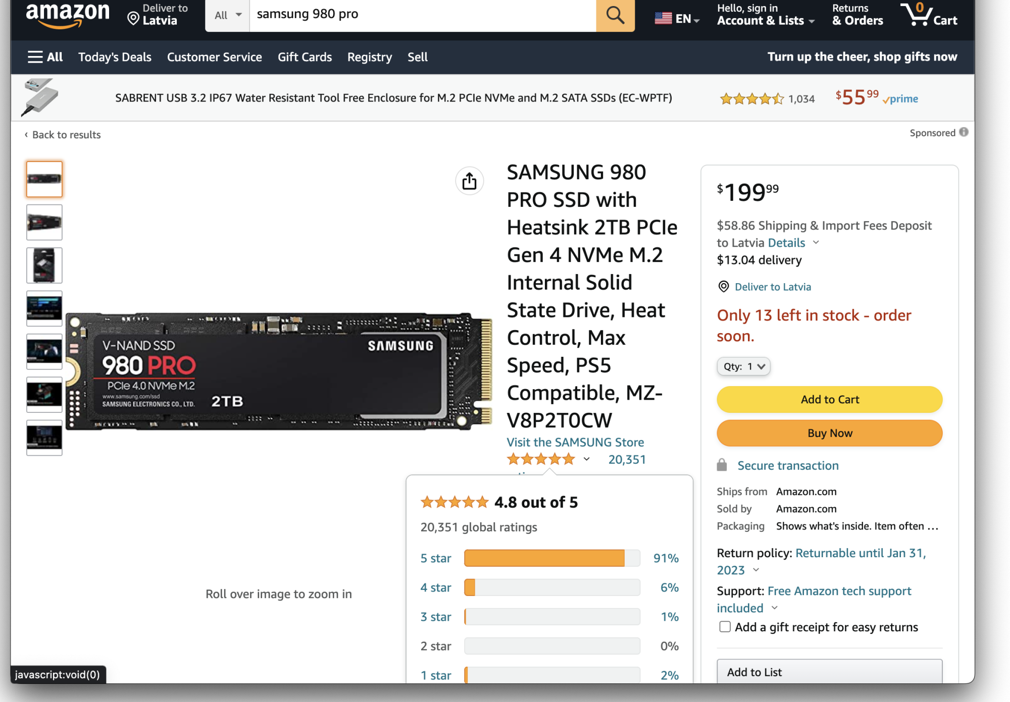

Be careful, there are countless reports of 980 pro's self destructing unexpectedly. Same goes for the 940 Evo Plus, which is the same drive but limited to PCIe 3.0. It seems that many of current gen NVMe SSD's are far from rock solid and prone to failure.
From what planet earth are you from? In this earth no 940 evo. If you mean 970 evo, it is not the same as 980 Pro.
I have never seen or heard of any problems. On the contrary, everyone praises him as one of the more stable SSDs, because he has a overheating temperature is 86 degrees Celsius, and then the writing speed drops to only 1GB/s.
After continuous writing of 1.5TB, he only heats up to 60 degrees Celsius on a wooden table.
For example, when placing the SSD on the legs of the LG 4K 23.7 Thunderbolt monitor, the maximum temperature is 52 degrees Celsius after 1,7TB continuous write with speed 1,6-1,8 GB/s.

Quick follow-up. I went last month with the Acasis M.2 SSD NVMe Enclosure and the Hynix P31 Gold as a previous poster suggested. Plenty fast as the Thunderbolt bus appears saturated, and no fear of overheating as the enclosure gets warm and not really hot. Haven't put it through severe video editing stress tests, but it's more than what I likely need. Also set up an OWC ThunderBay 8 unit for my spinning rust. Going to edit on the M.2 with the Mac Studio, and store (with backup drives) on the ThunderBay. Thanks to everyone who has responded.

Still dont understand wher you get bad reportings sudden. Show a prof! 🤭🕵🏻‍♂️
Based on Amazon rating (more than 20k) it get 4,8 from 5 stars. And if read 3 star reviews people crying about long shipping, for screws not included for PC motherboards 🤭😂😂, overpriced, about how MS Office opens up so long, as if he is ever opened up fast... 🤭🤣
I was initially concerned with looking at the most recent reviews, where there were too many users calling out failing drives. From there I did some more research
Even a great product can have design issues irrespective of previous performance expectations. There have been others in this thread discussing sudden performance drops with current Gen Samsung NVME SSD's
I've tried 2 Hynix P31 SSD's in my Mac Studio using multiple interfaces and both cannot achieve more than 520 MB/S write speeds. Can you please confirm the performance you are seeing with your setup in Amorphous Disk mark?
I've tested on multiple hardware configurations:
MacOS Ventura 13.1 on a Mac Studio Ultra.
TB4 -> Sonnet Breakaway Box -> Highpoint 7107a -> Hynix P3 Gold
TB4 -> Acasis TB4 NVMe SSD interface -> Hynix P3 Gold
