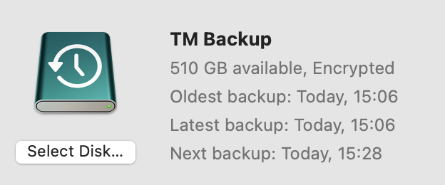

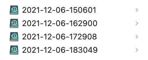

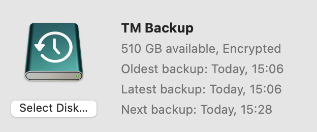

WORKED! Just completed my first backup in a month and I didn't use safe mode. Just excluded this.
How the correctly wrapped backup log should look like:
Code:
2021-12-06 15:06:00  Finished copying from volume "Macintosh HD - Data"
2021-12-06 15:06:01  .•••+••+++••.
2021-12-06 15:06:01  Time Estimates Evaluation
2021-12-06 15:06:01  Unmounted '/Volumes/com.apple.TimeMachine.localsnapshots/Backups.backupdb/ Vancoder MacBook Pro M1/2021-12-06-134747/Macintosh HD - Data'
2021-12-06 15:06:01  Unmounted local snapshot: com.apple.TimeMachine.2021-12-06-134747.local at path: /Volumes/com.apple.TimeMachine.localsnapshots/Backups.backupdb/ Vancoder MacBook Pro M1/2021-12-06-134747/Macintosh HD - Data source: Macintosh HD - Data
2021-12-06 15:06:01  Marked as reference snapshot: com.apple.TimeMachine.2021-12-06-134747.local
2021-12-06 15:06:01  Backup result: {
2021-12-06 15:06:01  Creating APFS snapshot com.apple.TimeMachine.2021-12-06-150601.backup
2021-12-06 15:06:02  1 backups: 2021-12-06 23:06:01 +0000 (1hr) MΔ: 493.79 GB
2021-12-06 15:06:02  Completed backup: 2021-12-06-150601.backup
2021-12-06 15:06:02  Mountpoint '/Volumes/TM Backup 1' is still valid
2021-12-06 15:06:02  Found backup "2021-12-06-150601"
2021-12-06 15:06:14  Starting session for '/Volumes/TM Backup 1' with options: 4
2021-12-06 15:06:14  Accepted a new connection from 'Finder' for service com.apple.backupd.session.xpc
2021-12-06 15:06:14  Session requested for Time Machine volume '/Volumes/TM Backup 1'
2021-12-06 15:06:14  Session prepared 0 backups (1 cached dates) for file:///Volumes/TM%20Backup%201/ (APFSMachineStore)
2021-12-06 15:06:14  Prepared 0 backups!
2021-12-06 15:06:14  Found backup "2021-12-06-150601"
2021-12-06 15:06:17  Accepted a new connection from 'Finder' for service com.apple.backupd.session.xpc
2021-12-06 15:06:17  Mounted backup "2021-12-06-150601"
2021-12-06 15:06:17  Mounted '/Volumes/.timemachine/121C0BC3-C708-4CA3-894D-68A4E42B21CD/2021-12-06-150601.backup/2021-12-06-150601.backup'

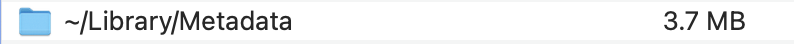

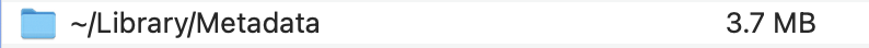

I wonder if simply deleting ~/Library/Metadata would help? It's a user folder, not system, and it looks like it's spotlight related based on what i saw in mine. Maybe something in that folder is getting corrupted, and a simple recreation of the folder and files would help. Only speculating here, since I haven't had problems with it personally.

I should have kept up better, I was making that suggestion based on thinking you were getting permissions errors since many of the reports of failed backups included various permission errors. Now that you mention it, the Arch problems sound more likely.
Yeah, "Failed to acquire device lock assertion" message was triggered by this Code=22 "Invalid argument" error from many places for me, and this is just a part I copied, there were much more:
