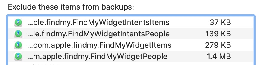

Just another report of what finally worked -- I'm on a new M1 Macbook Air Monterey (12.0) trying to make an initial Time Machine backup that always failed right at the end, finally found this thread, tried Safe Mode (didn't fix it), but finally checked the logs using:
log show --style syslog --last 30m --predicate 'senderImagePath contains[cd] "TimeMachine"' --info --debug
Which showed lots of "FindMyWidget..." errors at the end, and so added all 4 directories starting with ~/Library/Containers/FindMyWidget... to the exclusion list, and now Time Machine works like a charm.

Excluding FindMy folders has fixed the issue for me.

The FindMy fix worked for me twice.... Which I mentioned in this thread a few pages back...
