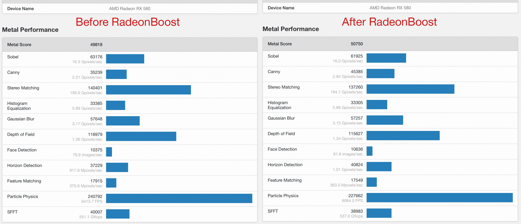

lol. My bad. Thanks again for recommending the changes! Thats weird your getting those scores. I am getting 90320 on geekbench 5 metal

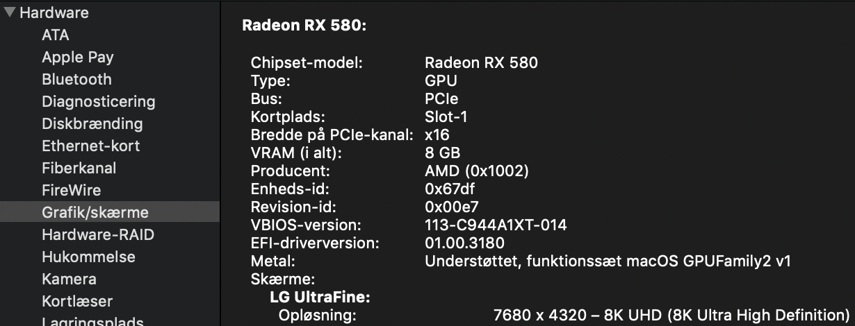

Non-OC data point:
* MP3,1 running Catalina, SIP disabled
* RX570 (same device-id as RX580, 0x67df)
* RadeonBoost linked into kernel (in /L/E)
The only difference RadeonBoost.kext seems to make is that the GPU fan hits 100% for about 5-10 seconds during mid-boot (remains slow/silent without the kext), which suggests that the kext is doing something. Various benchmarks were identical with/without the kext, and there is no noticeable difference in normal usage.
(EDIT: I do see the VBIOS Version and EFI Driver Version in System Information, so the kext is definitely being loaded.)
Do you think this is due to lack of explicit support for RX570, or something else? In every other context I've tested, the RX570 is functionally identical to the RX580, just slower.
I suppose it's the other way around, the optimisation for Polaris GPU is already very good, or nothing is locked. Therefore, you can't see the improvement.

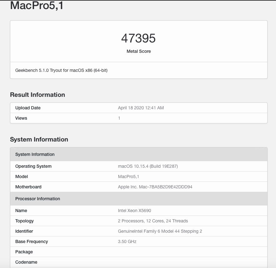

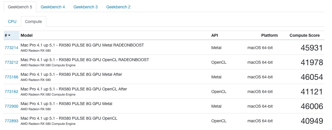

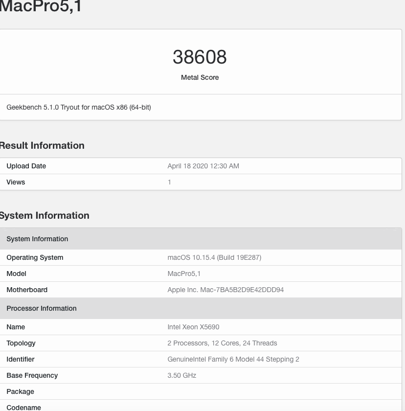

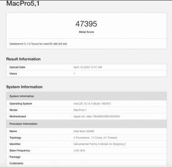

I just tested this on my cMP 5.1 / RX 580. But the speed increase is not as impressive as I was expecting from what I have seen posted here. As a matter of fact some test appear to be slower. I believe the kext is correctly installed and activated through OpenCore as I see the added lines in the System report:
But as the GeekBench results show, the speed up is not fantastic:
Am I doing something wrong?
Reactions: leoaf79
I just tested this on my cMP 5.1 / RX 580. But the speed increase is not as impressive as I was expecting from what I have seen posted here. As amateur of fact some test appear to be slower. I believe the kext is correctly installed and activated through OpenCore as I see the added lines in the System report:
But as the GeekBench results show the speed up is not fantastic:
I believe the optimisation for RX580 (or Polaris) was pretty good already (even without this kext), therefore, can't see any noticeable improvement.

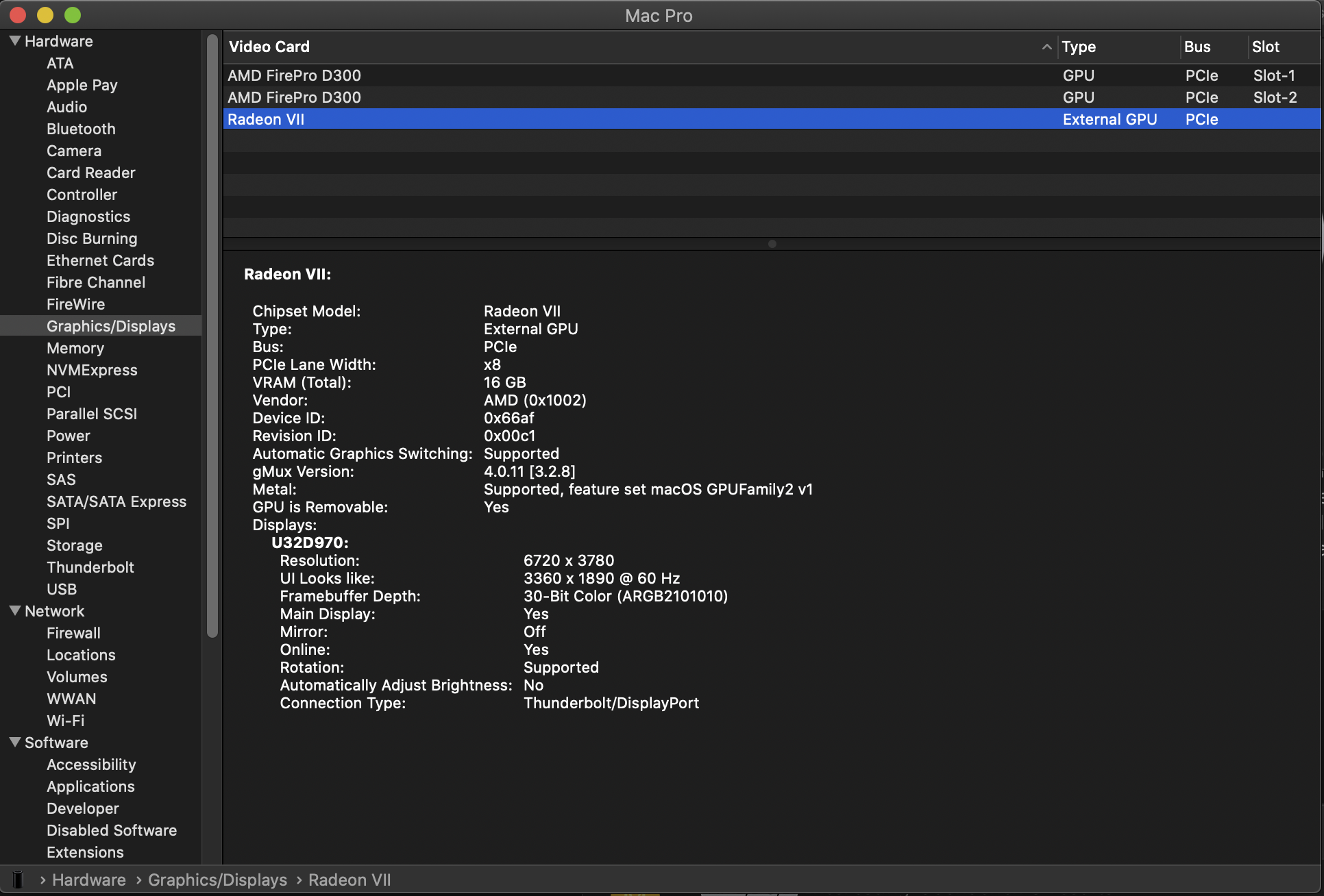

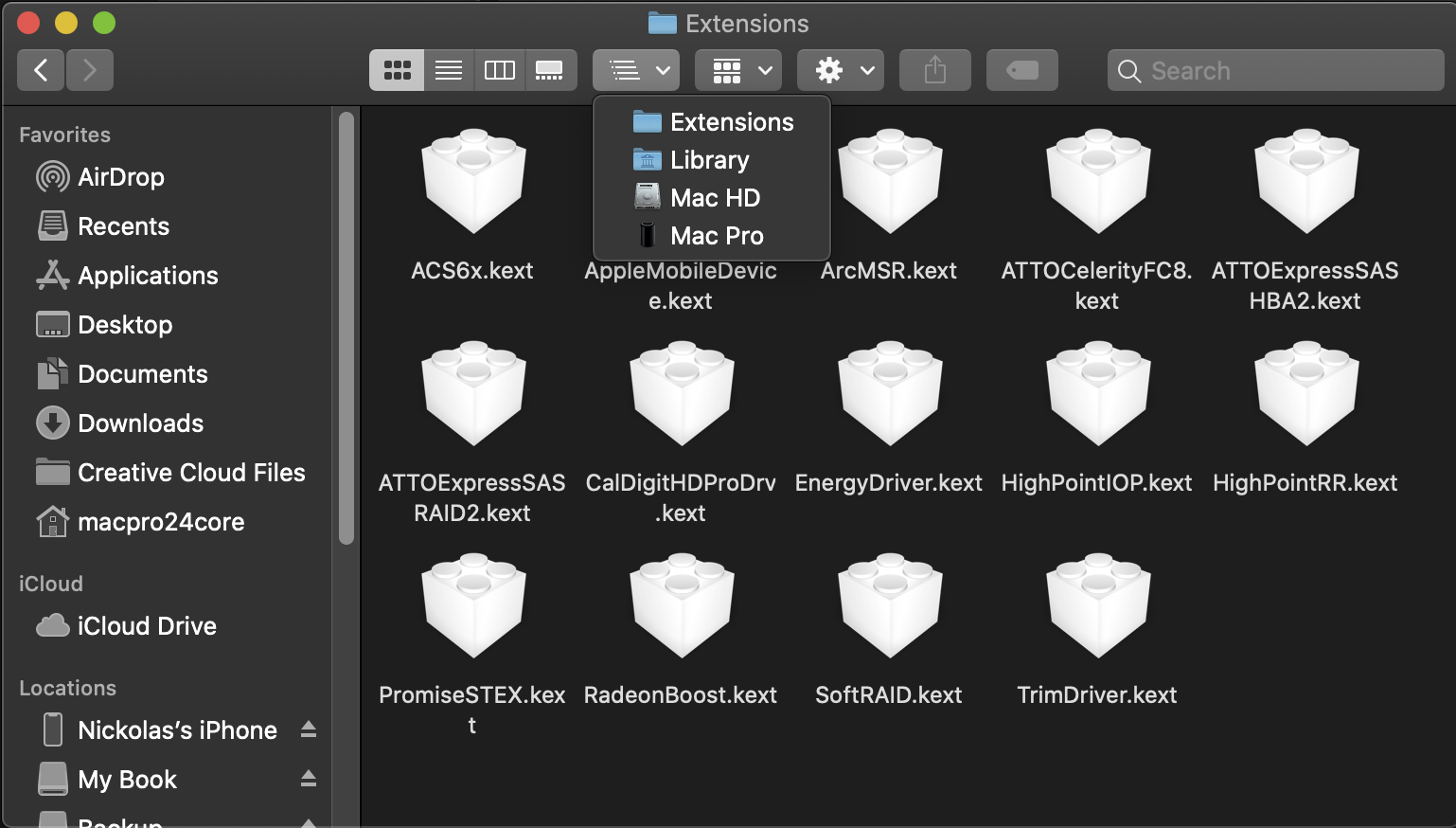

Ok... So It looks like I need some help. I've tried step by step several times to no avail. Mac Pro 6,1 with Radeon VII in eGPU. I do not get any errors and everything seems right as rain. I reboot and nothing is different. RadeonBoost is not listed when running kextstat. SIP is disabled and I know all is well with that because I just did a fresh install and loaded PureWrangler right before this. I know there was some question as to whether this would work with an eGPU or not and perhaps that is the issue. Any help is greatly appreciated.

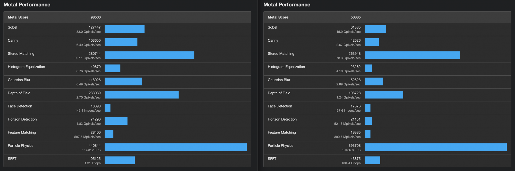

Ok, weird I see the 14K drop but certain sub scores are way better while others are far worse.
I also had constant fan noise after it revved up, like other users have mentioned with VEGA 10.
This is the detail scores comparison from my Radeon VII.
Apparently Something like Sobel can benefit from this kext a lot. But Stereo Matching perform pretty much the same.
And NO, this kext shouldn't infringe the PowerPlay kext for downvolting. I checked that on my cMP.
The Sobel performance is much worse on VEGA 10 with RadeonBoost.kext.
2.03 Gpixels/sec versus 13.4Gpixels/sec.
As well as Depth of field.
124.8 Mpixels/sec versus 1.73 Gpixels/sec.
