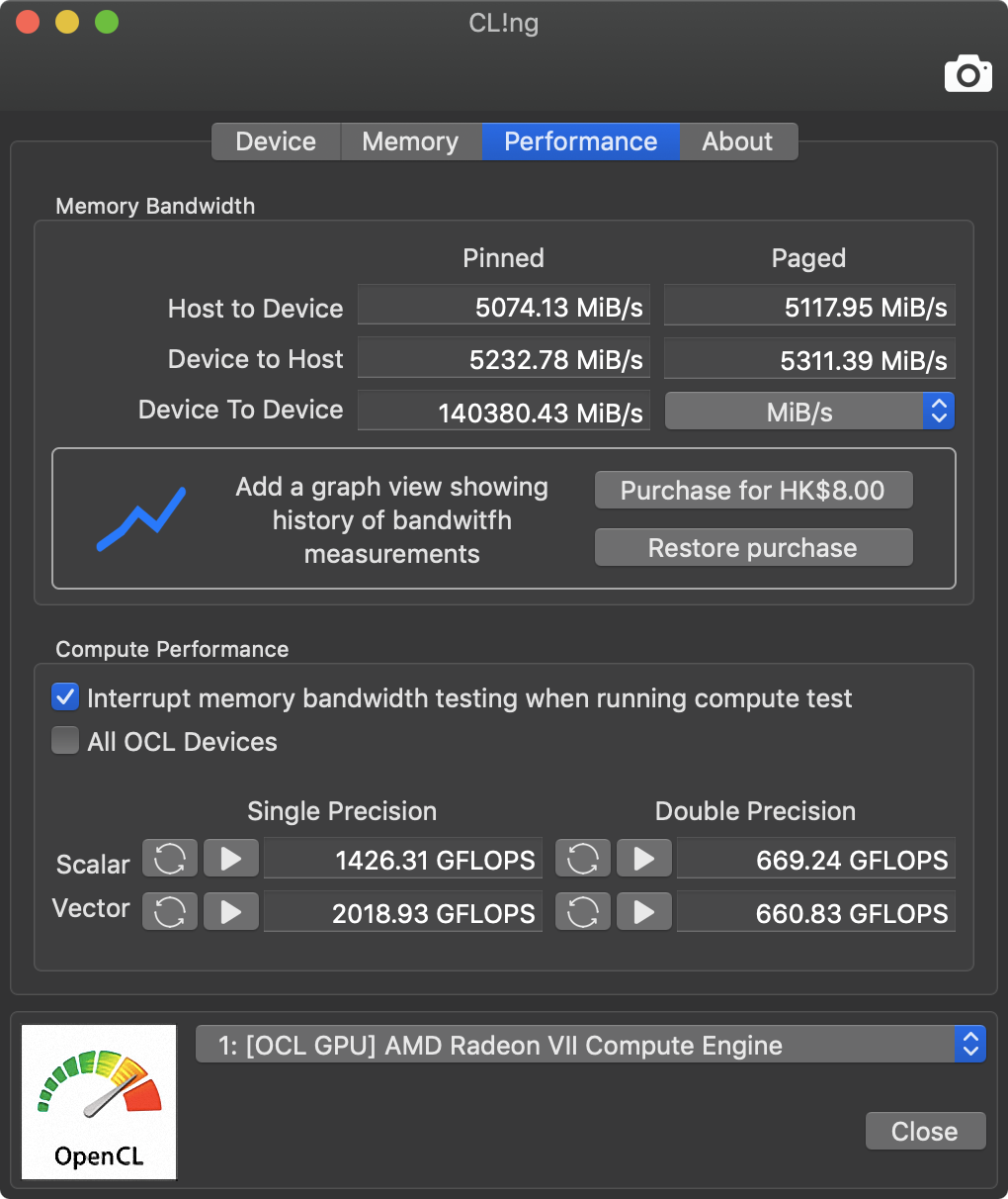

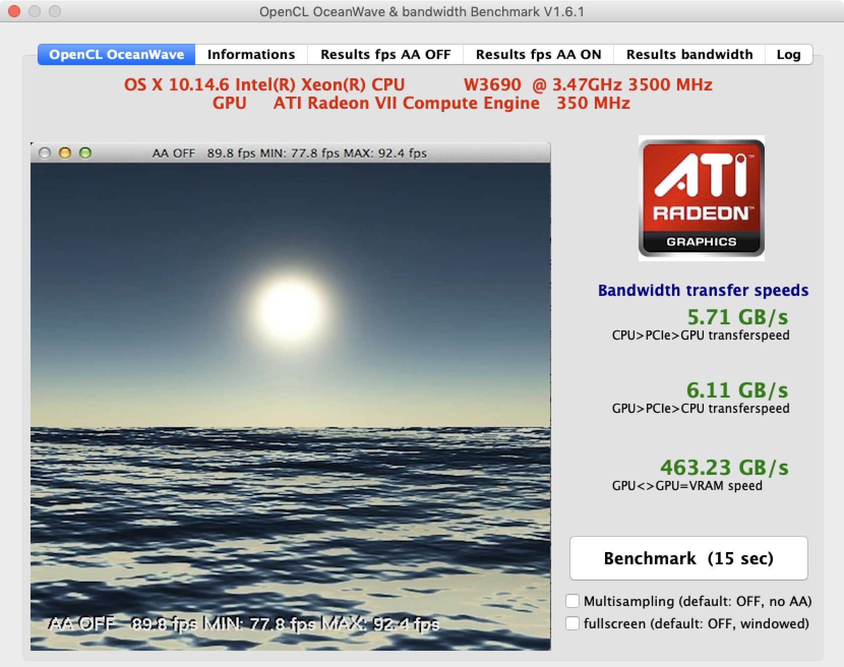

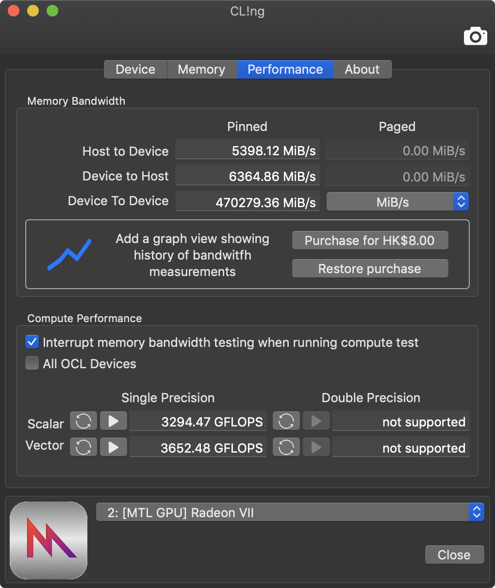

Just found one of the fundamental difference after applying RadeonBoost. It's the Device to Device memory bandwidth.
This may explain why Vega (including Radeon VII) benefit from this kext more than Polaris etc (because the of HBM)
Without Radeon Boost
With Radeon Boost
I tested this a few times. Consistent result.
In fact, when I ran those Compute Performance tests, that Device to Device Memory Bandwidth can go even higher with Radeon Boost.
If the HBM's performance was artificially locked. That of course can cause some performance degradation for certain usages.
Not sure if this is one of the main difference. But if it is, this can explain why some usages / benchmarks that are not memory bandwidth sensitive (device to device) show no benefit from this kext.

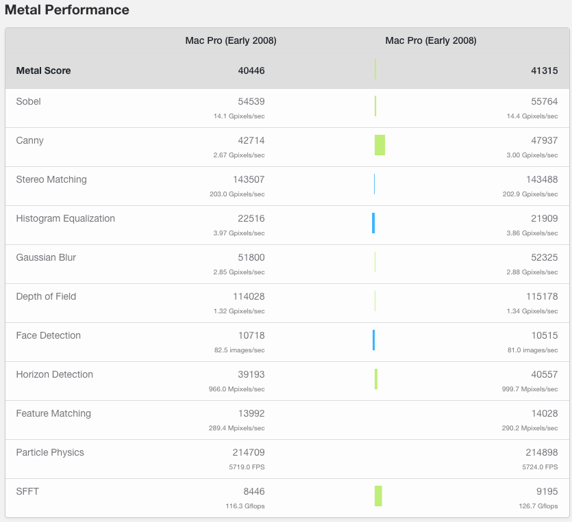

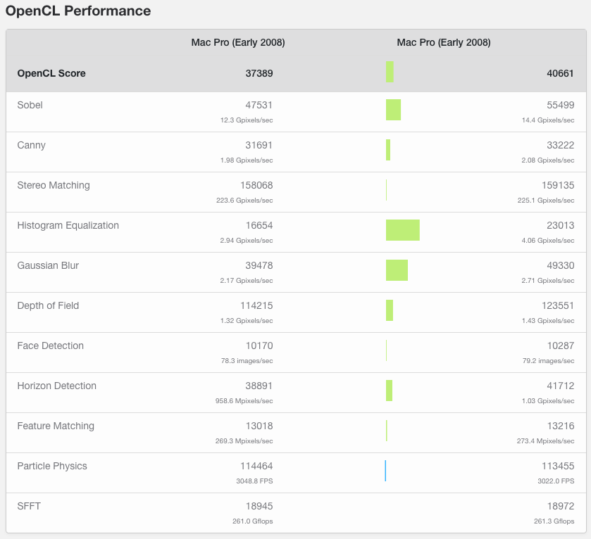

So a few things changed between benches ... but still the same version of macOS and the same hardware.
Updated to a newer beta SSE4.2 emulator from @Syncretic
Added RadeonBoost
Updated WEG/Lilu versions
RX580 4Gb Pulse on the cMP 3,1
GB5 scores:
Metal Before 40,845
Metal After 48,462
OpenCL Before 38,830
OpenCL After 43,246
Moved to version 1.3 and stats are slightly better, metal is now just over 50k
(ignore that my cMP3,1 has an identity of vmware7,1 and the iMacPro1,1 board... the board ID is for AMD accel and the model type i was doing some testing with a long time ago and never changed it)
Metal:
OpenCL:
