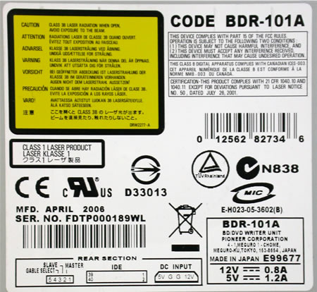

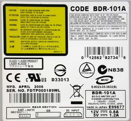

BTW i know some people have blu-ray drivers on their superdrive slot. so I'm also guessing that your DVR-104 and the blu-ray drivers volt and amp requirements don't fit. Yet they too work.
See the pic. Seems BluRay is pretty much same as DVR-104
I just can't picture Apple putting robust power connections in for such a minimal draw.
