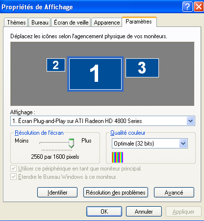

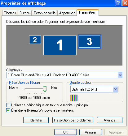

Hi Altimeter88,
If this could help you (mainly points 3 and 4):
In order to test Sapphire 4890 New Edition (NE) outputs, i wanted to be sure that they were running on XP, instead to remove again the GPU from MP, installed it on PC and reverse, i've installed Bootcamp (3) and XP.
XP alone can't be installed with Bootcamp (minimum required is XP SP2).
1 - Fortunately i found a tutorial (in french) "how to integrate SP3 within XP and make a bootable cd" http://www.tutoriaux-excalibur.com/integrer-sp3-xp.htm, this tutorial is using nLite (http://www.nliteos.com/index.html).
2 - After XP installation and reboot, BootCamp XP was not using NE, 30" ACD connected to NE DVI was black, only NVidia 7300 GT was working on 20" ACD.
3 - With 20" ACD connected to NVidia, i did install Catalyst 9.10 http://www.sapphiretech.com/presentation/downloads/download_index_01.aspx?psn=0006
and open Catalyst Center,
4 - With the help of Catalyst Center, XP was running 4890 NE with a 30" ACD attached to DVI and 20" ACD to HDMI / DVI adaptor.
5 - DP to be tested may be tomorrow on OS X and XP (DP / DVI adaptor not yet received).
6 - Keyboard is apple alu wired cable and mouse is bluetooth Mighty Mouse 4 buttons.
7 - Mighty Mouse was not working, i've been obliged to connect an USB one.
8 - The problem for the mouse IMHO is that XP didn't scan for bluetooth equipment, i've opened Config Panel, Bluetooth, asked XP to be detectable, Mighty Mouse was detected, paired and is working very well.
9 - I'll try again with Magic Mouse if she likes to visit my house a day, shipped on 28th Oct, not yet arrived, she has, may be, crossed Oil Can Harry's path …

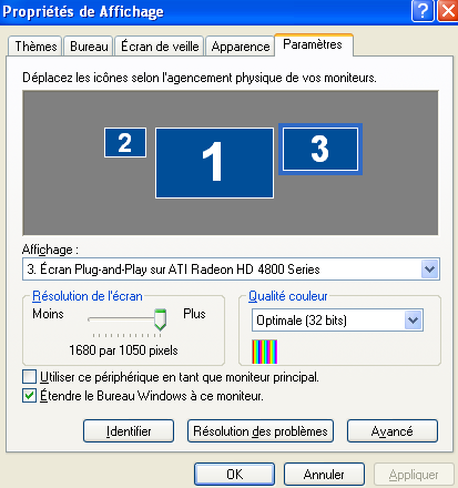

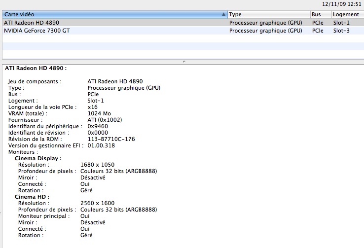

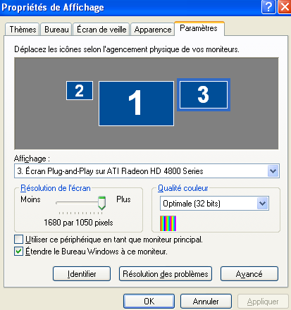

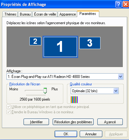

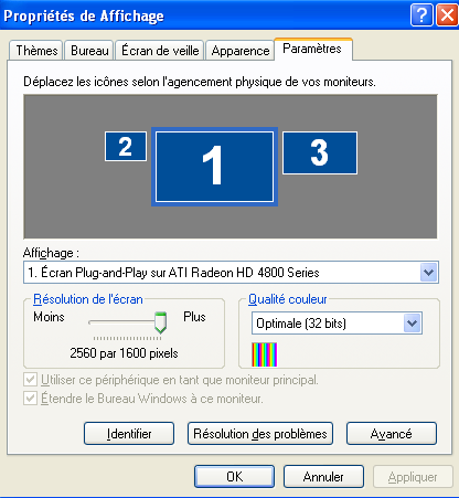

Update to point 5 of post #1273:
OS X part works well:
I've just received http://www.indipc.fr/connectique,ada...9-4487.fr.html , unpacked it, plugged it in DP port, 30" ACD works on DVI and 20" ACD on DP with the help of adaptor,
BootCamp XP part works as well
and voilà:
