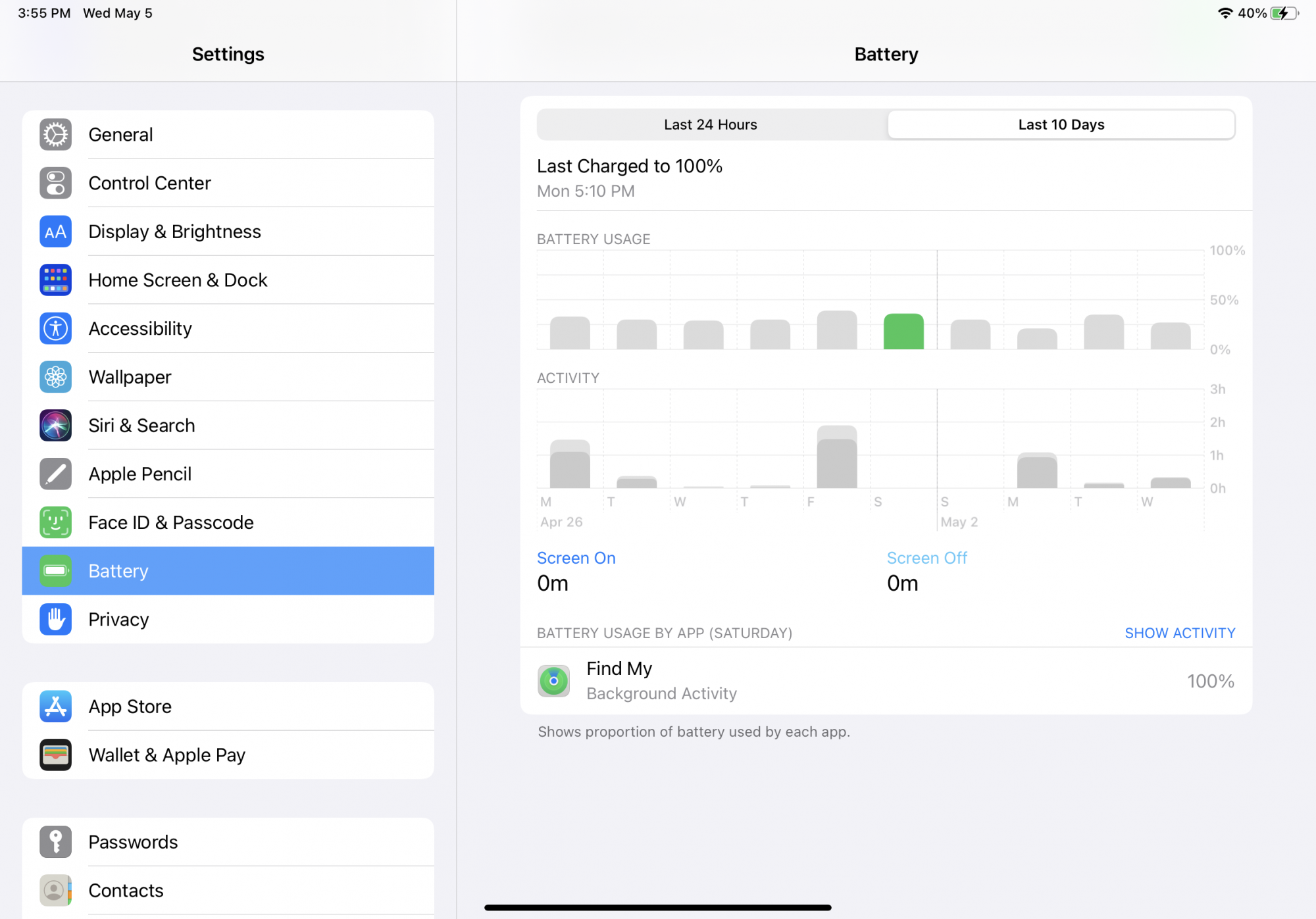

Curious to see if anyone experienced unusual battery drain after setting up AirTag. I am seeing "Find My Background Activity" on the top battery usage for the past few days on all my iCloud devices.
This starts from last Friday when I set up the AirTag and is still happening after multiple restarts & 14.5.1 update. Removed the AirTag from my account for ~1 hour now, and the "Find My background activities" across my devices seems gone.
For example, "Find My" is using over 50% of iPad battery in two days that I haven't touch it:
