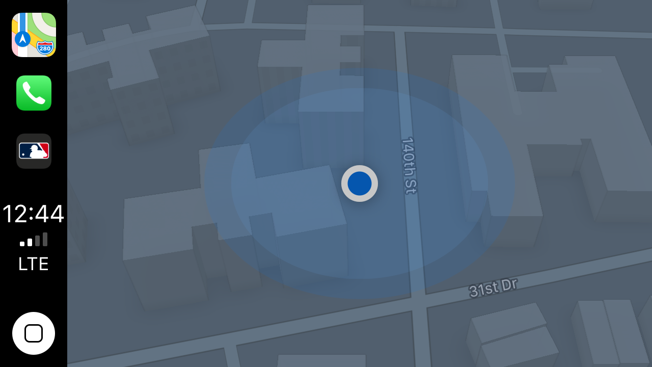

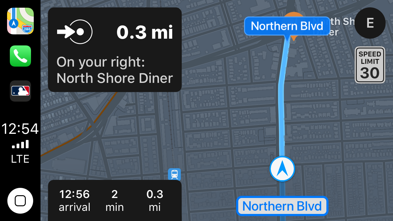

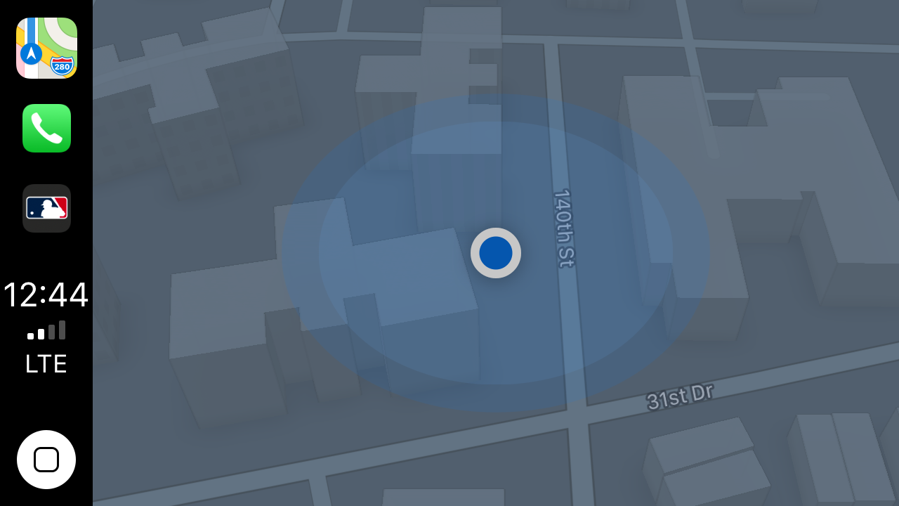

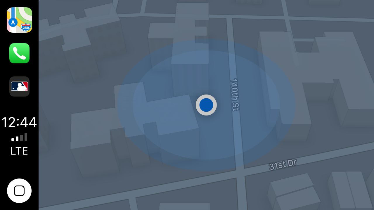

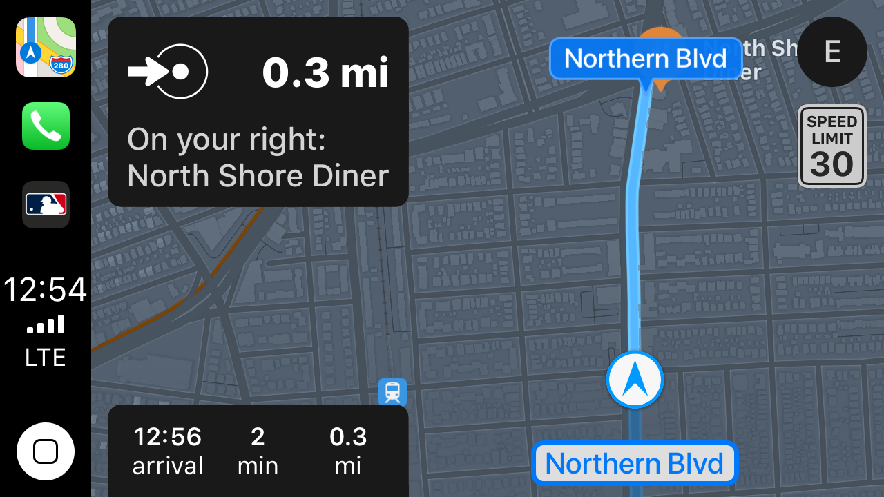

When I saw my location signal had stabilized while at home, I thought things were back to normal. But when I went out for a late drive to dinner, the same problems were occurring. Upon loading Apple Maps in Apple CarPlay, I would be a non-specific circle floating about. Driving around without navigating to a specific location, Apple seemed to have trouble tracking my position. If I were to stop at an intersection for a bit, I would turn into a circle again. If navigating, it had a better idea of where I was going, perhaps because it was expecting me to follow the prescribed route.

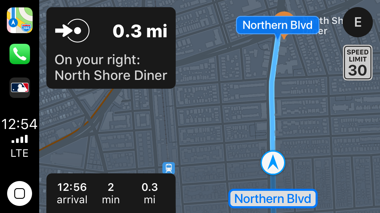

While I was driving, all road labels vanished for a while, just like what happened a few months ago. This leads me to believe that Apple is definitely doing *something* this weekend which is affecting overall performance. Especially since it's already been confirmed that certain people who received the Northeast update have now lost it.
Below: I'm not even at that corner. But Apple thinks I floated over there.
Below: All road labels (white bubbles) vanished for the last few minutes of this trip. The blue Northern Blvd up top shouldn't be there either, as I'm already on Northern Boulevard. This is a common symptom of when something is up behind the scenes at Apple.
The road labels returned for my drive home, but once out of navigation mode, I became floaty again.
Below: I'm not even at that corner. But Apple thinks I floated over there.View attachment 853515
Below: All road labels (white bubbles) vanished for the last few minutes of this trip. The blue Northern Blvd up top shouldn't be there either, as I'm already on Northern Boulevard. This is a common symptom of when something is up behind the scenes at Apple.View attachment 853516

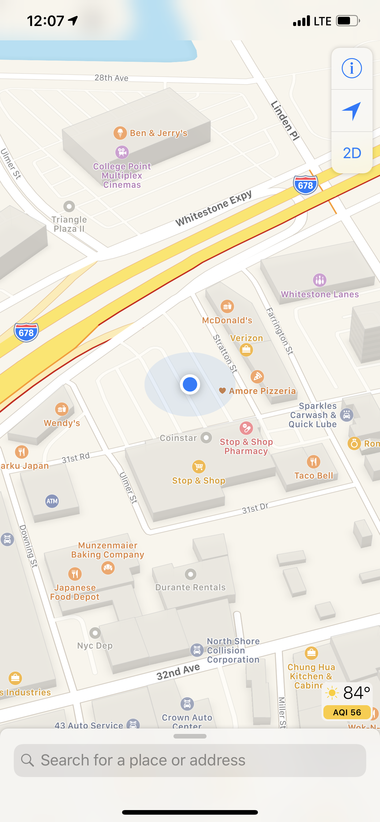

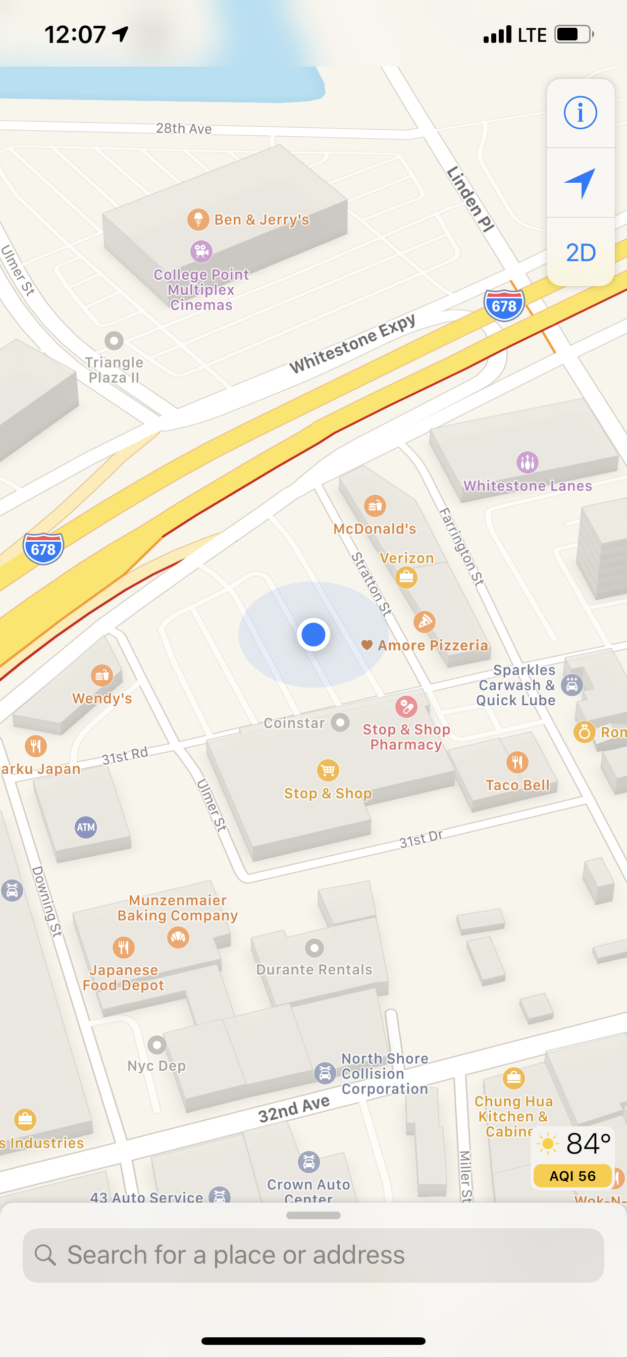

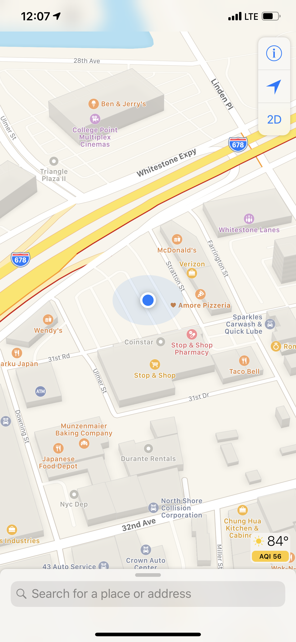

Here's what things looked like getting into my car in a large, open parking lot. Apple Maps had a vague idea of where I was, but no idea which way I was facing. So I was just a large circle. At this moment, my compass *was* correct.

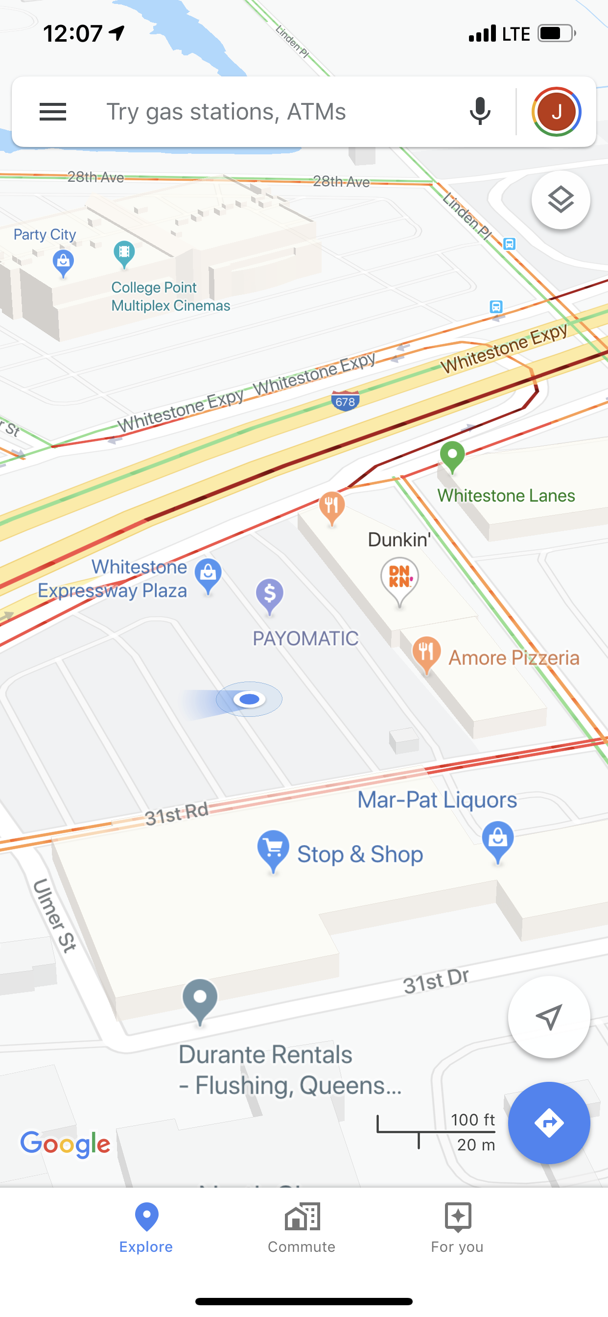

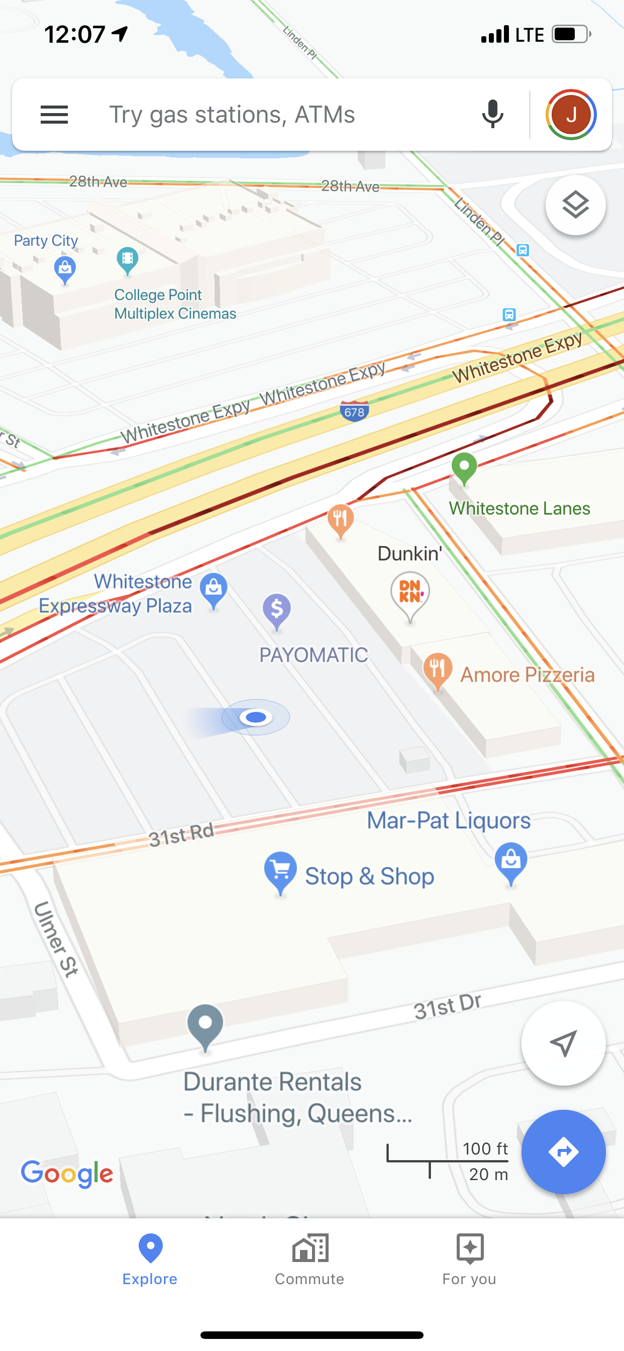

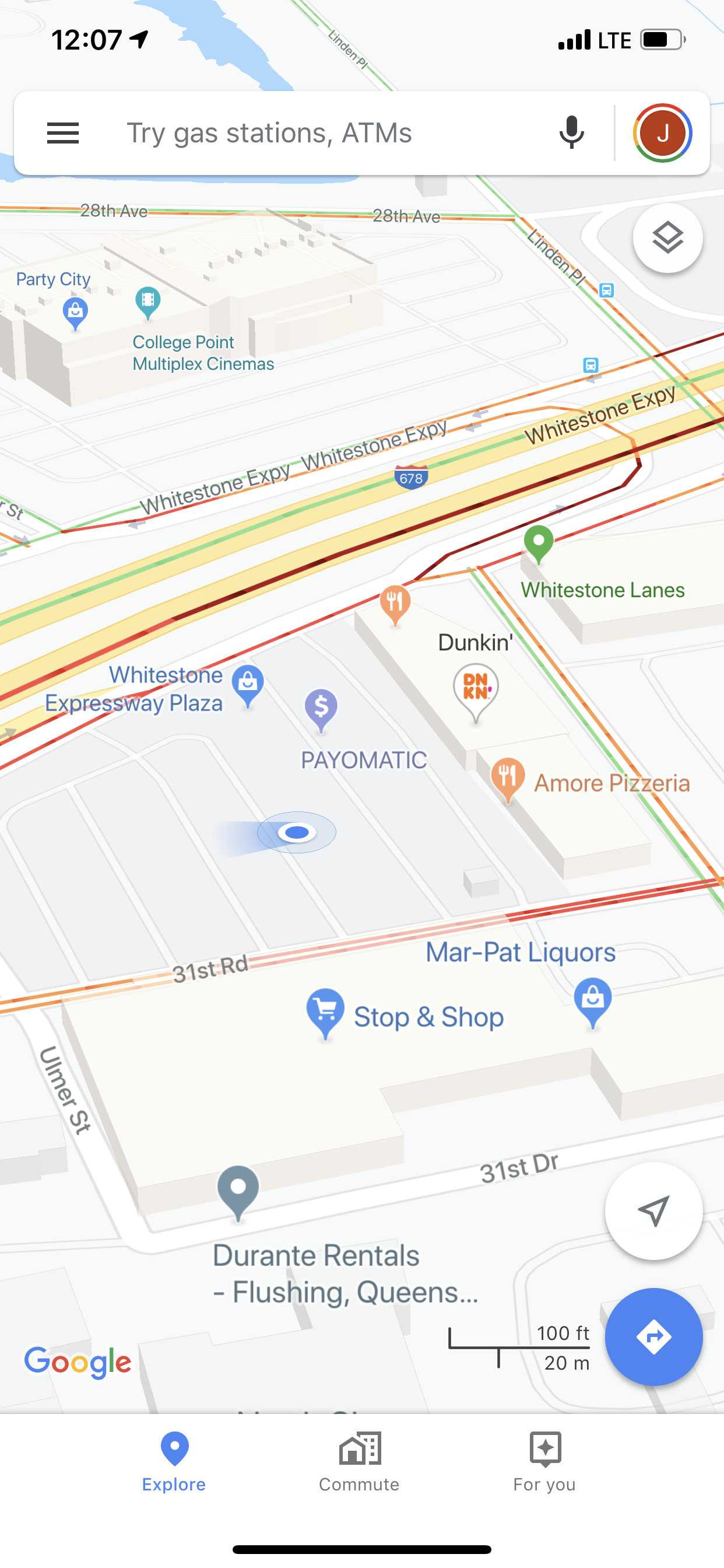

But in this instance, Google Maps had a better idea of what was going on, showing the direction I was facing correctly.
Navigating home on Apple Maps, it took about three blocks' worth of driving before Apple Maps positioned me properly on the road I was on, and even then, was lagging about 400-600 feet behind where I actually was. I did catch up at one point, and it remained steady the rest of the way.
But in this instance, Google Maps had a better idea of what was going on, showing the direction I was facing correctly.View attachment 853905

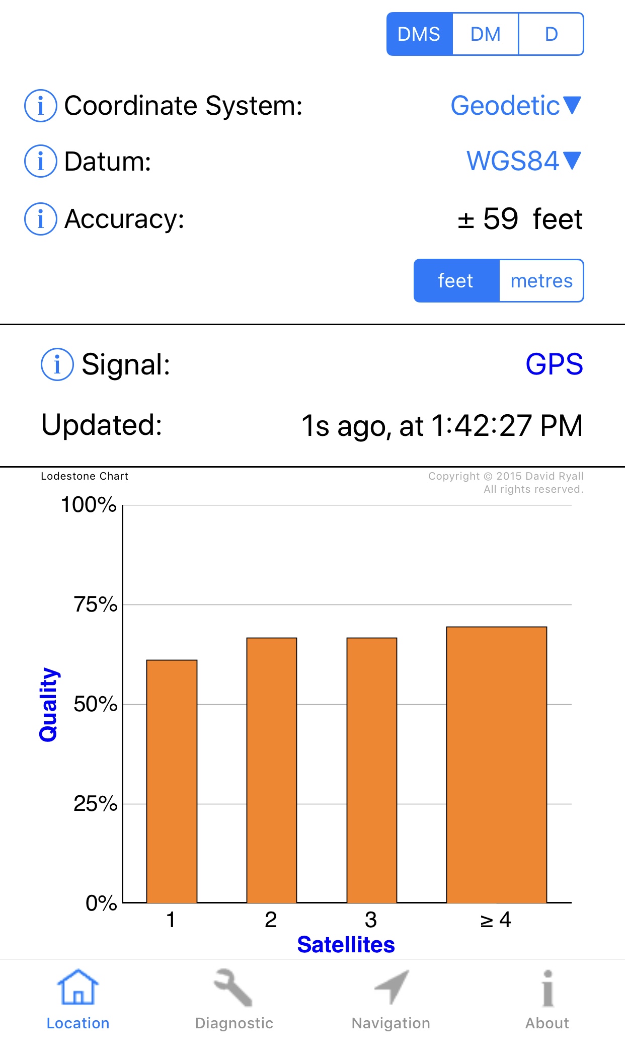

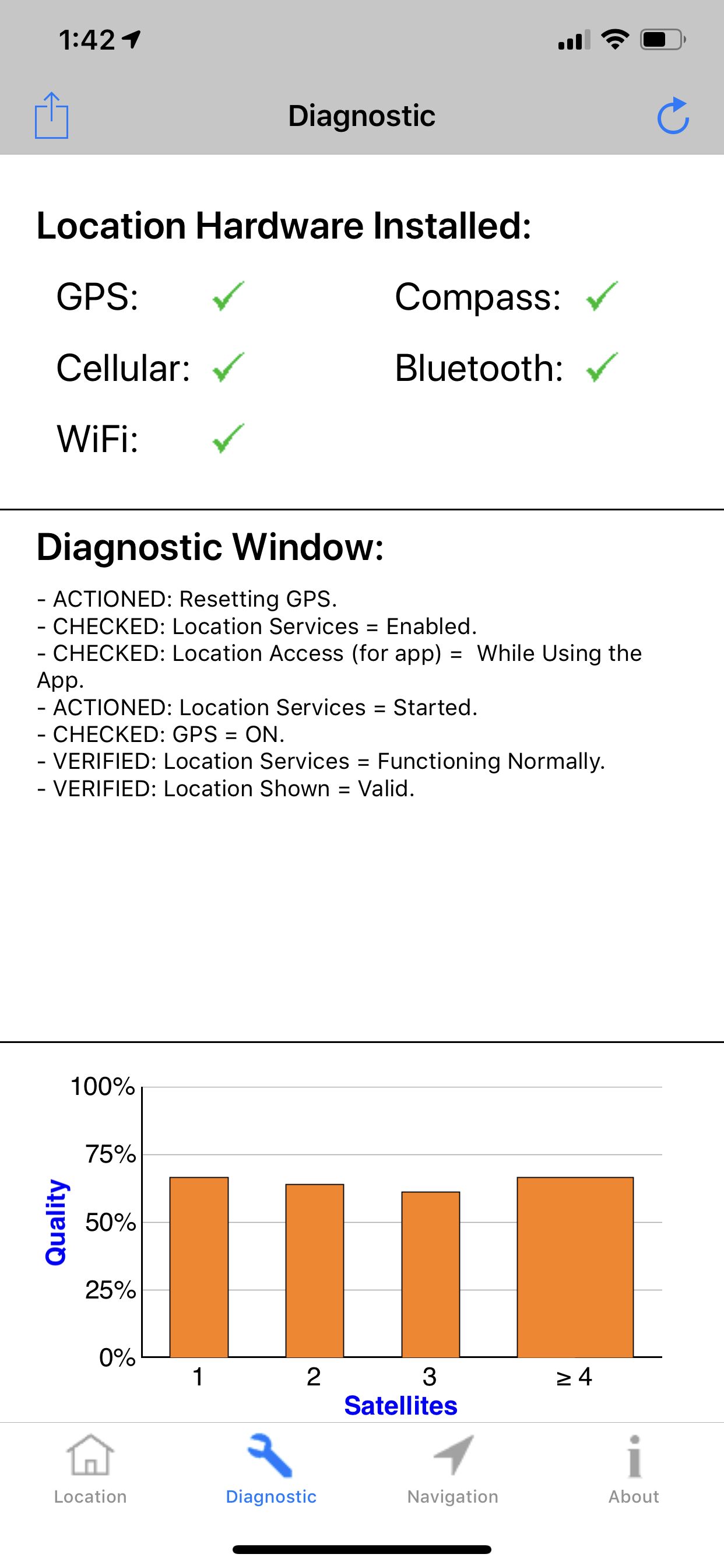

The fact that you're getting ok readings outside the car tells me that this is somehow the result of your connection to the car. But the GPS diagnostic app I recommended will tell you if there is an issue.
The only issue I had with GPS was with rental cars and the GPS settings from the car manufacturer. But they were WAY worst than what you are experiencing. The car's GPS was overriding where I was and had me 700 miles away. It took up to 10 minutes in some cases for the phone to correct the issue while driving. It's brutal when it happens and you have no idea where you are going.

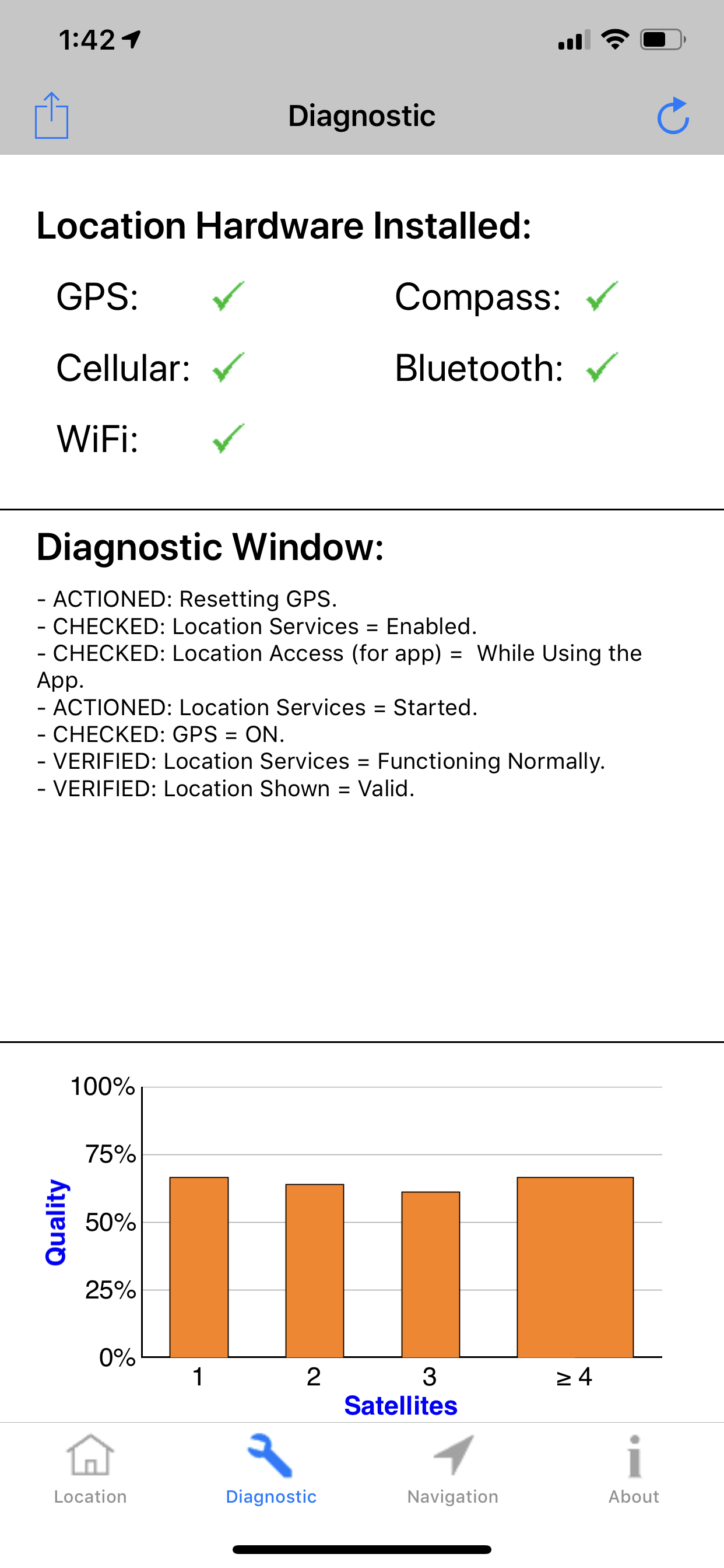

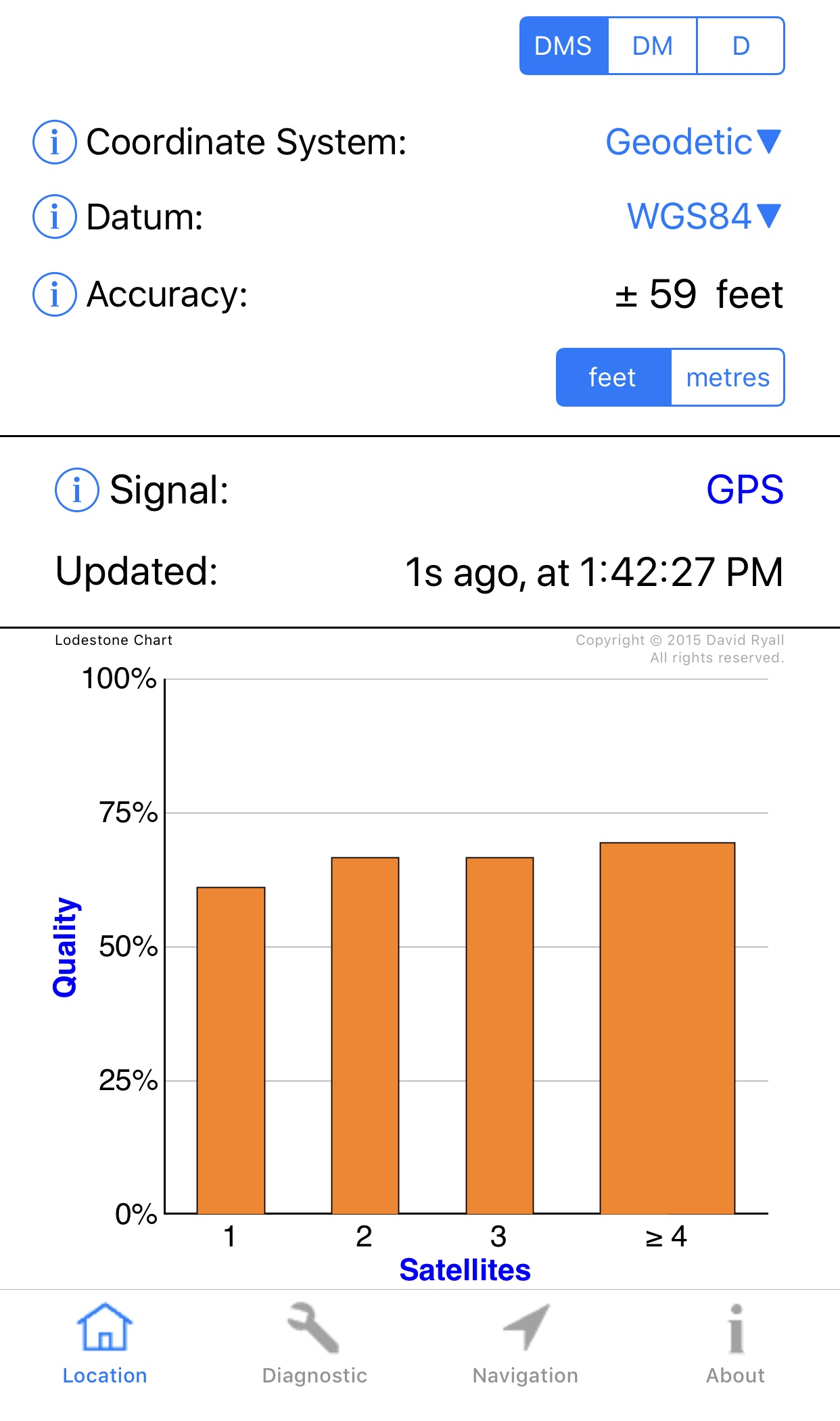

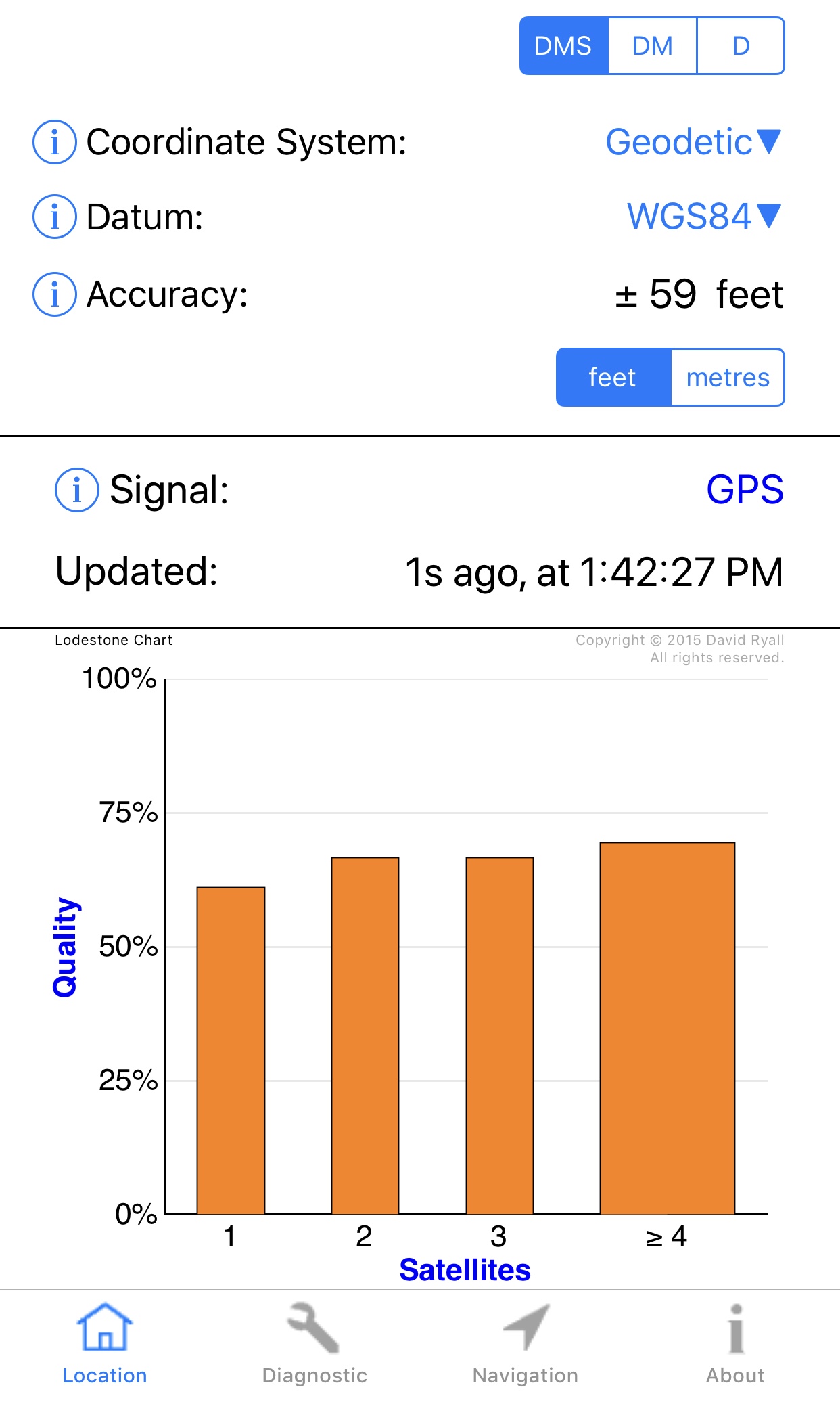

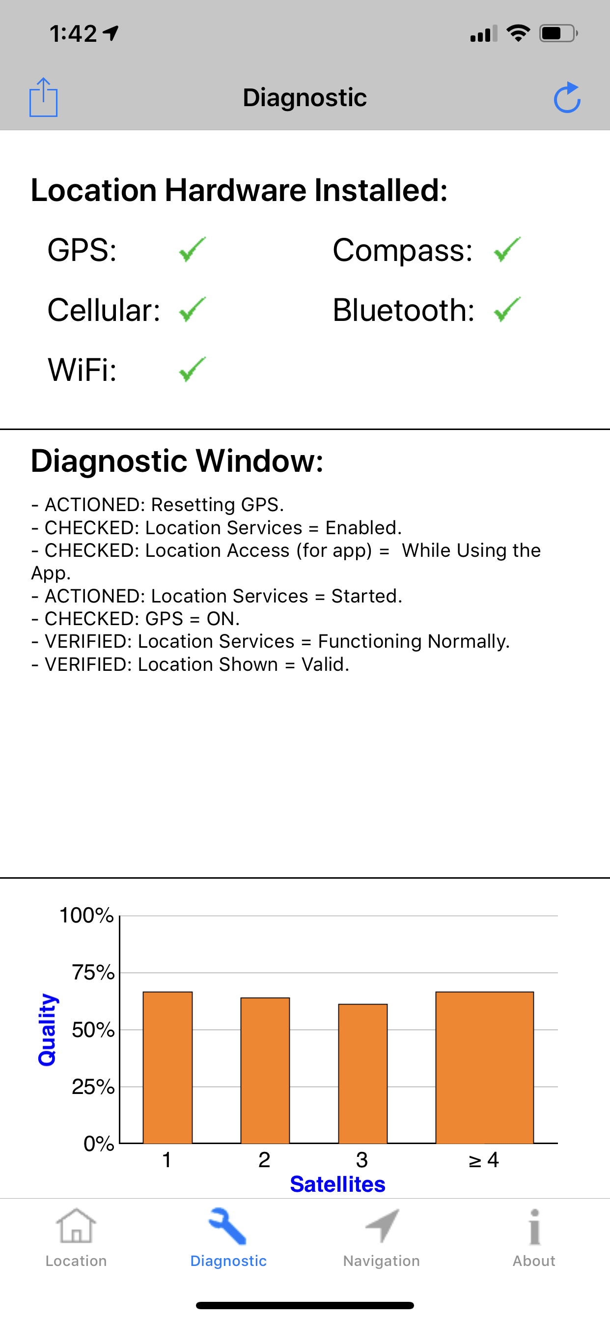

Downloaded the app gwhiz recommended. This is what I'm seeing at home, while connected to wifi:
View attachment 853923 View attachment 853924
Guess I'll see what this looks like when I'm in the car tomorrow. lol
Those are just fine. During iOS 12 betas, I was getting only 2 or 3 satellites and the quality was sub 50%. If you get a chance, before you plug into the car, take the reading from there (with the roof over your head). Then, plug in and see if that changes what you are seeing.
