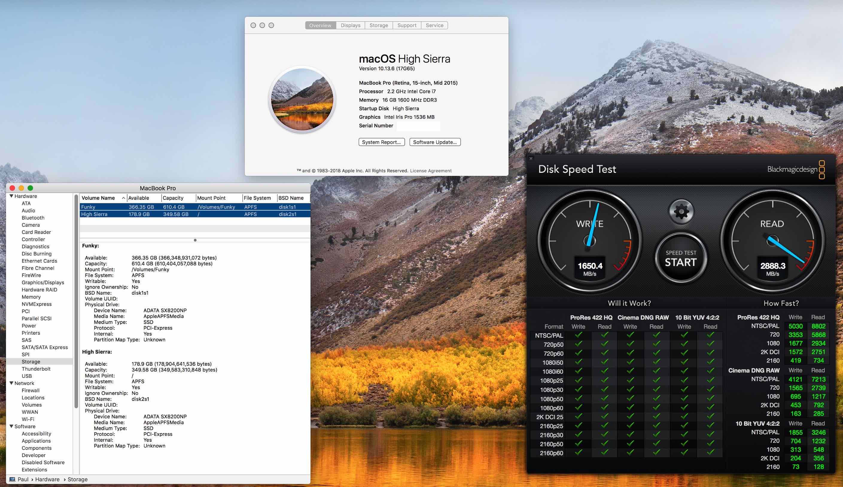

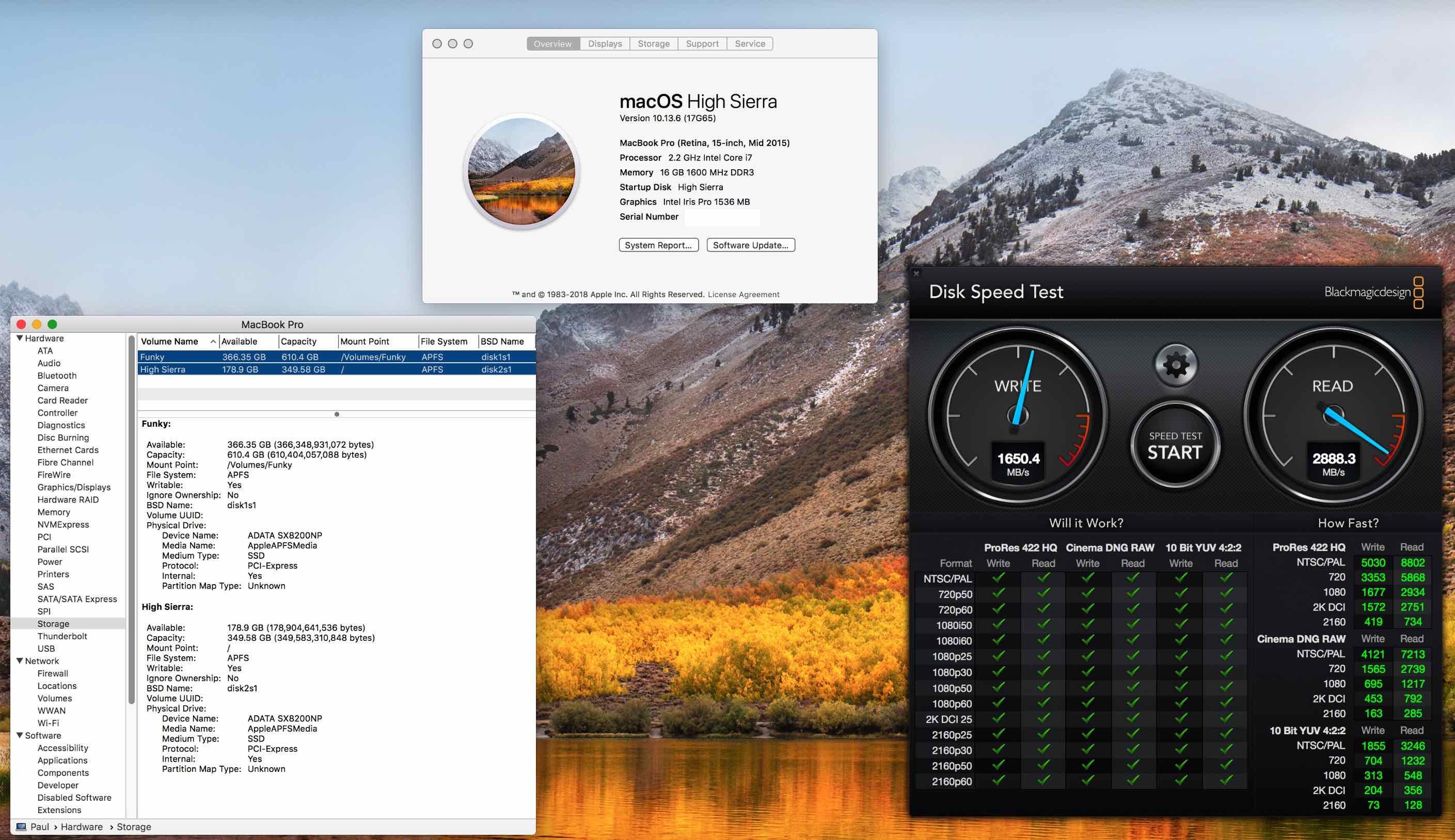

Just wanted to report a successful upgrade of my MacBook Pro mid 2015 with an ADATA 960GB XPG SX8200. I ended up using the short adaptor as I didn't like the bending of the long adaptor. I also used the original screw as well as the heatsink provided by ADATA. Not sure why people say it is too thick. For me it didn't cause any problem and the case is certainly not bulging like some have reported.
Reactions: Berlinsky and schns

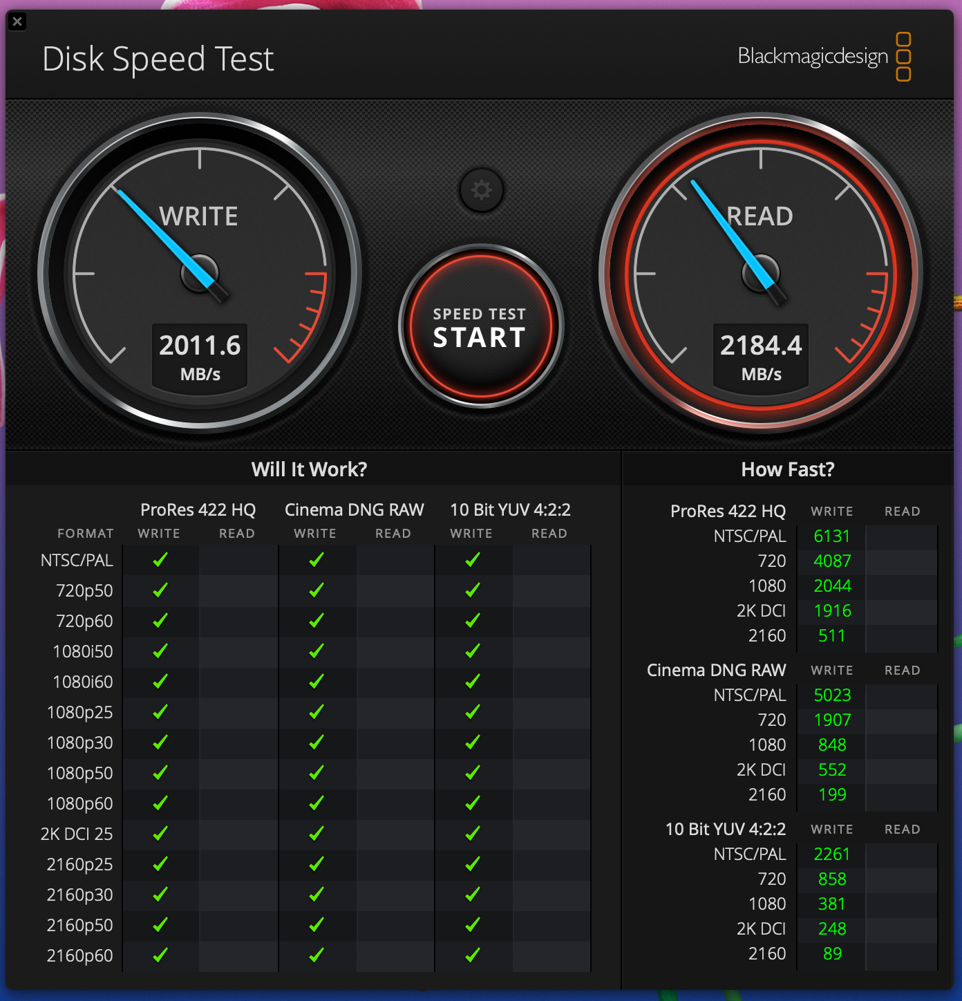

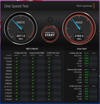

So I randomly decided to upgrade to the new ADATA SX8200 Pro 1TB NVME that was just released, which is their new top of the line SSD, which is supposed to slot above the SX8200 that I'm seeing people use here. It's using the updated new SSD controller. I'm seeing faster write speeds, but the read speeds seem lower that what people are posting for their SX8200. Any ideas on this? I'm using the long Sintech adapter, latest revision C.
I've just installed yesterday, so still need time to test out. But the temps seem fantastic, hovering at 23 degrees C.
