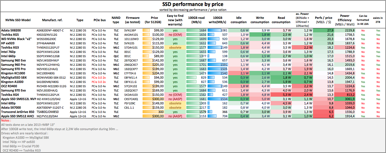

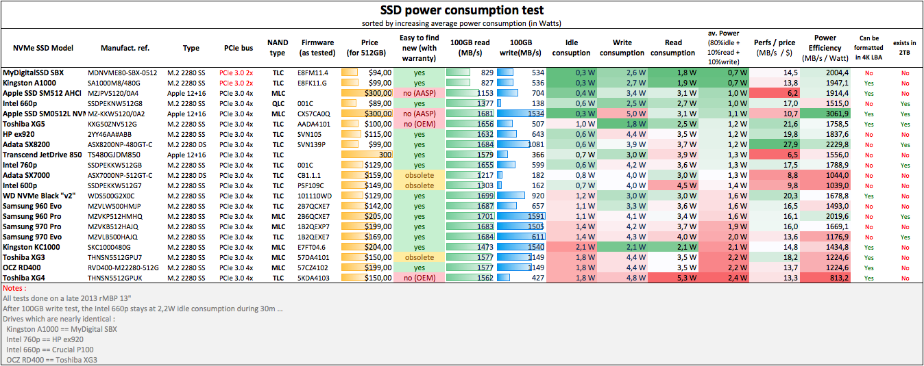

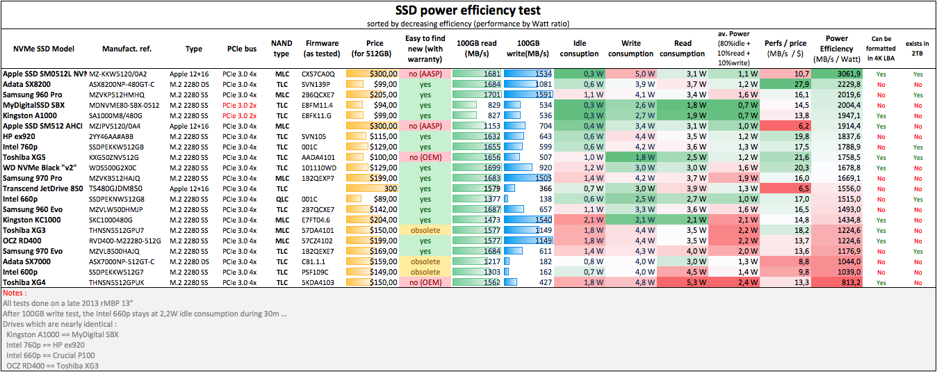

[doublepost=1544996008][/doublepost]Hi everyone,
juste a little update to my tests of NVMe SSD.
This time I focused on energy consumption, I also included for comparison some AHCI and NVMe genuine Apple SSDs.
I've sorted the table in three way :
- SSDs sorted by performance / price ration
- SSDs sorted by growing power consumption (assuming a time ratio of 80% idle - 10% read - 10% write)
- SSDs sorted by power efficiency = speed / power consumption
Note that my favorite SSD at this time is the Adata SX8200, but it is not yet available in 2TB (although it has been announced for nearly 1 year...).
I don't especially love QLC ssds which have very low speed once the SLC cache has been filled.
I would also love to test the MyDigital BPX which seems to be very interesting : high performance / price value, MLC cells, 5 year warranty, high endurance (TBW), and exists in 2TB (at $519),

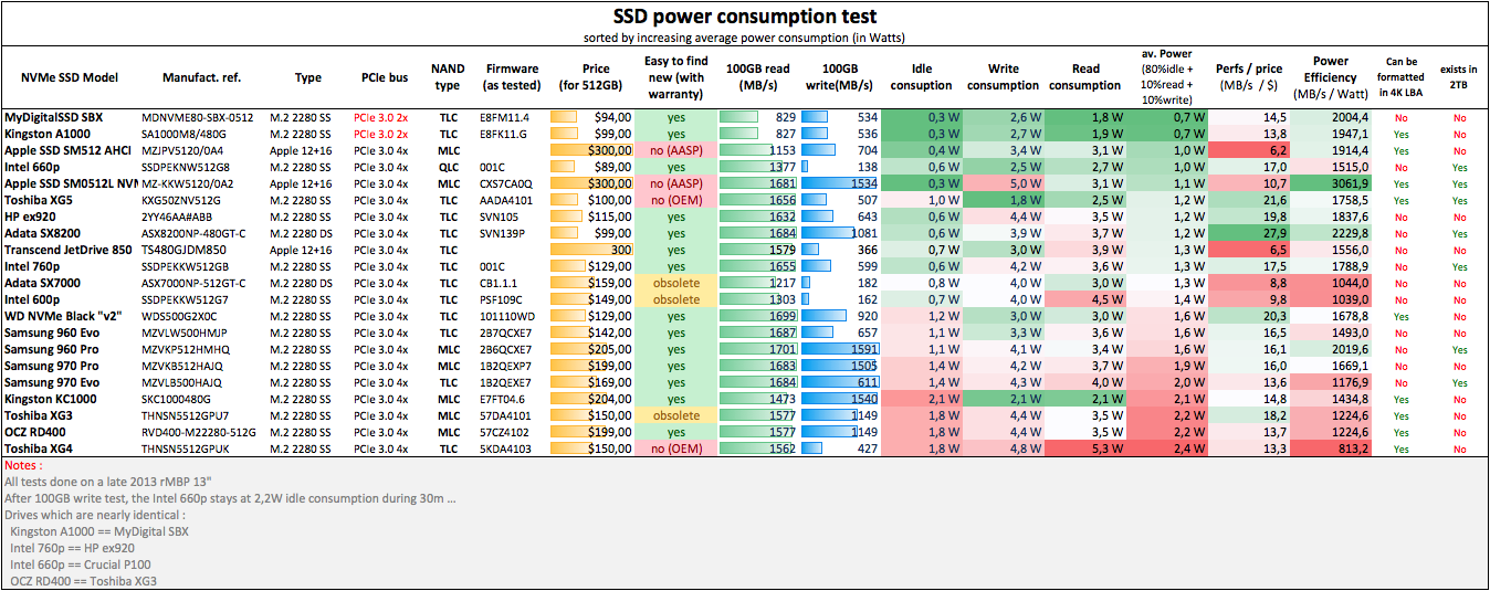

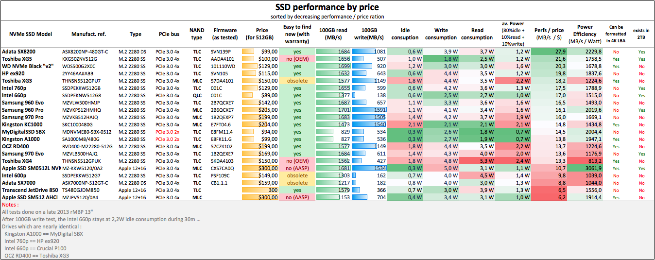

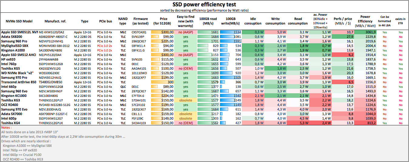

View attachment 811200 View attachment 811201 View attachment 811202

Sorry for your problem. I did upgrade to 10.14.2 on 2 rMBP and didn't noticed anything wrong (although I don't have a SM951 to test, my tests with 10.14.2 were on a KC1000 and on a SX8200).
Please can you tell me which model of Mac and which BootRom do you have ?
