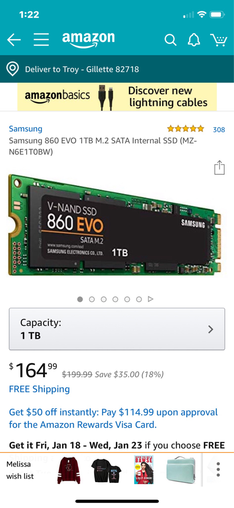

If I didn’t want the extra speed and just wanted stability and storage could I use a m.2 SATA drive with the black sintech adapter and not have hibernate issues in a 2014 MacBook Air like the Samsung 860evo.
