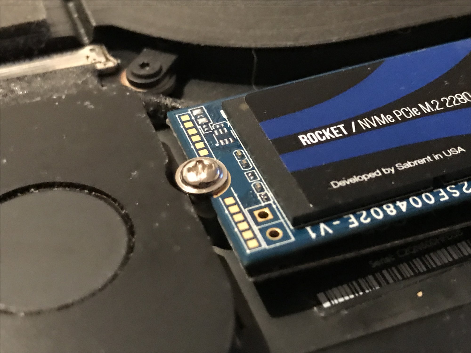

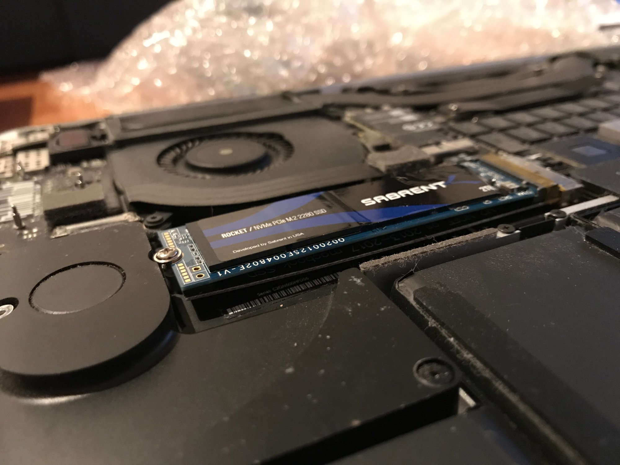

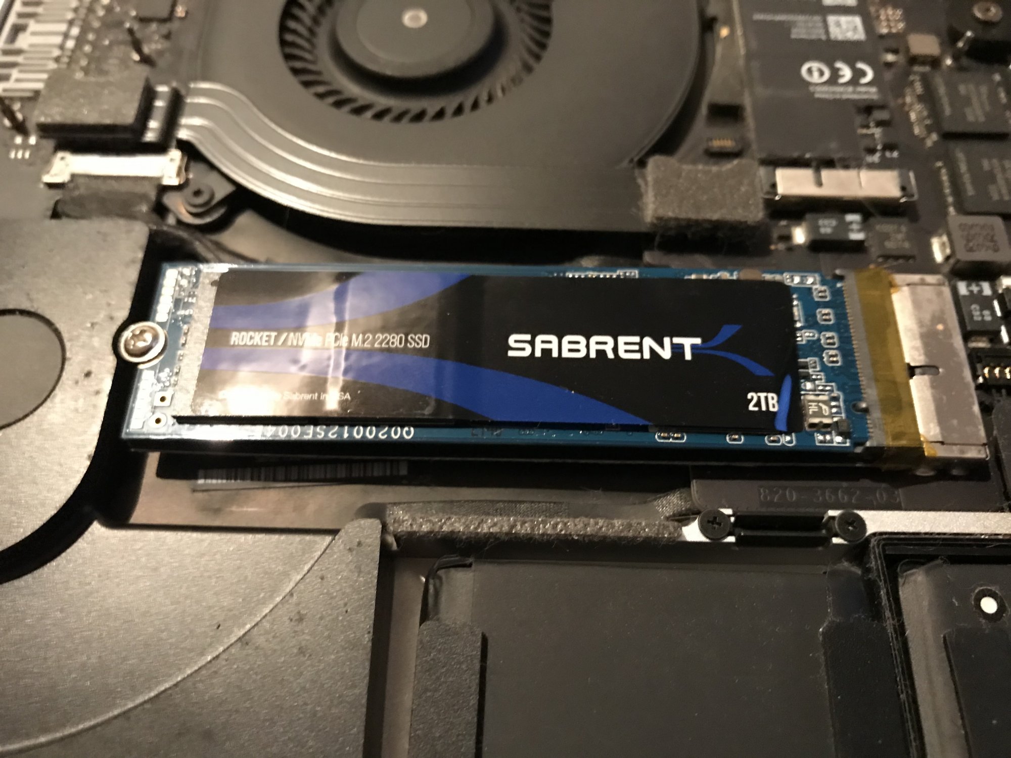

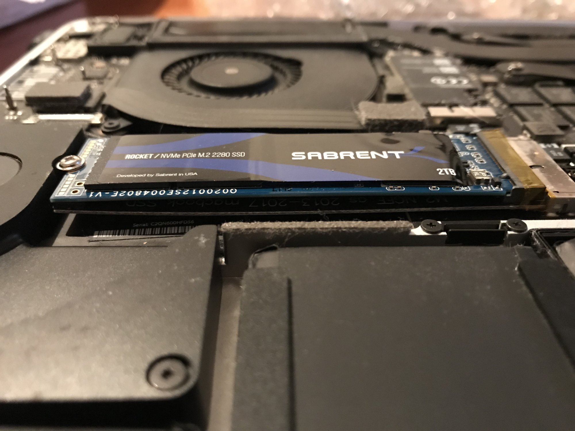

Hello everyone,
Juste installed a Sabrent Rocket 2 TB in my Late 2013 Pro 15’. I did the BootROM patch using EFI Cable & CH341a.
I used the Sintech long black adapter and I’m a bit confused. As you can see, the Sabrent seems to be really high and I’m worried about it being stucked to the MacBook lid. Also, the more I screw (using the Philips screw given by Sintech as is it too thick to use the Apple one) the more the Sintech adapter bends. So I didn’t screw it very well but at least it doesn’t bend too much.
Do you think I should cut out the Sintech Adapter to have a less thicker part to screw ?
Thanks a lot for helping me

try to reseat everything. I had my sisters buckle like that on the mba. It didn’t turn on. so took it out and reconnected it, it sat better, and it works fine after doing so. If that doesn’t work hopefully someone smarter can give advise

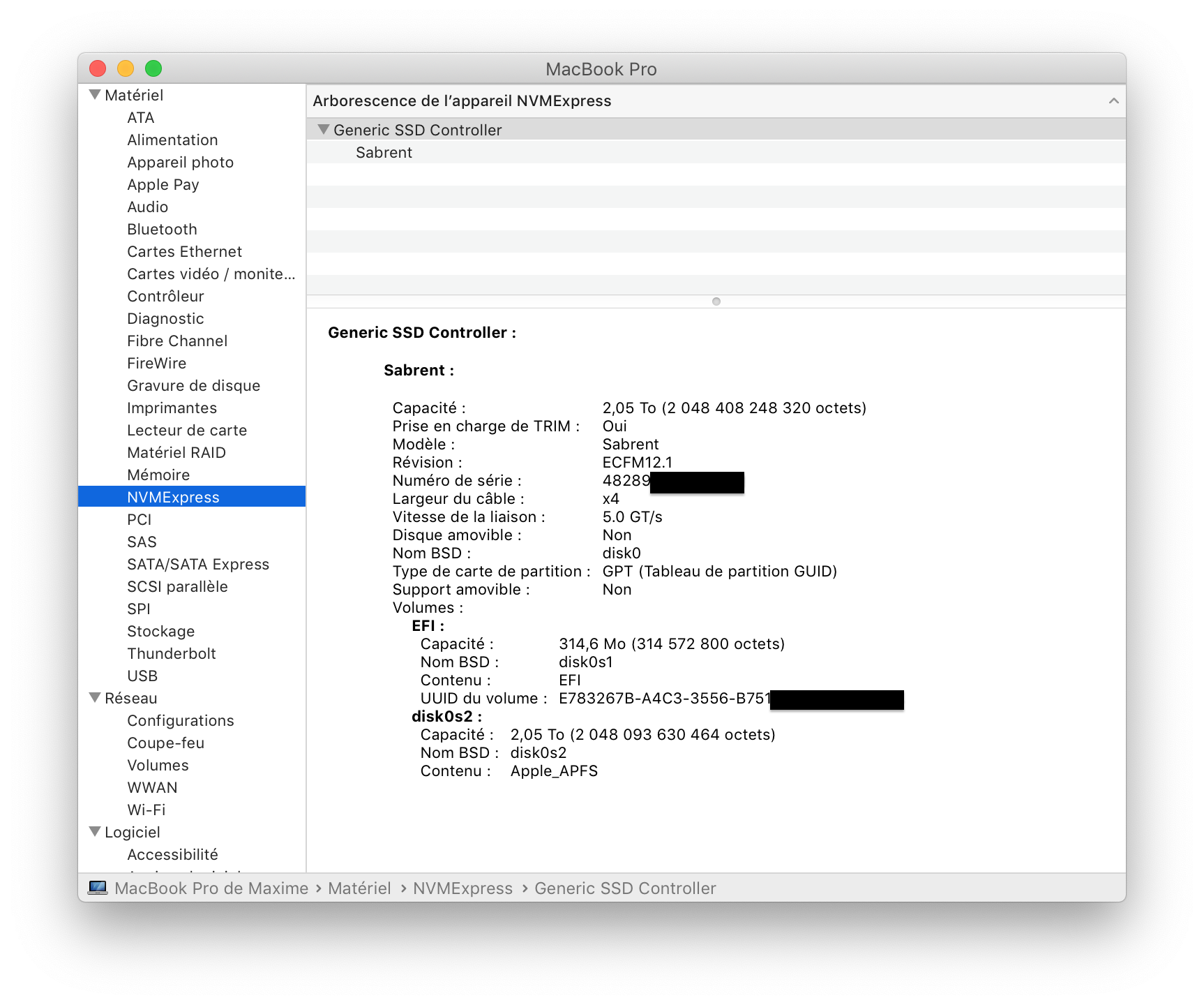

Everything working fine, recognized as a 4x lines PCIe 2.0 -> I'm writing this from my Macbook right now. But I'm a bit worried about overheating because heat won't dissipate or juste gonna heat the aluminium lid.

I hope the photos are exaggerating that bend but I would be concerned. I saw a post here somewhere where someone made a small plastic washer out of a pen casing and cut it just tall enough to level out the board. Personally I would just get the short adapter and redo it. Mine with the short adapter sits perfectly level.

Nope, actually I had trouble to take pictures showing it : it's more visible in real life. I think before buying the short one (anyone got the link from sintech website ?) I'll try to make my own from the long but cutting it and filing it after.
I’m using the one from the link on page 1 via Amazon. No issues whatsoever, no tape or anything.
I just cut it using a small hacksaw, and it's really fine now. I've used a small foam that was at the end of the long adapter and put it on the screw support to put it real straight :) I should have bought the short one from the beginning ;) So do not buy long one if you're planning to put the Sabrent Rocket 2 TB.

Yeah I dunno dude that Sabrent 2 TB looks like it is bent in the picture. Can you return it?
If it is just cosmetic maybe it is ok but ( well I have not looked at a ton of NVME ssd ) that looks funky to me.
Yeah it was bend because of the screwing with the long Sintech adapter, now that I've repaired it it's alright, not bend at all. I couldn't have returned it anyways because I was having it for two months (it took me a while to find time to do backup and to do the BootROM patch).
Moreover it's normal that the Sabrent sticker looks weird as it is glue to the chips and not a hard cover. But the card itself looks fine, and after my repair it's even better with no bending at all ^^ (Apple OEM & Samsung SSDs looks way better in hand imo)

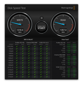

This is results from MBP 15" Late 2013, 2TB Intel 760P installed with short Sintech adaptor (revision B)

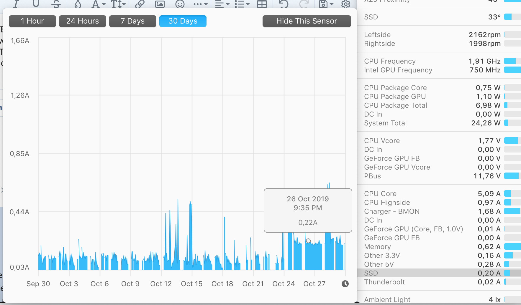

Hi, How's your battery life with the 760p?
Power consumption of Intel 760, according to iStats Menu, is around 0.2A (when it does not perform writing tasks)
Original Apple 1TB SSD took around 0.12A in same conditions
If I close the lid with 100% of battery, after 6-7 hours of sleep it's still 100%
(Power spikes on the screenshot are the times when I used Blackmagic Speed Test app)
