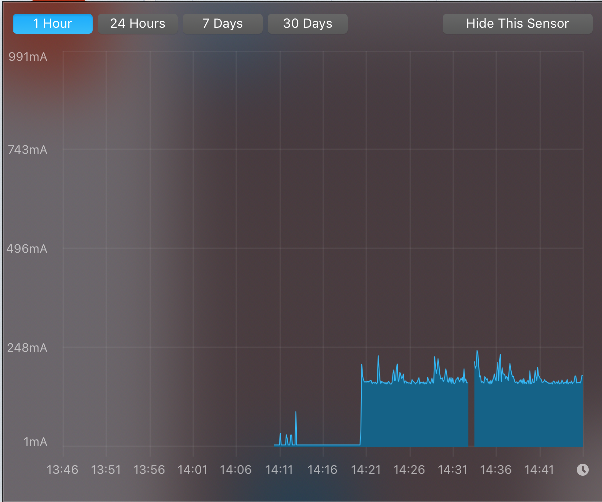

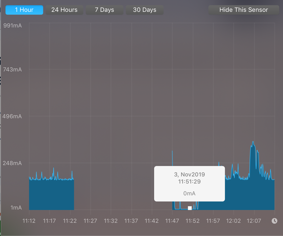

Recently installed an NVME SSD (Kingston a2000) and noticed that IstatMenus reports SSD current staying at 0 mA after mac wakes from a long sleep. :eek:
When opening files it shows little spikes after which current goes back to 0. At some point, (I haven't figured exactly what the trigger is, could be a heavy I/O operation or some kind of timer) current jumps to default idle level (~160-170mA for this disk).
I have seen the same behavior with the stock Apple SSD, when running on battery. Could this mean that macOS is capable of setting the disk into one of the low-power states but does this only when sleeping?
I noticed the same but I believe is more like the sensor is catching up with readings rather than deep sleep.
I u pay attention to the chart as soon as the sensor and istats wake up the reading is steady however with apple stock drive sometimes goes to almost 0 mA even way after waking up. So at this point I doubt any NVME drives other than apple are capable of deep sleep feature.
If it's catching up why then if I open some file from the SSD chart immediately shows small increase in current? Restarting iStats changes nothing, it may be a bug or some kind of restraint of their measuring method, however.
I'm unaware of how it collects data so I can't check these measurements in another way (i.e. from ). It would be cool if someone shared a terminal command to get it directly from OS.

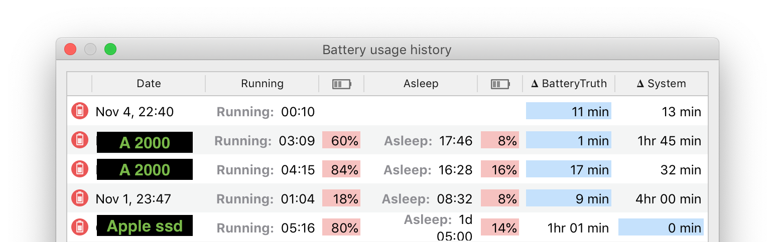

Looks good! What Macbook are you using? How is battery life with the new Kingston A2000 compared to the stock apple ssd? I'm planning to upgrade my 13" early 2015 with a Kingston a2000 1TB. Would greatly appreciated it if you could share your knowledge!
I'm using 13" 2015 mac
I measured my common daily usage scenario with chrome/movie playback.
First impressions are disappointing - battery lasts 1 hour less. The last result with apple SSD is actually 20% of battery while asleep, but it's not recorded by the app because it turned off before even waking up
SSD drains around 160-170mA when idle, that's only 0.5W
Maximum write power consumption - 3.1W, read - 2.8W, but only under heavy load, most of the time it is below 0.4A
