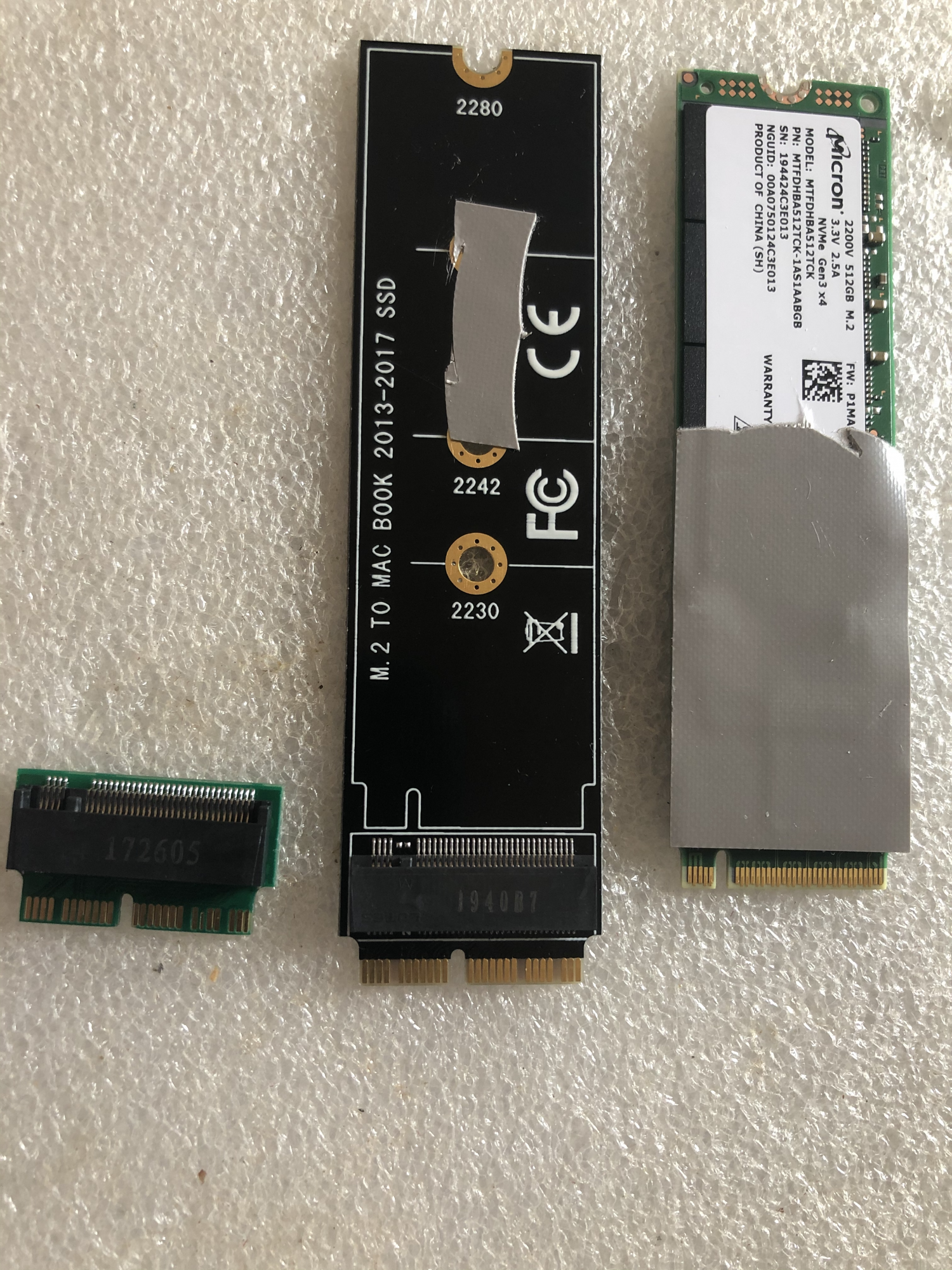

Hi, guys.
I want to upgrade my Macbook Pro mid-2014 from 128 SSD to Micron 2200V 512GB M.2 NVMe Gen 3 x4. (MTFHDBA512TCK).
I tried everything but can't figure it out how to make it work.
First - I have installed High Sierra on the new SSD via USB adapter and that made possible to see the SSD into the Option when I boot as internal, BUT keeps rebooting on startup.
I can't see the new SSD in Disk Utility.
1. I have a M.2 NGFF M-Key adapter + a M.2 PCIe NVMe adapter
2. Also, crsutil is Disable.
Can someone advise me on this, please?

Hi, guys.
Looks like your MacBook is running a 157.0.0.0 bootrom which should work with a NVMe drive.
Did you put the drive inside the MacBook, boot using Internet recovery, go into disk utlity, view all devices, and partition the drive?

With the SSD inside, I can't find it in the Disk Utility, the same result with Time Machine restore, Terminal diskutil list or Internet recovery - all the same, can't find the SSD.
I can only see it on restart > Options key, but keeps on booting and getting the error message "something went wrong press any key. ..."
Also, I have no partition, Do I have to make a partition?

Did you try disk utility from a Catalina installer with the Micron inside?
Did you try deleting creating partitions on a Windows or Linux machine?

I did boot on a USB hard drive and tried disk utility, but still can't see the SSD.
I can only see the SSD when start with boot option key but it boots halfway through, gives me error "something went wrong..." and restarts doing the same in a loop.
If I can see the SSD in the boot option would that mean my M.2 NVMe converter is working properly?

I first formatted the SSD externally via USB on a Mac as Mac OS Extended. Do I need to do APFS format?
Also I've been trying the SSD externally and I installed and upgraded the macOS from Mavericks and went all the way to Sierra - Couldn't install High Sierra because I got the error "You may not install to this volume because the computer is missing a firmware partition. Does that mean something?

I'm inclined to agree that the adapter is working since you can see it as a boot option. No need to format as APFS before installing the OS. I installed High Sierra, Mojave, and Catalina to NVMe drives and always formatted them as OS journaled.
The firmware partition is needed to install the OS which is why you get the error. Normally, there is a small portion of the drive that is used handle this.
Is it possible that the drive needs a firmware update?
Is it possible to try the drive in different or newer Mac?

The first time you formated the disk, did you format the NVMe as GUID Partition Map, Master Boot Record, or Apple Partition Map? If I am not mistaken, it has to be GUID Partition Map.
Which version of MacOS did you use to format the NVMe?
I also agree that the adapter should be working.

I haven't tried the SSD on another Mac machine. I don't have.
I was only able to install or make a copy of any macOS via USB without any drive inside or with my original SSD.
Weird thing: once the SSD is inside I can't boot from anything, not even a USB drive, nothing.
It goes halfway and reboots continuously. So, there must be something related to the SSD converters?
How do I do firmware update for my driver?

I'm not sure there the converters are the problem. They look fine to me. I assume you have tried both with the NVMe. I have used the short, green Sintech and short, green no-name adapters and both have been fine.
It's possible that the NVMe drive needs a firmware update. The Samsung 970 Evo Plus needed a firmware update before it would work properly in a MacBook.

SO, if I upgrade via USB from Mojave to Catalina theoretically the firmware will automatically upgrade too?
In order for the firmware to upgrade, there must be a working drive inside the MacBook.
To upgrade the firmware, you can do a clean install of Mojave or Catalina from an external drive to the internal drive.
If the internal drive is running an older OS, you can run software updates from the existing OS.

Yeah, I haven't got to the point of the SSD being recognized yet.
WHAT IF? - I will try to install windows on the Mac with this new SSD, maybe there is a way? Does anyone know if it's possible?
AND - Once I have windows I make a virtual machine with macOS Mojave and upgrade that virtual to Catalina. Will that update my SSD firmware? Did anyone done this before? Is it doable?
