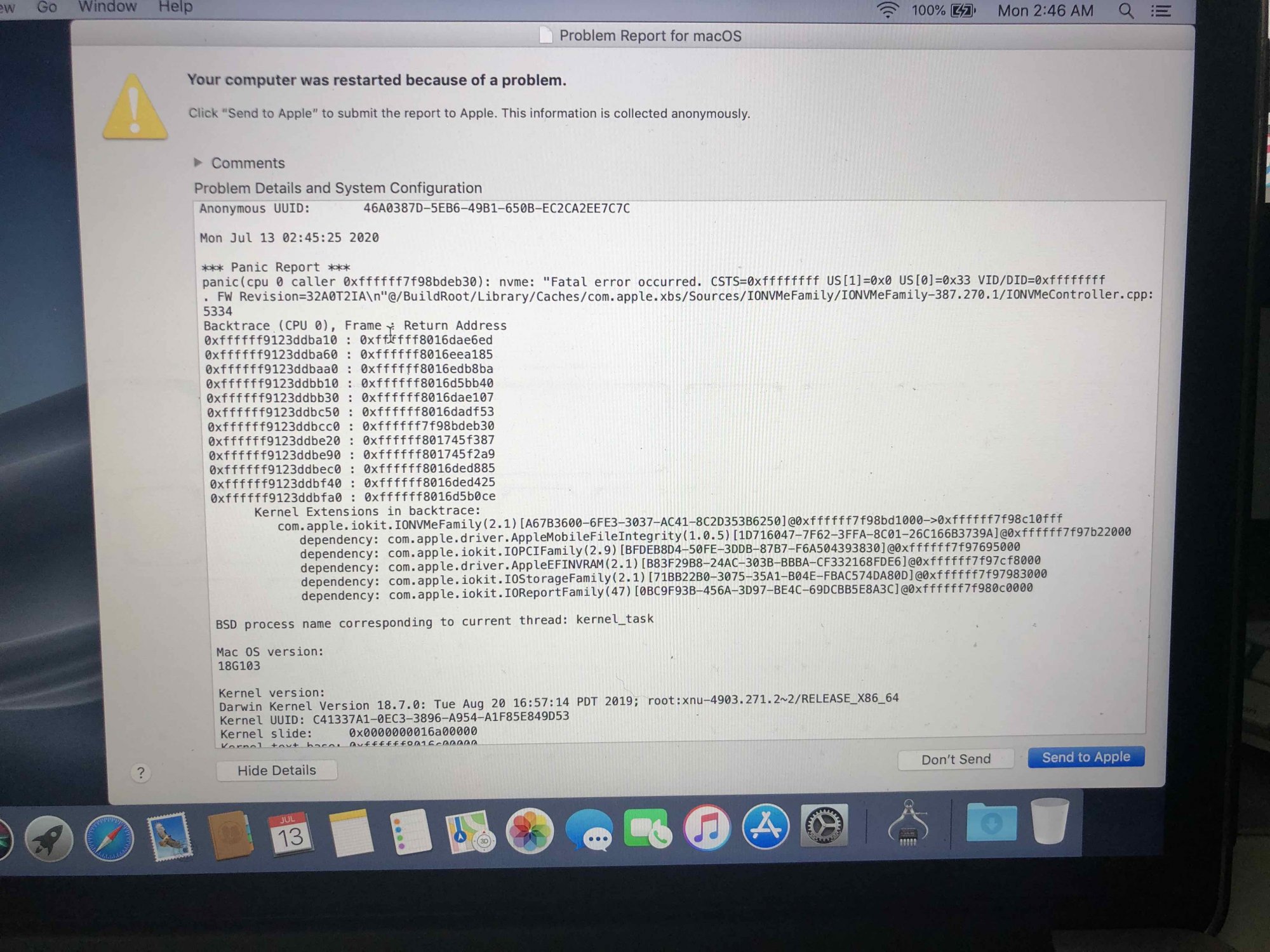

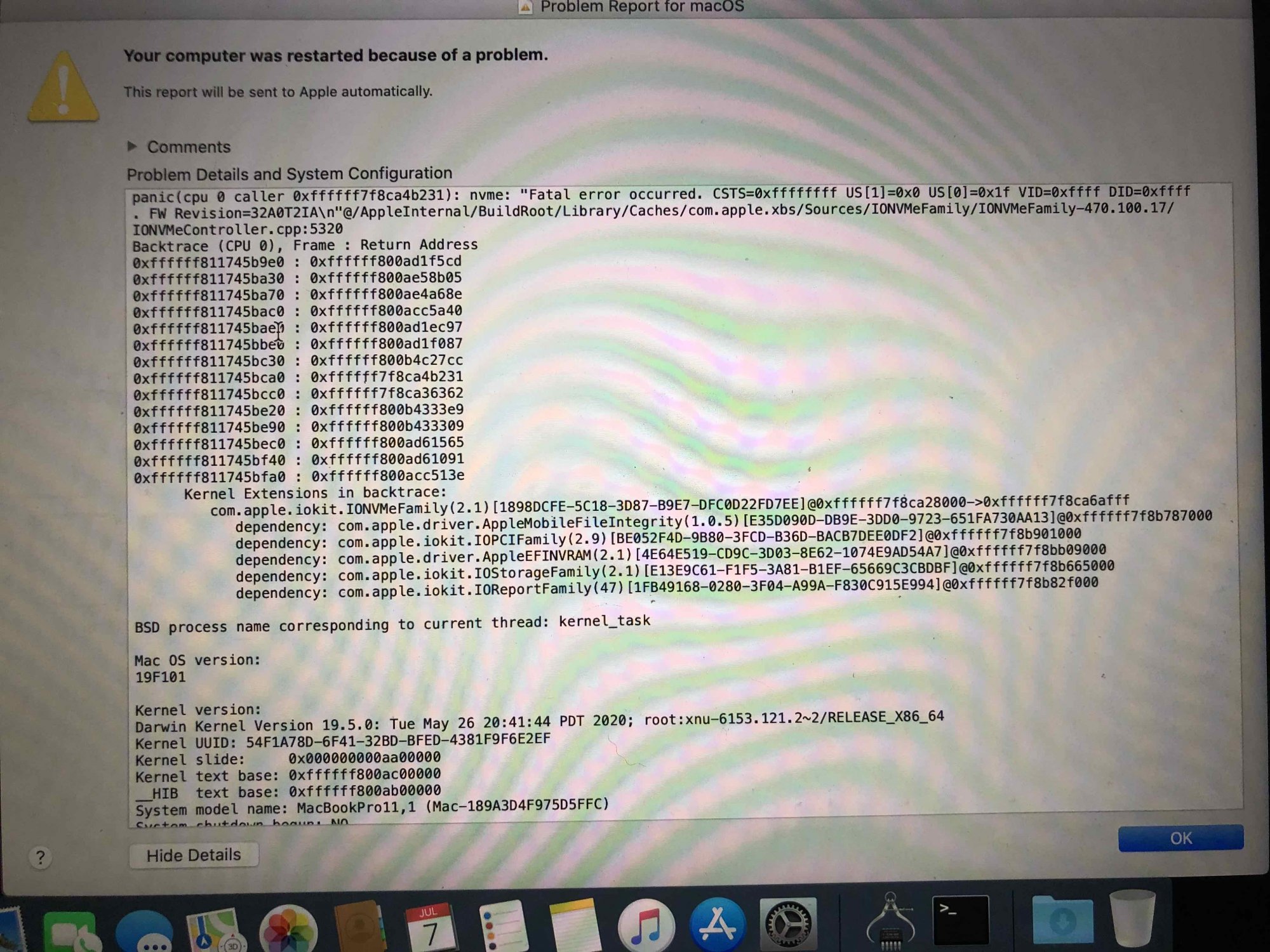

Do the panics occur under different circumstances or only 1?
Did you perform a clean install?
Do you have any of the panic logs?
Yes, happen very frequent, and performing clean install, about 13 to 15 minutes usage then hang, blank screen and kernel panic appear.
I already different MacOS Mojave, MacOS Catalina 10.15.4 also same results.

Which MacBook do you have? Have you tried re-installing the adapter? The drive is reported as x4 in system report?
Based on the logs, the panic is being caused by the NVMe driver.
MacBook is running the latest bootrom?

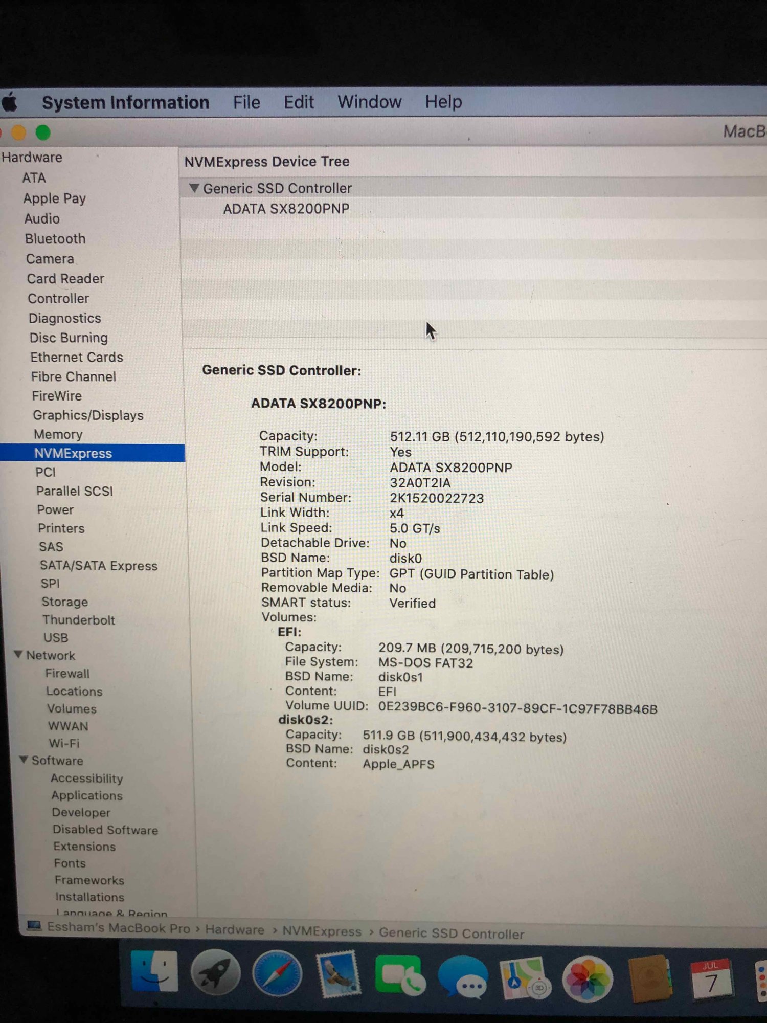

13-inch Macbook Pro Retina Late 2013. Yes, i have tried countless time re-installing, re-seating the adapter. I have 3 different type sintech, chanyang and not sure brand from aliexpress, all give same kernel panic. The system can view in attachment.
This macbook just newly updated to bootrom 162, before this 160. But still same results.

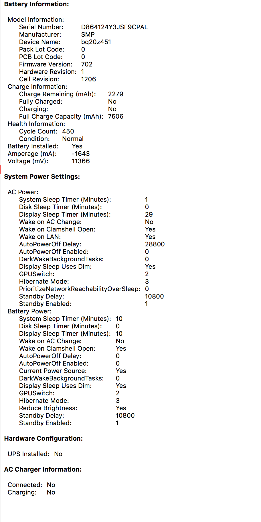

Congrats!The only thing I'm not sure from your above posts is that did you put your MBR into deep sleep (aka hibernation) after drain your battery to 50% or below? I'll call it success if that passed. Do you have means to check if your bootrom has full or partial nvme driver? TIA!

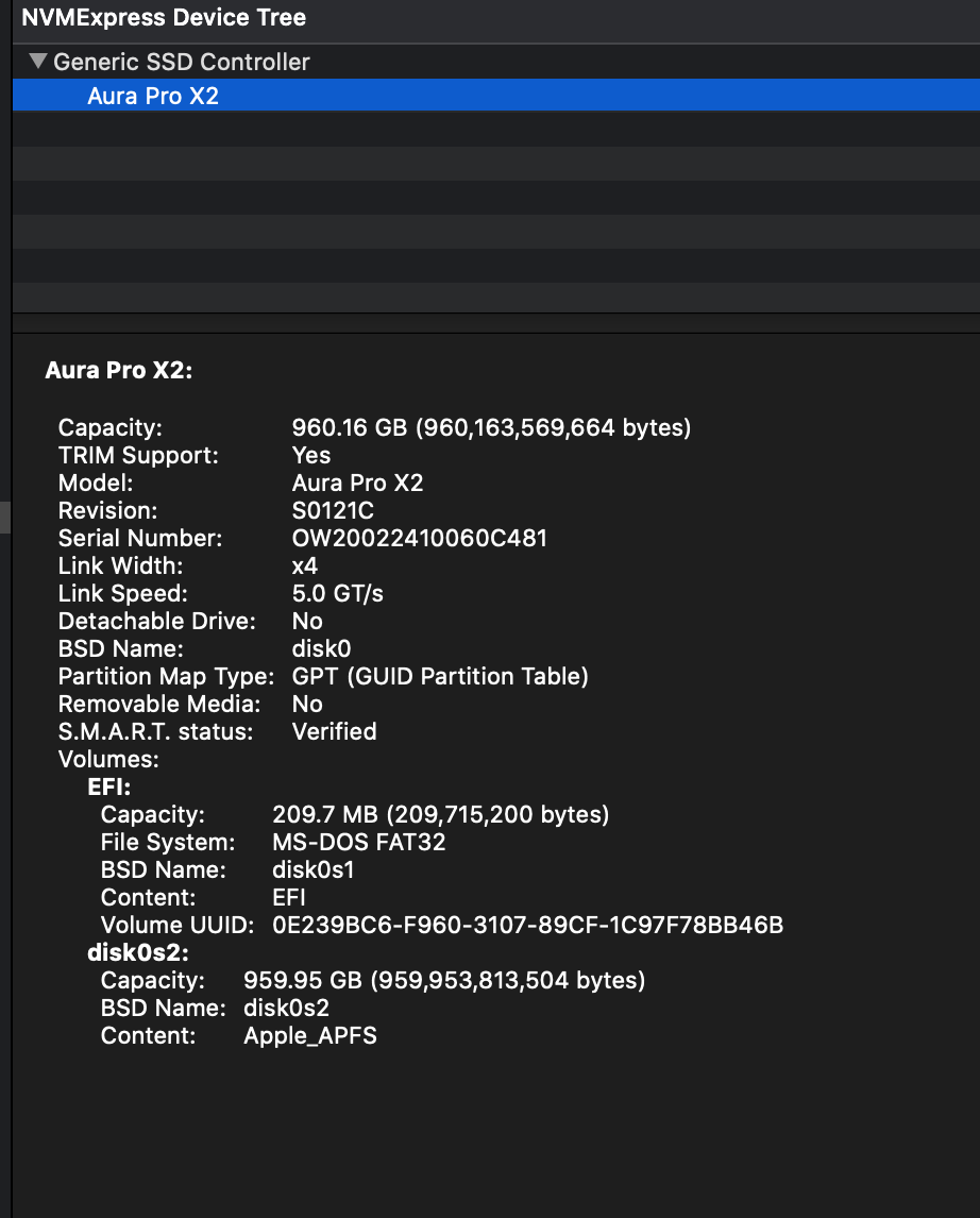

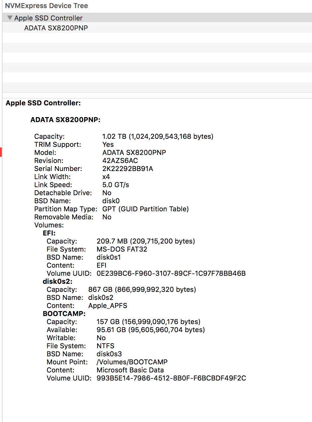

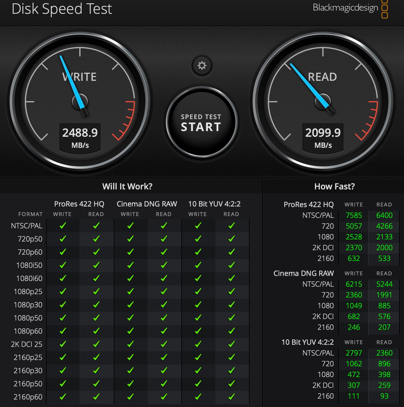

Here's a couple of screenshots. Wasn't able to find anything that said nvme driver so let me know if I should screenshot something else.
2013 15" mbp slept overnight at 30ish% and woke up flalessly 12 hours later at 27%.

How did you get your ADATA SSD to be recognized as an "Apple SSD Controller"? Most aftermarket ones are recognized only as "Generic SSD Controller" and don't seem to receive any of the power saving features.
Not a clue.
Like I said in a prior post, I chose a non-recommended adapter & SSD and am getting better results than those using the recommended stuff.
I'm baffled, but I want to share if somehow this is the magic combo.
It would be insanely stupid silly if all Apple checks for is if the drive name starts with the letter A.

Not a clue.
I'm getting same controller today macsound1 have, i'll be checking if i'm getting "Apple SSD controller".
