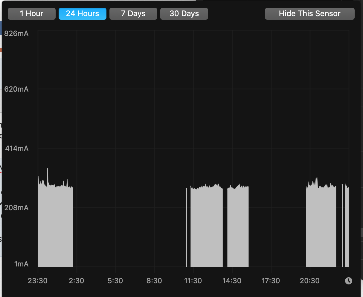

I've almost had this setup for a year now, and it's been running pretty smoothly. The speeds are great with the x4 PCIe link! Up until this point I've only had maybe 2 kernel panics related to the NVMe drive, which means it's quite reliable considering I'm a pretty intensive user. The only thing I have run into is that the battery drain is horrible. I used to have about 5 to 6 hours of battery life during normal operation, which has now been reduced to 1 to 2 hours; which is very bad if you'd ask me.
If there is a comprehensive way of measuring and reducing battery drain I'd be glad to hear about it, so please let me know. I have heard of NVMeFix but have been unable to install the kernel extension (SIP is disabled). I'd be very happy to have a fix for this.

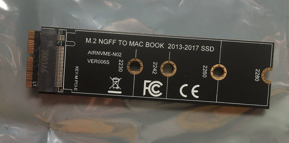

As a side note, there's an alternative to the OWC adapter for your original drive available on AliExpress which is pretty decent and has USB-C. Read and write speed weren't anything to write home about (250 Tx 300 Rx), but I thought I'd mention it anyway because of its convenience.

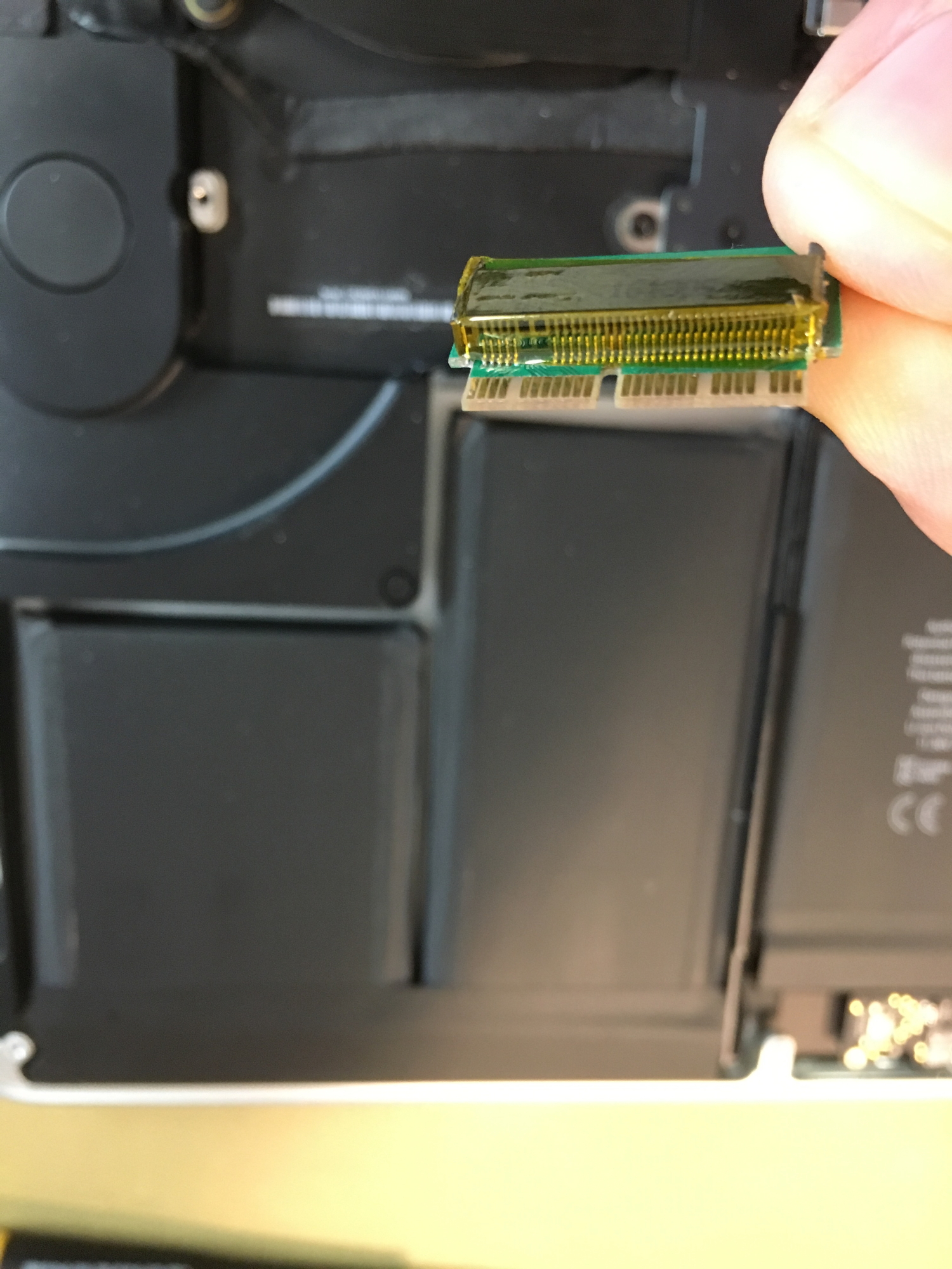

And what is its purpose? Did you apply the tape or it came with the tape?
My adapter came with tape pre-applied. I think it helps preventing some electrical leakage. I remember some people talked about that after applying the kapton tape, they no longer had kernel panics.

I already got this adapter mailed in from China:

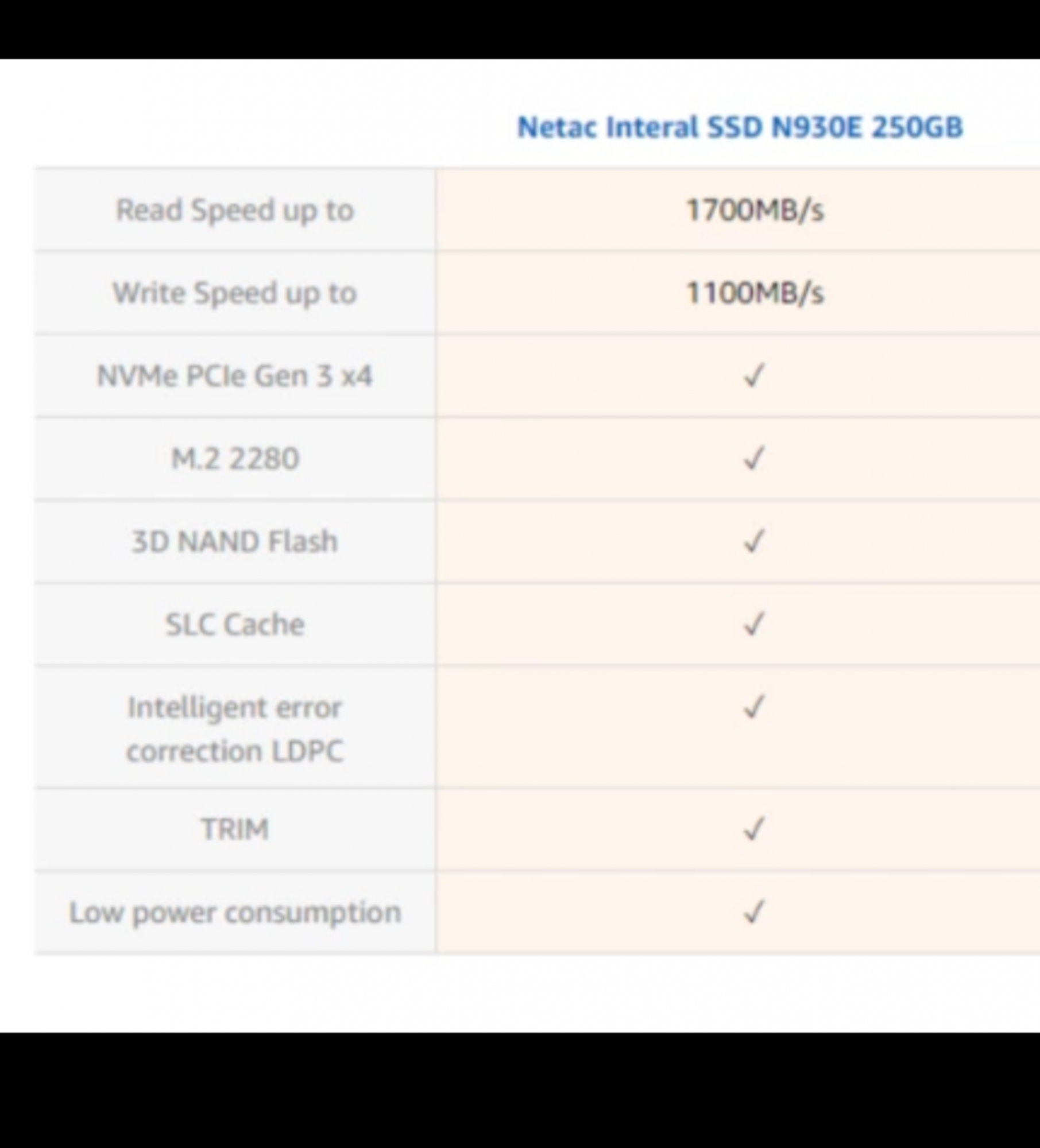

Hey guys!

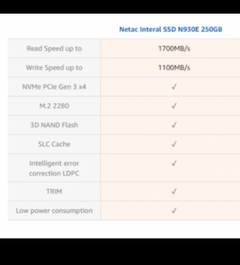

Does anyone know if the SSD that I linked has Dram cache or if it's just a plain basic ssd?
NVMe SSD
the seller sent me this image that I attached which shows that it has "slc cache" what does that mean is that the dram?
I tried to search on Google but I couldn't find any specific information, would it be "compatible" with a macbook pro 2014?

FWIW: the only power consumption tool that I've seen "work" is iStat Menus, but I don't completely trust the readings as it tends to show 0A on the SSD 3.3V until the fan turns on (at least, on my MBP 13" 2015).
Sorry I misread! If you install the debug version of NVMeFix, with -nvmefdbg added to boot-args it might show more info about the failure to load, if you haven't tried already. I have found re-enabling SIP after installing the kexts also makes them randomly stop loading after a few days.
I also don’t trust the iStat Menus readings since the new version (6.5).

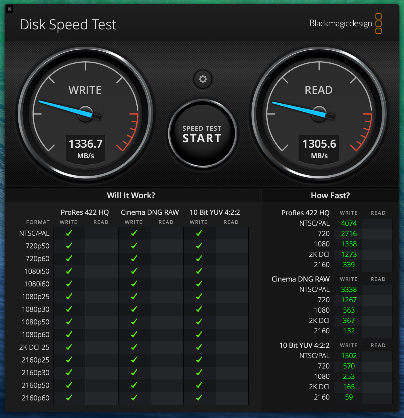

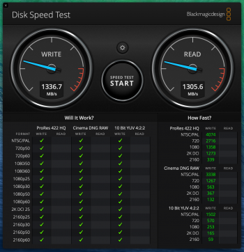

The new SSD is way faster according to Blackmagic test. The system wakes up perfectly fine when I close the lid and open it again after a few mins/hours. It also comes back after hibernation when I reach 0% battery and plug it in. No commands, no adjustments of any kind. It's been two times now that I left it unplugged over night, lid closed, and I have almost 100% battery in the morning as well (Wifi on and my usual apps open; as I would do before the SSD replacement).
