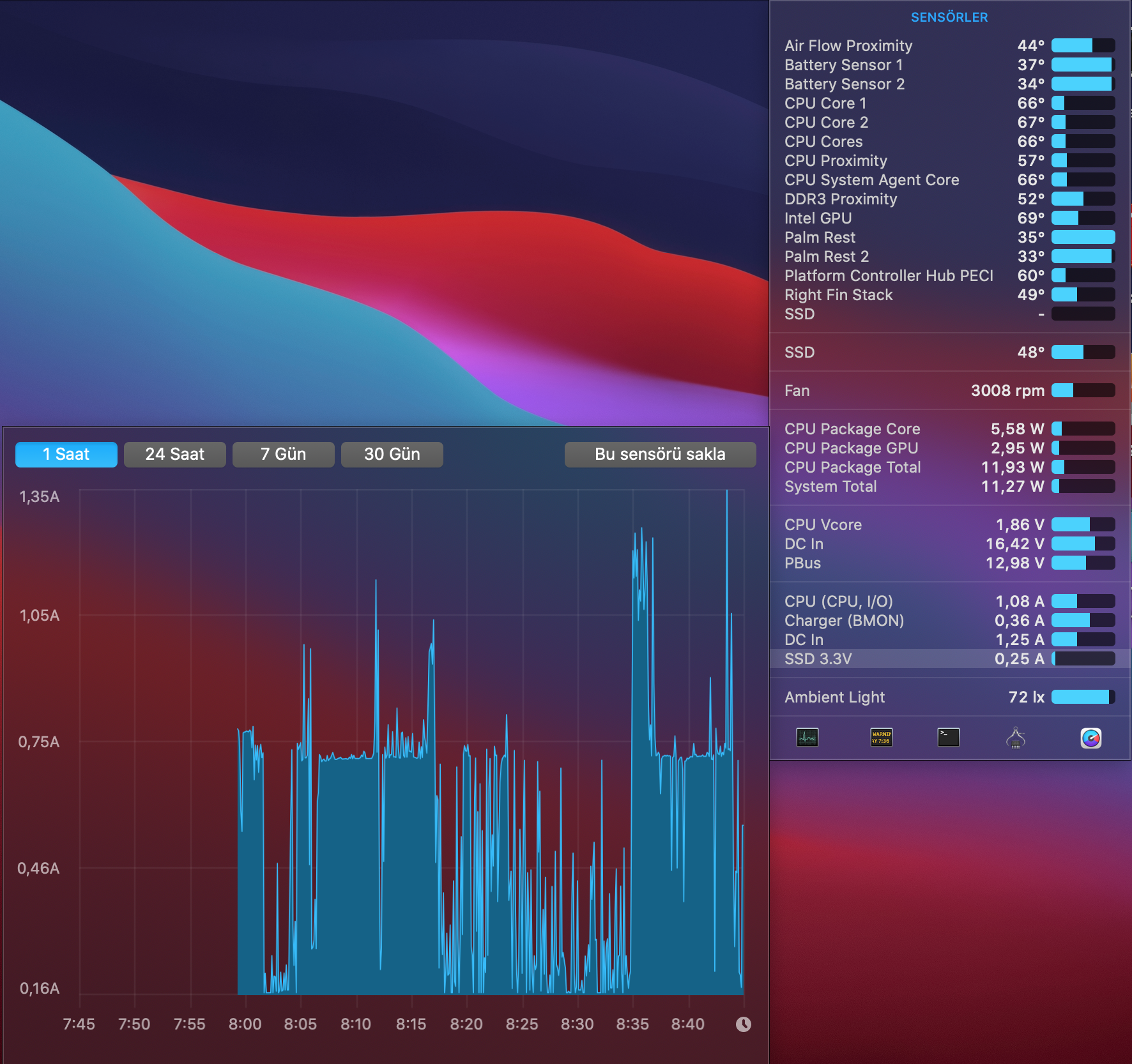

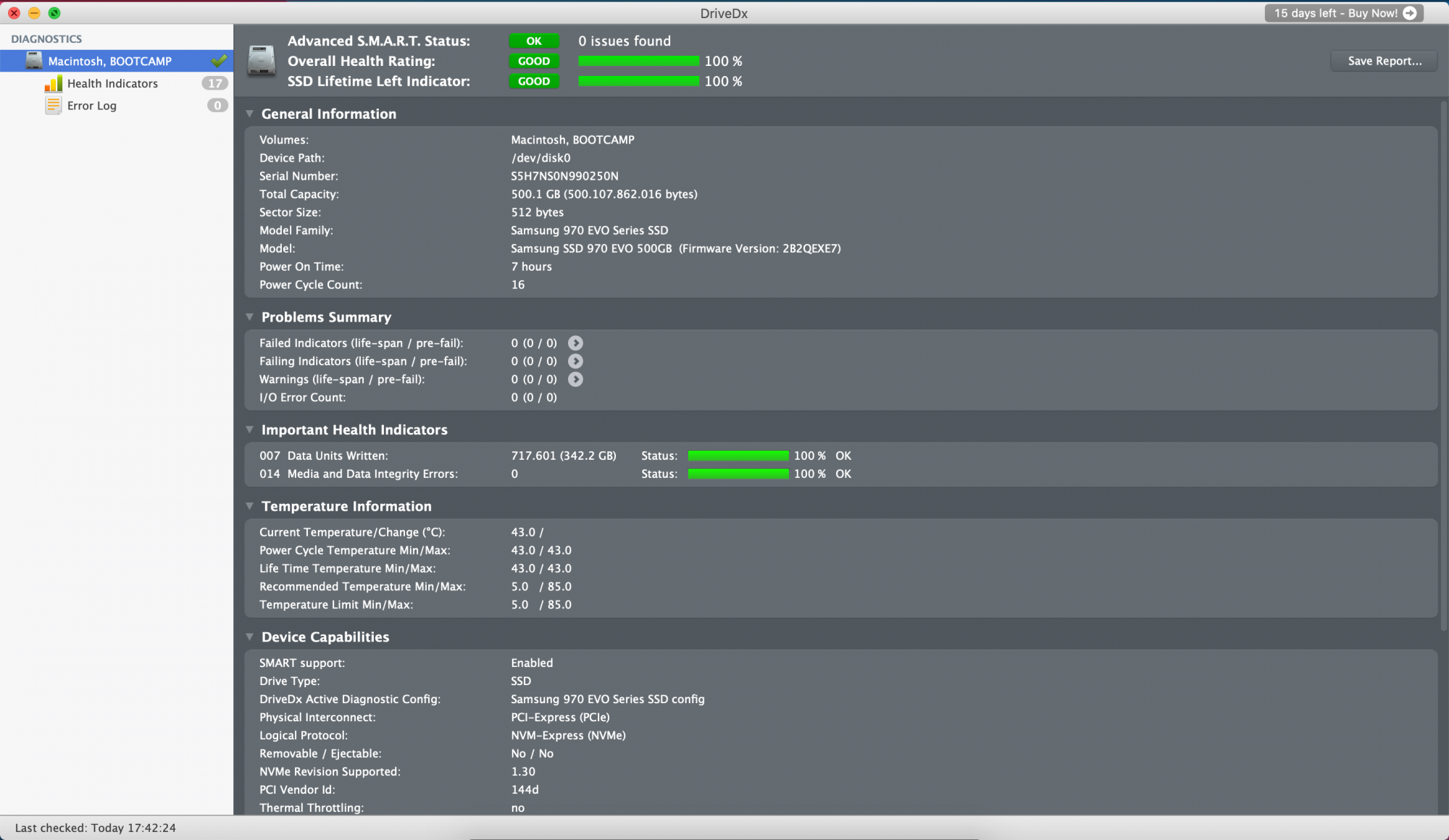

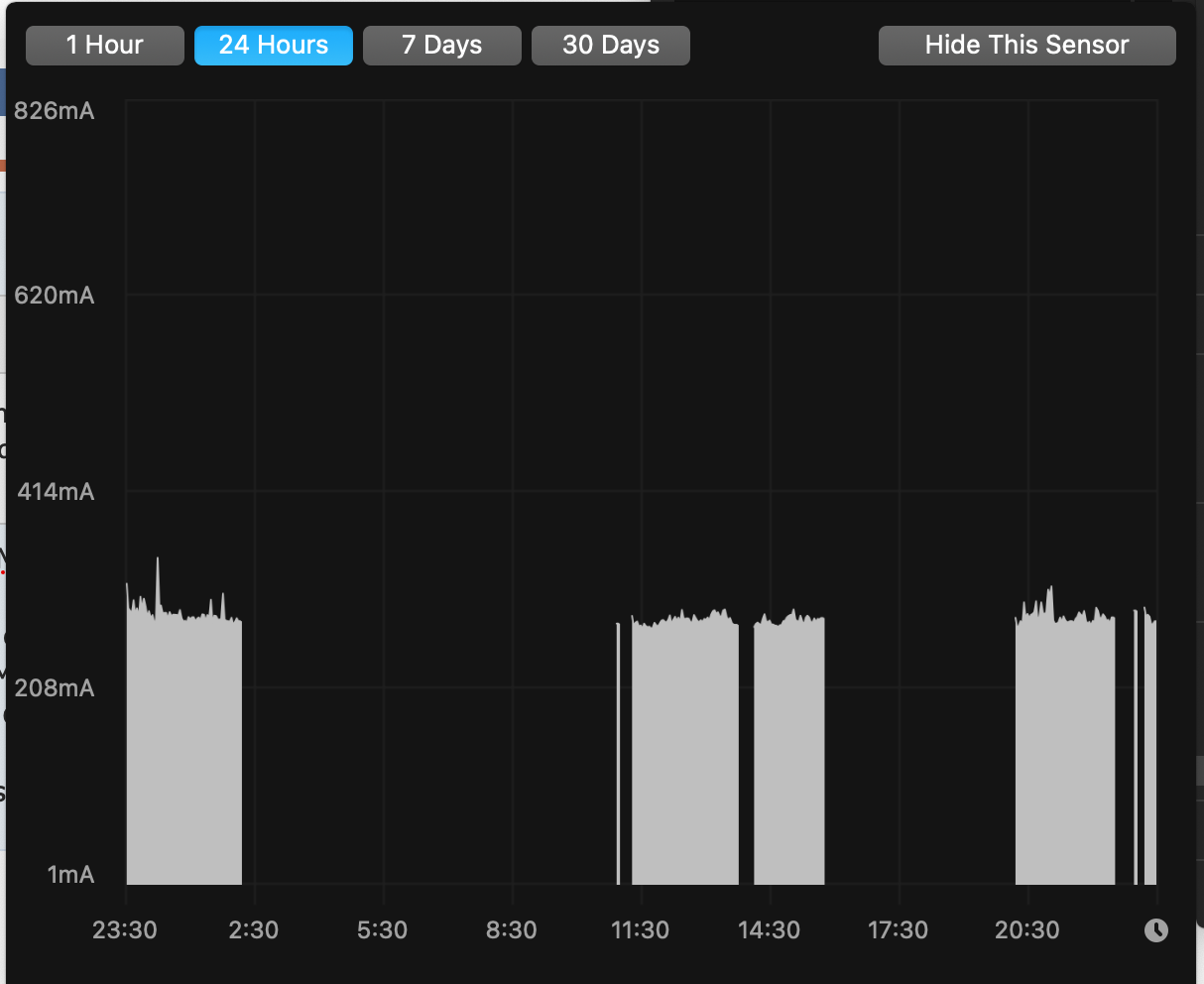

I'm using macOS Catalina. Yes, the temperature is normal in the previous image. But when I load a little, the temperature reaches 104 degrees. I can cite file copying as an example. The temperature rises and falls fast. It wasn't like that before replacing the SSD. I used to use the Mac's own fan settings before, but the temperature wasn't rising that much.
I don't think NvmeFix is installed properly. How can I understand this?
Is it normal for SSD to go up to 1.38 A?
There are two SSD temperature indicators on the iStat. One of them doesn't work.
Thank you for taking care of me. I would be glad if you could help.

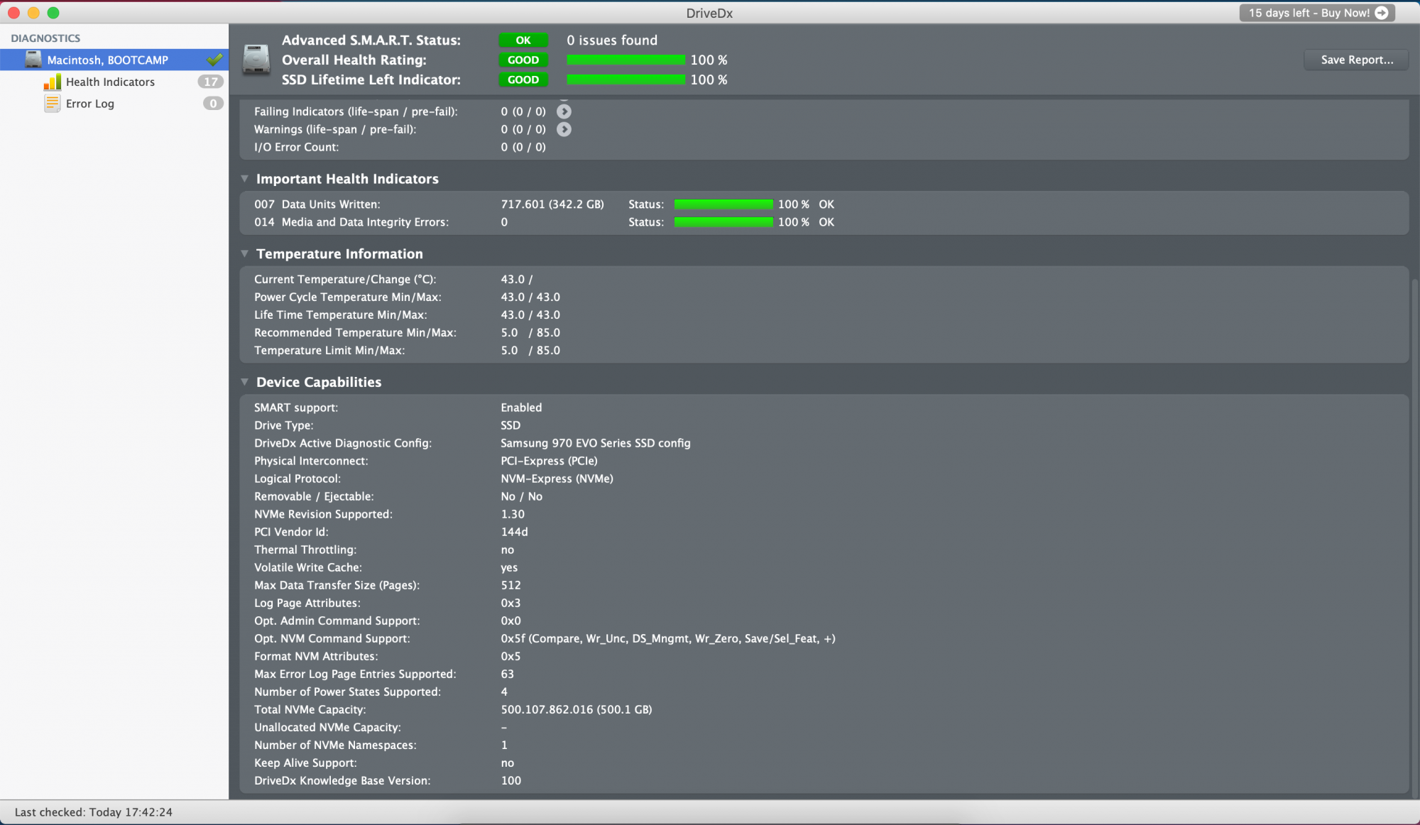

@otosan
Disk Utility:
"Physical Drive:
Device Name: Samsung SSD 970 EVO 500GB
Media Name: AppleAPFSMedia
Media Type: SSD
Protocol: PCI-Express
Internal: Yes
Division Map Type: Unknown
S.M.A.R.T. Status: Verified"
DriveDX:

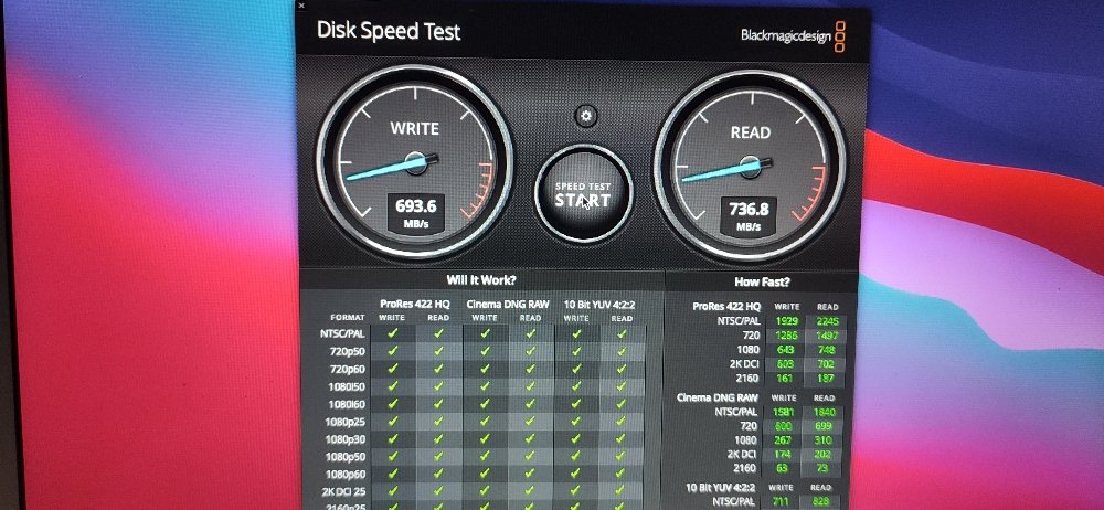

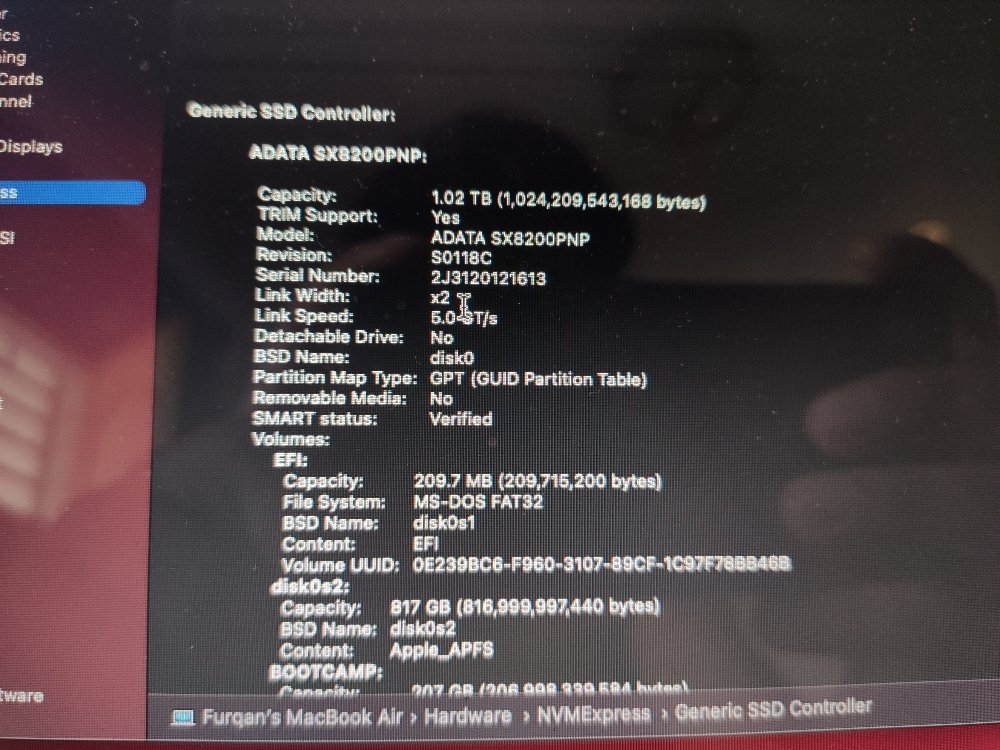

I am use adata xpg sx8200 pro 1tb on my MBA 11" 2014. Is it normal speed just w/r 700mbps?
It's not.
it should hit at least 1300/1000 on 11 inch model of 2014
what is the lane width showing in system report ? is it x4 or x2 ?

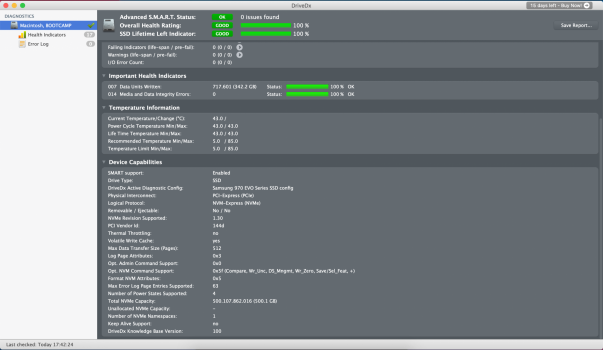

@otosan
Disk Utility:
"Physical Drive:
Media Type: SSD
Internal: Yes
DriveDX:
Yes, i've seen 1.2A even with original SSD, so that aint strange under load condition.
as long as its not hike up to that current during idle, i guess nothing to worry about.
but then, 970 is always slightly hotter by default, because it supposed to be a high bandwith ssd.

Hi @turkay..we have same setup of mba + ssd..how much speed u get from adata sx8200 pro...im only get around R/W 700..if u speed highr than mine, maybe my ssd got problem i guess...

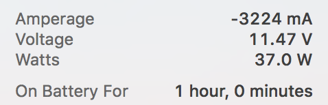

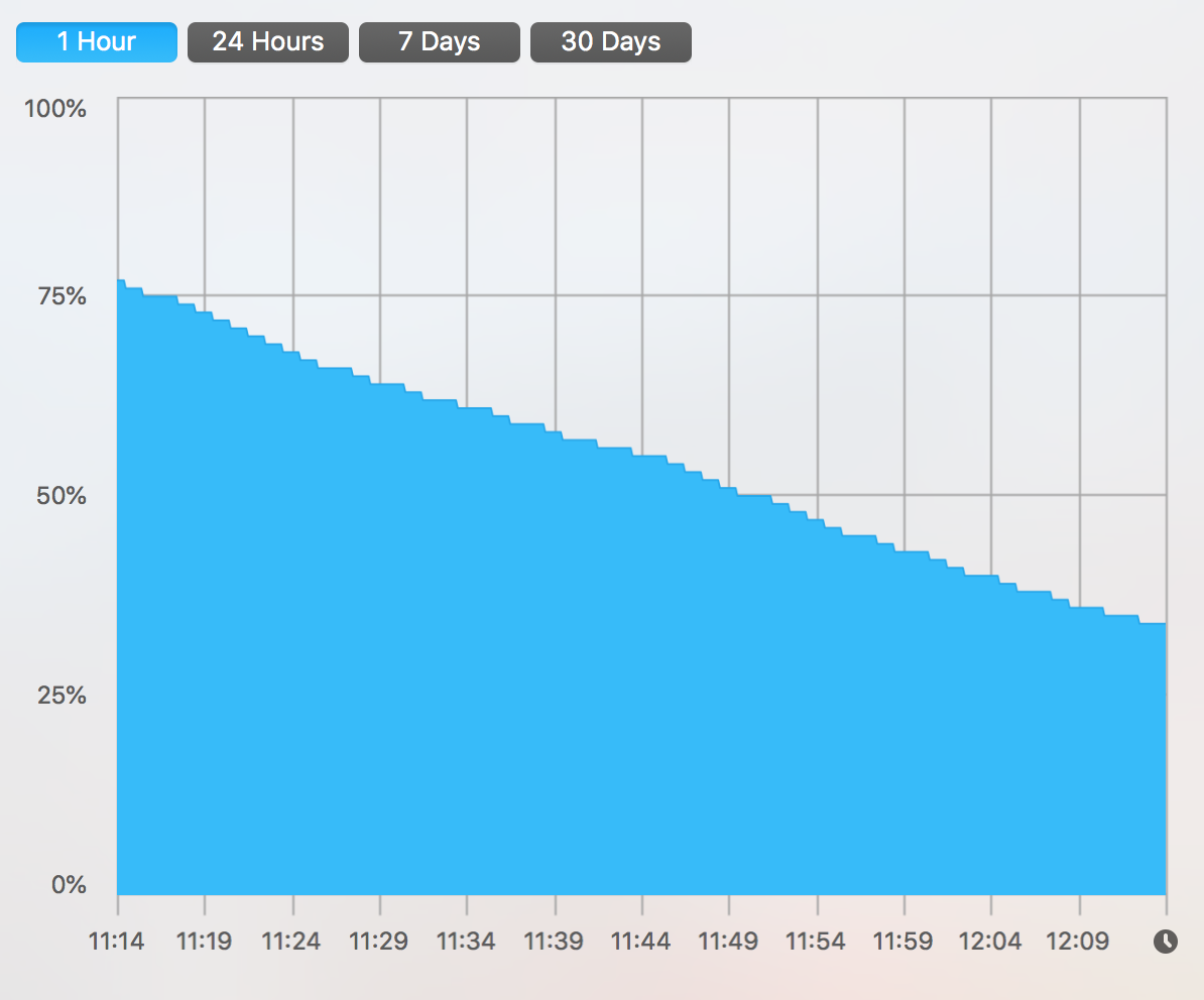

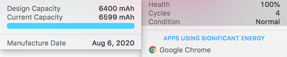

So with light browsing (not looking at videos) on chrome I'm hovering around -1100mA or so drainage on average. However...I've seen it peak at like -3,224mA while watching youtube in chrome and that... seems to be abnormal afaik. Sometimes it hovers over 2,000mA just doing light browsing. Brightness at about 50%.
Is this drainage normal? I feel like the oem mac battery did not drain this fast, but it's been over 7 years since I had it new so I can't remember. Was hoping to breathe some new life into this guy with a new batt/ssd but it seems like it eats juice really quickly and was unsure if it was the new SSD, the new battery, or it's just normal.

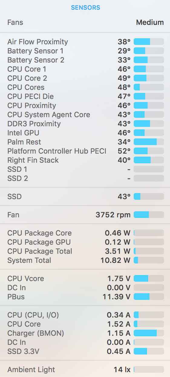

Late 2013 rmbp 11,1
High Sierra 10.13.6 (Clean install)
Firmware: 427.0.0.0
Samsung 970 evo plus with sintech adapter TRIM enabled, Latest Firmware (2B2QEXM7)
Newertech 72W battery brand new and completed power calibration
Reset SMC
I set the fans to medium in iStat Menus (hence 3752rpm). If i go back to system controlled it hovers around 1300rpm.
This speed is normal if the PCI lane only showing x2. But it means your adapter or board is not normal
Late 2013 rmbp 11,1
Firmware: 427.0.0.0
Reset SMC
One of macbook air unit i handle is hovering around -1200mA to -1500mA during light task with full brightness and WiFi on. So i guess thats number pretty normal.
I Use sintech long black adapter...what kind adapter that can up mu ssd speed?
Dont use sintech long adapter with SX8200 pro,
the space is way too tight for the bottom component of the ssd. Not to mention the potential bending which might cause solder breakage.
get short one. dont have to be sintech. sintech is no longer leader in adapter game. if any, getting it from reseller might only increase chance of getting fake sintech.
Tq @otosan ..just bought the short adapter..will update the result..
