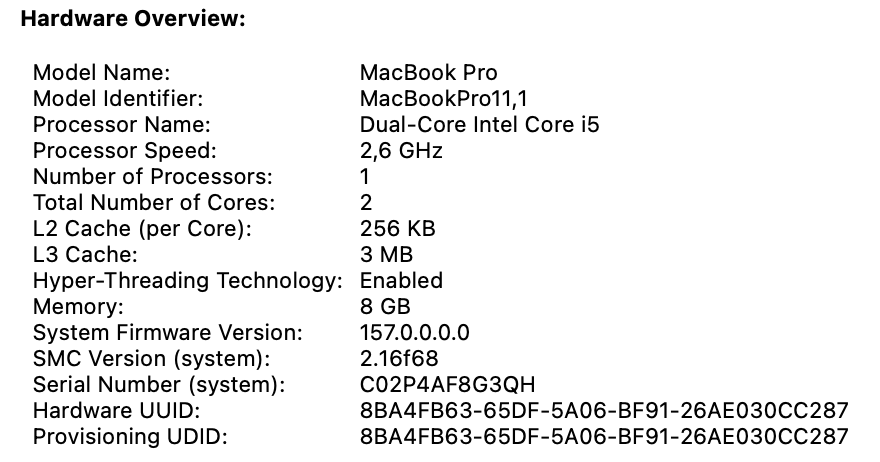

Last week I updated just the OS. The SSD replacement I did a couple of months ago. But anyway, I am using the SanDisk Ultra 500gb and updated the macOS directly on it.
Initially I installed the OS using time machine. I created the bootable macOS on a USB flash drive, did a backup on my external HD and changed the SSD.
Reactions: klyno
Are you using a MBP11,1?
It's a mbp 13 but it's viewed as a mbp 11,1 in the system information. I have already seen the case before to some other people.

Thanks. I have already tried to shutdown and power it back as you have written in your previous post. The thing is, nothing happens.. Also the 1st partition to boot when I power the mb back up , is the windows / bootcamp one. Thus I have to press alt and chose the macOS one. I'm afraid that doing this somehow won't take the firmware update into account (just a supposition). Also I have an EVO 970 (500gb) installed (latest firmware), hope it isn't a problem source aswell. I should try with another ssd or without the bootcamp partition I guess, or maybe fresh install big sur. Or just wait the next big sur (small) update that will magically resolve this.
You are likely referencing a file that does not exist. Did you obtain the system firmware file from the macOS Big Sur installer app? I recommend placing the system firmware file into a folder on your desktop or similarly accessible in your home folder. Hope this helps.
you are correct this helped and produced the attached logs, but when i shut down and power up again nothing is changed
The messages look exactly like mine; the system firmware appears to be staged correctly. The only thing I do afterwards is select "Shut Down..." from the  menu, wait 5 seconds after the screen is dark, and then power the system back up. I do not use bootcamp, and I have my startup disk set to macOS.
