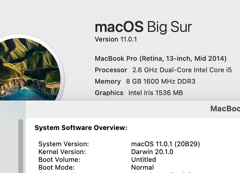

I have a late 2013 13" and mid-2014 13" and used Apple SSDs to upgrade to 11.01. Both are now running bootrom 427.0.0.0.

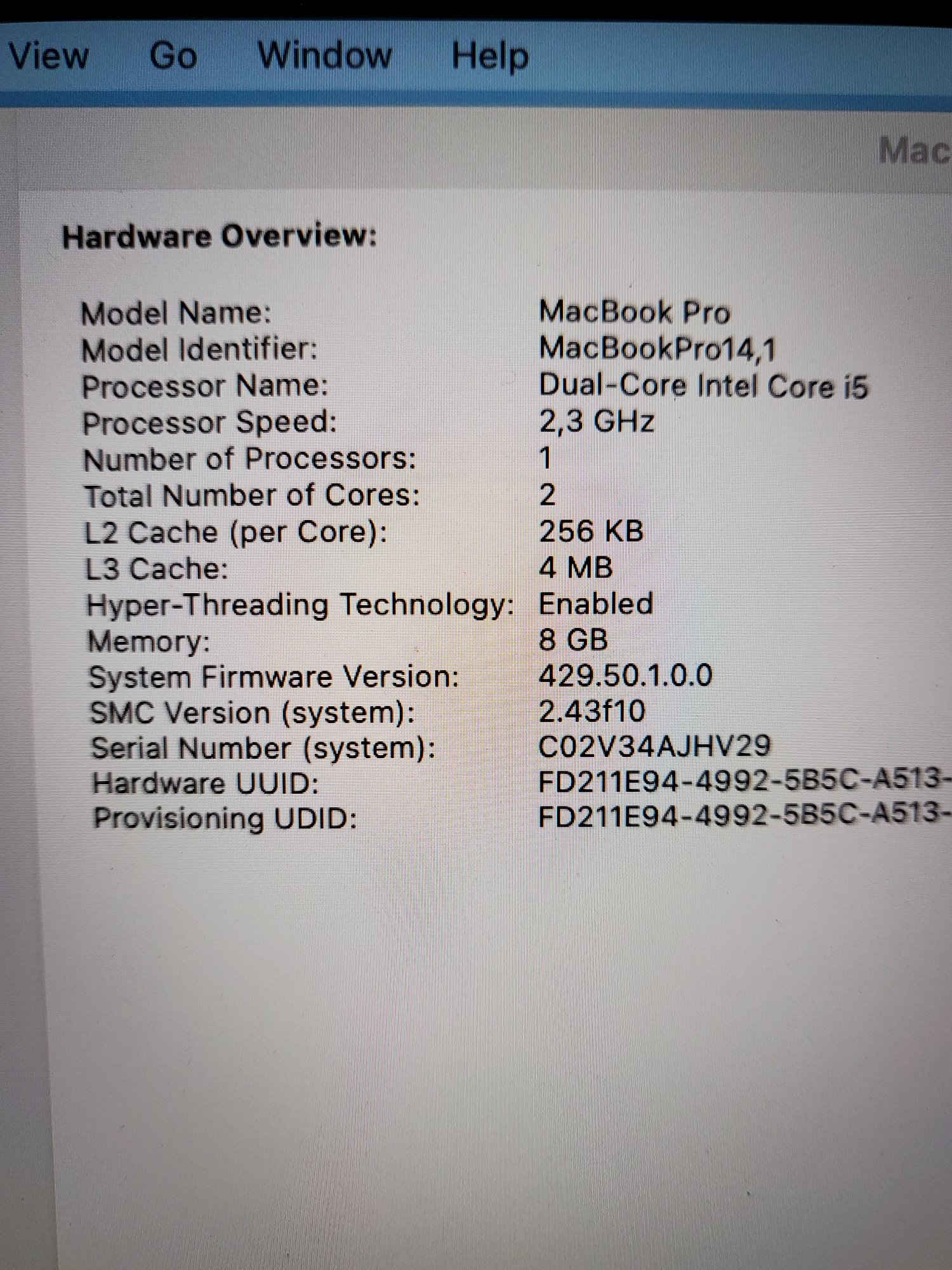

this is from MacBook Pro 2017, the bootrom updated to 429.50.1.0.0 when i installed BigSur 11.0.1 using USB installer directly to the new NVME drive installed inside.
EDIT : After some checking, turned out this is how the BootRom should be on supported Macbook Air and Pro model :

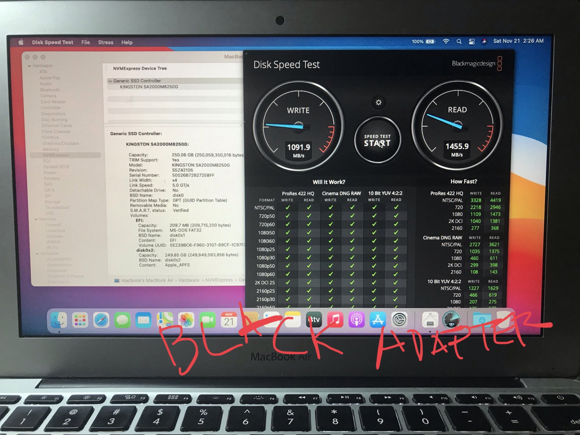

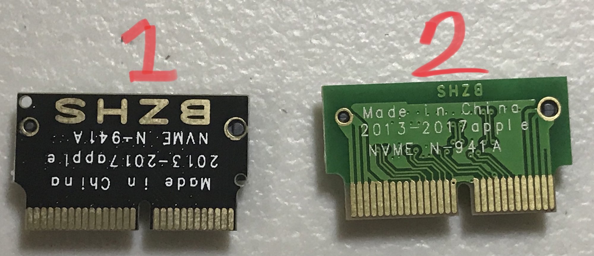

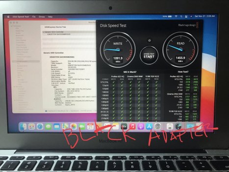

MBA 11 inch Mid 2013
Big Sur
boot rom 427
ssd Kingston 250gb
1. Black Adapter, good and the speed X4, read 1400 write 1091 mb/s
2. Green Adapter, good no hangs hibernate sleep seems ok but the speed only X2 700 to 800 mb/s r/w
mba 2013 to 2014 green adapter have an issue with the speed
i try with mbp 2015 A1502 green and black adapter same no problem with the speed X4

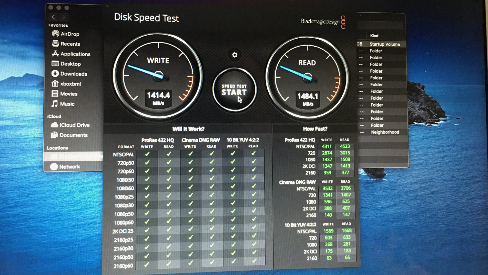

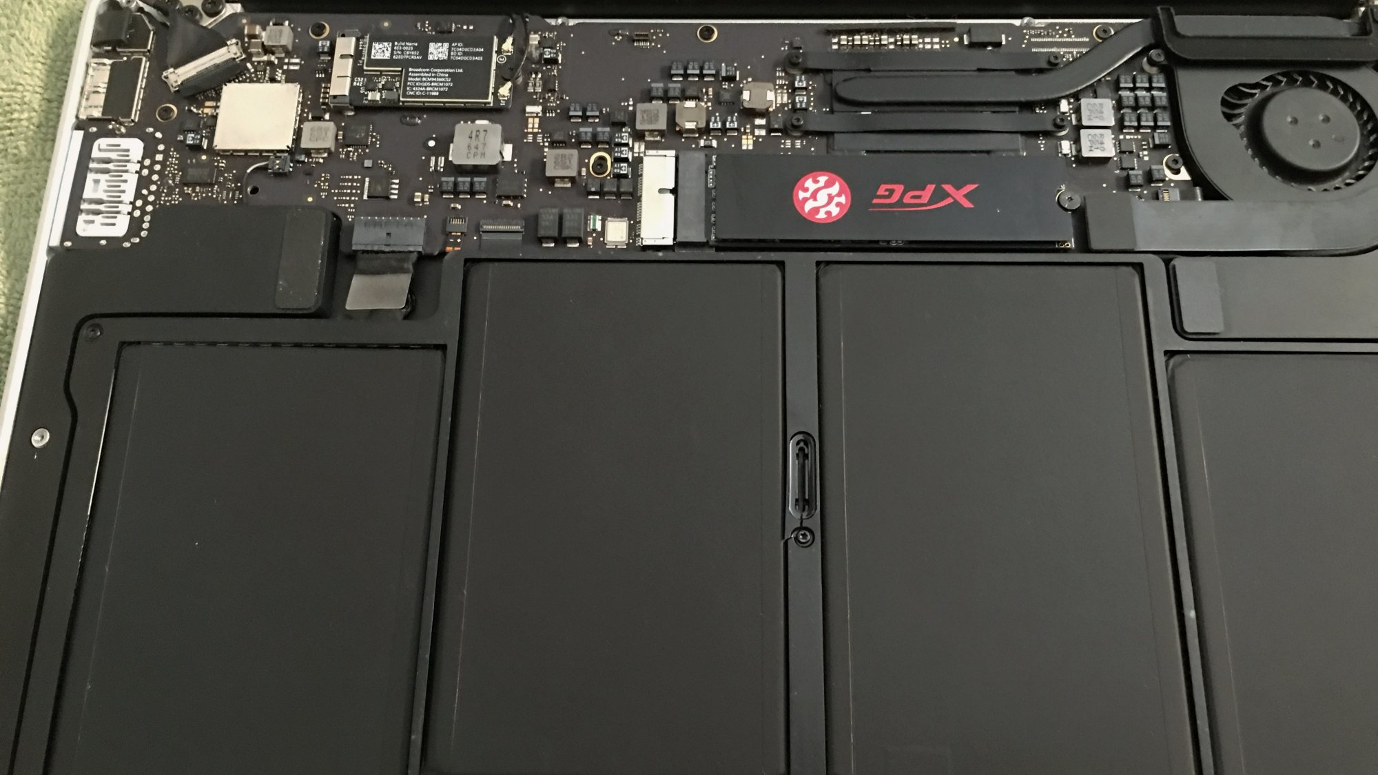

Hi All, I've read through the OP and would like someone to confirm this
I have a MacBook Pro Early 2015 A1502 with a Jetdrive 820 in the system (Installed when bought)
This drive seems to have very slow write speeds
I would buy the Sintech adapter and a Adata xpg8200 pro.
This would work just fine right?
That's exactly what I have. Yes, it works very well! Been running it for a couple months now.
