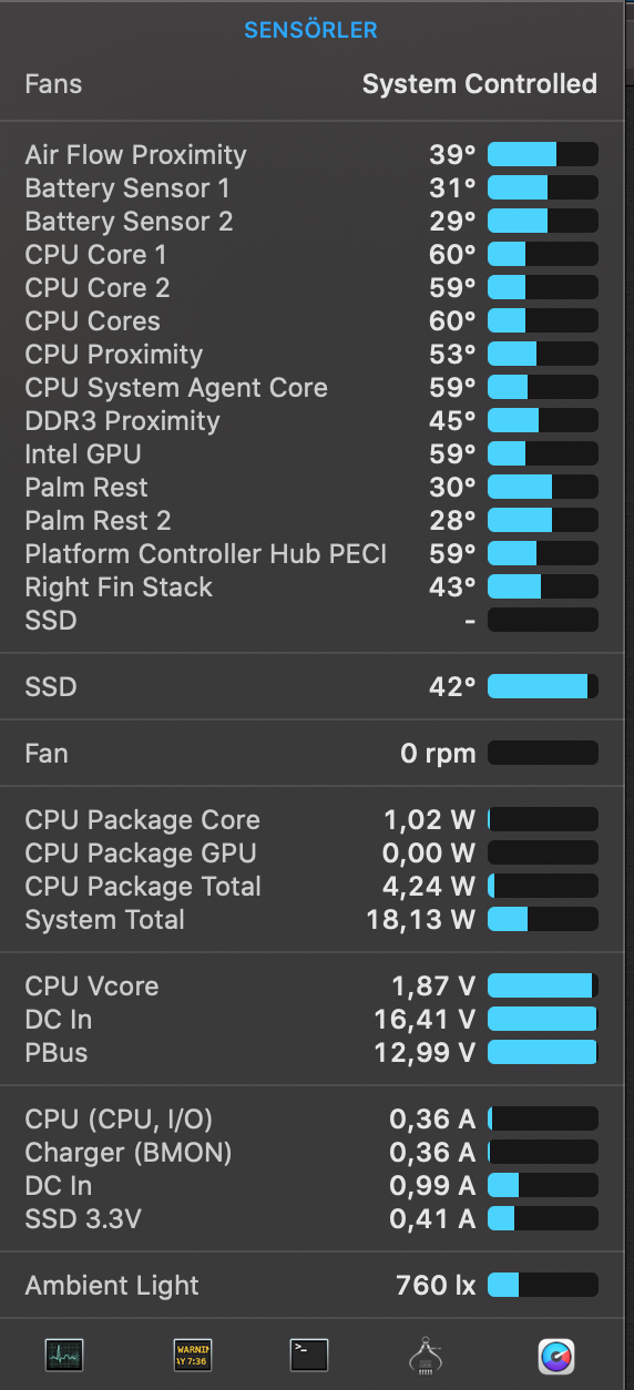

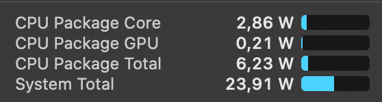

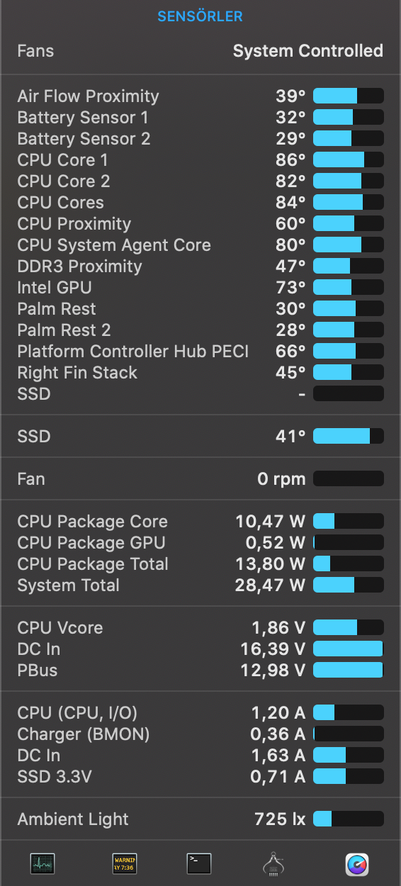

Why is the system consuming so much power? The processor consumes 4.24W in total. Who consumes the rest? I think it's SSD. I regret doing this procedure.
13 inch MacBook Pro A1502 (970 Evo with NVMeFix) (Boot ROM: 424.0)
@otosan
@mo5214

Yes, i've seen 1.2A even with original SSD, so that aint strange under load condition.
as long as its not hike up to that current during idle, i guess nothing to worry about.
but then, 970 is always slightly hotter by default, because it supposed to be a high bandwith ssd.
