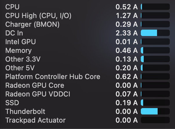

After going through the past twenty pages of the thread, I just installed the 2TB Sabrent Rocket (SB-ROCKET-2TB) into my MacBook Pro (Retina, 15-inch, Mid 2015) using the Sintech NGFF M.2 nVME SSD Adapter Card. While installing the nVME drive, I cleaned the interior of my MacBook Pro alongside applying new thermal paste to the CPU and GPU. I also started with a fresh install of Big Sur 11.1 (Boot ROM: 425.0.0.0.0).
After installing the .kext @kvic provided:
When idling, the SSD usually sits at 0.47A. I've seen some drops to as low as 0.07A, but it usually just stays at 0.47A. Even when I have apps open, such as Safari and Spotify, alongside downloading and installing other apps, it sticks to 0.47A. Never increases, but does have moments where it drops.
When I ran AmorphousDiskMark, the highest it went was 0.72A with it averaging at 0.55A.
Is there anything else I should / need to be doing to ensure proper power consumption?
What results do you get when you don't have the kext installed?
I think I may have solved the issue because I'm an idiot.
I reset the PRAM and followed it up with a reset of the SMC. I'm now idling at 0.19A-0.22A.
It looks like that resolved power consumption all across the board.

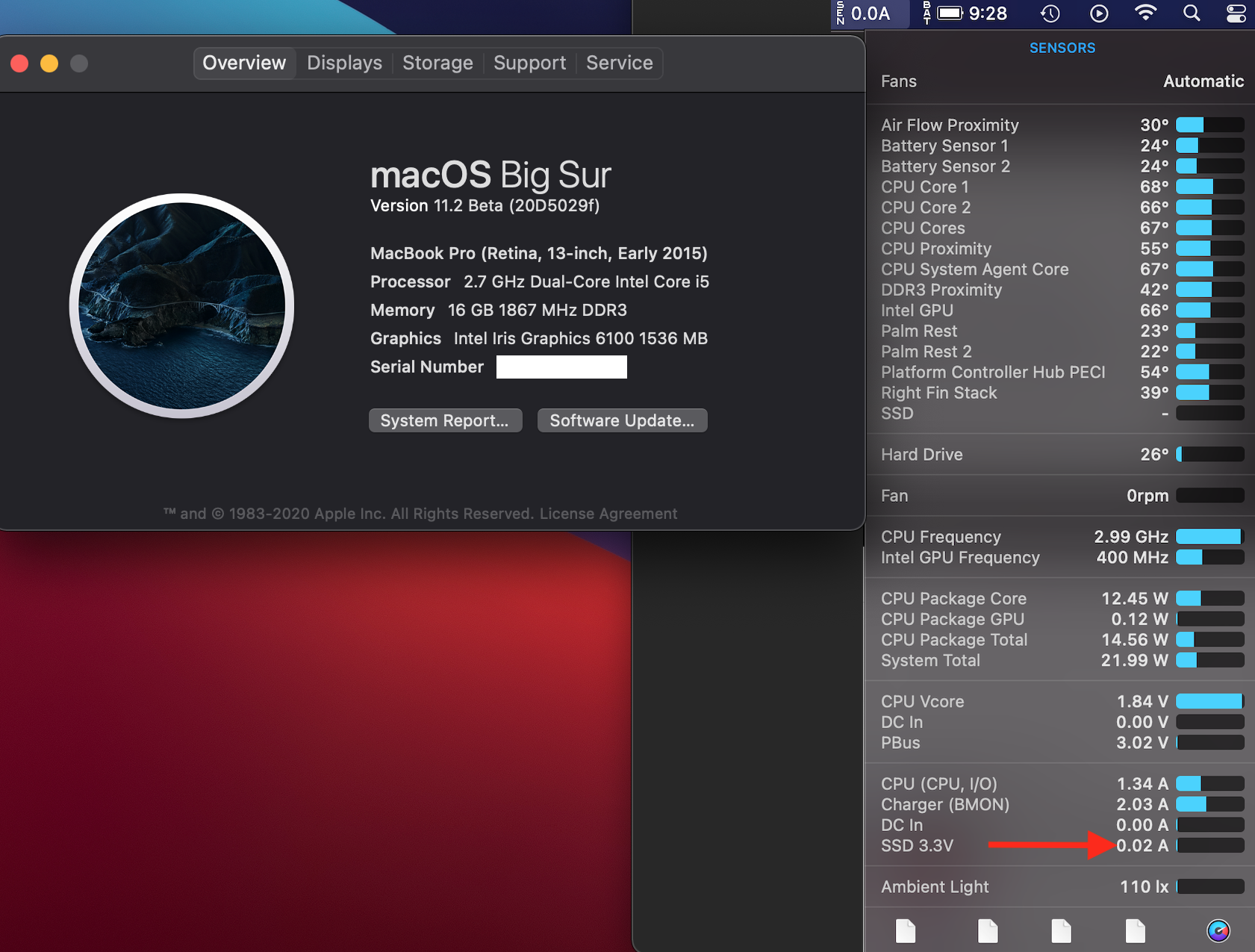

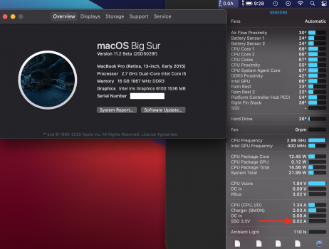

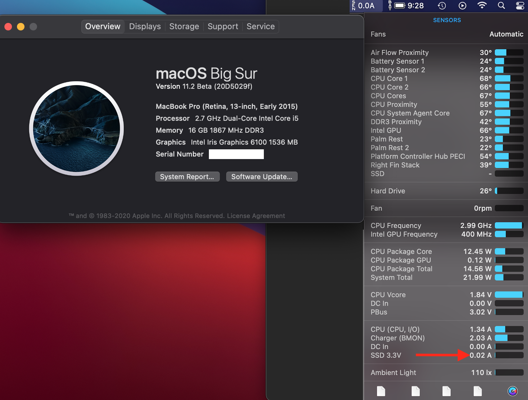

i highly doubt it, sabrent rocket 1TB, even better results with BigSur 11.2 (beta).

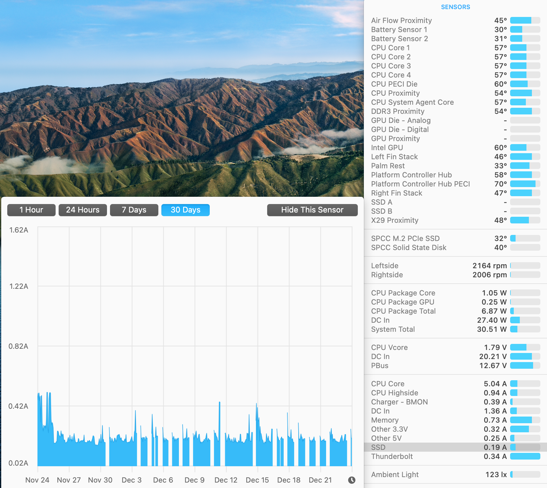

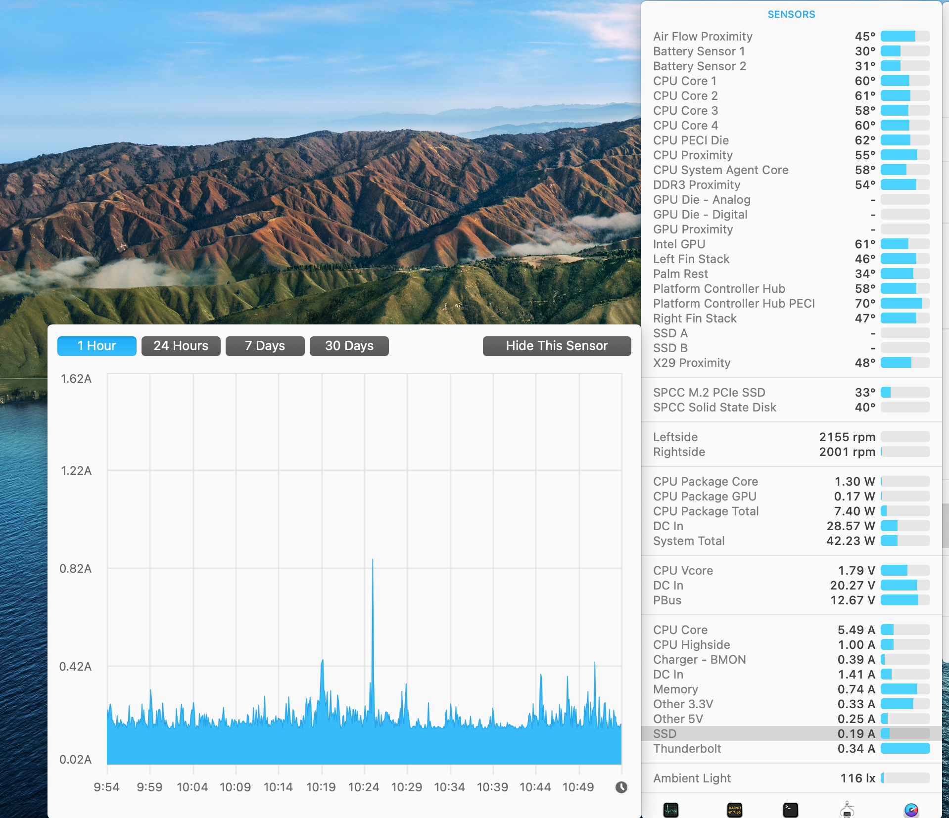

These are my results (since Catalina). Now I am running Big Sur 11.1 with BootRom 429.0.0.0 on a Macbook Pro 15" mid-2014 + Silicon Power A80 (Phison E12) 1Tb. The minimum is at 0.16A. I don't use any kext.
