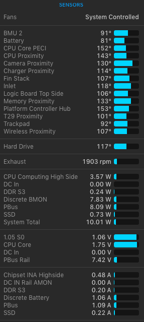

@BoPl How is your Crucial P2 doing?
@crystalwonders
A fresh install of MacOS requires sometime to "break in", lots of background jobs going on and trying to make your Mac run faster. Check again after the jobs are finished. If you aren't sure, just leave your MBA turned on for a day or overnight.
Btw, is 0.22A for your SSD with ssdpmeEnabler installed?

kvic,
I will receive P2 next week. Before that I'm planning to upgrade firmware on my Corsair Force MP510 SSD to new ECFM22.7 and try to install the SsdPmEnabler. And waiting for megaco reply to confirm what is his Sabrent Rocket firmware. For me is the big mission to upgrade firmware on MP510 SSD, Corsair SSD Upgrading Tool doesn't support MacOS and I don't have any Windows PC. So I have to use Boot Camp and install Windows on my MBP to try to upgrade the SSD firmware.

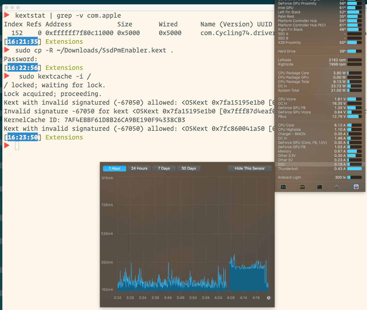

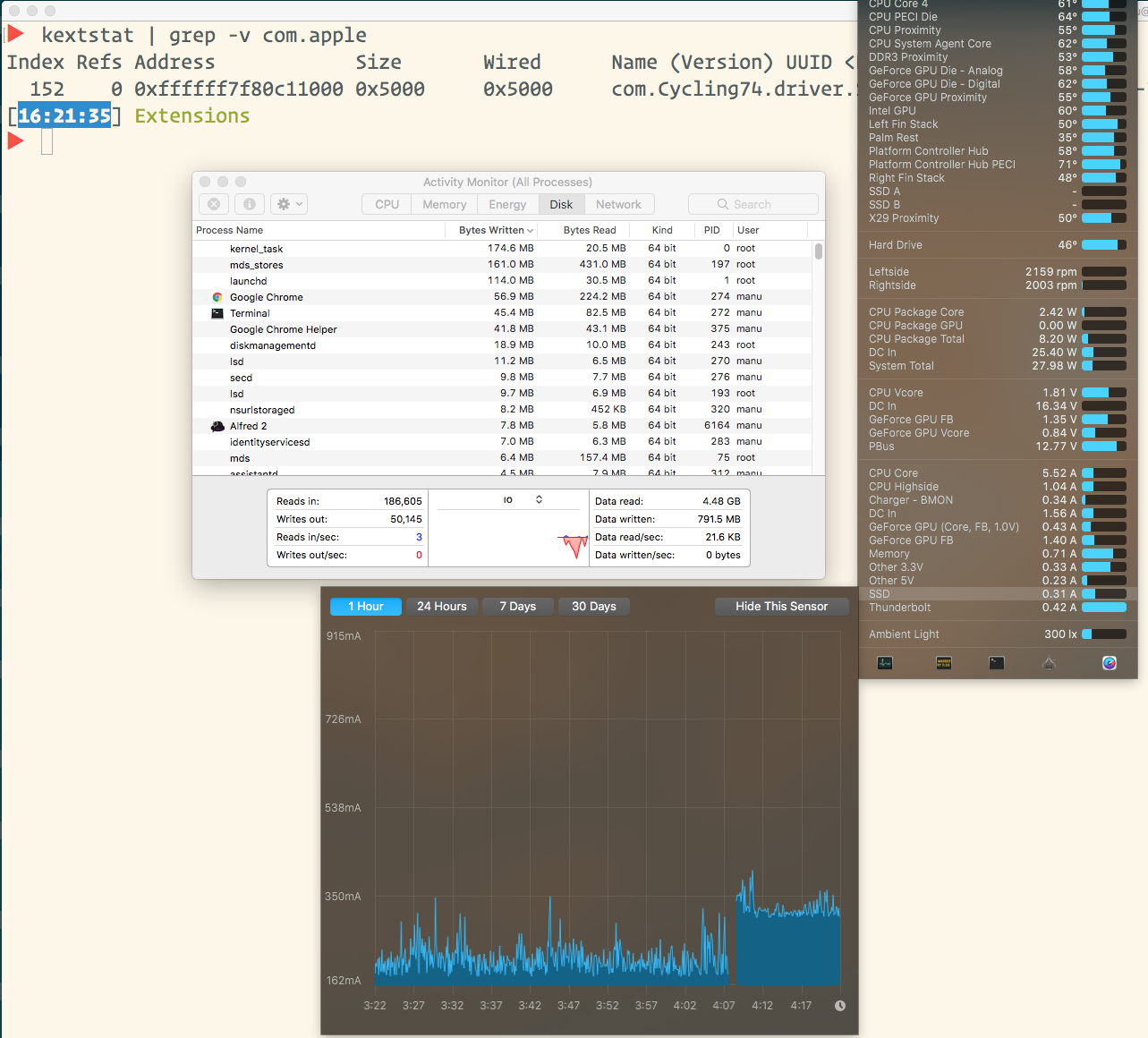

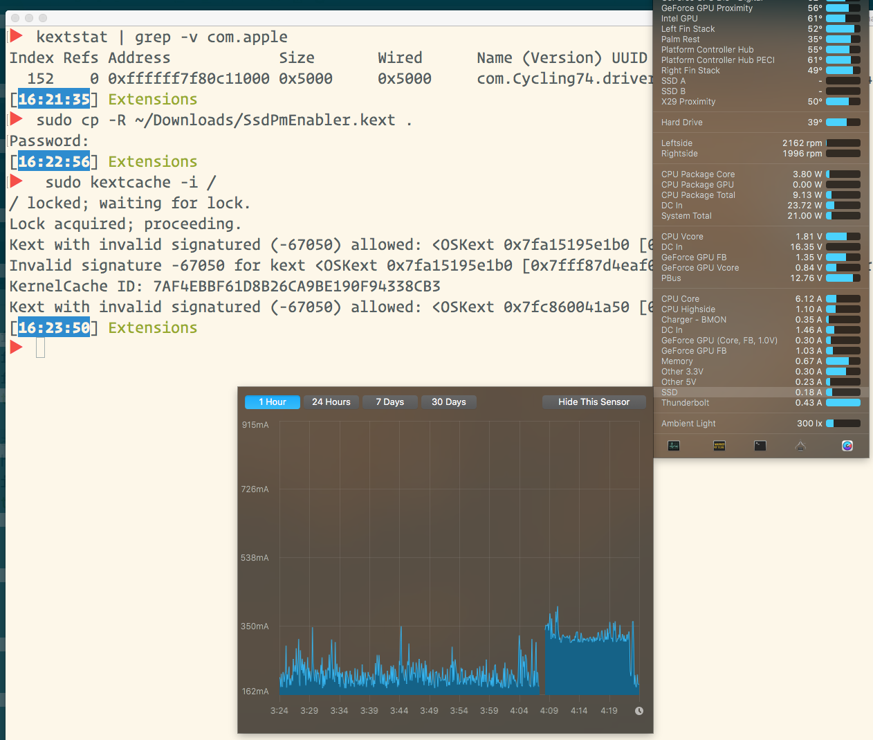

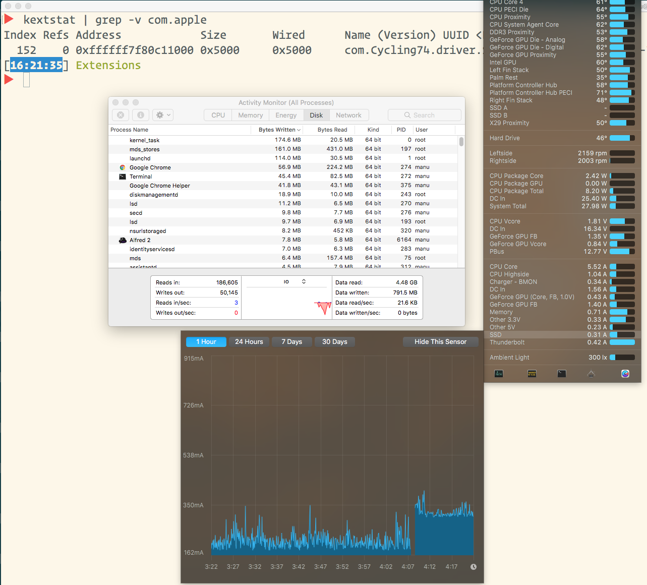

@kvic - Thanks for your response and insight about potential driver related current differences.
With all 3 kexts removed, the lowest I see the current go is 0.31A.
And when loading the SsdPmEnabler.kext again, the current drops back down to 0.18A.

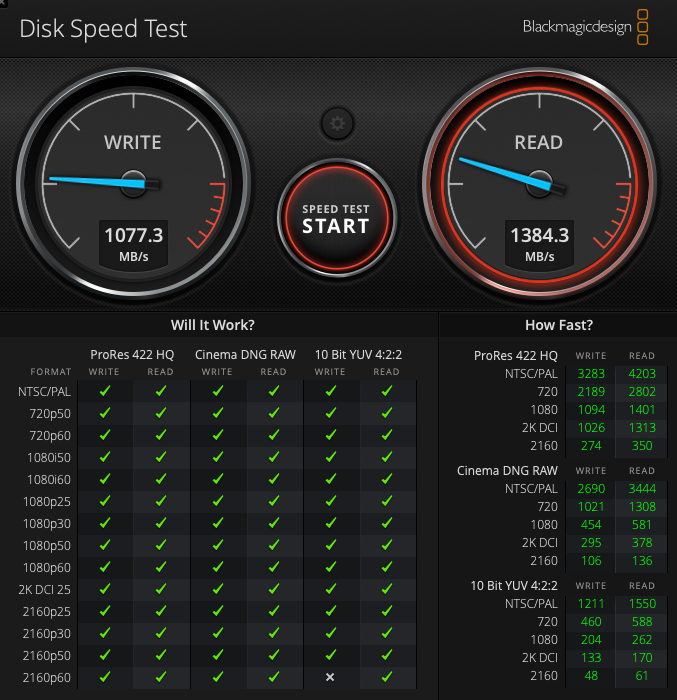

Anyone know of any reasons why my MacBook is running way slower after the SSD ugprade? When I had the original apple SSD everything ran faster. I don't understand what reasons the new ssd would be slower because when I ran the blackmagic test on my ADATA SSD it doubled the speed of my original apple one. My apple one was reading around 300-400. These are the stats and speeds of the current installed ADATA SSD. View attachment 1710127View attachment 1710129
See sig.. I have similar setup as you on 2015 MBA. I have similar numbers as you as well. I have no issues.. Maybe try nvram and SMC reset..
Have similar experience. Measurably slower - but overall it is faster.
Maybe the NVME connection takes some more computing - however it is not visible on the processor load.
Many days ago I am replacing the original SSD and the Sabrent Rocket 1TB with short Sintech adapter as the measurements are not correlated to my general feel about the speed. I feel that the computer is much faster, however all the measurements are the opposite. Maybe the more IOPS helps.
MBP 13" 2015 Early, 256 GB SSD (MZ-JPV2560/0A4), 8 GB memory.
In general: the Sabrent drive gives a faster (smoother) system - although the Blackmagic Speed test shows lower numbers.
On the original Apple SSD I measured around 1400/1400MB/s on the Sabrent I get only 1150/1250.
My system has PCIe 2.0 X4 connection, so the 1400 is really the maximum which I might reach.
I even went back to High Sierra on HFS+ file system, as the APFS was noticeably slower on my device since ever.
Measurements are not confirming it, but I feel a little lag on APFS. I kept HS until November, then I upgraded to BS.
Then did a clean install too on Big Sur (no time machine restore).
High Sierra did 1400/1400 on Sabrent too (HFS+ file system, Filevaoult off, indexing finished).
So APFS and NVME is slower than HFS+ and NVME.
The reason why I'm on Big Sur again is the fact, that I installed ssdpmenabler.kext on HS and after that my SSD started consuming 1,43 A peak. Checked the logs, it was loaded properly.
So with the same usage I do on BS it was consuming much more than BS without the ssdpmenabler.
Now on Big Sur (without the ssdpmenabler) it consumes 0,06-0,25 A. (that's nothing - even on battery).
I did a test, was able to browse the net and listen to music over BT headset for 7 hours (my battery is new).
So no ssdpmenabler anymore, and I'll play with the sleep/hibernation issue as the system consumes 2% per hour from battery. As I usually using it plugged in this is not an issue.

I'm wondering if you could have gotten more speed with a different drive?.. x4 should get better than that I think?. my 2015 MBA gets same numbers as you, maybe a little better.. 1121-write 1322-read.. with the ADATA.
AJA System test gives 1350/1350 on Big Sur for 1GB test file in my home directory.
And now I have at least 40 open tabs in various browsers plus bootcamp vm running.
Skype, Spotify, Qbittorrent runs at the background.
In my opinion other SSD would not be (a lot) faster. PCIe 2.0 X4 limits the maximum around 1400.

On Big Sur the power consume is mostly under 0,5A which is fine. I mean this is not significantly decrease the battery operation time.
The big issue is the sleep. It seems it does not go to sleep at all and consumes even more energy than in normal operation. 2W/h is a significant energy usage while the rest of the computer is in low power state.
And now the SSD consumes 0,35A.
In my opinion the core issue that Big Sure seems to use the SSD as cache memory.
Swap is often used - and this free up the main memory. In my opinion at these times the SSD slows down.
Never managed to hang up the system, but I was able to consume much more memory then I have (8GB).
This means the swapping on SSD helps.
Of course at this time I measured 400/400 on Blackmagic. Most probably the rest of the bandwidth was used by the system.

My MBA upgrade report & problems:
  • Config: MBA 6.2 13” mid 2013
  • Mojave 10.14.6
  • Upgraded to Adata SX8200 PRO 1 TB
The upgrade about half a year ago went well. But I do run into occasional kernel panic, about once every two weeks. I’m thinking about putting Kapton tape on the system board under the SSD as suggested here #7,381. I’ll let you know if it helps.
With the security update of Mojave 10.14.6, my bootROM was upgraded to 429.0.0.0.0 and this happened with the Adata SSD inside! That’s the good news.
The bad news with my Adata SD8200 is that NVMeFix & Lilu won’t make any difference in SSD power consumption.
So I was thrilled to read @kvic SsdPmEnabler.kext solution as it would reduce the consumption about 50%.
This didn’t work out well:
  • Followed the manual to the letter, checking the input before executing in Terminal
  • It all went well until I tried to update the Kext cache. 10 sec after doing so I got a Kernal panic and it couldn’t even reload the MacOS completely anymore: the Apple logo screen loaded very slowly and near the end of the white band, it created a never ending circle of kernel panics.
  • Turned it completely OFF, restarted and same thing happens.
  • Uninstalled the kext in recovery mode using “If your Mac does not boot…”
  • Rebooted normally
  • Tried the entire process again starting at “Disable part of SIP”
  • This time I got past the update of the kext cache, I got the signature warning (didn’t get that the first time as it takes a while to appear)
  • I executed the kext load and when I was about to check if it loaded correctly, it had another kernel panic resulting in the same loop of kernel panics.
  • Uninstalled it again and all was back to square one.
So as a conclusion: the SsdPmEnabler.kext doesn’t work for my configuration so far.
@kvic Hopefully you have some time to update your kext to make sure it will work for my configuration? I’m available for any assistance.
Would be great as it’s the only way I can get my power consumption under control with this SSD!
I don’t have iStat but I definitely notice less battery life with the CPU area being hotter than before.
Many thanks for helping!
