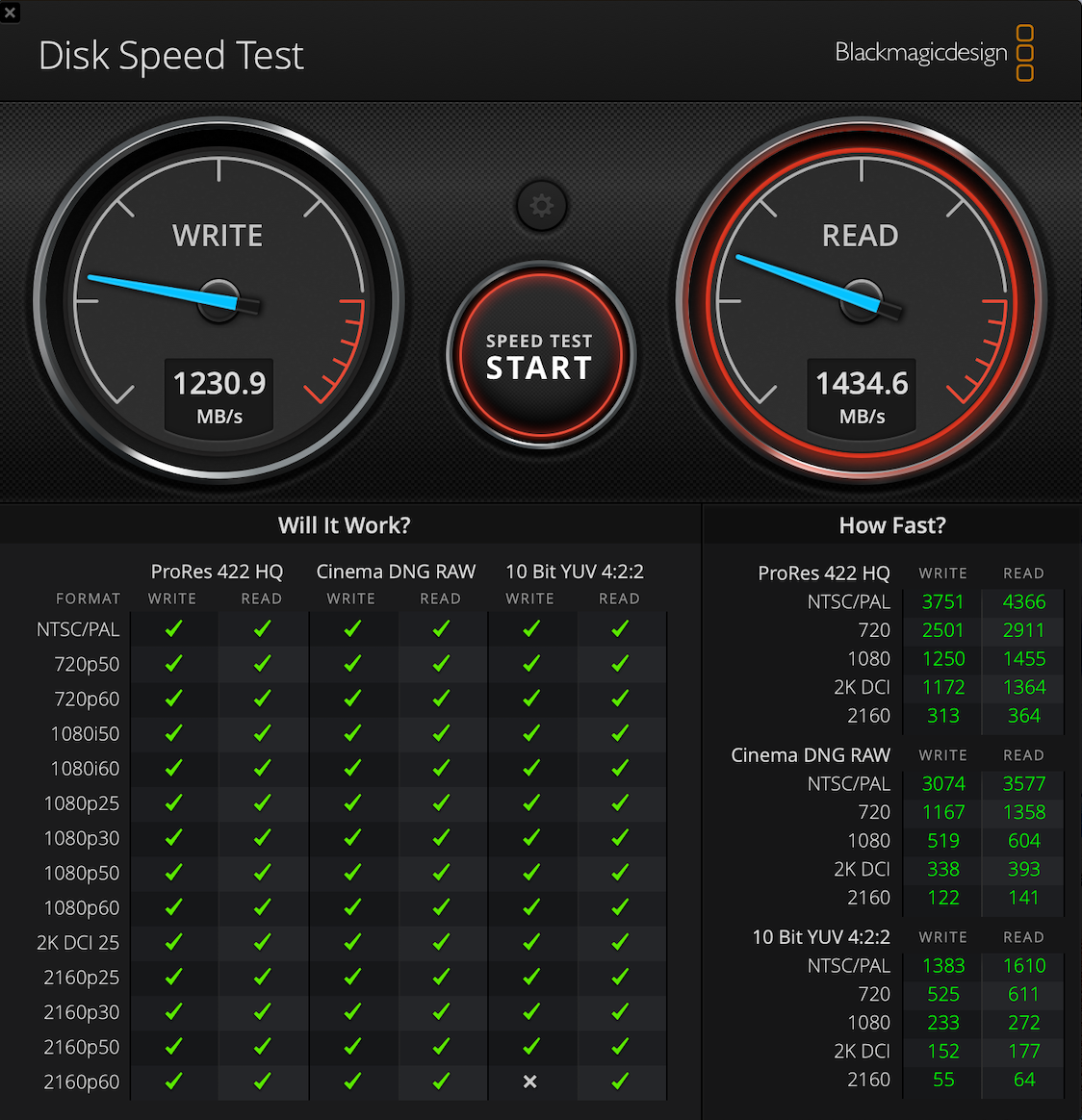

My experience with the Crucial P2 is good. I have the 2TB version and apart from doing benchmarks o_O, I have had the chance to actually work with it and collect some real-world experience, which also are positive. The SSD performs better than the original Apple SSD. I would recommend you do the usual tests before and after the swap, so you know what you got.
AmorphousDiskMark
iStatMenus
Blackmagic Disk Speed Test
AJA System Test
All of these tests offer different helpful info for you and others, so please post your results here.

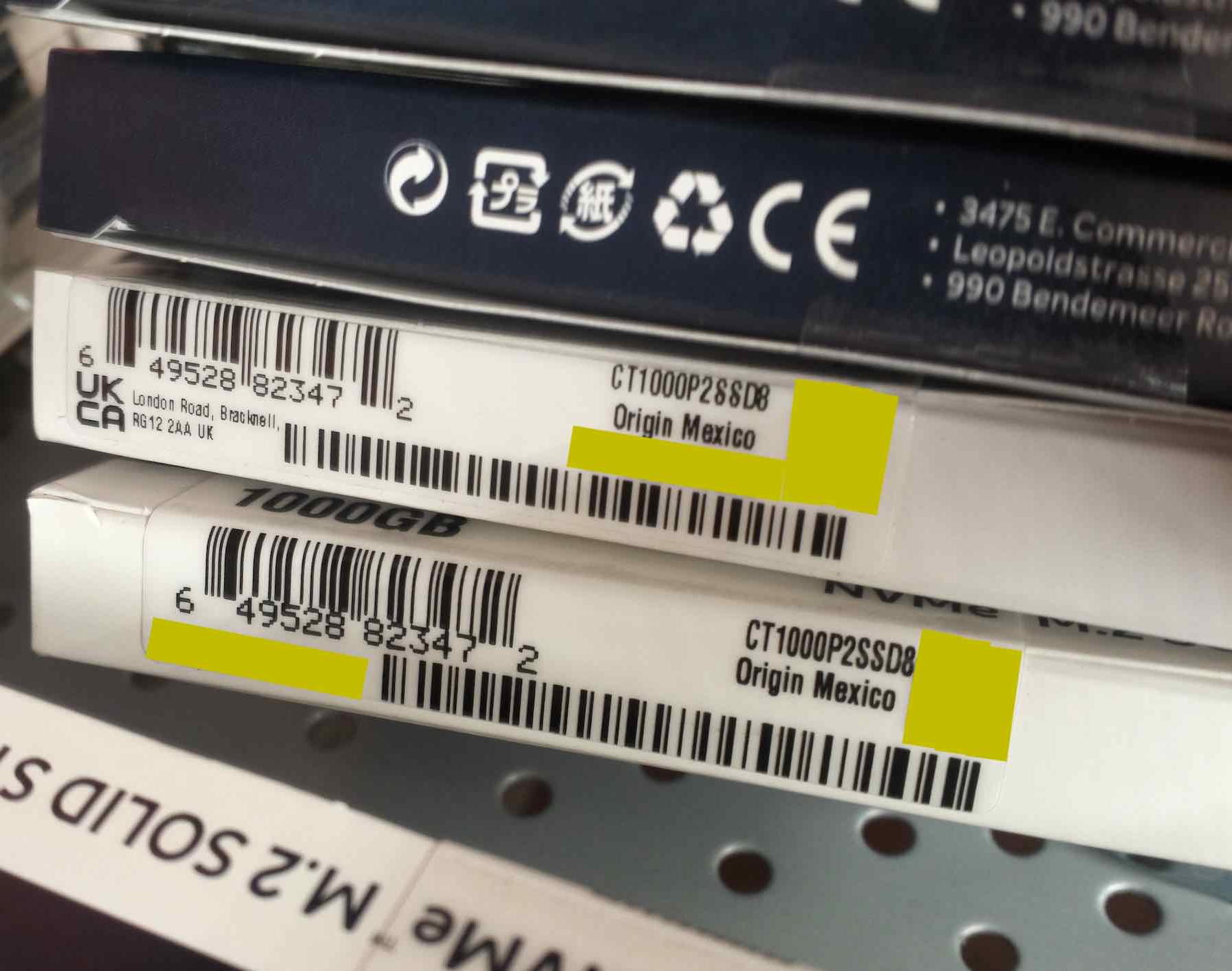

About the “bad” P2:
I haven't checked my SSD if it is QLC or TLC, because you'd need to install Windows to find out.
It is confirmed by many users that there are two or more different versions of the SSD, which perform better or worse.
So you better buy somewhere where you can return the SSD easily, in case the performance is not good enough.
In my personal experience, I have seen one “bad” P2 out of three (all 2TB bought between May and August 2021). With the bad P2 the performance dropped drastically after 32GB written. This was quite similar as described in this article:
So you can easily find out just by running a large file test or a continous test in the benchmark programs.
Also the article gives a hint how the lower quality P2 can be identified from the sticker. Not sure if this really works.

P.S.: My P2 came with the P2CR033 firmware but not UK/CA on the label (like the linked article mentions).

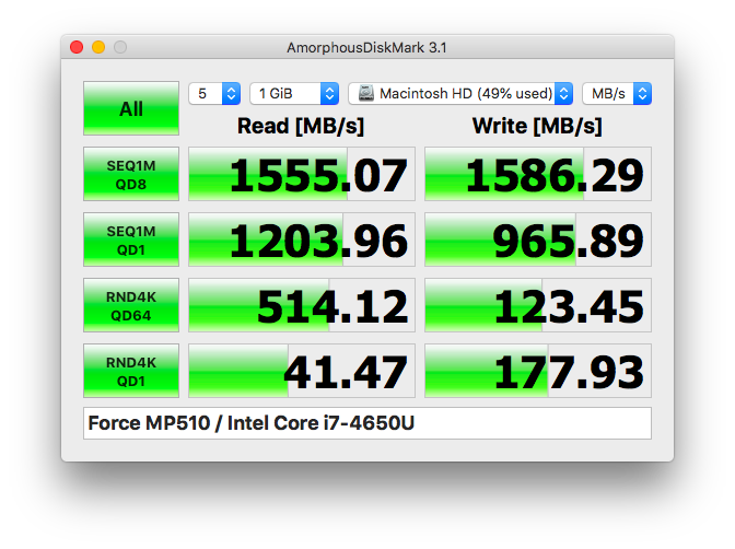

Can you please post an AmorphousDiskMark screenshot? I think we haven't had that one here in the thread.
Your Macs are MacBookAir6,2 ?
Cool, the Corsair MP510 was my other choice back then. But suddenly the prices went up.
Here are the results on my MBA. It's a 2013 i7 MBA. MBA6,2. The SSD is the Corsair MP510 - 480GB. Not sure if these numbers are good or not, as I didn't check the stock SSD to compare. I had used the BlackMagic app to test.

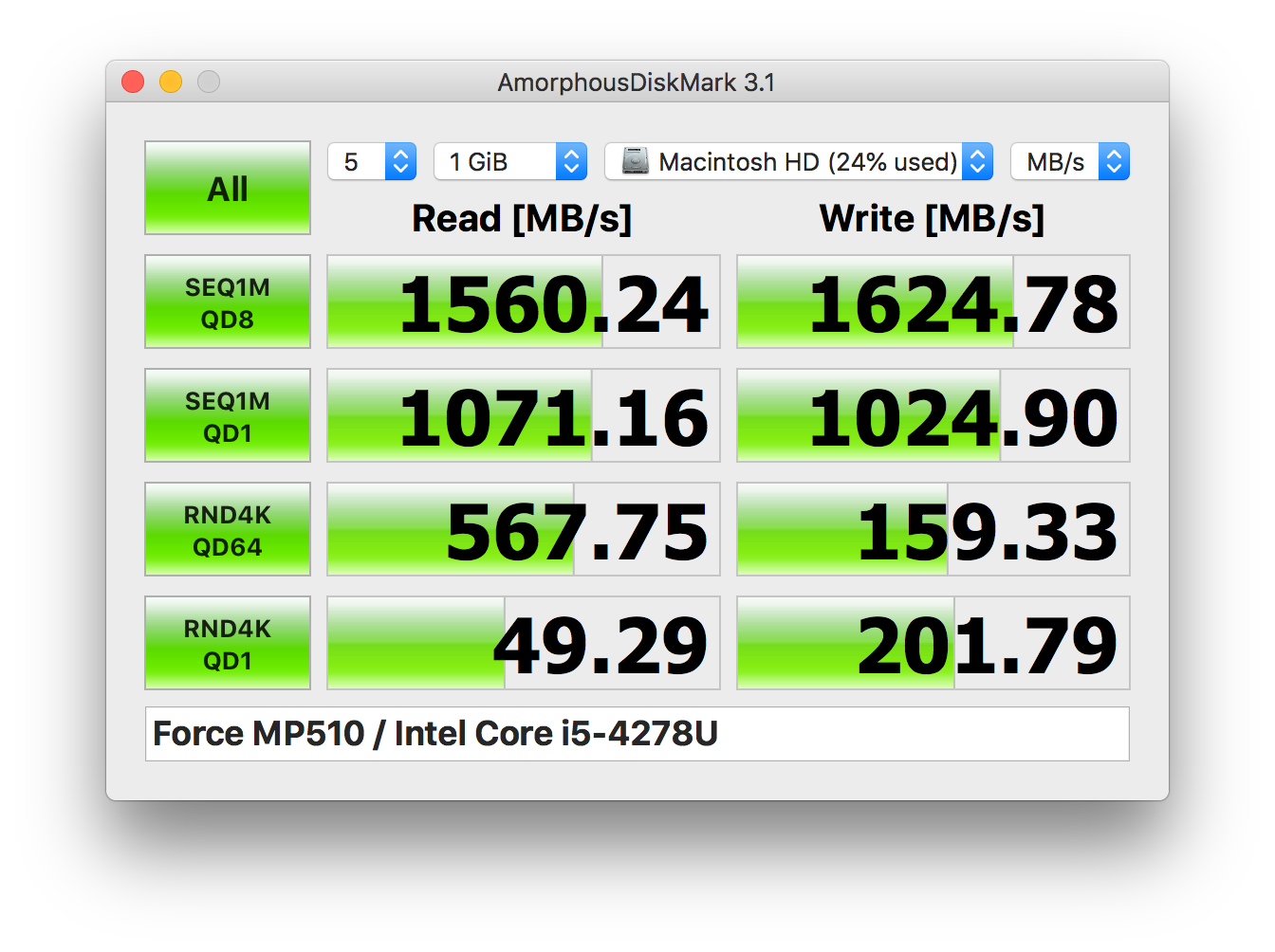

Wife's MacBook Pro (11,1). This one is the 960GB Corsair MP510.

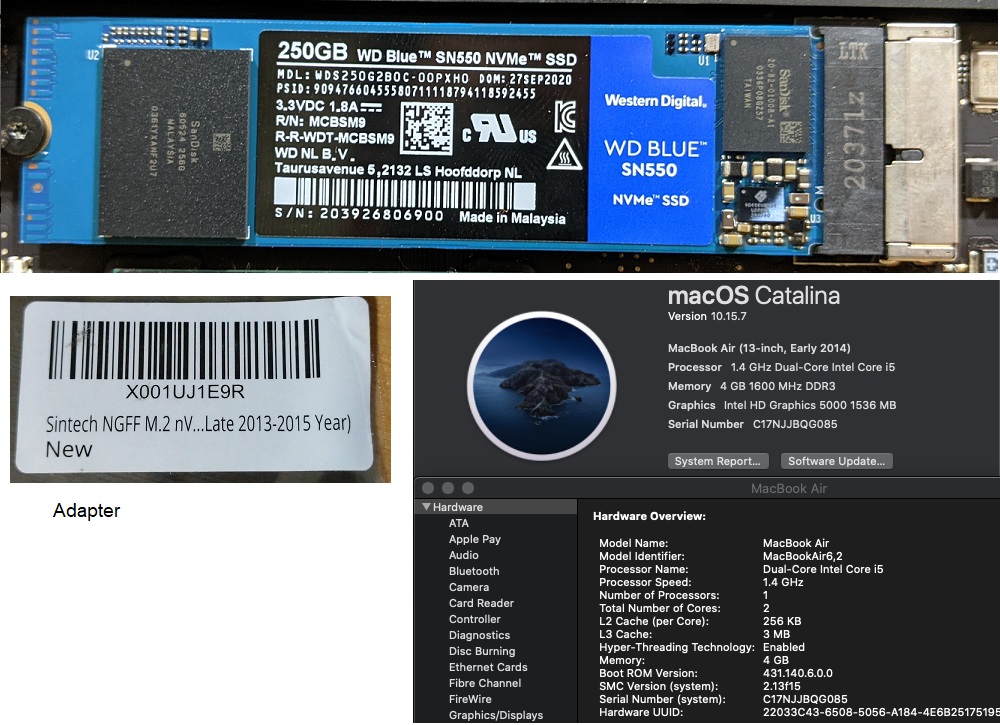

Have not done a speed test yet, but I did receive an authentic Sintech adapter yesterday and that worked! The Kingston NV1 was detected and booted into the install of Mojave I have on it. I do have the laptop on the latest BootROM as it was running Big Sur previously for the better part of a year.
Hi, @Lucas1980,
Did you have the Read/Write speed after the Firmware update?

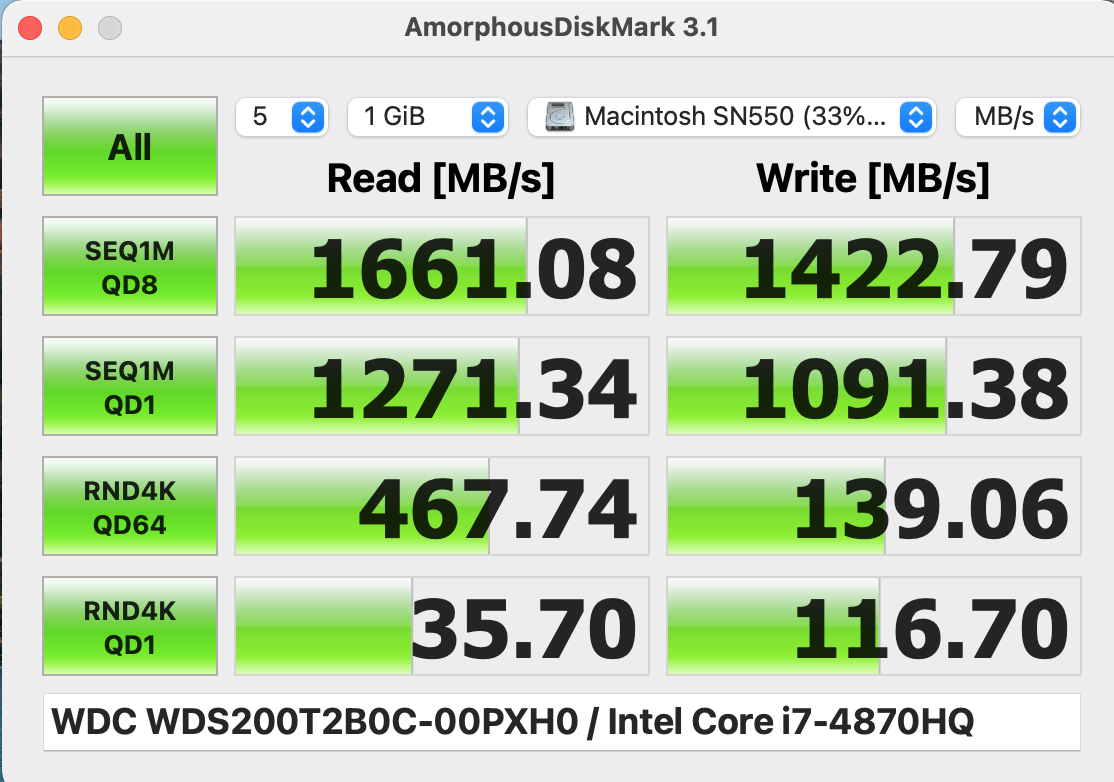

I just installed the 2TB SN550 on my MacBook Pro 15 mid-2014 (MacbookPro11,2) and I am getting Write ~800MB/s and Read ~1450MB/s after some interactions. I guess the Write speed reflects the fact that the SN550 is DRamless, but
I am wondering if the firmware update would change anything in terms of speed!!

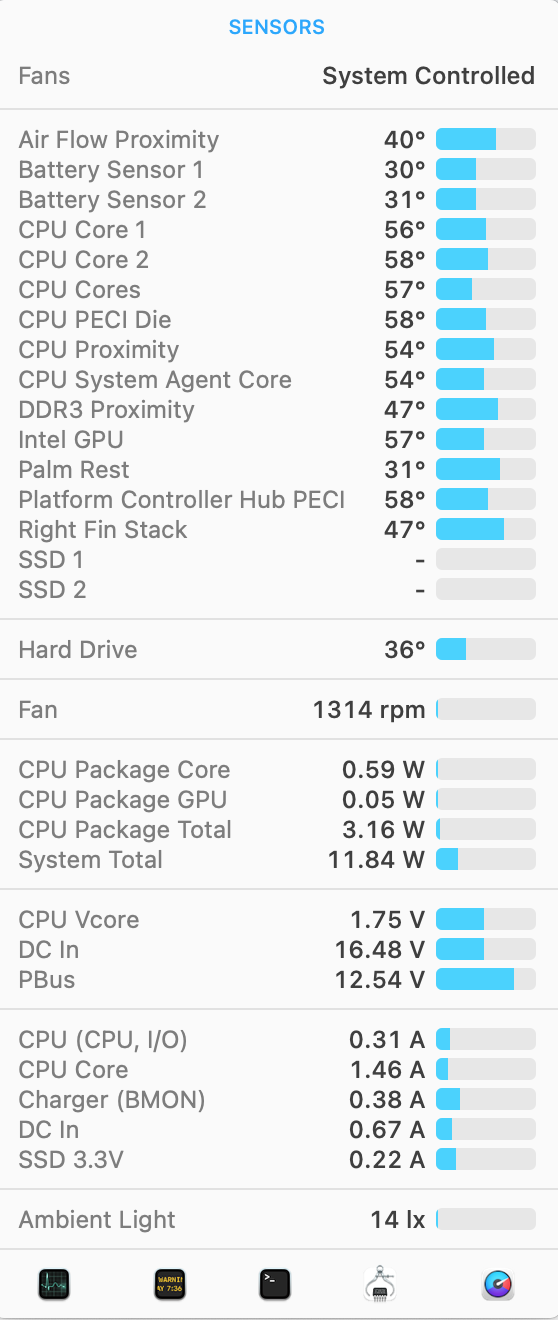

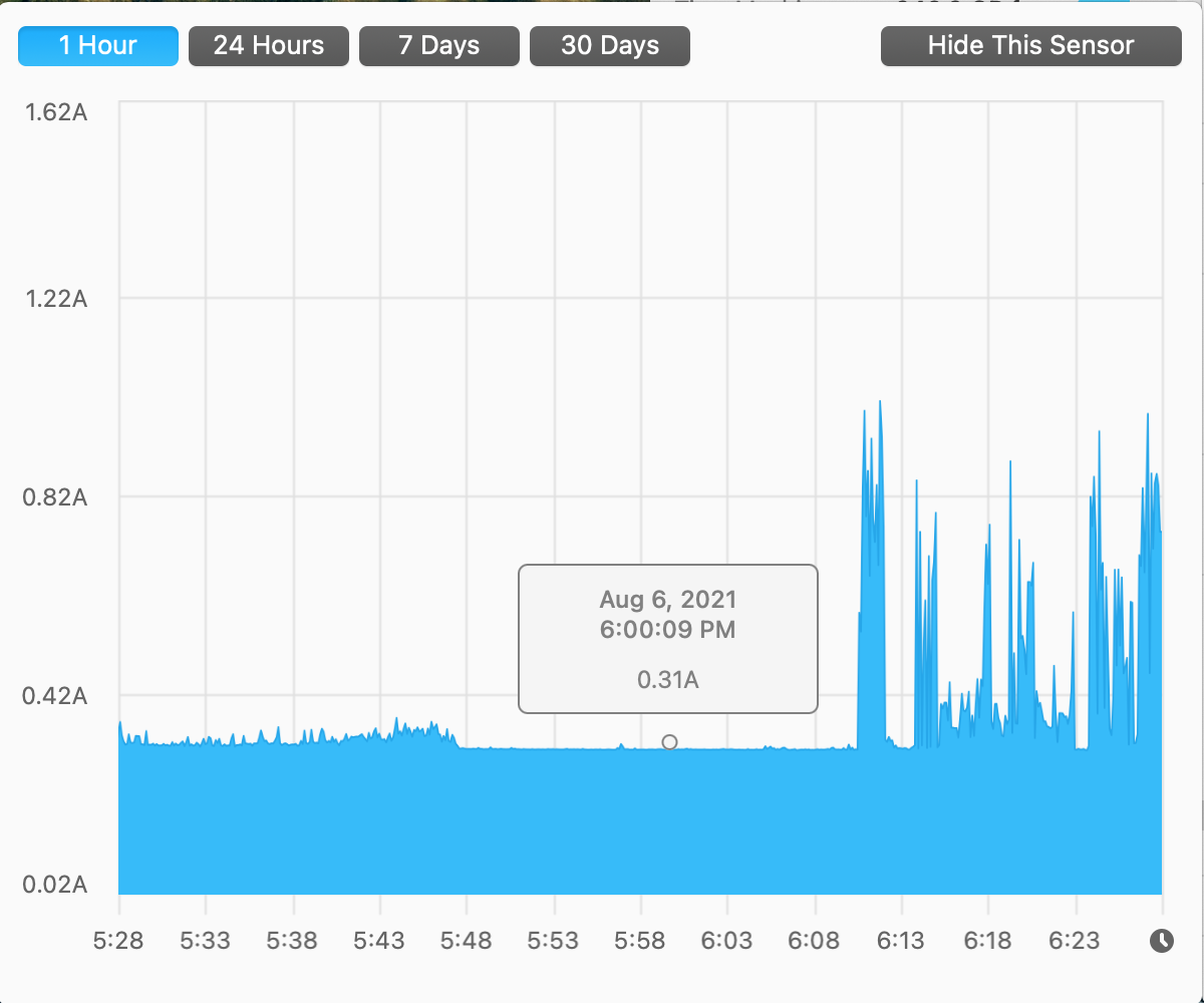

The idle current is around 0.31A, which is twice the current my previous A80 (Silicon Power) 1TB used. I don't care about that because I use the laptop plugged in most of the time.
Thank you,

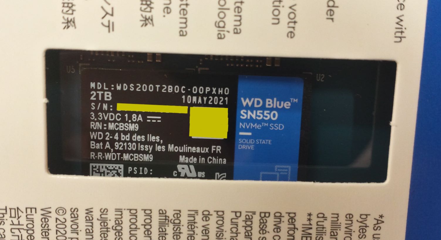

EDIT:
I've bought the SN550 from Amazon.ca and it came with the updated firmware:
WDC WDS200T2B0C-00PXH0:
Capacity: 2 TB (2,000,398,934,016 bytes)
TRIM Support: Yes
Model: WDC WDS200T2B0C-00PXH0
Revision: 21705000 -> Updated Firmware out of the box.

After the disk settled down for a while, the speeds are better than the Silicon Power:
But the idle current is not:

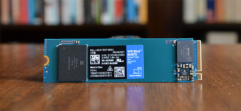

Hey macpro_mid2014, I was a bit in a Sherlock mode recently 🔎 and trying to get behind the SSD revision riddle by sneaking around in shops.
Can you please comment how this matches your SSD model?
I have found it in a local shop. This is what can be read on the retail box of the 2TB WD SN550.
R/N looks like revision number. But it is in no way similar to what you have posted.
Also the production date could be a hint to an updated model. Would you mind checking yours?
Something else:
The Crucial P2 has indeed different markings on the box. Here is a snapshot of one model with UK/CA on the label and the other model without. So you can probably tell just from the packaging which version you are buying (both 1TB on these photos). The UK/CA labelled SSD is supposedly the newer version (see the Toms Hardware article on that).
P.S.: That SSD is likely the newer version, also because the serial number is higher.
That is exactly the SSD model I have. I bought mine from Amazon.ca in the last week of July.
Reactions: olfo
Thank you. And may I ask if you find similarities to the new WD SN550 version described in this article, as of performance?
I cannot get more than 1300KB/s because of the PCI 2.0 in my MBP11,2. So, I cannot test if it has a degradation in performance after a big file write/read. I posted (some pages back) the performance using a couple of utilities.
