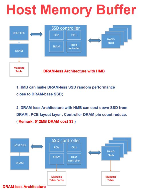

FWIW, Kingston has a lower end DRAM-less model called the Kingston NV1 which has a 2 TB capacity option. Here are the official specs:
250GB: 5mW Idle / 85.5mW Avg / 0.99W (MAX) Read / 1.5W (MAX) Write
500GB: 5mW Idle / 205mW Avg / 1.1W (MAX) Read / 3.3W (MAX) Write
1000GB: 5mW Idle / 220mW Avg / 1.1W (MAX) Read / 3.3W (MAX) Write
2000GB: 5mW Idle / 340mW Avg / 1.1W (MAX) Read / 3.3W (MAX) Write
They don't provide info on the controller and NAND type, apparently because they will mix and match. However, they do use Phison E13T and Silicon Motion SM2263XT. Phison E13T is what the very low power Crucial P2 uses.
Tom's says the SM2263XT can't scale to 2 TB, so the 2 TB model may be Phison E13T.

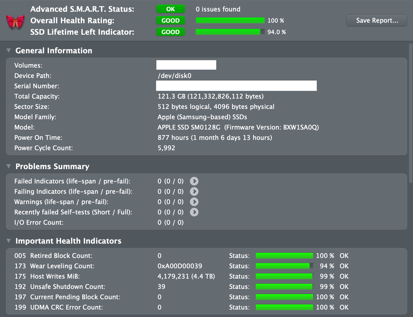

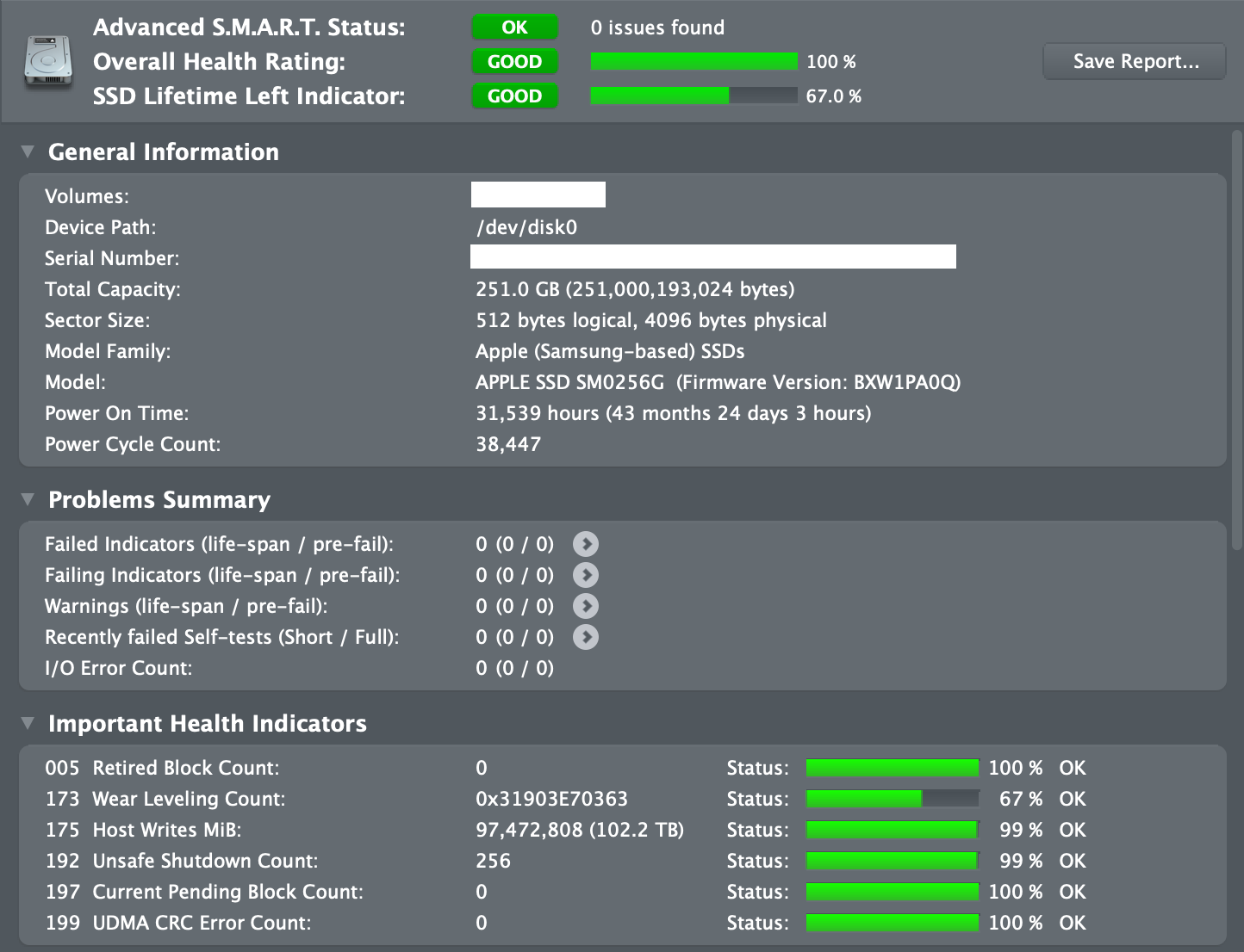

Today I installed my used SSUBX 256 GB OEM Apple/Samsung SSD in my 2015 MacBook Pro 13". There was a fair amount of wear on it, but given the lifespan of these drives, I'm OK with it, as it still has almost 200 TB of TBW left. In contrast, my previous 128 GB drive was barely used at just 4 TB.
As we already knew, the read speeds of the two drives are similar, but the writes are much better on the 256 GB. In general OS navigation and basic usage though, I don't notice much difference.

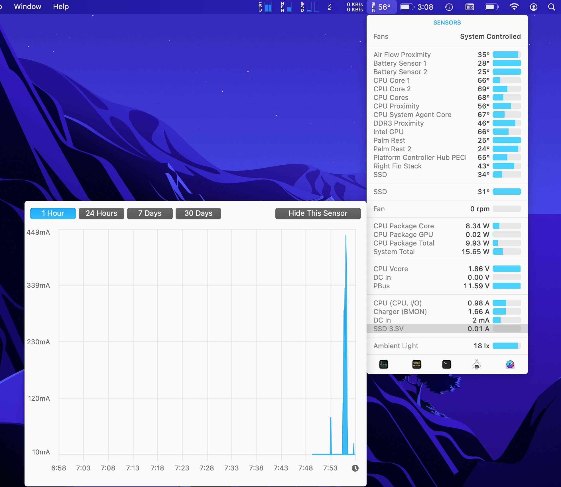

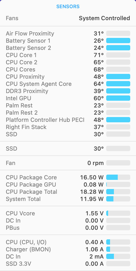

The image on the first page says that the MZ-JPV5120/A04 512 GB SSUBX Apple OEM SSD with BXW1SA0Q firmware uses 0.4 W at idle. I don't think this is correct.
I booted off my external hard drive and installed iStat Menus. According to that I'm getting 0.01 A at idle for the internal SSD. That suggests 0.03 W at idle. Actually, it was 0.00 A initially presumably because it wasn't being used at all initially, since it wasn't the boot drive.
Mine is is the MZ-JPV2560/A04 256 GB SSUBX Apple OEM SSD with BXW1PA0Q firmware. I believe this is an earlier firmware, since this drive was manufactured 2015-03. My other MZ-JPV1280/A04 128 GB SSUBX Apple OEM SSD was manufactured 2016-04 and has the BXW1SA0Q firmware. I don't see a firmware updater for SSDs on this Mac on Apple's website. There is a firmware updater for the 15" model though.
I copied Google Chrome from the internal SSD to the external hard drive, and the power usage jumped to 0.083 A, which suggests a 0.3 Watt read. I then copied iMovie (which is a much larger program) from the internal SSD to the external hard drive, and the power usage jumped to 0.45 A, which suggests 1.5 W read (although my external hard drive is much slower than the SSD of course). After the copy was finished, it dropped back down to 0.01 A. Interestingly, I could not do a write test on the SSD, because when I boot off the external hard drive, the internal SSD is read-only.
Machine is an early 2015 13" MacBook Pro with Monterey 12.1 installed.
tl;dr:
Apple OEM SSUBX 256 GB SSD in 2015 MacBook Pro was 0.01 A (0.03 W) at idle, and spiked to 0.45 A (1.5 W) for read (although the read power consumption may be limited by the slowness of my external hard drive). This disagrees with the data on the first page by an order of magnitude.
