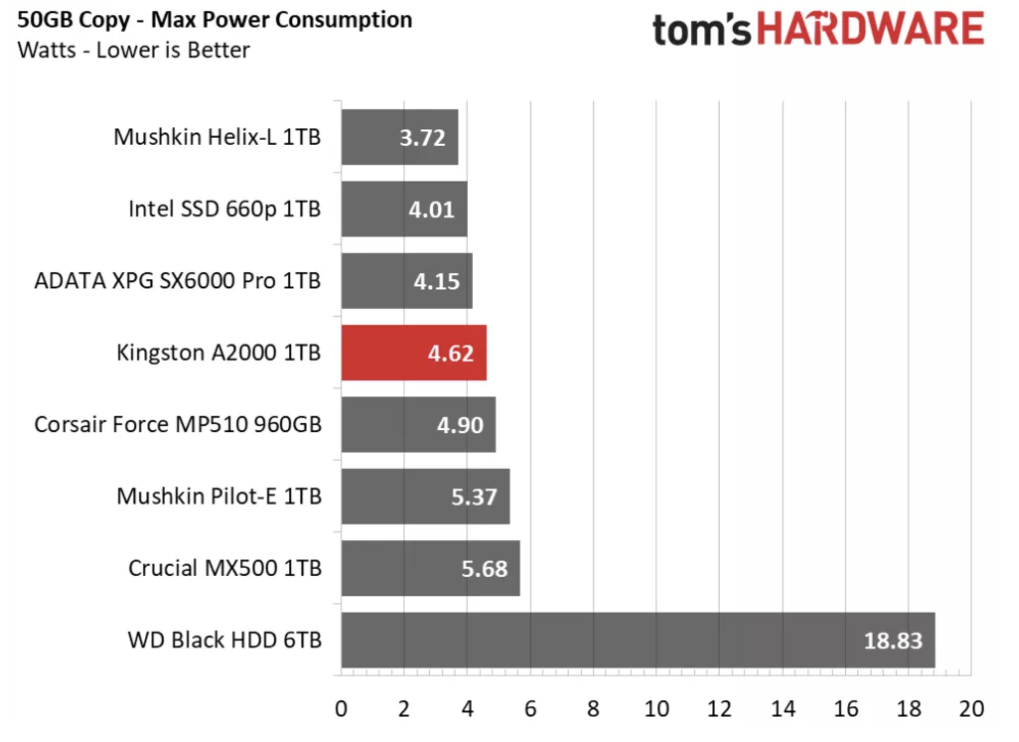

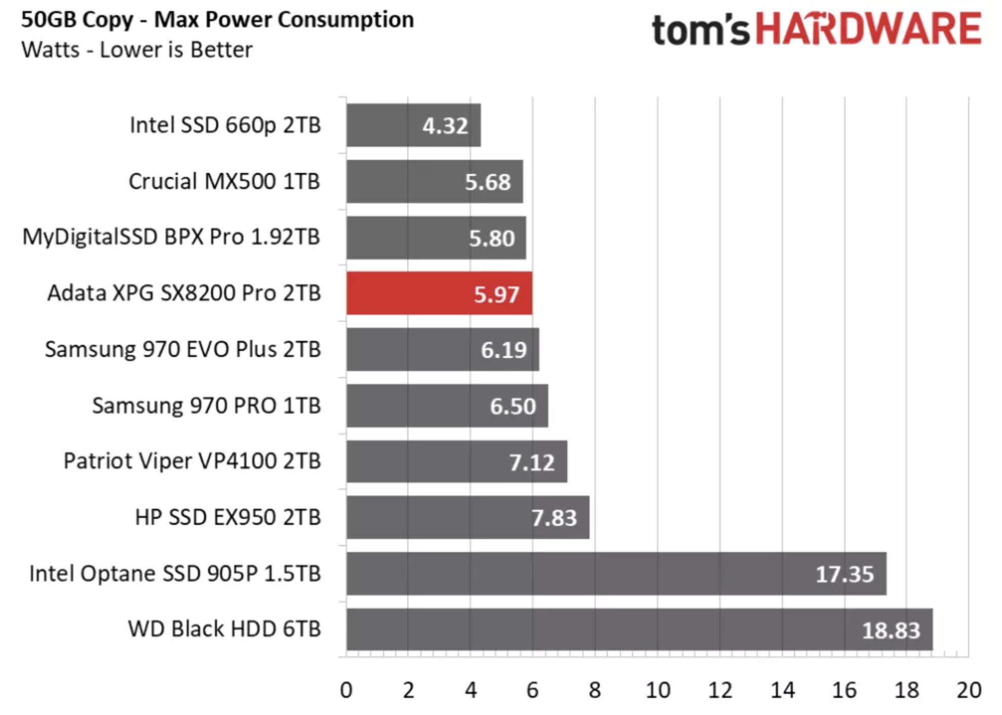

The concern I had with the SX8200 was its max power usage, which is around 6 Watts. That might sometimes be problematic in an external enclosure. The A2000 was closer to 4.6 Watts.

The Crucial P2 was significantly lower power but after the cache is filled, the QLC variant (which I think may include all of the 2 TB models), it drops to 40 MB/s. Ouch. Not great for an external storage drive. Plus, strangely enough, it wasn't that cheap.
I ended up getting the 1 TB A2000 for CA$95, which is only US$74. Cheap for a DRAM model. I think if I do get another 2 TB drive though, I might just get a Samsung T7 instead. They're relatively inexpensive, and never have USB power issues.
