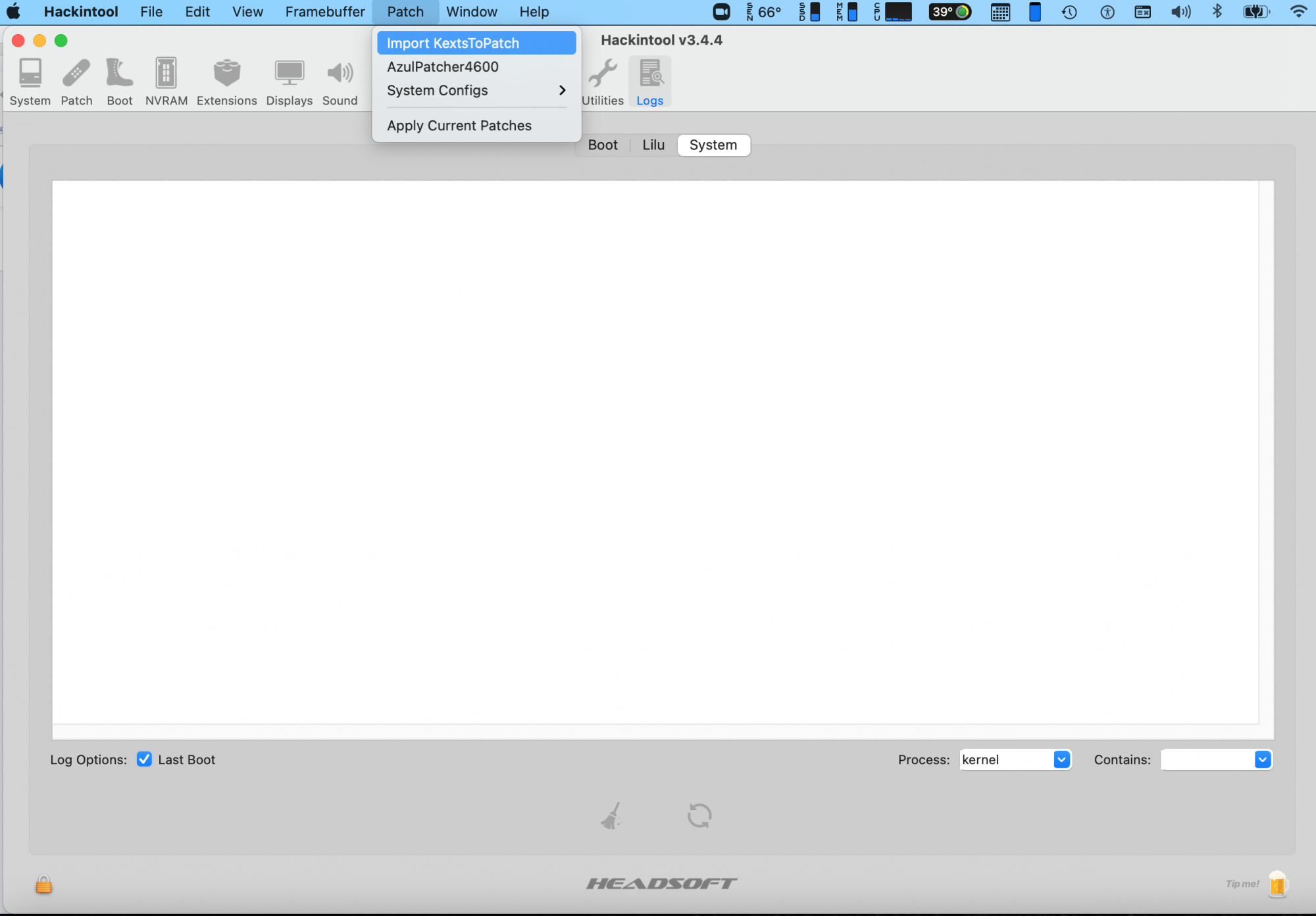

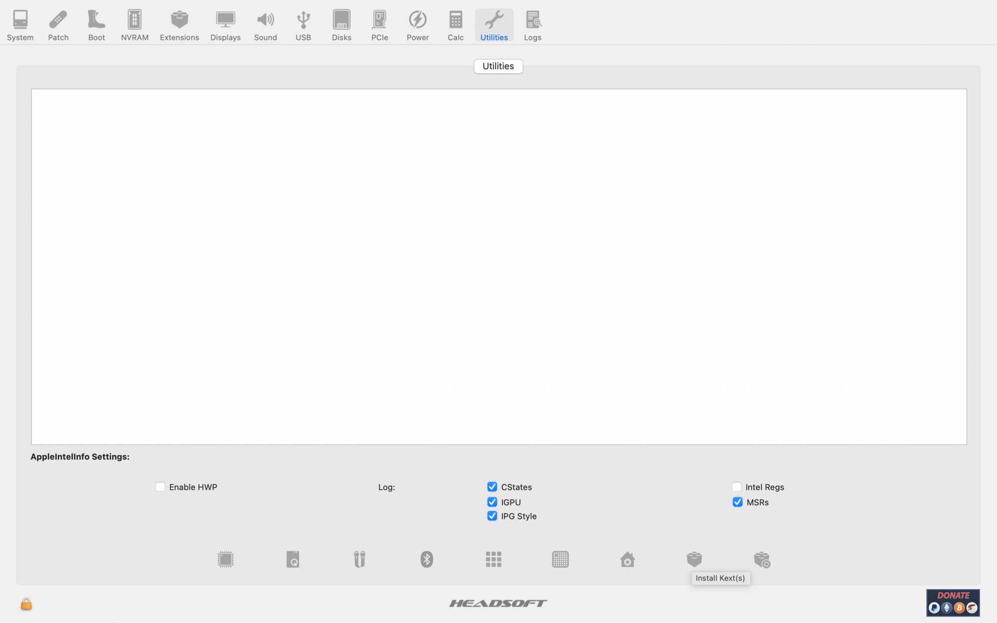

I'm using hackingtool v3.4.4 and i can't see the option to install extensions
I haven't really used this tool to install anything, just to check stuff, but I guess this is where you install kexts.

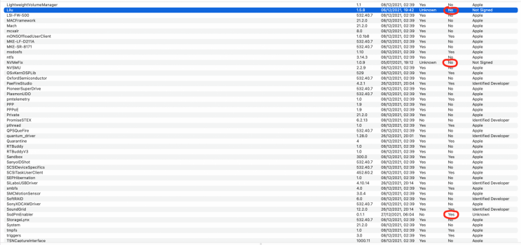

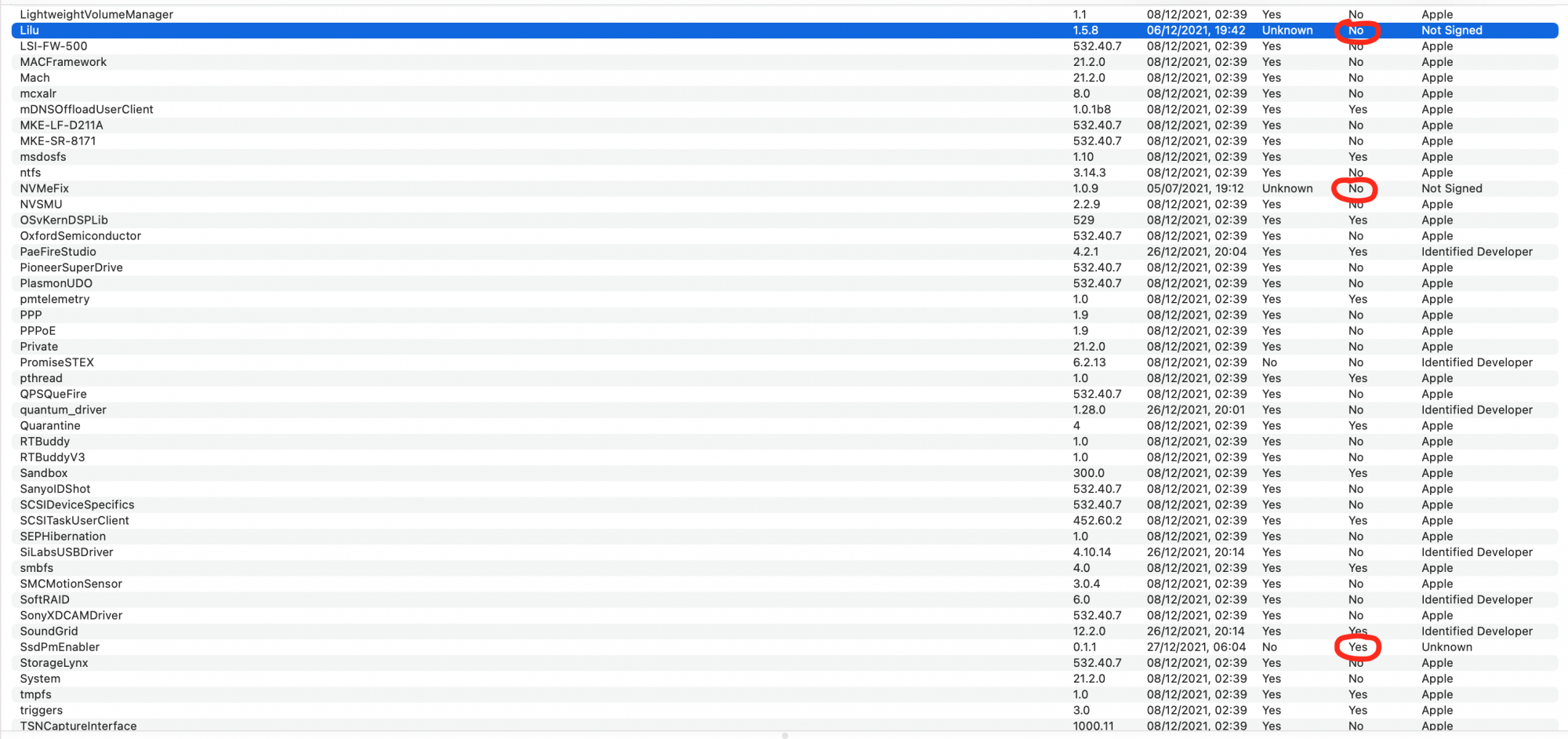

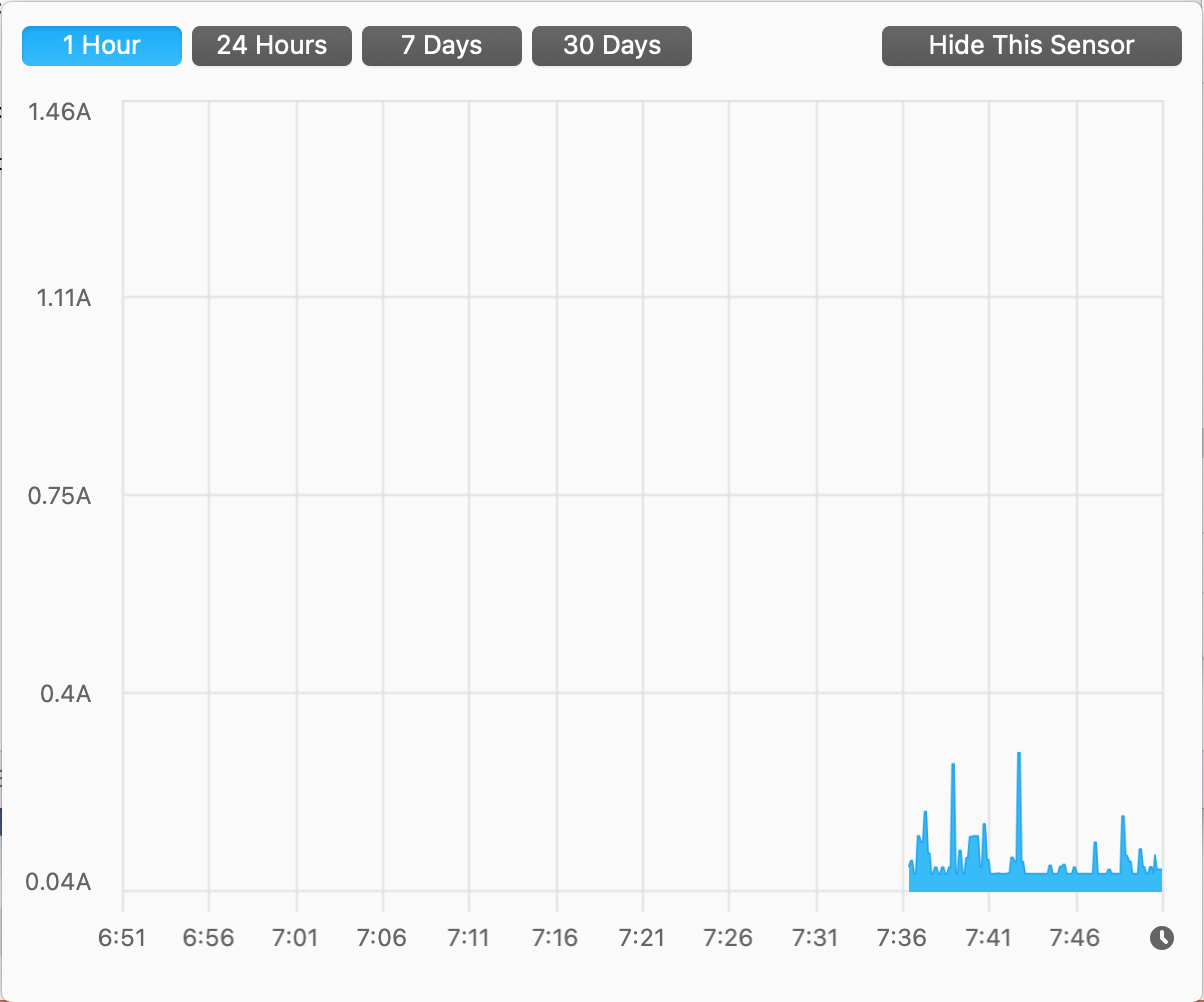

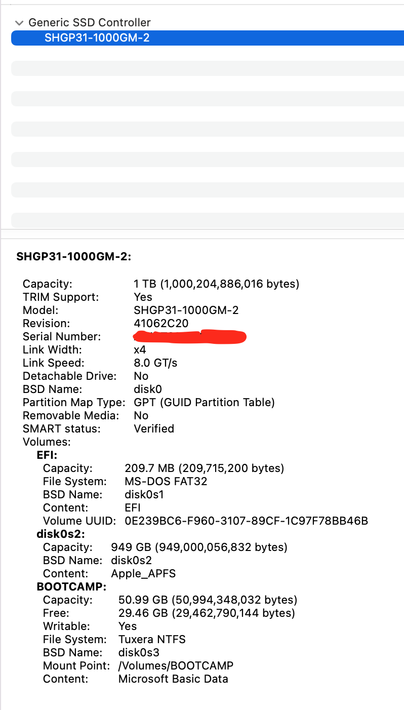

Thank you for pointing me in the right direction. Lilu and NVMeFix are not loaded. my idle is also at .16A I've also included a screenshot of my SK Hynix P31 Gold SSD details. Let me trying you earlier instructions and see.
What was the power consumption without the kexts installed?

I've tried the first 3 steps of the instructions by @terrazoids the first kext is installed but not loaded. i'm seeing my idle anywhere between .15A - .17A

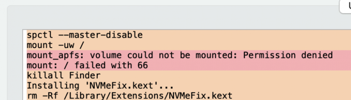

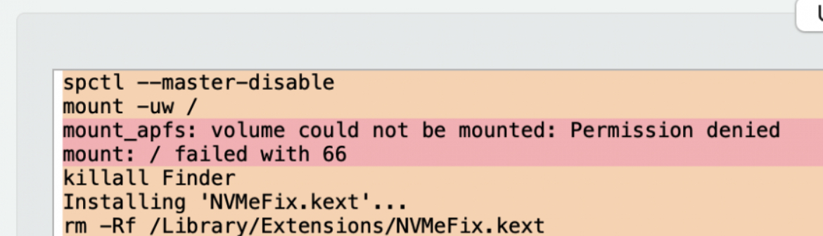

I am still getting the usual refusing to boot errors "experienced an error and need to restart...". Is this the cause of the error as looking at it, Hakintool cannot patch properly due to read only enforcement as I had referred to earlier.
- 660p same firmware as you also.
- the funny thing is SSDEnabler seem to work by itself but NVMeFix/Lilu refuses to boot either by itself or together with SSDEnabler
Any ideas?
