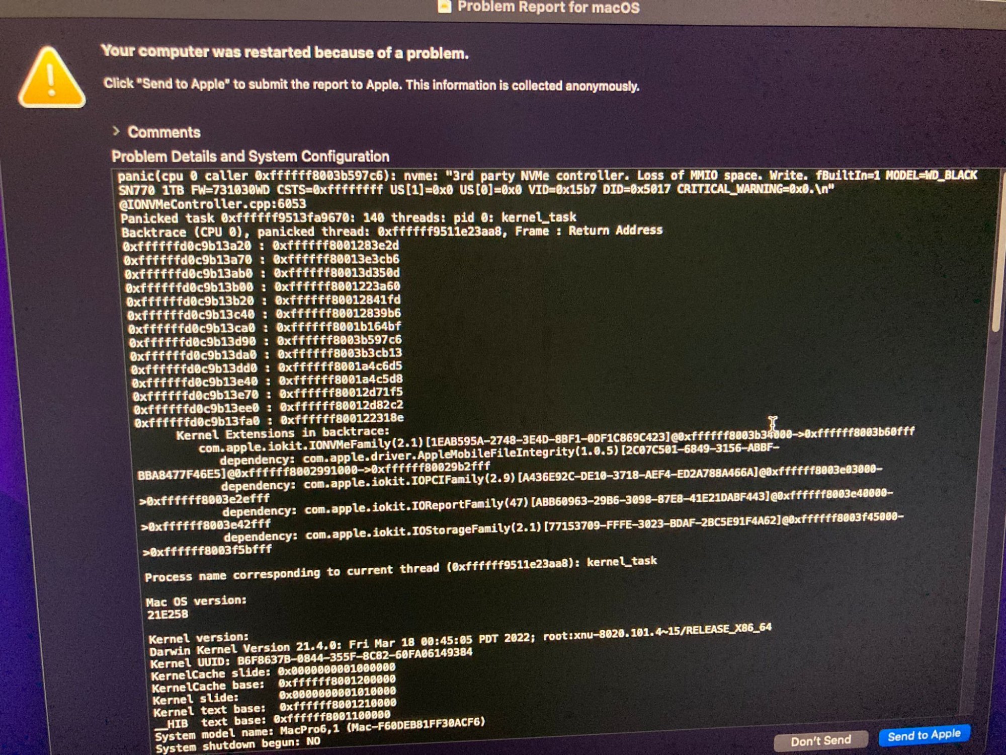

SN770 doesn't work, frequent lost of MMIO space

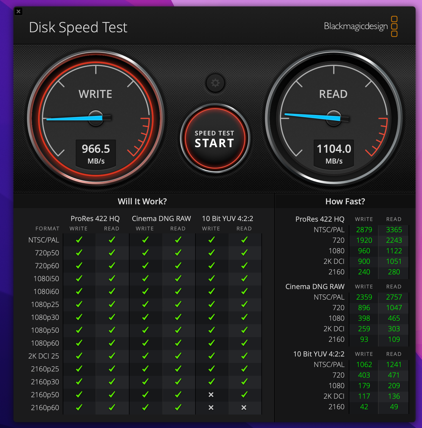

Seeking advice from anyone having A2000. I got the Kingston A2000 for my MBP 13" Early 2015 and install the latest version of Monterey when doing migration. Latest Boot room is updated and no issue thus far but the performance is kinda low from what I saw from other in this thread. Is the performance I got is normal? Or anything that I can try to improve it?
*pic removed*
I'm getting about the same speeds when my A2000 was in an early-2015 13". Its slightly faster now that it got moved into my mid-2015 15", but not by much.
