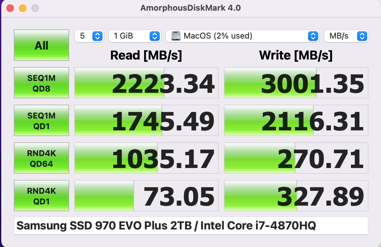

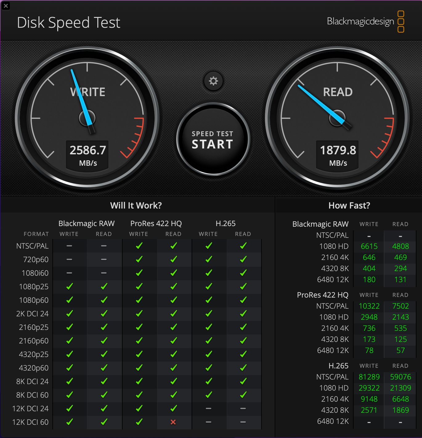

Ok, story update. I ended with 2TB 970 evo plus and sintech adapter. Temperatures are really ok, I am surprised. 35c while using normally. Power consumption is around 0,4-0,5A, pretty high but I will try to fix it by kext changing.
One problem is that I have higher write speed than read. Write 2800 and read just 1800-2000. Before with adata sx8200 1tb I also had slower reading. I have the latest boot and ssd firmwares… maybe adapter is fake ? MacBook 11,5, pcie 3 so should around 3000/3000 with 970 evo plus.

could you check write and read speed please?

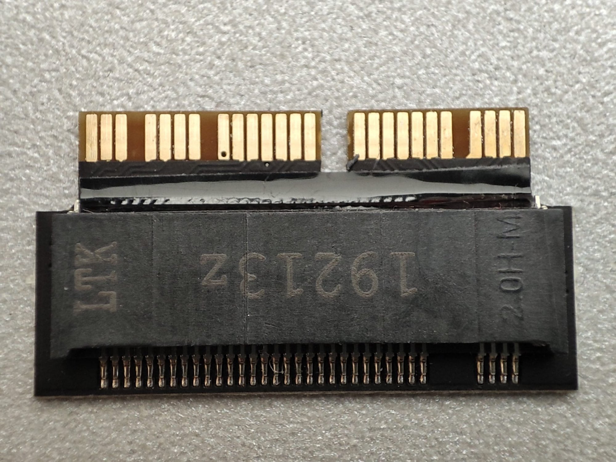

BTW, do you have the short Sintech adapter or the long one? I'll be using the long adapter, just hope it will fit.
Long, but i think it’s a fake one.I have 2000 mb/s reading. It should be at least 2800

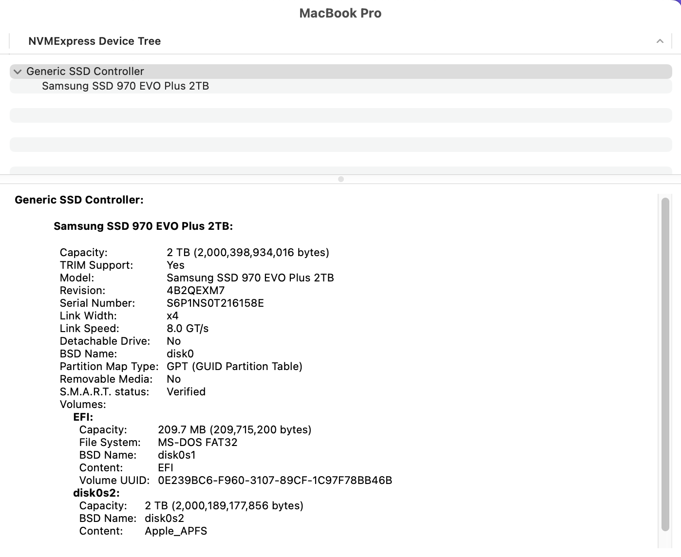

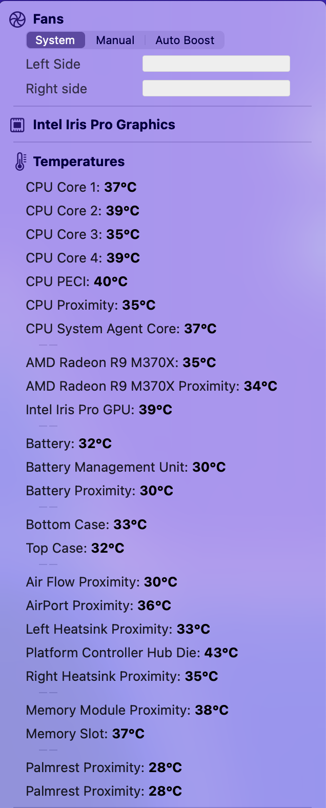

OK so here's the story so far:
I prepared the Sintech adaptor by wrapping Kapton tape around it, then installed the Samsung 970 EVO Plus 2tb onto it, screwed it into the motherboard. No flex, everything seems to sit very nicely, even with the SSD being double sided.
Fresh installed Monterey via bootable USB, and during the install the fan went berserk for a bit. Once it's all up and running, I loaded up Blackmagic and took some readings, along with AmorphouseDiskMark. Also installed TG Pro to take some temp readings, see screenshots.
System is flying along, everything seems to be working sweetly :):):)

Ok, it’s exactly the same as mine. I don’t understand why it can’t go up to 3000 with reading. I saw on YouTube some videos with 970evo plus upgrade and they had much higher reading speed then us. Maybe it’s because new revision of the ssd or they have mojave or something. I use big sur

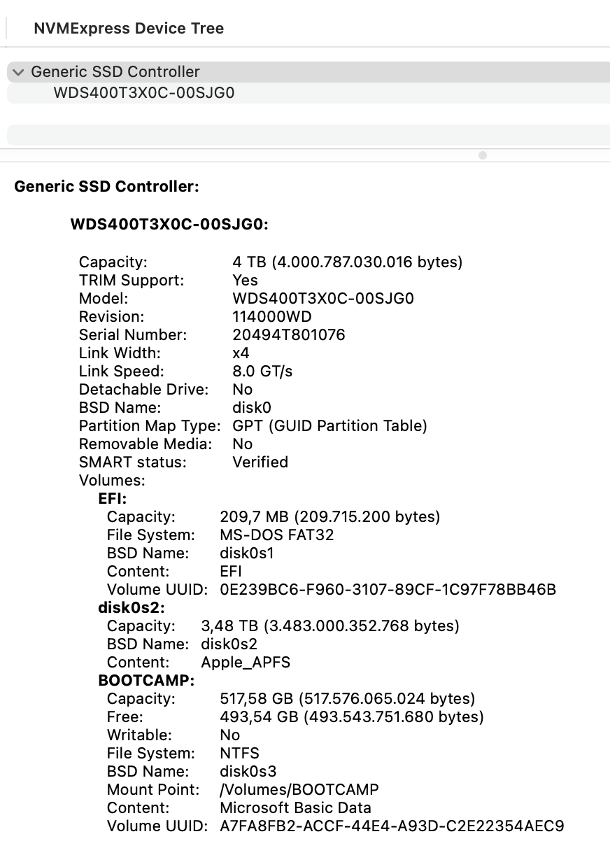

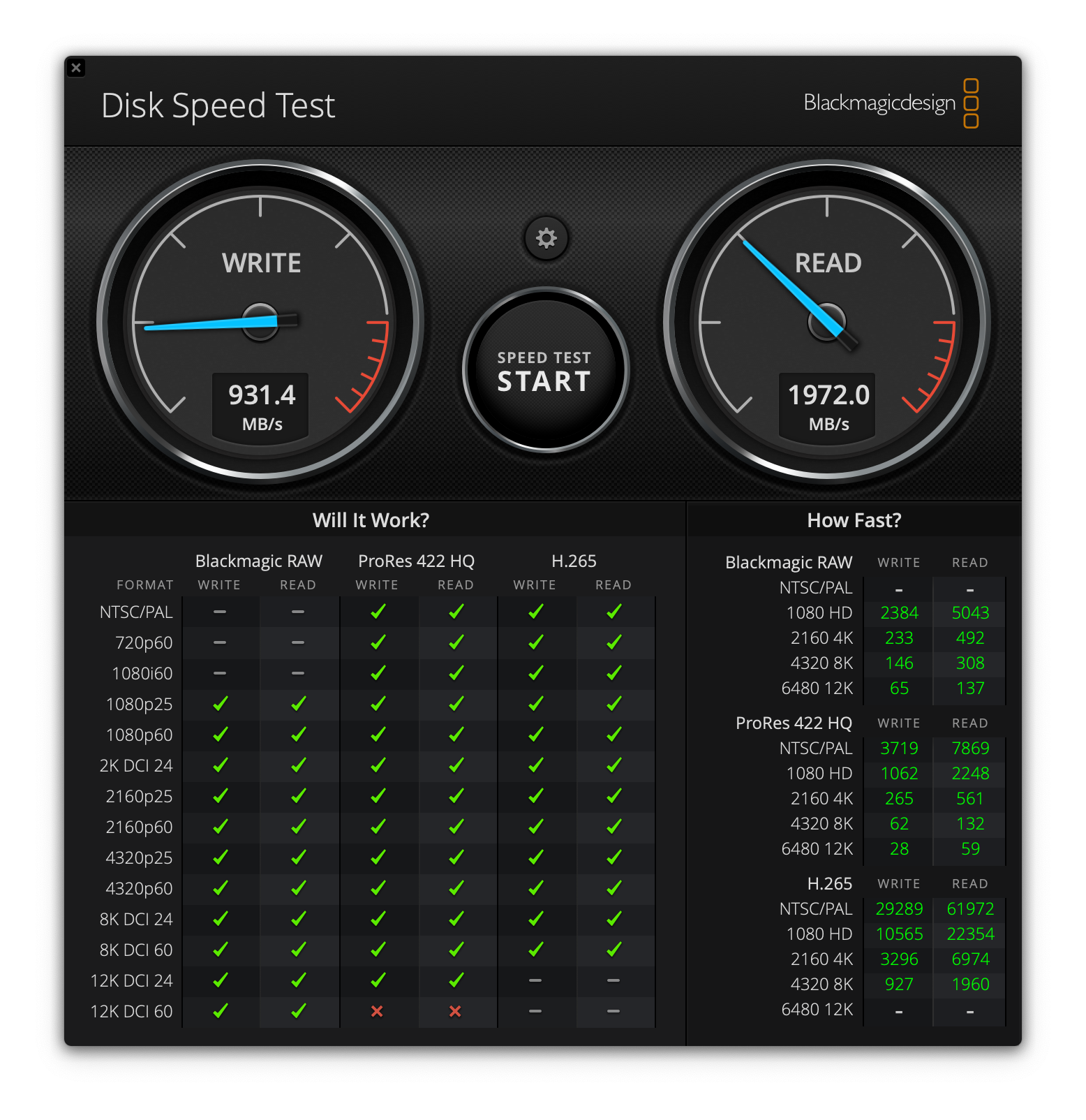

Hey everyone, i'm a little confused about my SSD upgrade.
I bought 4TB WD SN750 SSD for my Macbook but i have really low speeds.
I tested it also under Windows 10 but the same bad results.
Do you have any ideas?
MacOS version: Monterey 12.4
Mac: MacBookPro11,5 (Macbook Pro 15" Mid 2015 with AMD R9 M370X
Processor: Intel Core i7 2.5 GHz
Boot ROM Version: 430.120.6.0.0
SSD: WD SN750 4TB WDS400T3X0C-00SJG0 + Sintec short adapter

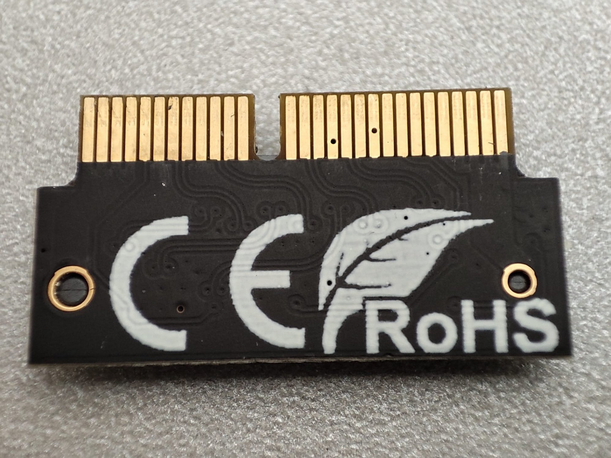

Bootcamp Windows or PC? If bootcamp, try another adapter
yes i was bootcamp, i purchased the original sintech from page 1 (Link on Post 1)
which one do you use?

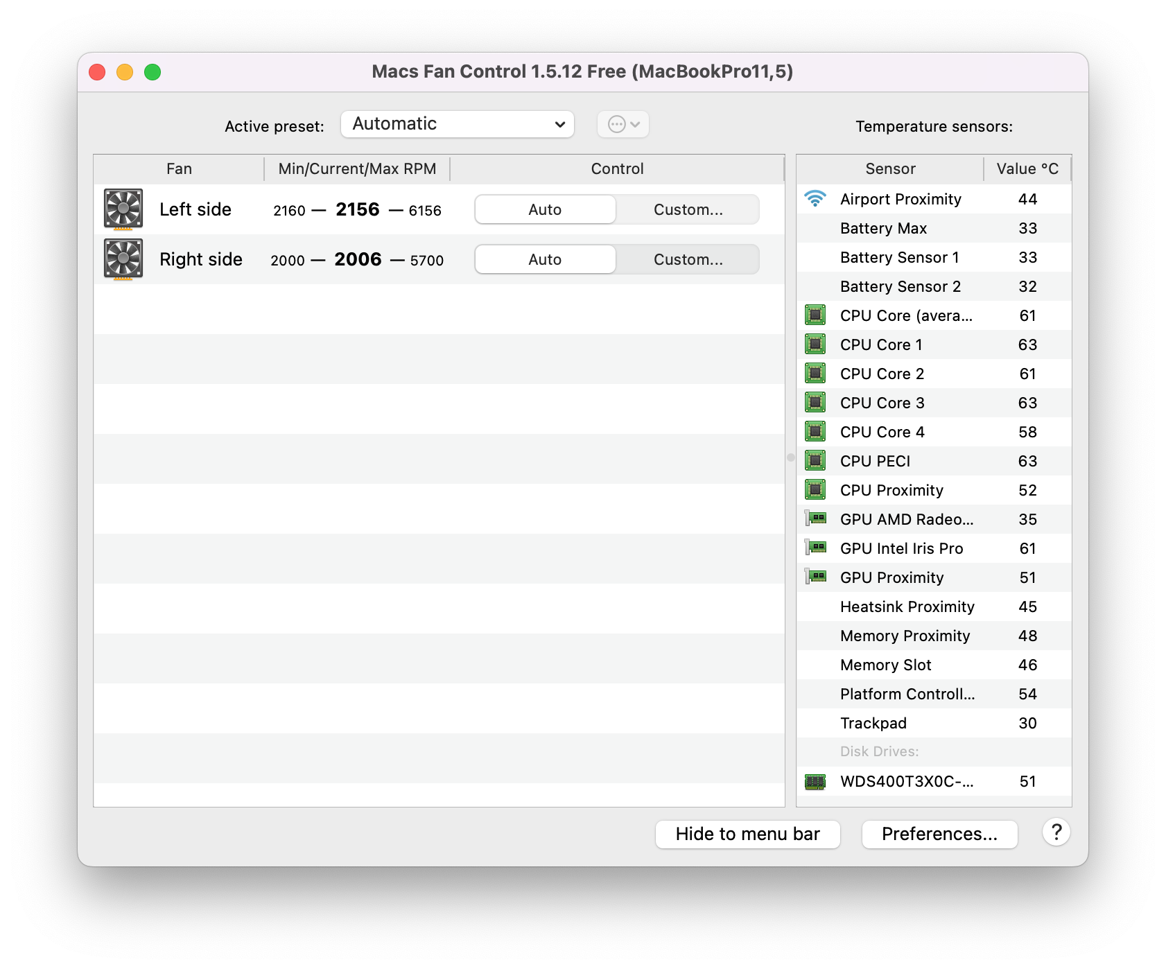

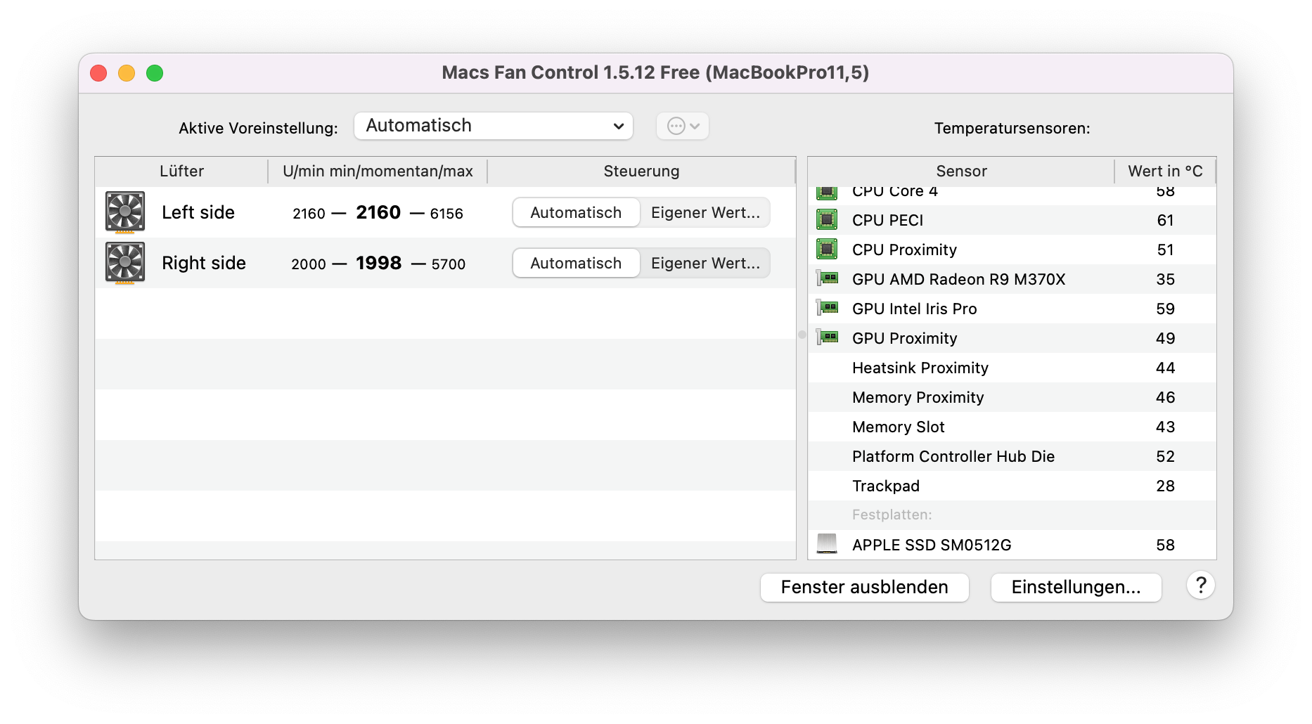

I also find the temp from the ssd a little high, 51° as you can see in the screenshots.
EDIT:

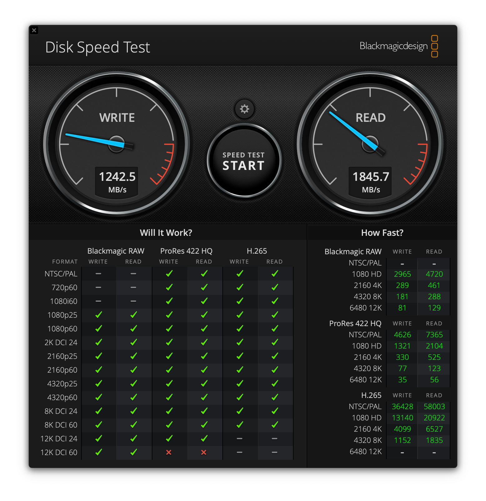

I replaced the old original apple ssd back into it and here are the results.
i find it interesting that the heat goes up to 57°

I have the cheap one. No name. Everything works perfect so far. No issues with temp, battery or hibernation. Boot camp works too. Maybe your sintech is broken. Try another one. Or maybe sn750 needs firmware upgrade before? Try your ssd on windows machine if possible

i just ordered a noname from amazon. it will come tomorrow.
before i placed it into my macbook i checked it in a desktop pc for firmware updates but nothing to update.
tomorrow i will check the new adapter and will test the ssd in my friends notebook, he has a new asus with full speed capable.

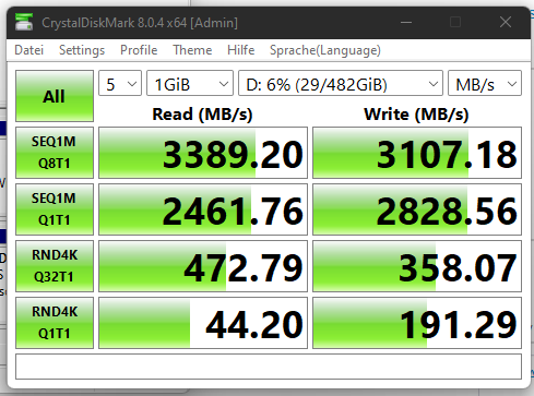

Ok got results.
the new noname adapter did no change at all.
Next i tried the SSD in my friends new notebook and it worked like a charm, see screenshot.
i think i will order a different one now, in my country the corsair mp510 is now buyable (570€)
Do anyone have any else ideas? thanks

My guess is that you have a discrete GPU and it uses or share some lanes on PCIE and that's why you are not able to get full bandwidth on your Macbook Pro. If you have bootcamp and Windows, try disabling it in device manager and restart and see if the SSD speeds up.

Can you check how many PCIe lanes are used by the ssd?
