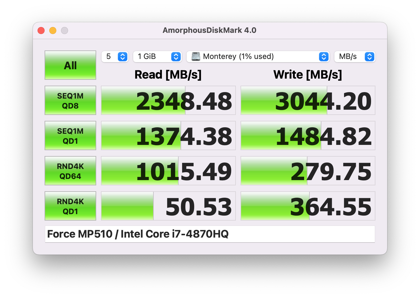

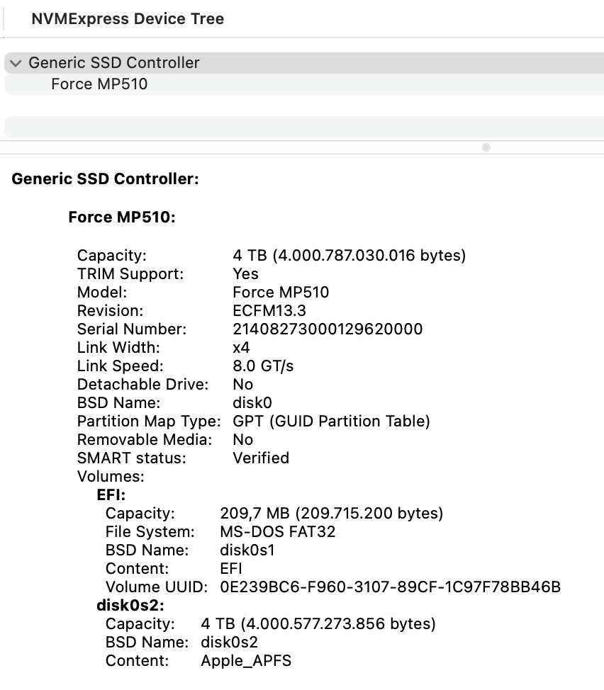

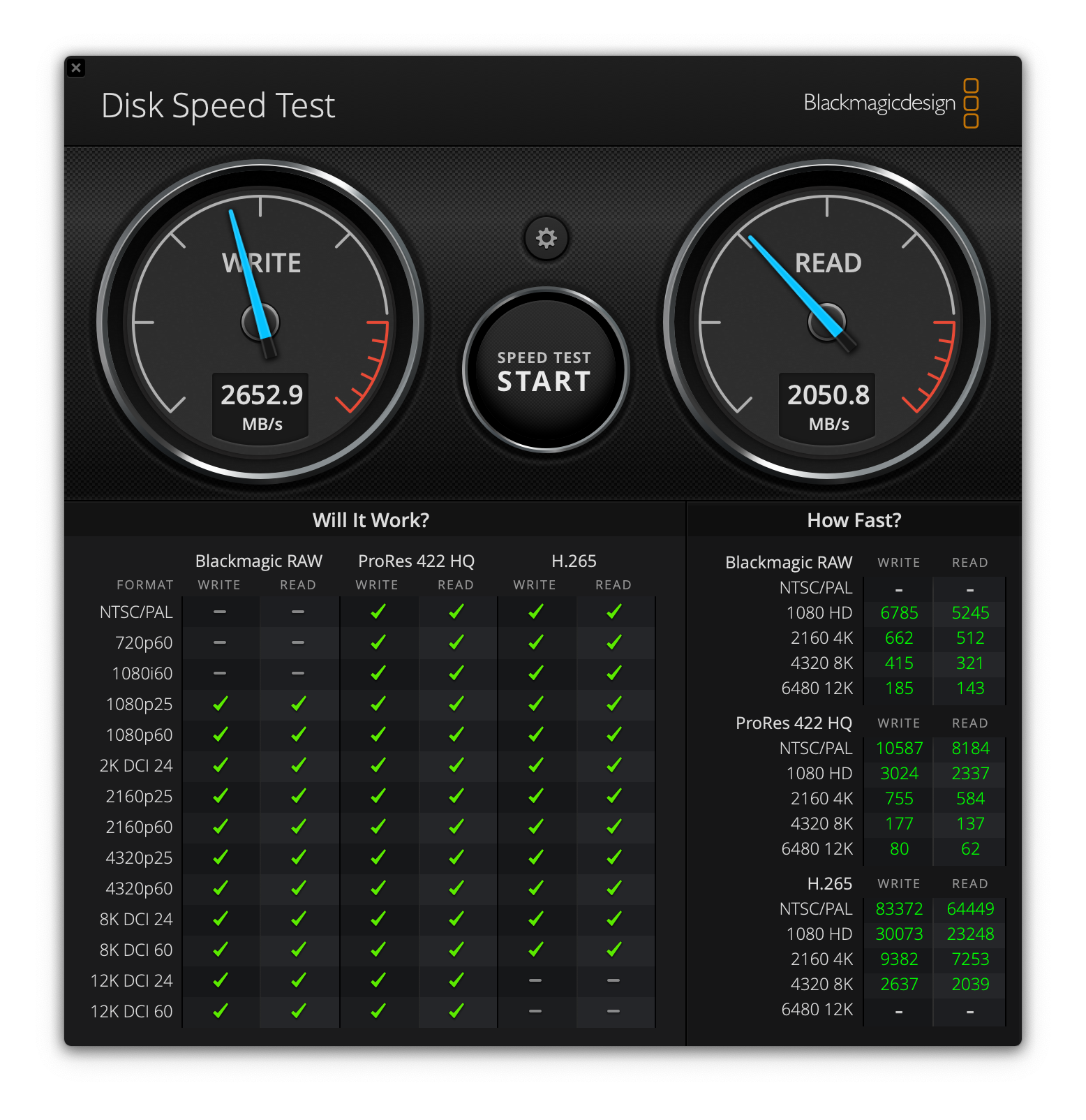

Ok got some news, here are the results with the new Corsair MP510 4TB. Also Checked for latest Firmware.
Its Write is much faster but the read is also 2k. like that, its better than the WD Black but not perfect. Is this all i can get or are there more posible?

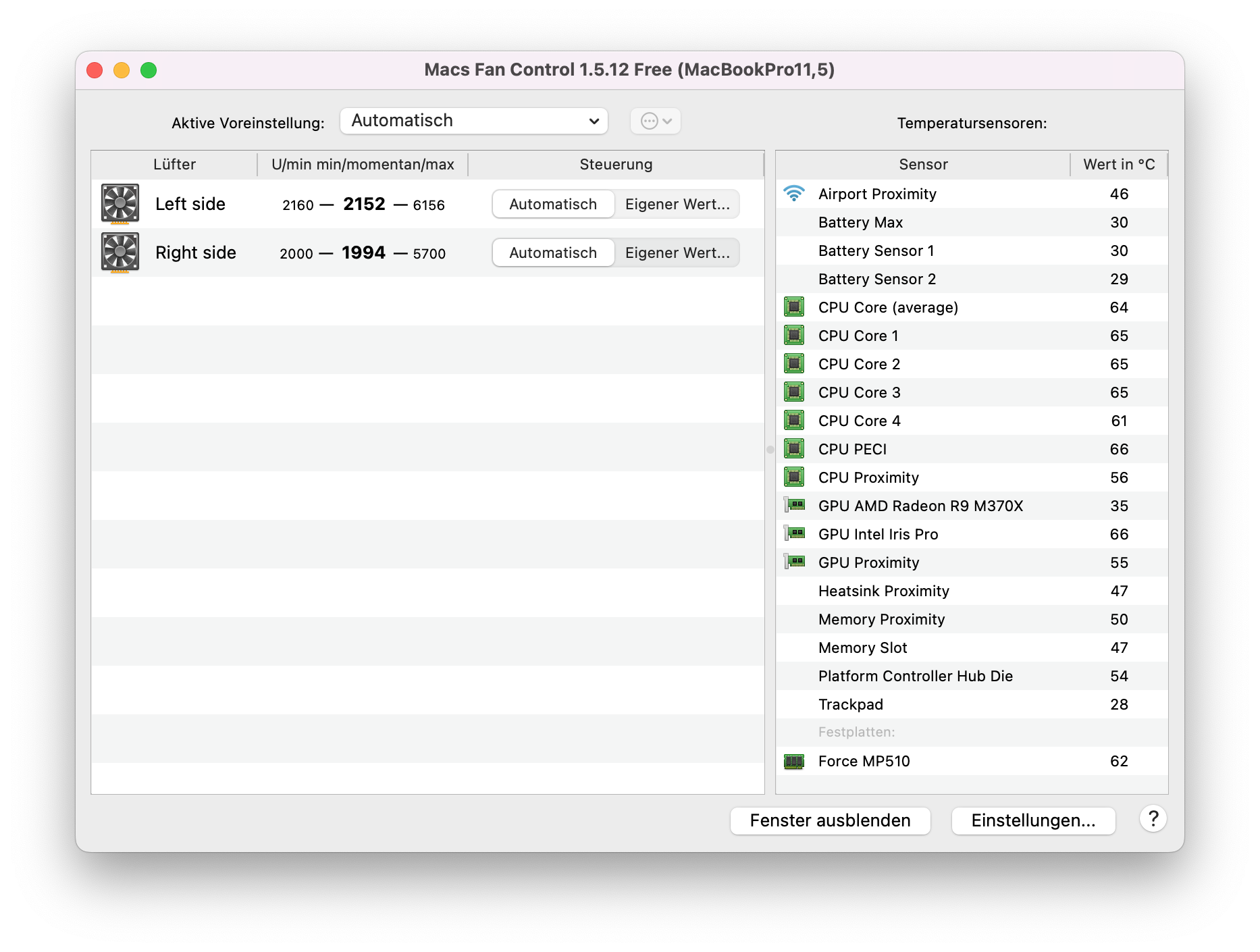

If i ran it several times the heat goes up to 62°, is this ok? If i do nothing on the System (idle) its on 34°.

EDIT: I added a test with AmorphousDiskMark
