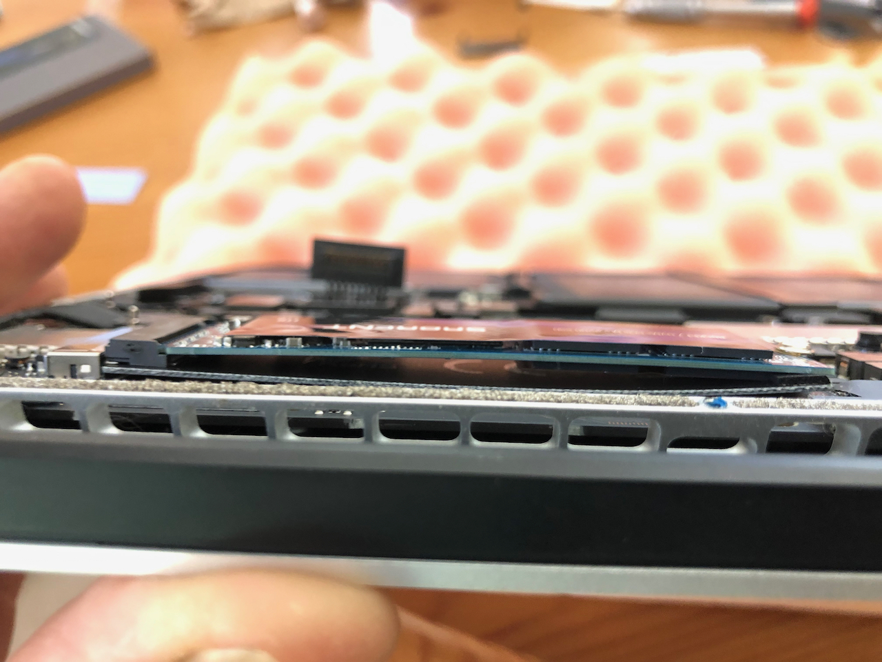

And, yes: it was quite unsettling seeing the bow on installation <s>
Same here on the first sight 😂
When I looked closer and thought it through, I found it fascinating. So I remember it well.
I see two bows or two arcs mirroring each other. The bottom arc touching the motherboard. The upper arc perhaps touching (or approaches to touch) the under cover of the MBP. It accidentally forms a very rigid structure. Firmly secures multiple connections of the NVMe, adaptor and SSD socket. Unintentionally, also provides one additional, sizable structural support to the under cover. Help to protect other components on the motherboard.

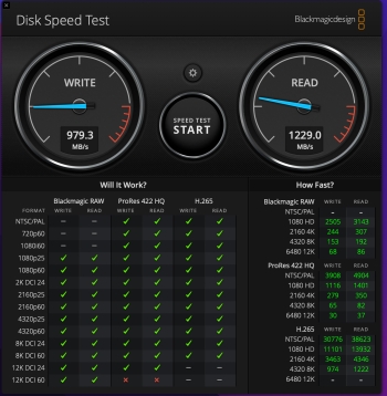

After having purchased an 2TB ADATA XPG SX8200 Pro back in September 2020 (along with the short Sintech adapter), I finally got around to installing it in my 2014 MacBook Pro with a stock 1TB last night (procrastinated and then needed a swollen battery replacement). Ran the Blackmagicdesign Disk Speed Test before and after and here are the results:
Write: 488.8 MB/s ----> 1290.9 MB/s
Read: 959.3 MB/s ----> 1508.4 MB/s
Just started using the computer this morning and I've opted to start from scratch with a fresh OS install but I'm pretty happy with those test results.
Is there a better app to test disk speed with? I noticed that it's been a while since Blackmagicdesign has updated their app.
By modern standards, this is not much. This is about half of what is promised in Samsung advertising. But in normal operation, this is not felt at all.
Amorphous DiskMark. I do not know if it is better than Blackmagic one, but it is regularly updated. It's the fork of Crystal DiskMark for Windows.

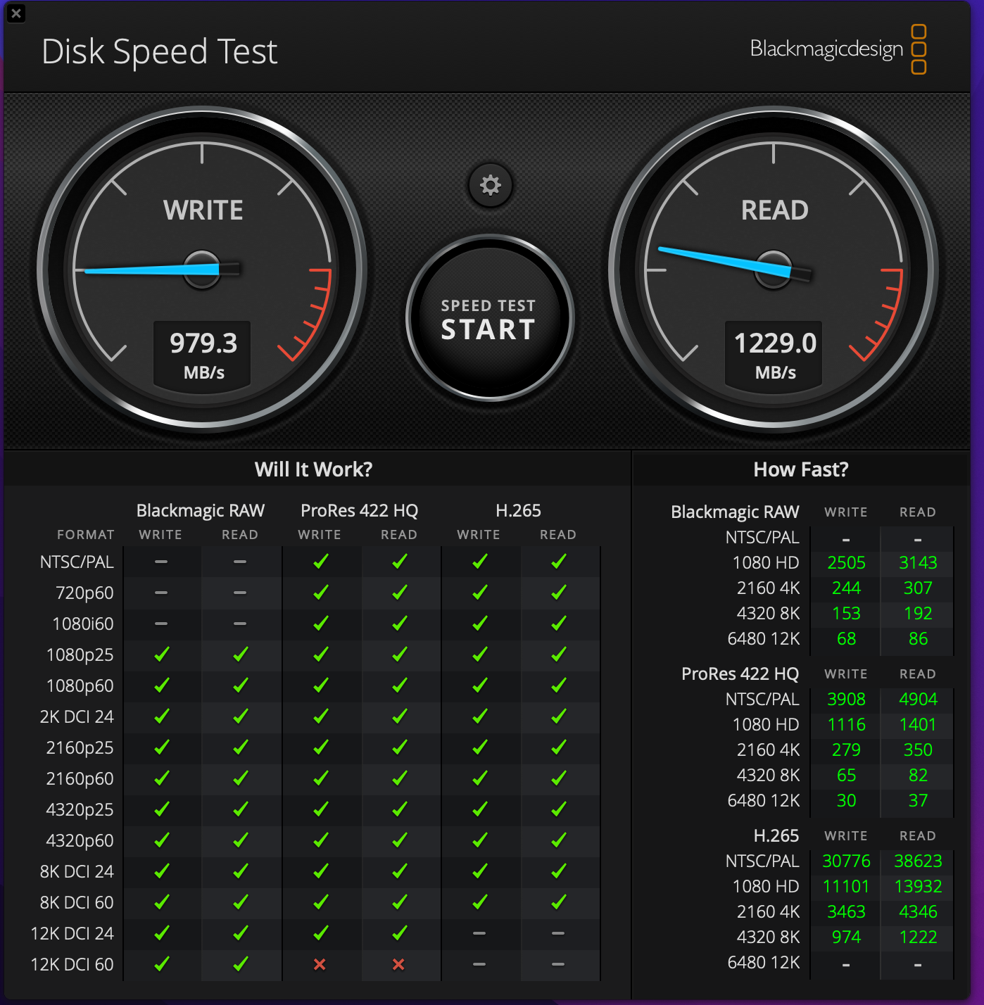

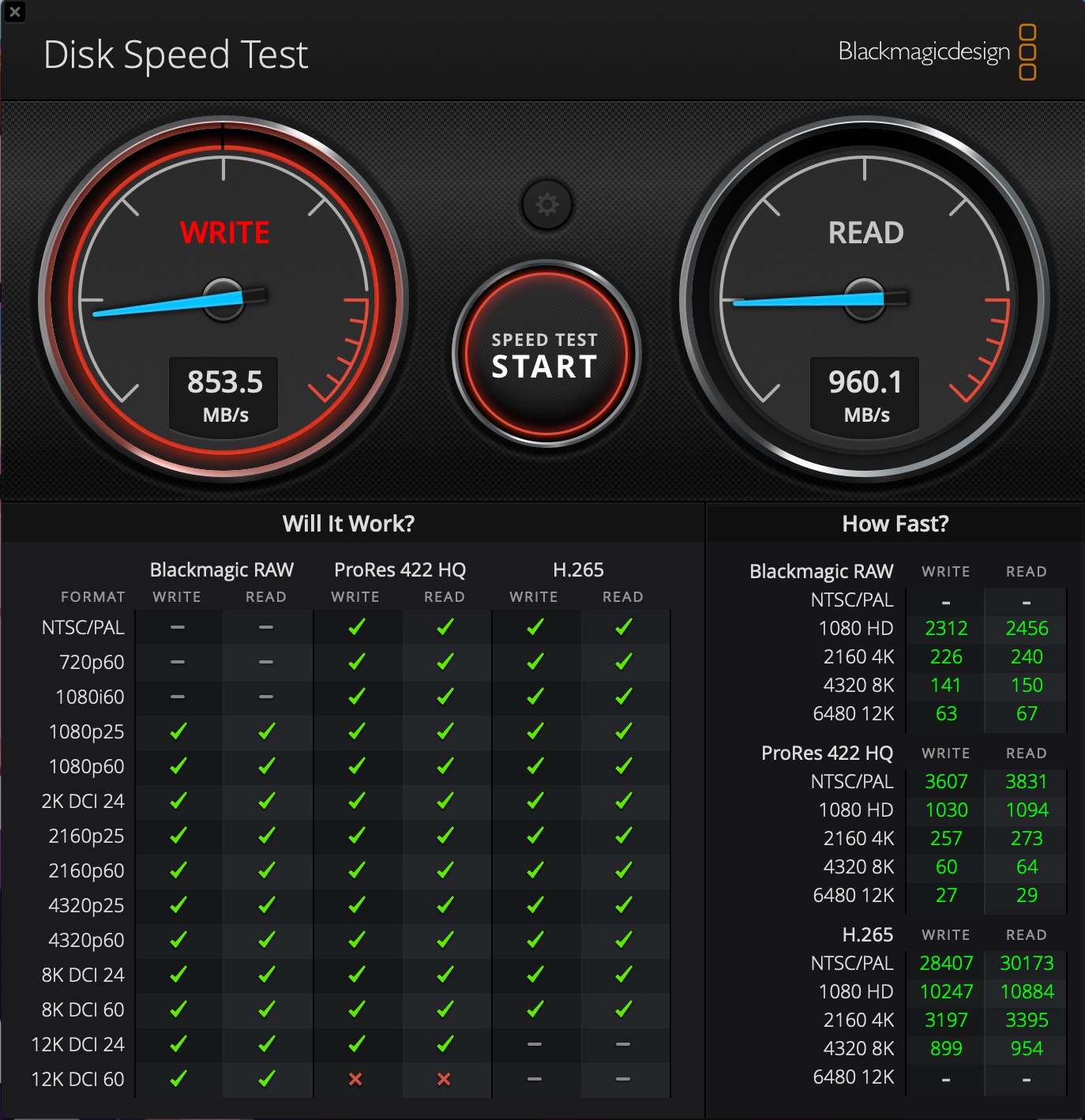

I bought the WD SN850 NVMe SSD and tested it with 2 Sintehc NGFF M.2 nVME SSD Adapters.
I noticed the following...
The CPU temperature ran 10-15 degrees hotter (it's why I tested 2 adapters to confirm)
The disk speed readings didn't significantly increase. I know the macbook limits the read and write speeds but was I wrong to think there would be a more noticeable increase?
Just wanted to get some advice if anyone had the same issues or any suggestions? Did all of your SSD upgrades cause an increase in CPU temp?

I wanted to upgrade the SSD speed as my older macbook pro retina 13 early 2013 had 500GB but the speed of it was noticeably faster compared to my current model.
An increase in temperature is considered normal. Other people in this thread also mentioned an increase in temperature after the SSD upgrade.

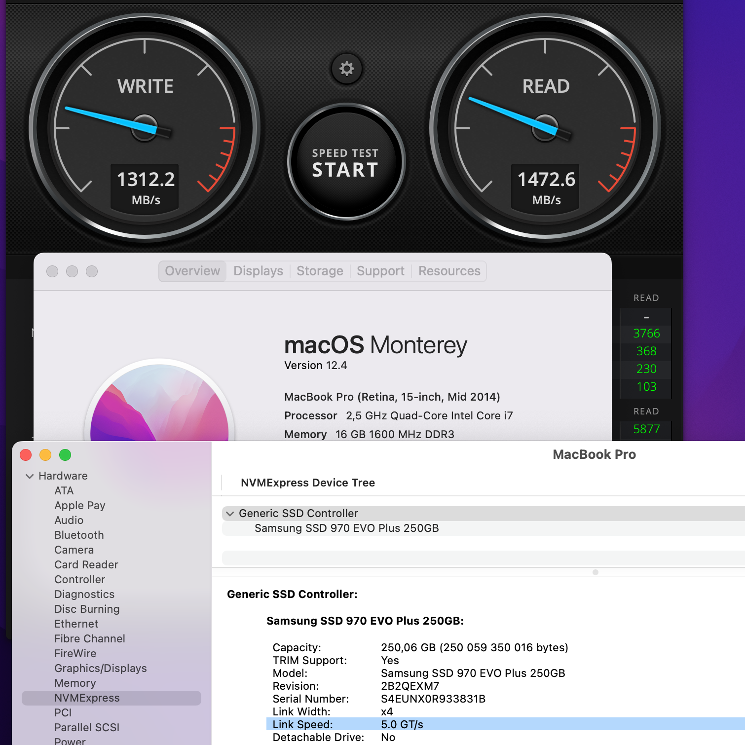

You have a 2015 MacBook 13. Check what System Report shows for Hardware->NVMExpress:
Link Width:x4 / Link Speed:5.0 GT/s (Max speed is 1500)
OR
Link Width:x4 Link Speed:8.0 GT/s (Max speed is greater than 2200)
