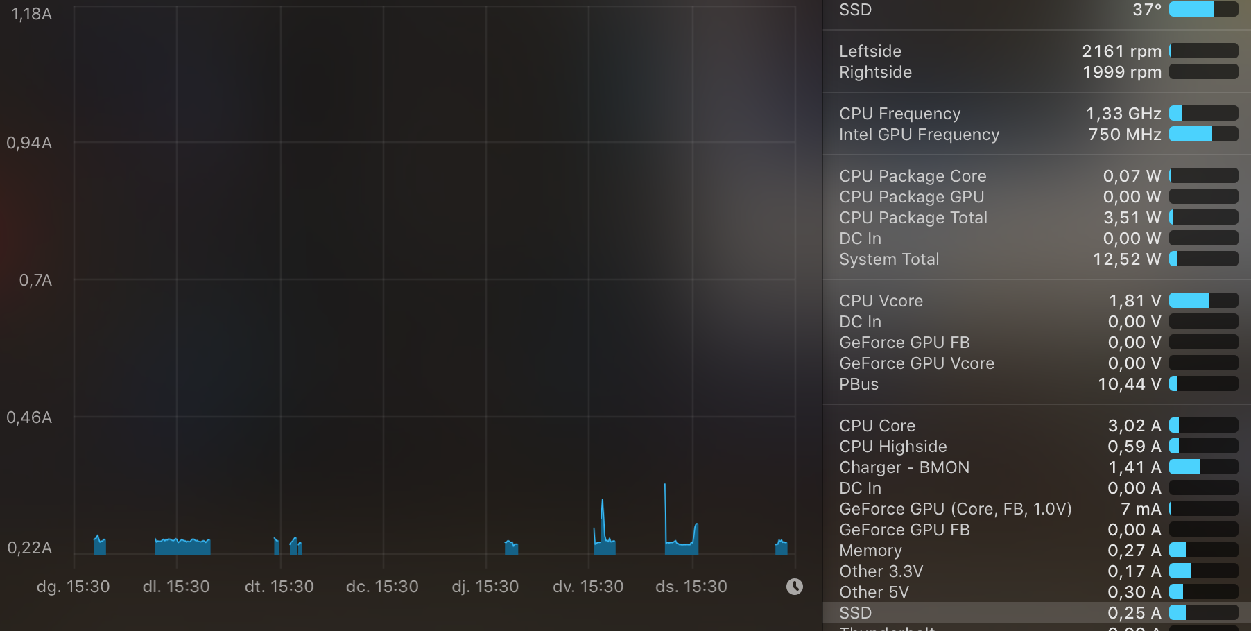

Hello,
New to the forums and wanting to check if there's anything more I can do in order to lower power consumption on my MacBook.
So I have a MacBook Pro 15" Mid 2014, 11,2. Installed a new 3rd party battery (my old original battery was in "normal" health, but I found it to discharge faster than usual. Also installed new cooling paste on CPU, and finally got a new 1TB SSD storage. First I got a Samsung 970 Evo +, together with a NVME adapter (https://www.amazon.se/dp/B07PJTFBKL?ref_=pe_24982401_513610551_E_301_dt_1&language=en_GB).
I later found out that the EVO + isn't very power efficient so I bought a WD Blue SN570 after reading some good reviews from users refitting MacBooks with it.
Finally I installed Ventura with OpenCore Legacy Patcher, and SSDpmenabler kext.
Now my question is: I'm getting around 0.1A at idle on my SSD. Should I be contempt with this or is there anything else I should consider? I've read about the Sintech adapter being superior - worth swapping to that? NVMEfix - would it help me at all? Anything else to do in order to spare juice while not using the laptop?

Hello,
Regards
I think 0.1A is what you should expect. I also use Ventura 13.2.1+OCLP 0.6.1 with NVMe Power Management set, which never gave me less than 0.17A for the SN550 2TB.
NVMe Power Management does not use SSDpmenabler, but LILO+NVMeFix I presume.
In your case, enable NVMe Power Management in Settings->Misc Settings on OCLP, if still not enabled.
Alright, thanks I’ll check that setting out - I have not seen it before. Very much appreciated!

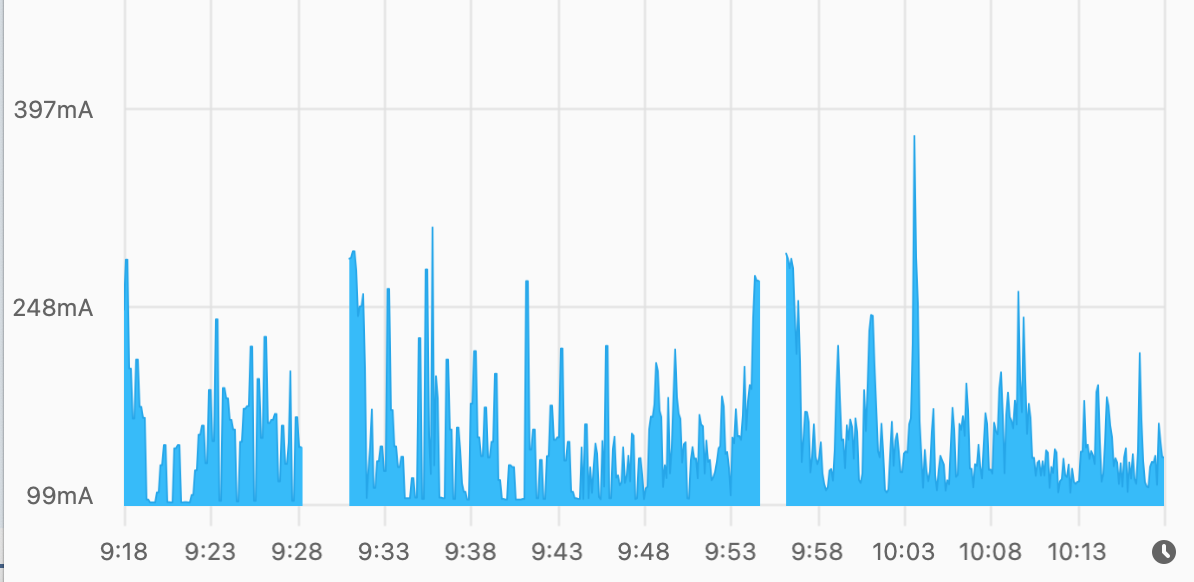

Hello everyone!
Been running a mid 2014 15" mbp with the original apple SSD since 2017.
I'm using still high sierra since I use CUDA. Boot ROM 162.0.0.0.0
However, since installing istat I noticed that the ssd never sleeps. It always consumes 0.25A or more.
How could I test / make it sleep again?
