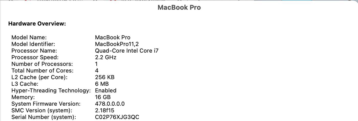

hi, guys i'm new here. rencently i've upgraded my macbook pro 15'' 2014mid to a western digital sn580 1t with the lastest Ventura 13.6 using OCLP 1.2.1. unfortunately, the system shows a colorful rolling beachball and then totally freezes up from time to time, after that i have to reboot the machine and the crash report says something like "Loss of MMIO space. Write. ...". FYI i've used the very same adapter with my old sn750 500GB in the same os version and everything works smoothly for about a week. i'm writing this just for the reference anyone who is going to buy a sn580, at least it doesn't work out for my spefic hardware and software combination.

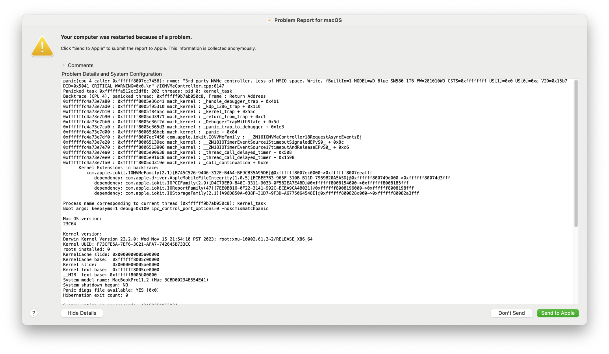

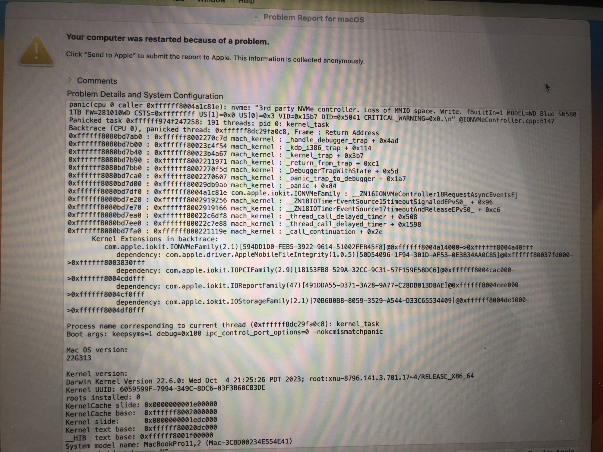

crashed yet again!

crashed yet again!
Lots of factors could be causing this, these are a few of the possibilities:
- Mounting of the drive/adapter (contacts clean, is it or the adapter contacting any part of the case? Is the drive secure inside the adapter? Is the adapter shorting out on the case? - insulation may be needed for the top of the adapter)
- Firmware up to date on drive? (check under Windows or in external enclosure linked to suitable device - usually these should improve operation of the controller)
- Drive running within normal temps? (use MacsFanControl/TG Pro/iStat etc to check, if it is running abnormally or overheating, a thin piece of thermal pad or heatsink may be able to reduce temps especially on controller..)
- Tried using the "3rd party NVME power management" option within OCLP? (uses NVMEFix kext which may help with compatibility of some controllers, you can also add SSDPMEnabler as well if that further helps..
i've got two different adapters each from different manufacturers, both of them work their magic with sn750 on Ventura as well as Sonoma; none of them works well with sn580 on either OS (crashes after a couple of hours, i couldn't give you the exact steps to reproduce the crash, seems random). IMHO, it has nothing to do with physical connectivity.
yes, i've checked the drive on a Windows pc, the western digital dashboard shows the firmware is already up to date.
temps are fine ranging from 30 to 45 give or take under constant surveillance of MacFanControl
i just leave the OCLP setting as is, the option is checked by default.
thank you for your advice. i got what you mean, it might be too soon to jump to the conclusion and call the sn580 the culprit. since this macbook pro is my daily driver i might as well settle with sn750 and be done with sn580.
