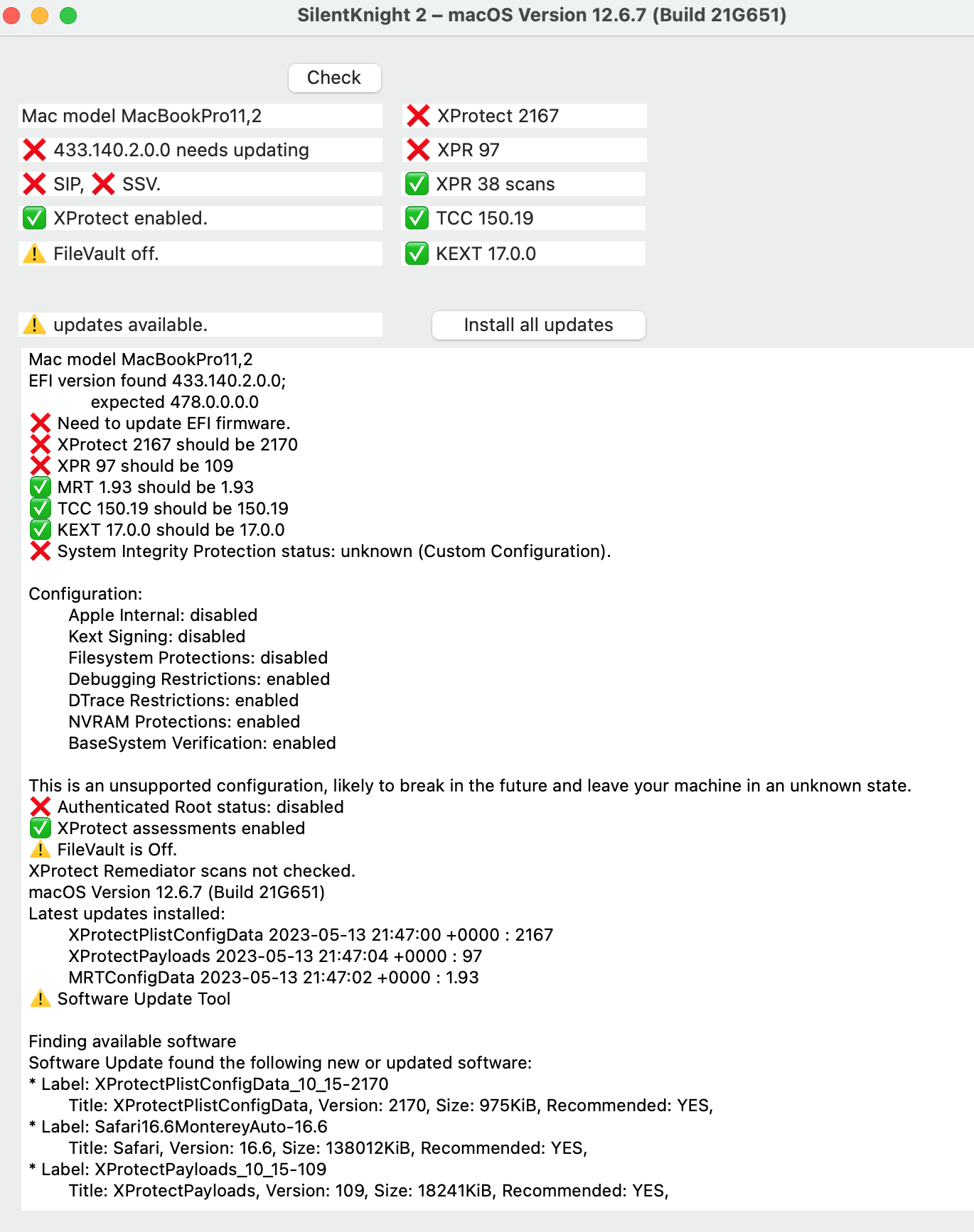

1 - I was on Big Sur for a few months after the new SSD went in (official MacOS). No issues. Then I went to Ventura OCLP. No issues for a few months until performing an OCLP Ventura update. Kernel panics started after that and continued with each Ventura OCLP Update. Then I went ahead and downgraded (clean install by wiping SSD) to Montery OCLP. Less kernel panics now, but still plenty.
2.1 - This is what the command line returns after entering that line into the terminal:
"ReadBinaryFromKernel: No matching services found. Either this system is not supported by eficheck, or you need to re-load the kext
IntegrityCheck: couldn't get EFI contents from kext"
2.2 - A screenshot from SilentKnight:
3 - Copied the DriveDX report to pastebin: https://pastebin.com/zRYDmF1M
Looks ok to me.

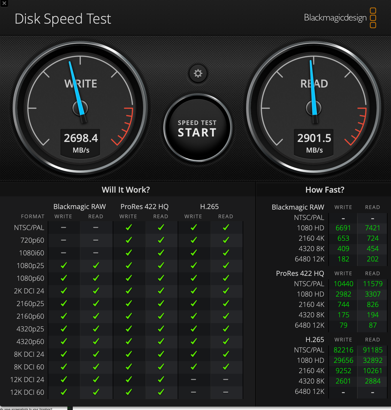

I am running Sonoma on my 2015 15" MacBook Pro using OCLP. I just had the Apple 2TB Polaris SSD fail so I replaced it with a 2TB WD Blue SN570 plus Sintech adaptor. I am running SsdPmEnabler & it doesn't seem to be running hot or using too much battery. Performance seems very decent. I tried a 4TB Crucial P3 Plus which worked OK but performance was slower on Black Magic Disk Speed Test & I decided to send it back as I didn't really need 4TB. At £93 the WD Blue SN570 is probably the cheapest 2TB SSD around.
2015 15" MacBook Pro using OCLP with a 2TB WD Blue SN570 plus Sintech adaptor.

I've just been looking at the temperatures in my 2015 15" MacBook Pro 11,4 in Macs Fan Control. Even when I thrash the SSD with Amorphous Disk Mark or Black Magic Disk Speed Test the temperature of the 2TB WD Blue SN570 never rises above 38C.

First, I would upgrade it to Big Sur and ensure that it is running the latest firmware version.
You can verify that by running SilentKnight SilentKnight 2.7 (Universal App for Catalina, Big Sur, Monterey, Ventura and Sonoma)
