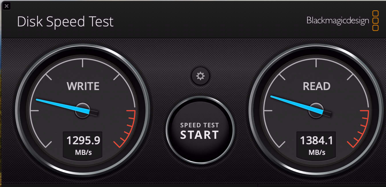

HE PROBADO EL WD SN570 SE EN MACBOOK AIR 2017.
Funciona perfecto.

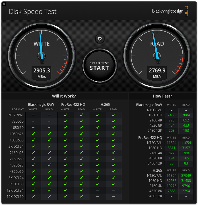

Hi All,
I think I've managed to find a fix for hibernation issues that does not require the hardware tools in Cmd+Q's guide (CH341 A and SPI to J6100).
Background:
MacOS version: Sonoma 14.3 (Via OpenCore Legacy Patcher v3.30)
Mac: MacBookPro 11,2
Processor: Intel Core i7 2.5 GHz
Boot ROM Version: 478.0.0.0.0
SSD: Apple SSUBX (off eBay with heatsink from Mac Pro 2013 - filed down edges to fit with thermal pads)
pmset -g output: https://pastebin.com/N5KZ052y
SSD speeds in BlackMagic benchmark - attached
SSD temperatures from istat menu screenshot - N/A
The issue I had was that I was on firmware 478.0.0.0 (the latest) for my Mac, yet I was running into kernel crashes (windowserver) because this firmware doesn't work properly with my SSD (even though the SSUBX is AHCI, not NVME).
I followed Cmd+Q's guide to extract the system firmware update file from the Big Sur install OS app.
This involved me opening the files 'MBP112.scap' and 'MBP114.fd' in UEFItool (0.28).
I then transferred the NVME driver from MBP114.fd to the MBP112.scap.
(GUID 51116915-C34B-4D8E-86DB-6A70F2E60DAA)
Once I had saved my new image, I named it 'MBP112.scap' as this was the firmware file I wanted to upload to my EFI.
I then followed the guide below to do this:
Once I had done this I followed this YouTube video to mount the EFI and confirm that it was successful by opening the firmware (EFI > EFI > APPLE > FIRMWARE > MBP112.scap) with UEFItool:
I hope this helps someone.
EDIT: I've attached the modified MBP112.scap file for a MacBook Pro 11,2.
  • MBP112.scap.zip

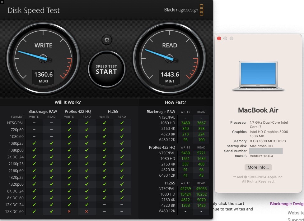

I’ve had success today upgrading a 2013 13inch MacBook Air with a sintech short adaptor an a Hynix P31 Gold.
I Appear to have no issues with Ventura via OCLP performance is as below

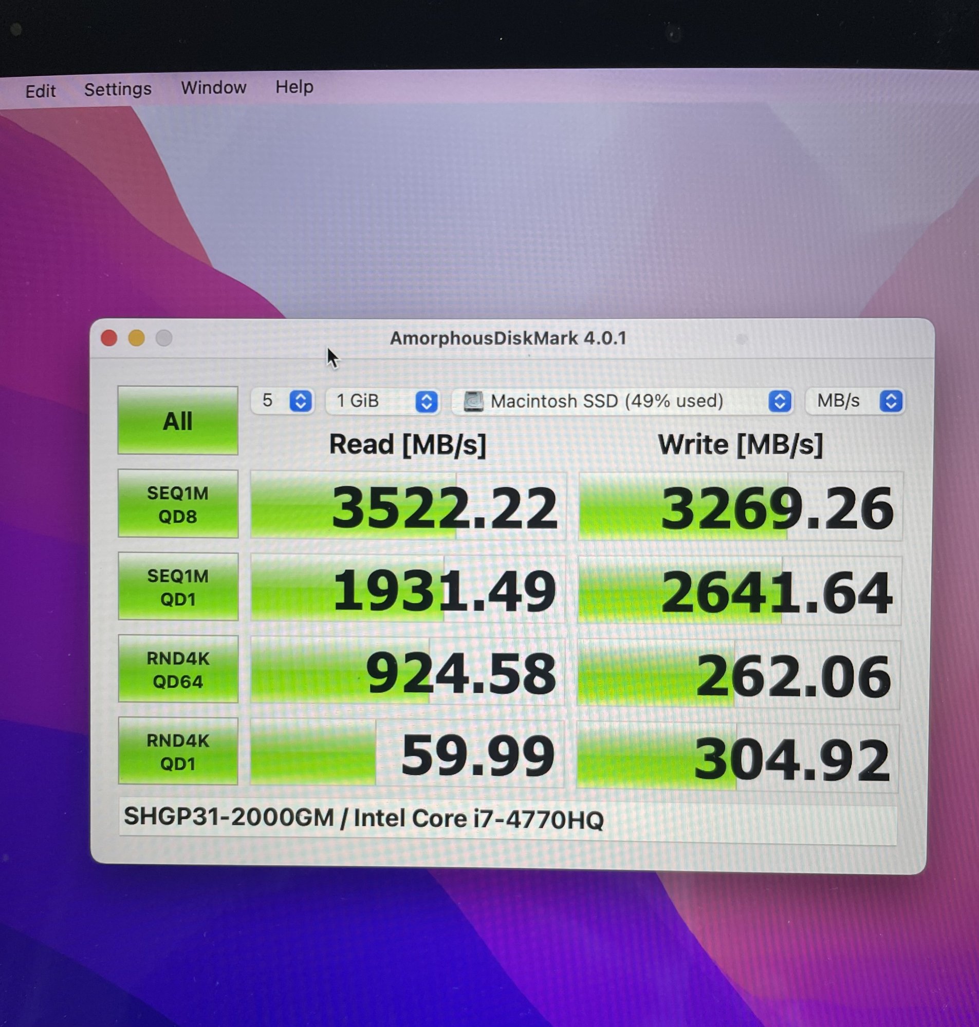

I have a mid 2015 15" with the amd m370x gpu. I'm using an sk hynix p31 gold, 2tb drive with short adapter. Currently on the latest version of Monterey, not using any oclp stuff. So far so good, had it running for a month and a half so far.

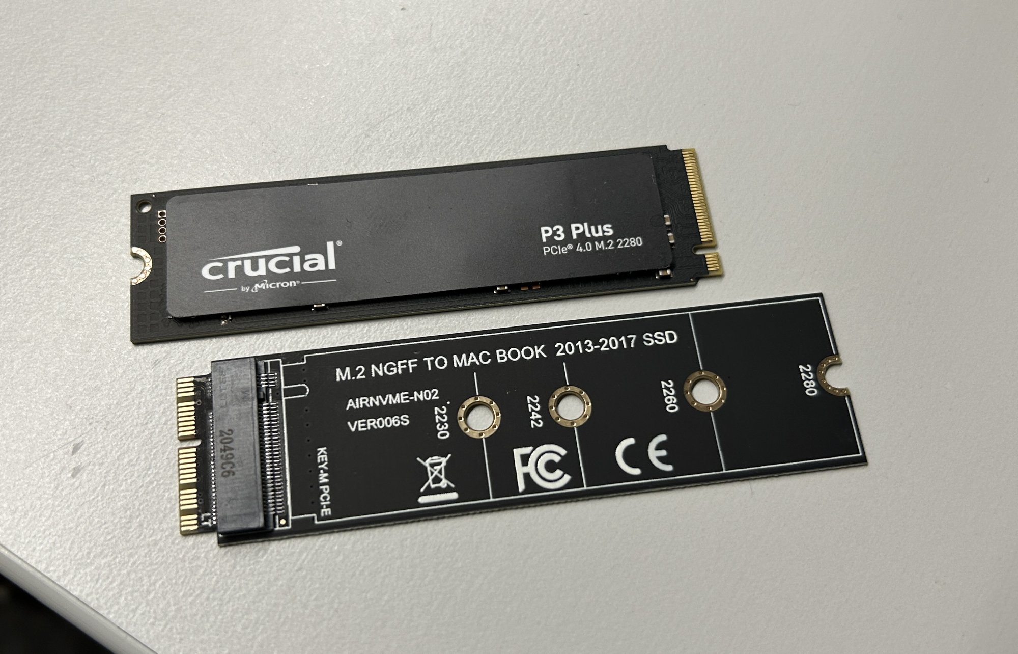

I just dropped a crucial P3 Plus in my MBP 2015 13'' using this adapter.
The same has worked for me in a late 2015 iMac but the drive would not be recognized at all.
Any idea?
Any idea?
If you search this thread (maybe last 20 pages) you will find reports of other users having issues with the P3. If I remember correctly, this SSD is not compatible with the Macbook Pro/Air from 2013-2017.
Any idea?
Tried using another disc image (Linux/Windows, etc) to format the drive? (given the reports of it working are mixed you may have the issue of the drive being in a state where it may not be able to be initialised by MacOS..)
