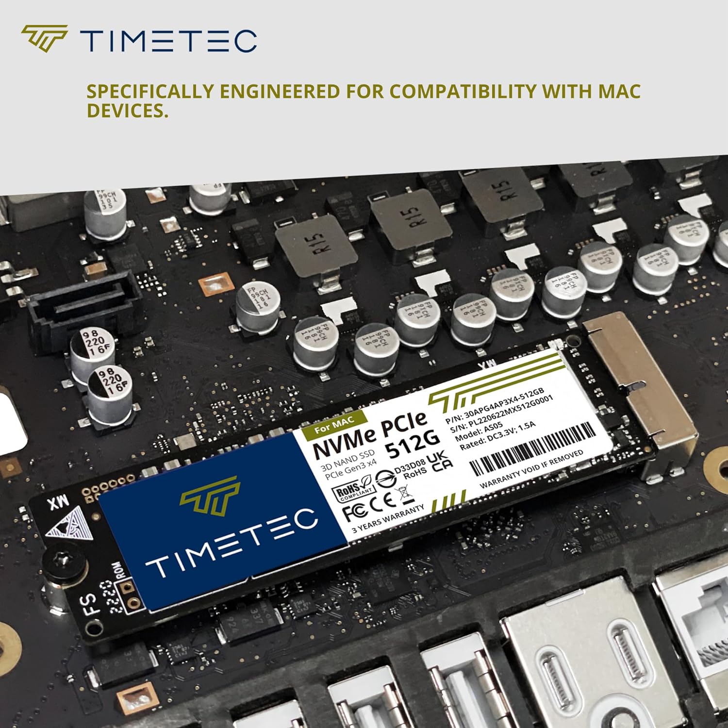

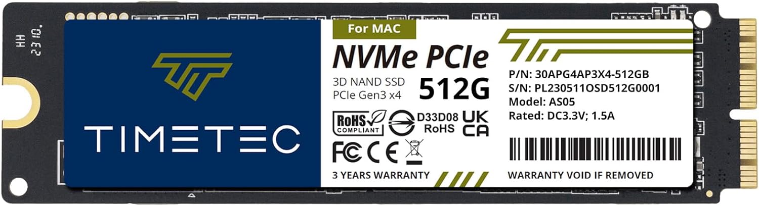

Two months ago my original Apple SSD 256 GB stopped working and I was suggested to make an attempt to change it by myself because it’s out of date and at the Apple Store couldn’t fix it up.
At first I tried with this Timetec which worked two weeks. In this short period of time, also the original Apple SSD booted occasionally.
After that Timetec SSD caused MacBook not to turn on (black screen with fan working at low speed, can't execute SMC and NVRAM reset or any other key combination).
Therefore I found this forum and I decided to buy Sintech adapters (short and long) and a WD SN570 1 TB.
Unfortunately with this setting Macbook does not boot, I have a grey screen (SMC and NVRAM reset work but do not change anything, safe boot doesn’t work). I succed in installing macOS Big Sur with a USB enclosure from a bootable USB drive. WD SSD boots if in the enclosure but not if assembled on MacBook.
I didn’t give up so I bought a SK Hynix Gold P31 but I obtain the Grey Flashing Folder Question Mark (the same with original Apple SSD).
Nothing change if I install Big Sur with the USB enclosure and then mount the p31 on the logic board (SSD not detectable, folder question mark).
I think it should be a problem of the connector on the logic board, am I wrong?
Don’t know if I should try with a used original Apple SSD on eBay or change the logic board.
Thank you very much for suggestions!

Yes, I have the same result with p31 with Big Sur and Windows 10 (bootable form external drive, not if assembled). I don't think it's a problem of the adapters (same result with either short and long Sintech and with another one non-Sintech adapter). Timetec SSD has 12-14 pin connector, no adapter need.
Diagnostic tool shows VDH002 error. At the Apple Store the hardware diagnostic showed a storage problem (at that time was original Apple SSD mounted).

Hmnn, so you slot in the Timetec nvme without the adapter?
I wonder if that is something correct to do. If not, it could have damaged the nvme as well as the logic board socket.
Not sure.
I hope not so! It's designed for Mac connector... Additionally I was unofficially advised to try with this one at the Apple Store.

Thank you! But I think I have updated the firmware with Big Sur and I also checked with SilentKnight. I was told during Apple hardware diagnostic (at the beginning) that a "storage error" could mean either a SSD or a logic board problem but the Apple technician suggested to me to try with an afermarket SSD (Timetec).
Nvme encolsure for Apple/Timetec SSD is about 90€.
I think my option are buying an used original Apple SSD (20-30€) to confirm it's not a SSD issue or directly try to change the logic board (150€).
What do you think?
What do you think?
20€ isn't much to invest in a test an SSD. That said, my hunch is it's a logic board issue. At that point I'd think about donating or selling the laptop, since it's already 11 years old, and finding a new or used replacement, unless you like fixing stuff just for fun.
You're right... It's all about I think it's a good machine for my needs and at this point "it became personal with me" :)
