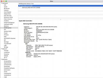

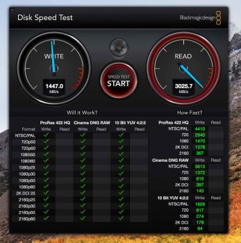

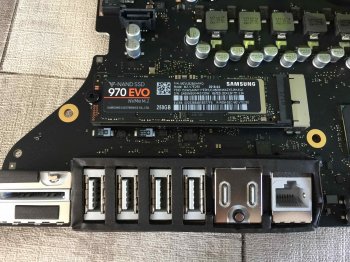

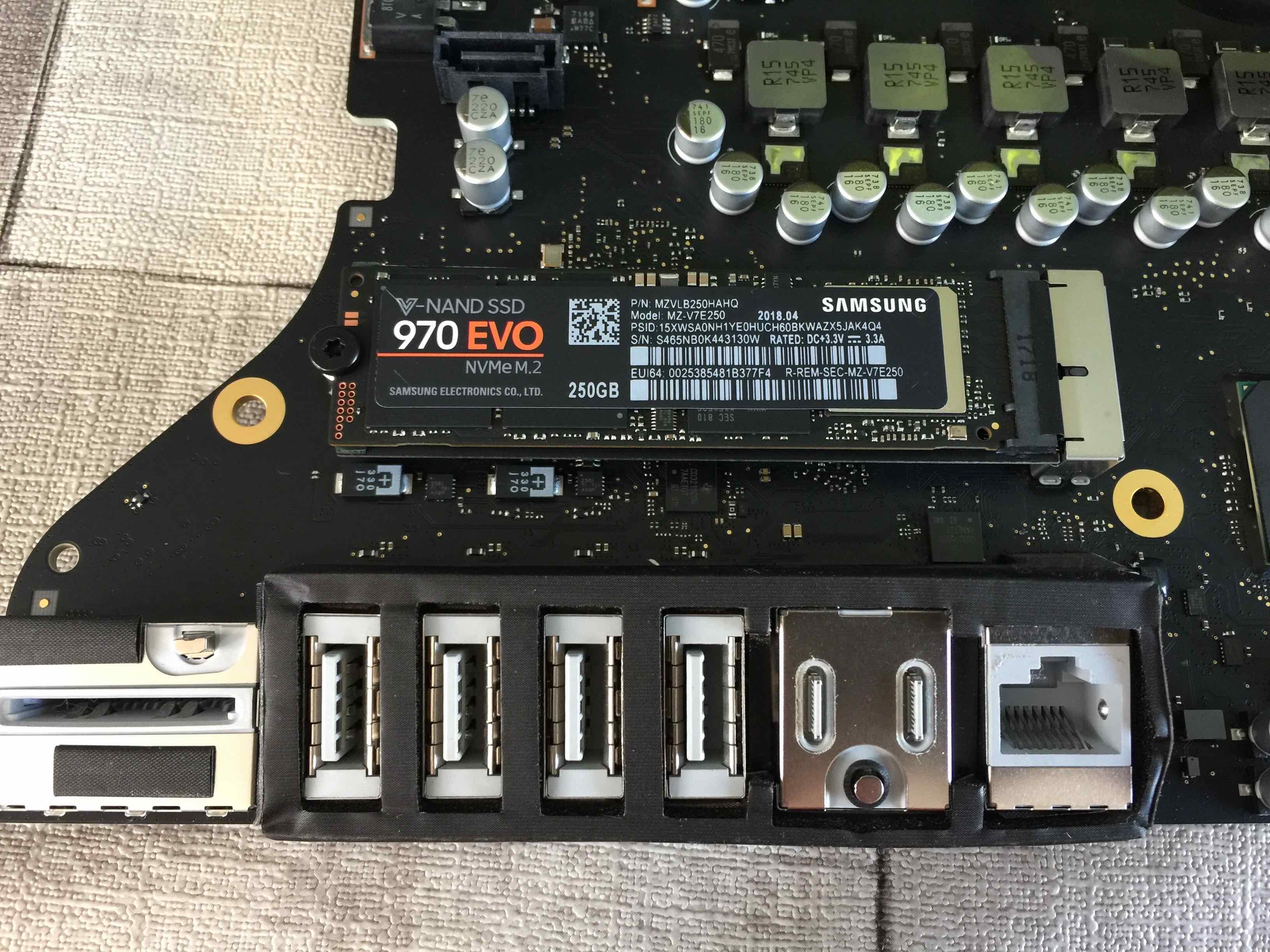

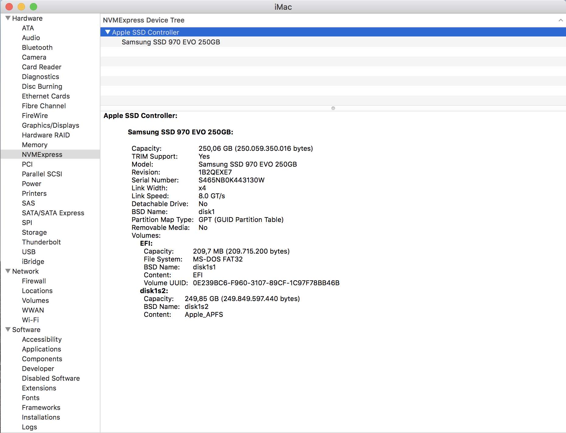

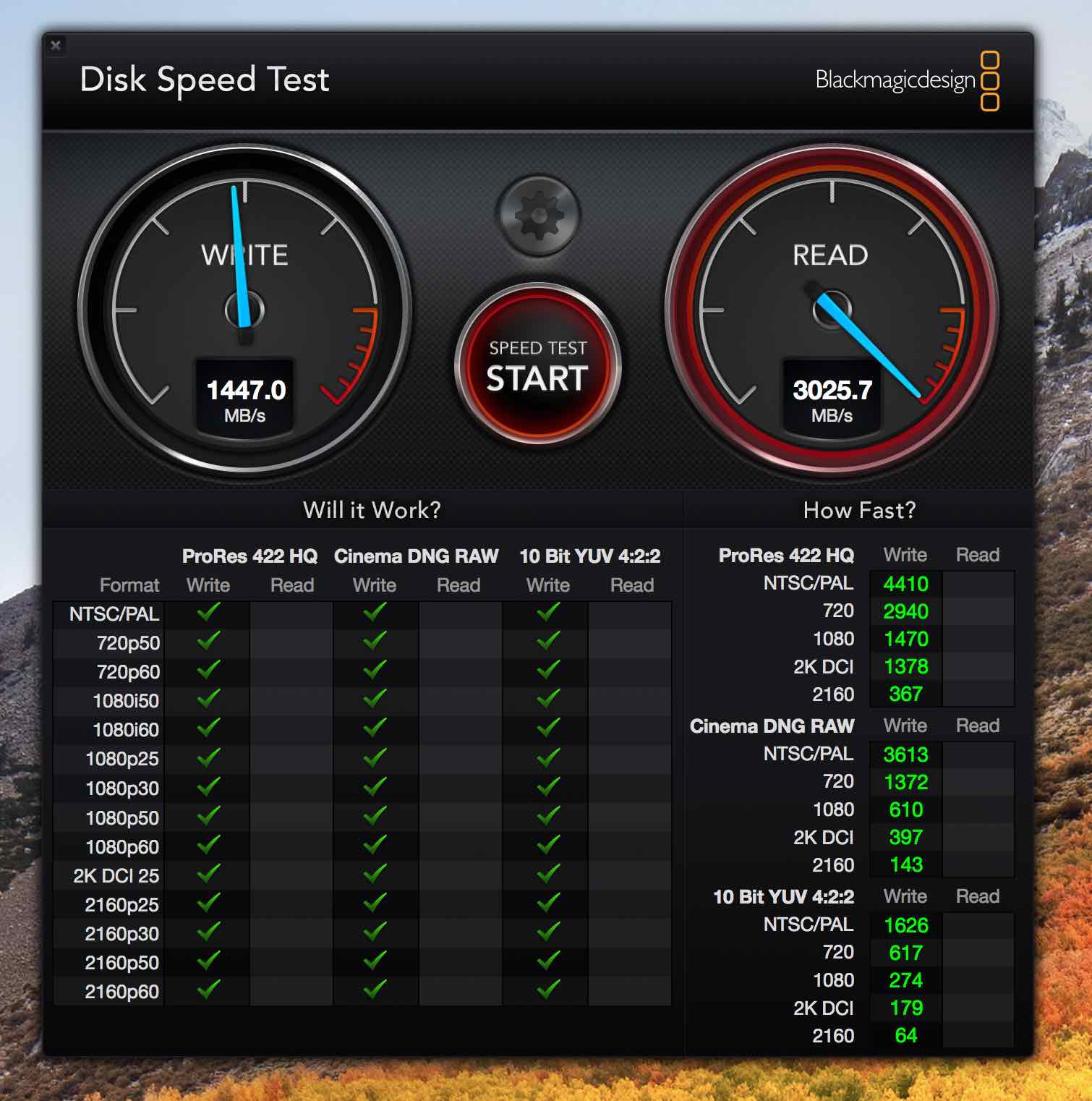

Just upgrated my iMac 5k 2017 with Samsung EVO 970, everything works perfectly without any issue. 1.jpg 2.jpg 3.jpg
