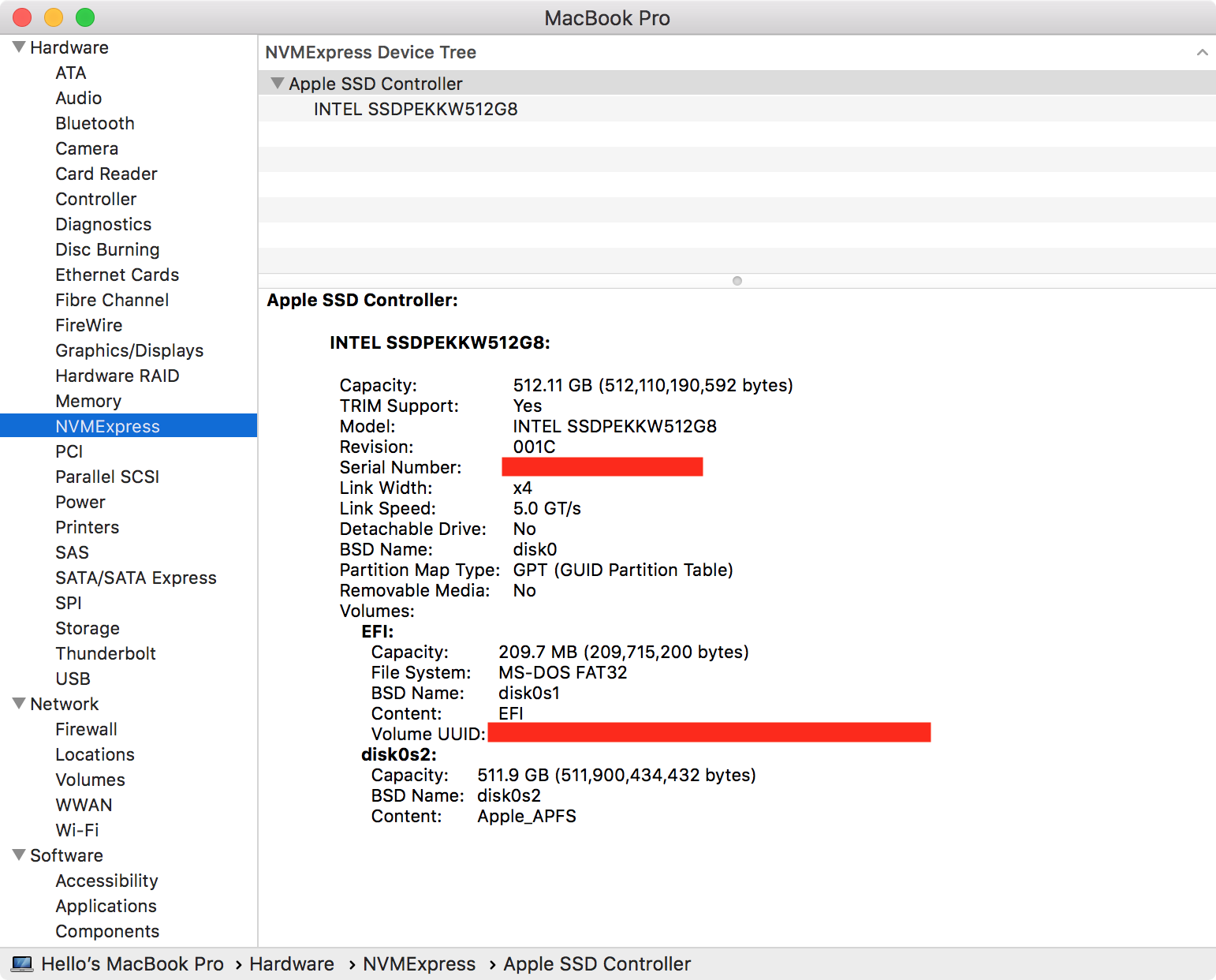

Hmm.. perhaps this has something to do with Samsung drives? Again; I don't have any standby issues once I've applied the pmset changes; I remember it would have issues coming out of standby (black screen) before said pmset changes.
I've got a 512GB Intel 760p waiting to go in; just waiting for the Mojave GM to be released. Was meant to come out yesterday but I guess now Monday / Tuesday next week. OK so I was impatient and swapped it out to the Intel 760p. iStatMenu reveals a lower idle power figure, so only time will tell. Do take note that this drive is not capable of 4096 sector; only 512 - I wasn't aware of this!

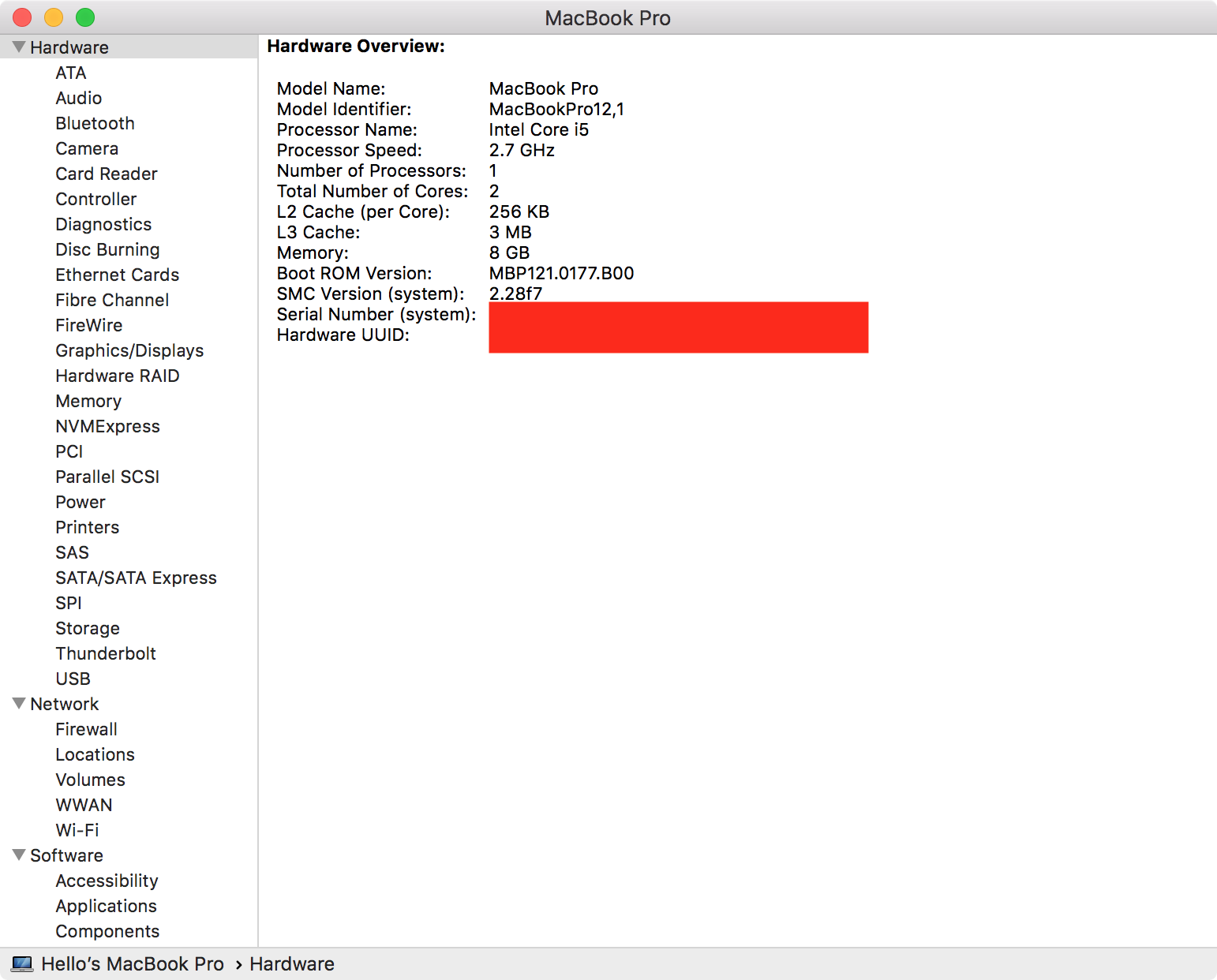

Also did someone tried bootrom update that @d235j mentioned few post up?
I just wanted to demonstrate that it is possible to update bootrom on a non-Apple drive with their tools.
I'm planning to do more experimentation with these tools in the future, though I'm not sure how soon.
Reactions: Audit13 and Trunkz
This method works; I’ve tried this on both stock apple SSD and Samsung & Intel SSD :)
Thanks to both of you for confirming that the upgrade is possible with a third-party drive :)

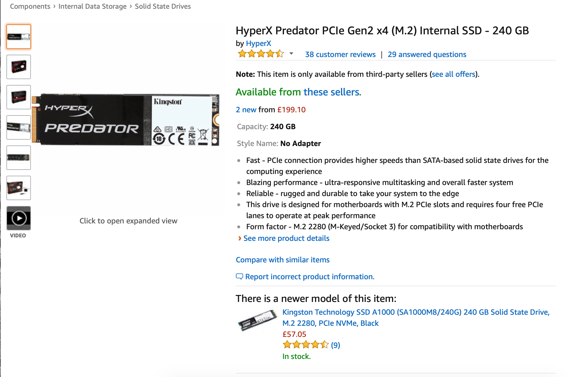

I found one:
£200 for 240GB vs £57 for the newer NVMe version.
Good luck.

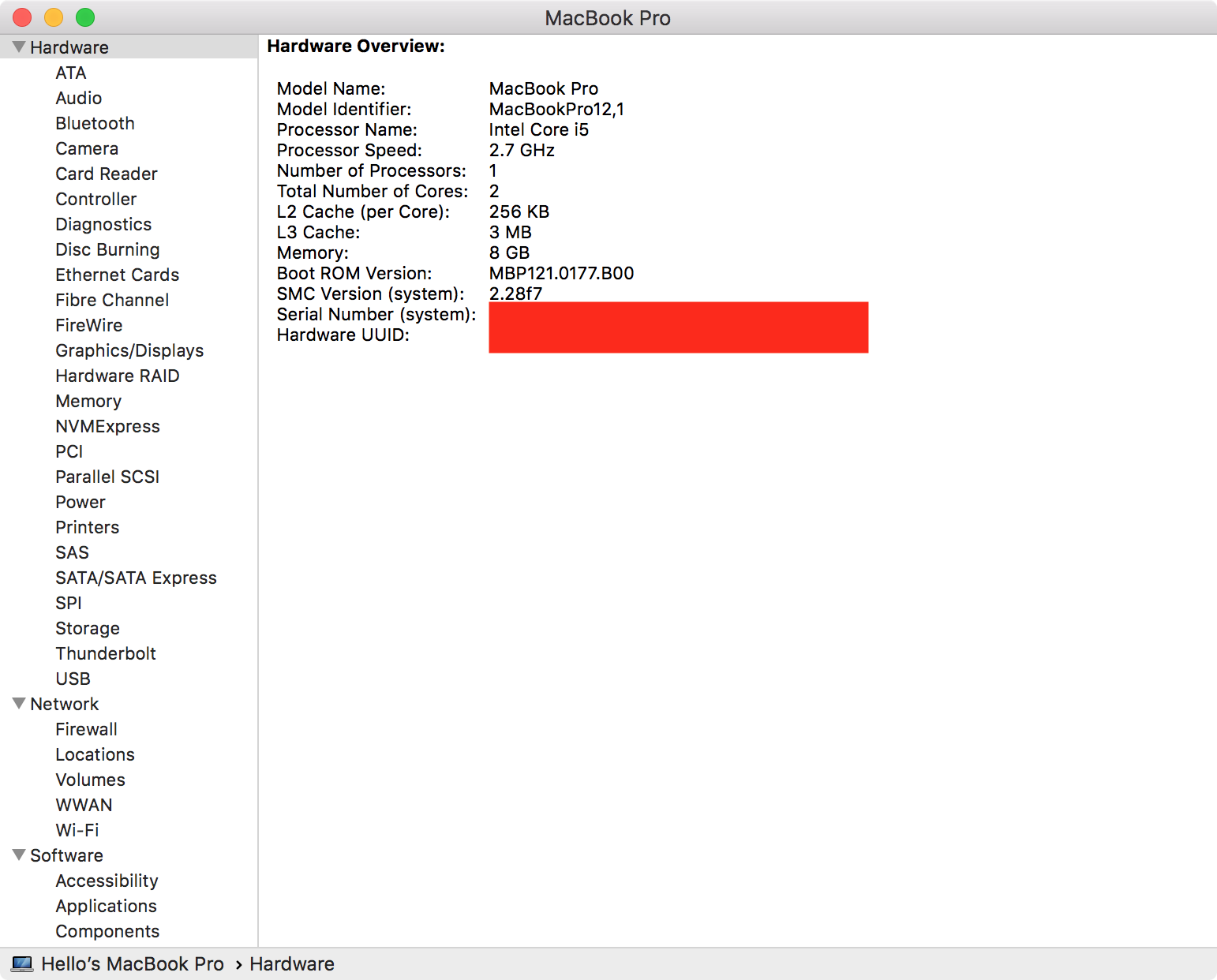

Go and update your BootRom. You are running an old(er) version! But yes those instructions are intended as a workaround for pre-2015 MBP :)
my MBP is currently running the latest High Sierra.
What is the newest BootRom for 13’ MBP 2014 by the way?

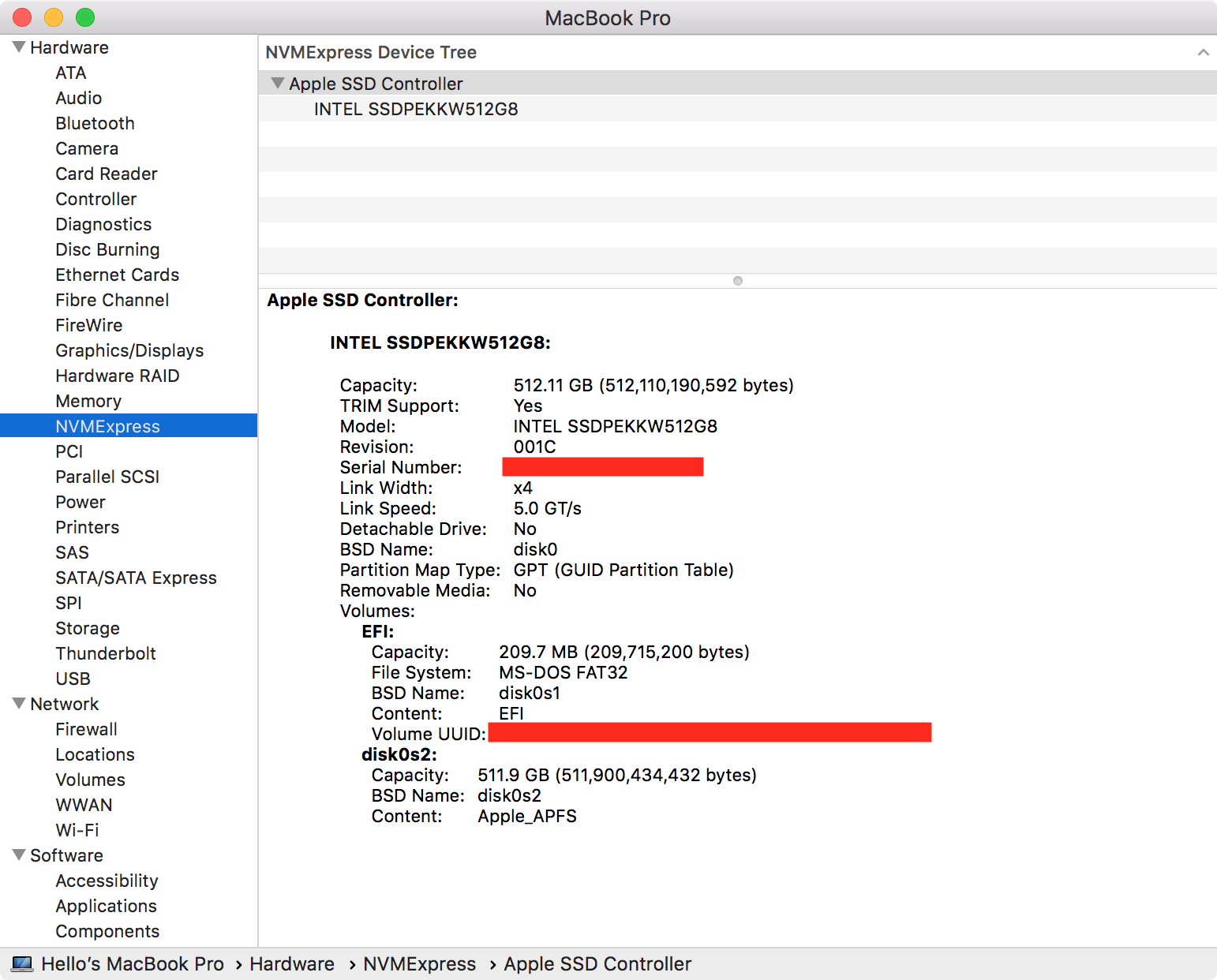

Hello all, I am pleased to announce that my installation was successful on an Early 2015 13" Retina MacBook Pro.
The list of items used:
  1. Intel 760p 512 GB
  2. The ST-NGFF2013-C adapter (long black)
  3. This set of tools from Amazon; it has all the bits needed for this model of MacBook, and maybe any or even every.
  4. An 8GB (minimum storage recommended, the more, the better) USB to create a bootable USB of High Sierra (10.13.6 is the version I used, which is the latest at the time of this writing). Created by following this video. (edited here, forgot this).
  5. External Drives for data backup (HDDs worked fine).
I will list some steps for those who don't have an idea yet of where to start.
Step 1: The Most Important Step!
BACK UP YOUR DATA!
It cannot be over expressed how important this step is.
What I did was create two backups; a Carbon Copy Cloner backup (I used version 5.1.4 as it is updated for High Sierra compatibility) in addition to a normal Time Machine backup.
Step 2: iFixit
After letting the MacBook cool down for about 5-8 minutes I followed iFixit's guide to get the mission started.
I recommend having a can of compressed air as I noticed the inside and bottom plate containing lots of dust and other particles. Furthermore, I recommend air dusting the fan in order to maintain it clean.
Be sure to disconnect the battery!
** I noticed that when installing the SSD into the adapter and screwing it in, it appears to bend slightly (as others have mentioned). I didn't tighten the screw too tight as to potentially bend it too much **
Remember to use the screw included with the adapter, it's longer than the default one.
Step 3: Install and Recover
After closing the lid and all, insert the USB and hold the option/alt key.
Format the SSD to APFS (recommended over HFS as it's faster for SSDs).
After formatting, you should see the SSD on the main menu that you first see when the MacBook boots up.
Install, wait a while, and you're done!
I chose a clean install and did not use the Migration Assistant, so I am slowly adding back all my needed data.
Results: I used the MacBook with the new drive and it definitely has a performance boost, yet marginal battery loss. This is first day reporting, I hear that battery loss is due to caching so I am not super worried as of yet.
  • BlackMagic reports 1400/1500 top speeds, compared to 400/~1000.
  • I am using iStatMenu to monitor battery consumption. I've noticed that it takes, on average, 0.18A constantly, about three times as before. Again, this may be due to caching. I will report back after some time has passed if any improvements are made.
Update (9/18, 1 day later): I forgot to mention that on the first night I left it to sleep, the battery fell 10% from 100% over a 12-hour sleep period. The second night it remained at 100% for another ~12 hours. Results are looking good still!
Photos:
