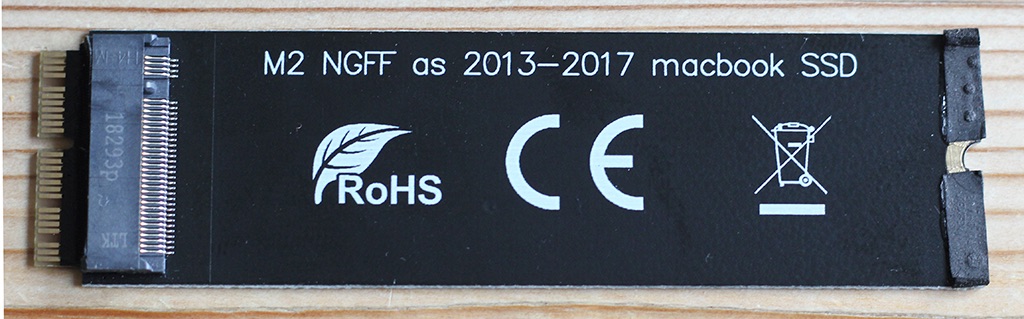

Hi, i’m planning to upgrade
Intel 760p M.2 SSD 512 Gt SSD to my macbook pro retina 13” early 2015. I wonder should i get the sintech short on long adapter (black version)?
Hi, strange thing here. I have been testing all kinds of M.2 NVMe drives. I have been testing on MacBook Air (2014-2015), MacBook Pro 2013-2014. I wanted to try the Intel 760p since it uses half the power opposed to the 600p. I wrote before how the EVO 970 (and 960) just get freakin hot and use at least twice as much power both in use and idle:hi, I just mounted an Intel 760p on a MacBook Pro 15 mid 2015 with A-tech adapter I have a write speed 1355 and reading 1400. I think the reading speed should be better. can help Me
Both will work. I have not tested the small black one, only the small green and found no difference, even the small green gave me better speeds. Just be careful and do the taping.View attachment 794301

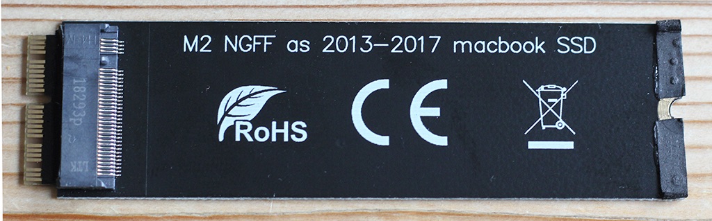

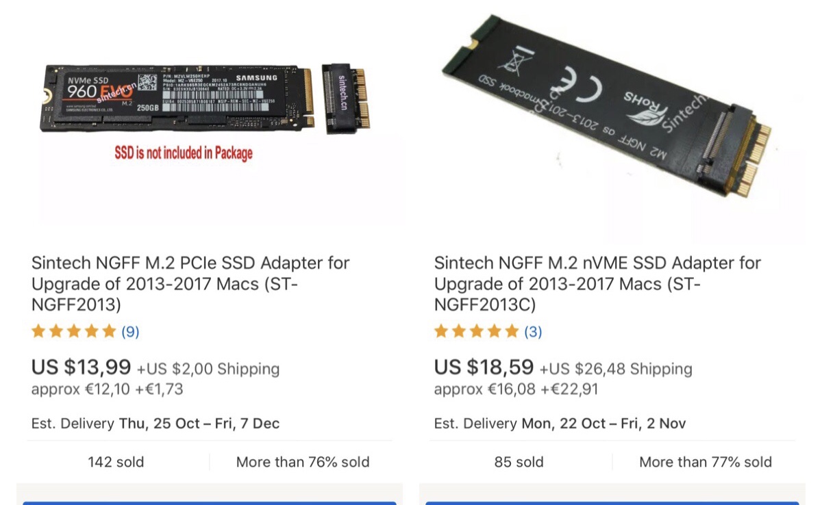

Hi, here’s the short and long Sintech adapters. Does both work similarly with Intel 760p and MBr 13” early 2015?

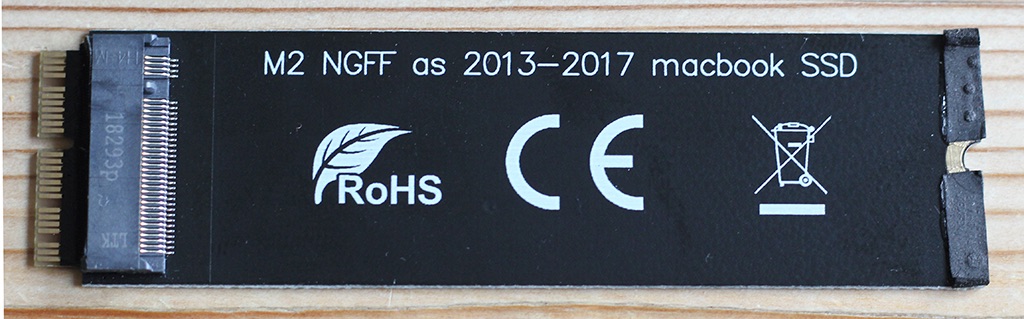

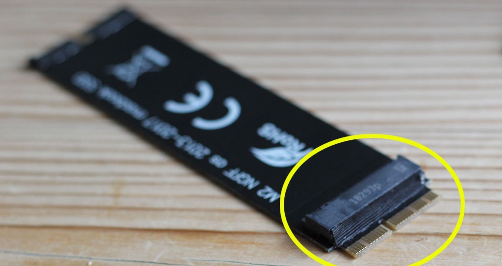

Please can you send a link of the ebay auction, and precise which model of mac and SSD you have, and also post photos of your adapter ?

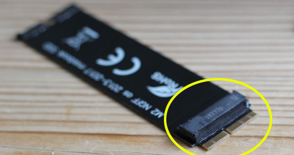

Only sintech rev. B or C adapters have the proper wiring and do work well.

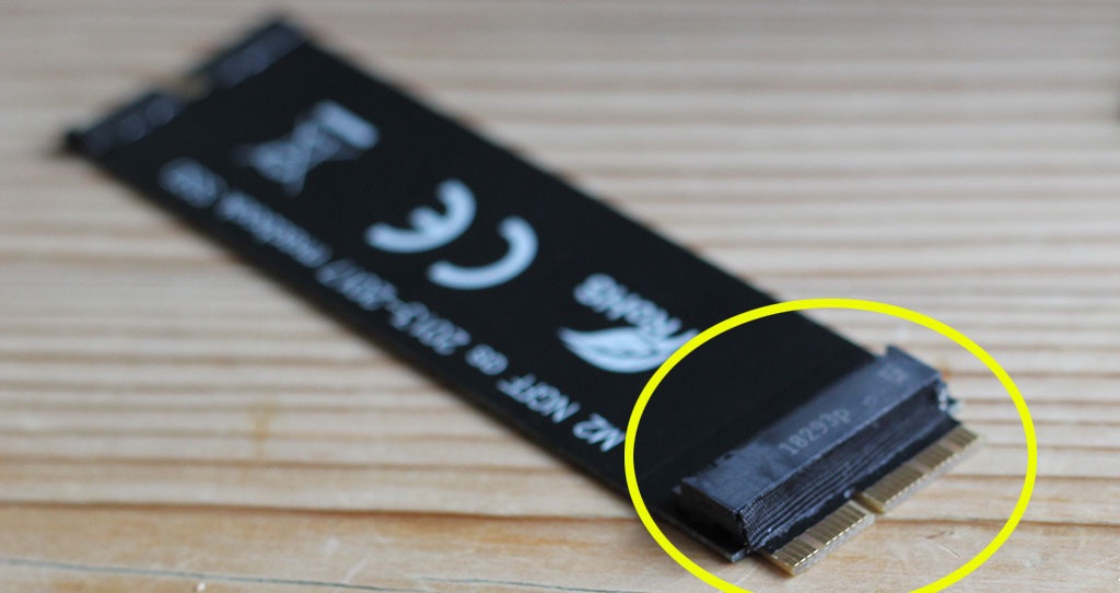

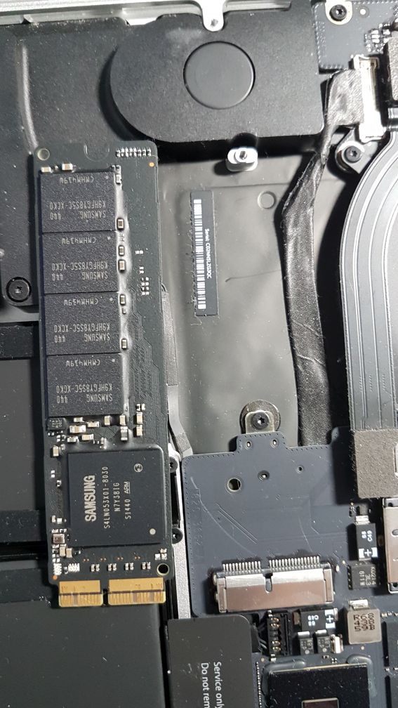

Is it normal for the overhang to go that far? The bolt barely goes in without bending the drive.
You mean from http://eshop.sintech.cn ? Allow at least 2-3 weeks. Took over 2 weeks to get it from Sintech to Norway.People in the US how long does it usually take to get the Santech adapter from them directly? It's already been a week and haven't gotten it.

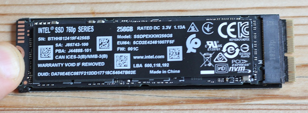

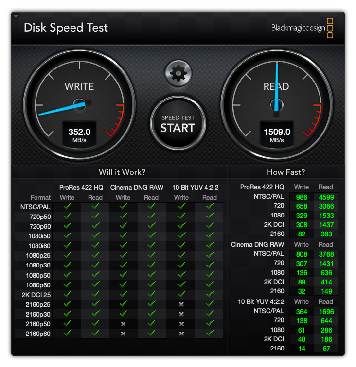

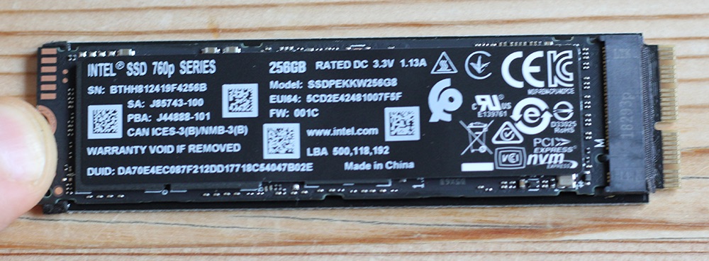

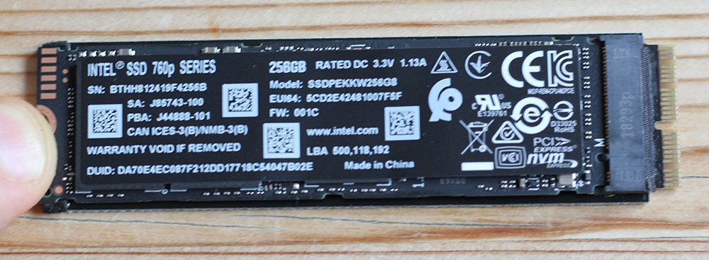

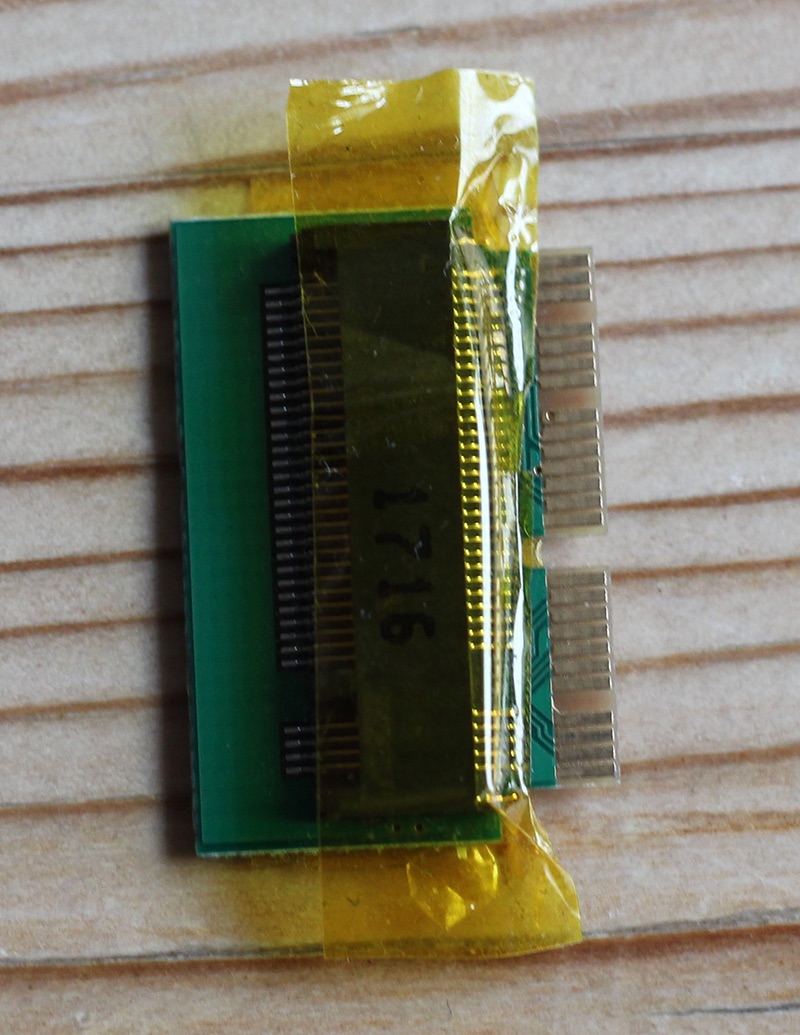

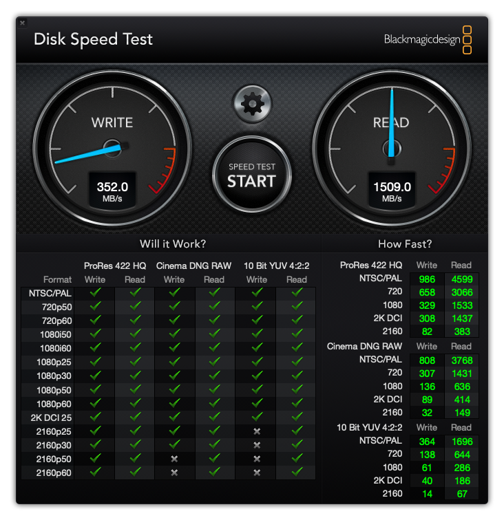

I have problems with write speed on a Intel 760p 256 GB when using any Sintech adapter. On a MacBook Pro 13, 4-lanes/5.0 GT/s . With the same adapters (short and long) I get 800 MB/s write with a Samsung EVO 970 500GB. With the Intel 760p I get 240 MB/s . It seems the new long Sintech doesn't need taping since it already is isolated. Take a look at the pics and how I tape the short Sintech. Anyone get better speeds with Intel 760p with the same adapters?[doublepost=1526398315][/doublepost]

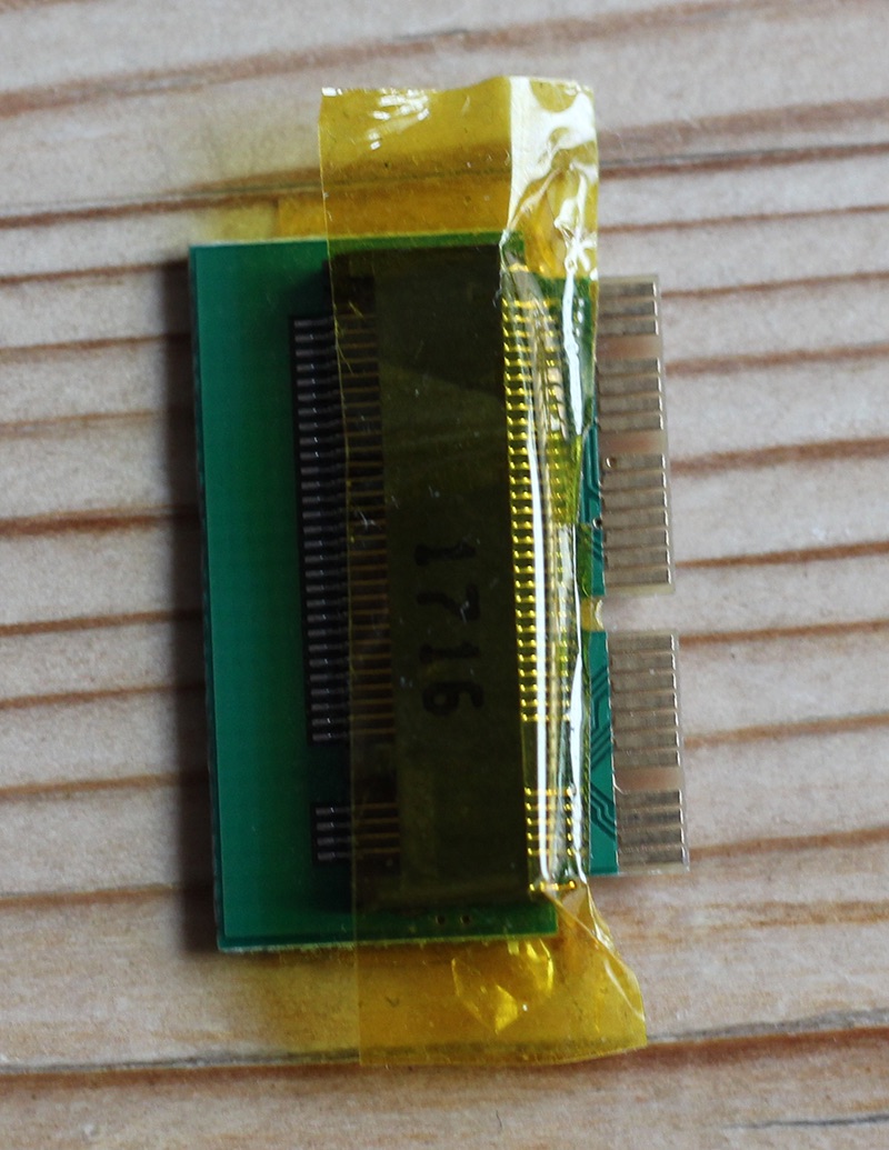

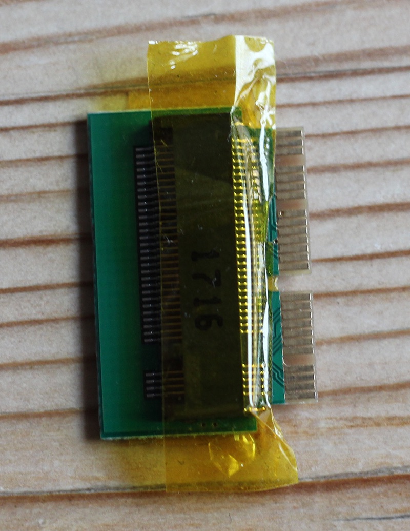

I've wrote in my post how to apply the tape, however i've edited my previous image ...
Hope this helps

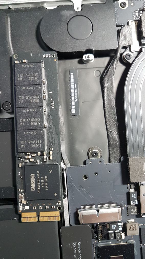

1. If you have a 2015+ model; pop in any Apple SSD to have it run out of the box. SSPOLARIS drives will require that your bootrom is sufficiently up-to-date to support NVMe drives.
2. If you have a 2015+ model; pop in any NVMe SSD drive with the correct Sintech adapter and it will run out of the box. The same bootrom requirement is applicable as (1)
3. If you have a pre-2015 model; pop in an Apple SSD with the SSUA or SSUBX serial-prefix to have it run out of the box. No hibernation issues occur as these are not NVMe drives. No bootrom requirements are applicable here.
4. If you have a pre-2015 model; pop in an Apple SSPOLARIS NVMe drive. These require your bootrom to be sufficiently up-to-date to boot. Now hibernation will not work correctly unless the following is done:

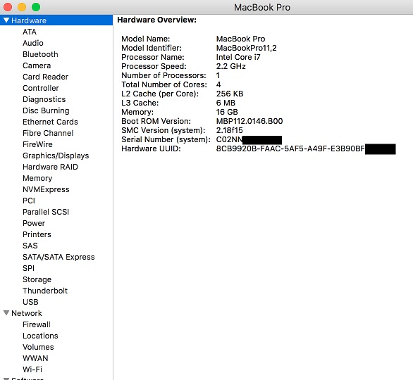

OK - in system report what is the Link Speed of your NVMe. Also are you running the latest bootrom? Latest bootrom on a late-2013 mbp is MBP111.0146.B00; you can google what the latest one for your particular model is or search the forum. Also where did you buy the sintech adapter from? The majority of users here in the forum use the sintech revision c. adapter (i.e. the long black one) and we get full speeds. I get around 1400mb r/w on my intel 760p 512gbI have problems with write speed on a Intel 760p 256 GB when using any Sintech adapter. On a MacBook Pro 13, 4-lanes/5.0 GT/s . With the same adapters (short and long) I get 800 MB/s write with a Samsung EVO 970 500GB. With the Intel 760p I get 240 MB/s . It seems the new long Sintech doesn't need taping since it already is isolated. Take a look at the pics and how I tape the short Sintech. Anyone get better speeds with Intel 760p with the same adapters?

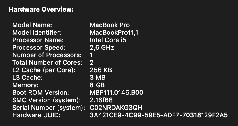

@Trunkz I have bootrom MBP111.0146.B00 which seems to be the latest version for MacBook Pro 13" 2014. I bought the adapter directly from Sintech.cn as I always do. Still the write speed is terrible. The long black Sintech adapter gives even worse speed than the short green. See attached images. What more can I do to get better write speeds?OK - in system report what is the Link Speed of your NVMe. Also are you running the latest bootrom? Latest bootrom on a late-2013 mbp is MBP111.0146.B00; you can google what the latest one for your particular model is or search the forum. Also where did you buy the sintech adapter from? The majority of users here in the forum use the sintech revision c. adapter (i.e. the long black one) and we get full speeds. I get around 1400mb r/w on my intel 760p 512gb

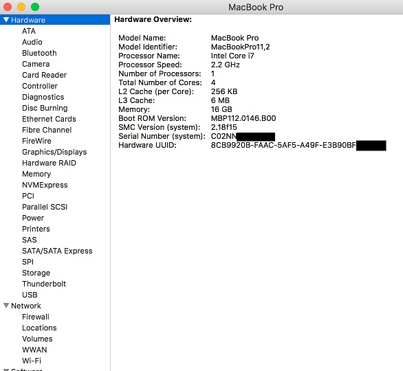

My MBP is 15" mid 2014
Model identifier MacBookPro11,2
Boot ROM: MBP1120.0146.B00
OS: macOS High Sierra 10.13.6
View attachment 795229 View attachment 795232
