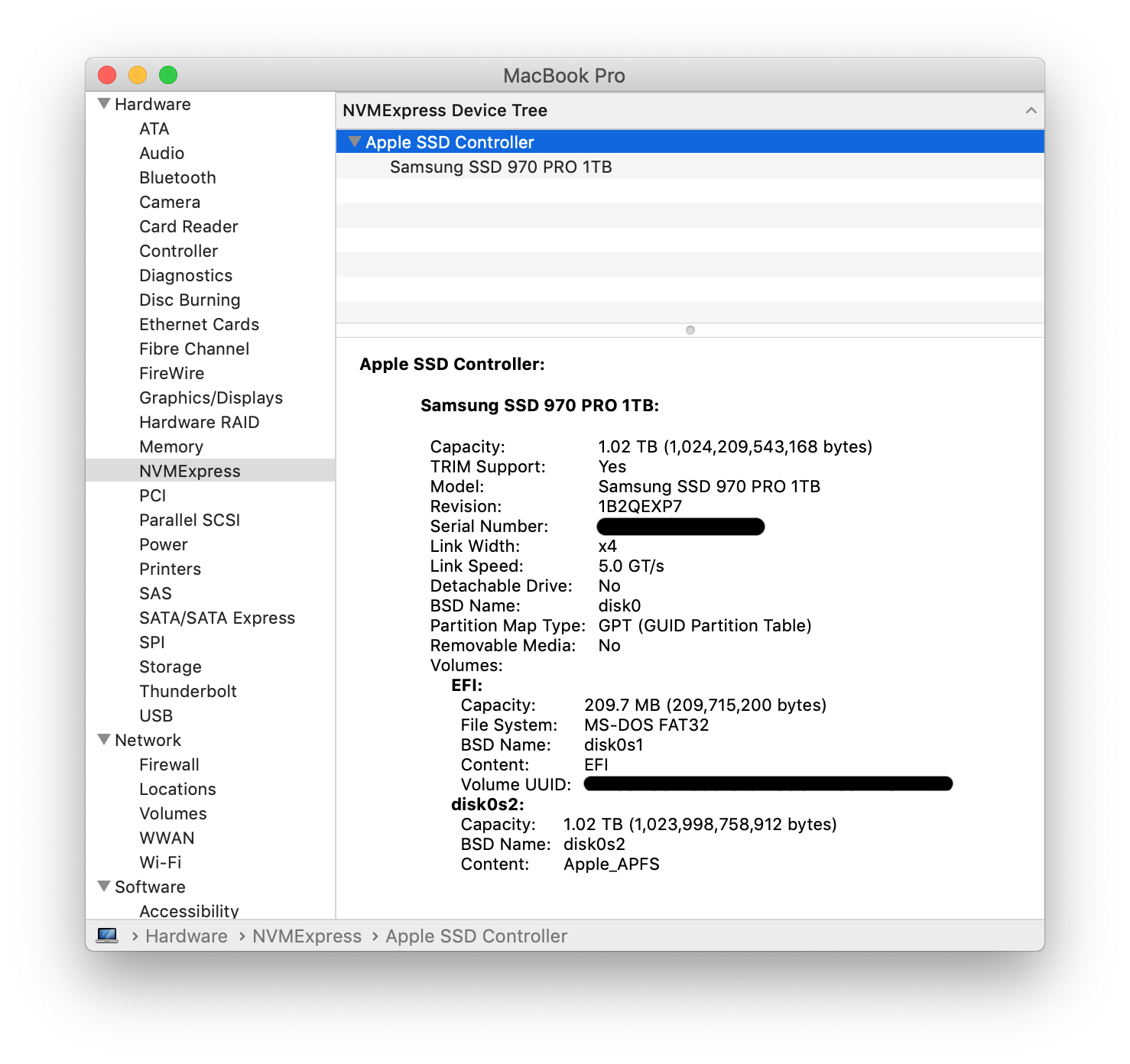

I upgraded my wife's rMBP 13 (Mid 2014) with a Samsung 970 PRO - 1TB , below the steps for anyone joining late to this thread:

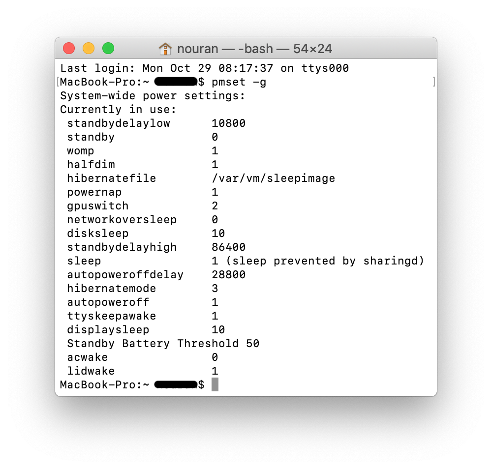

  • Hibernation causes an issue, have to hard reboot the laptop after it, so disabled with sudo pmset -a standby 0.

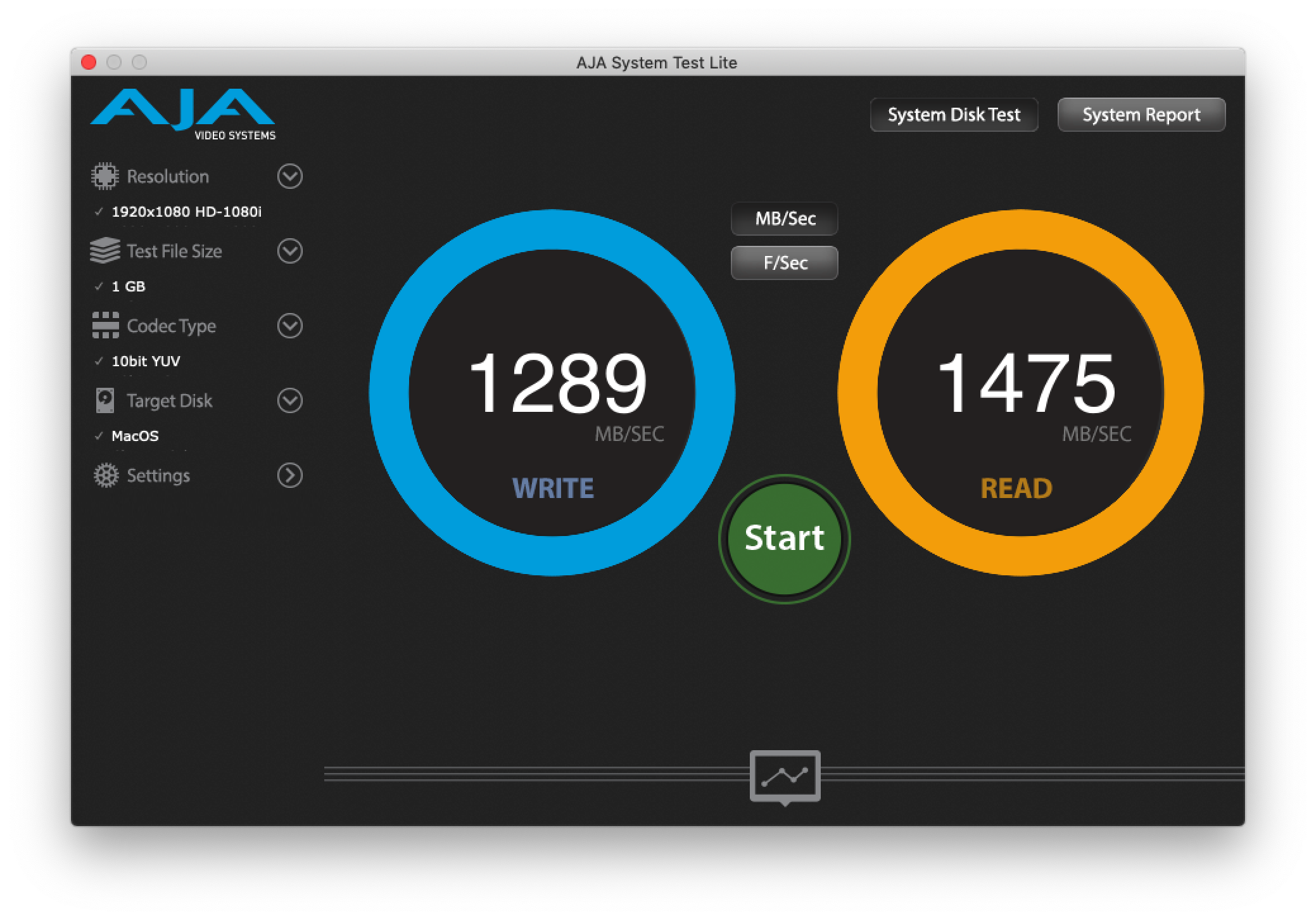

  • Read/Write speed increased between two and three folds.

Below some screenshots:
